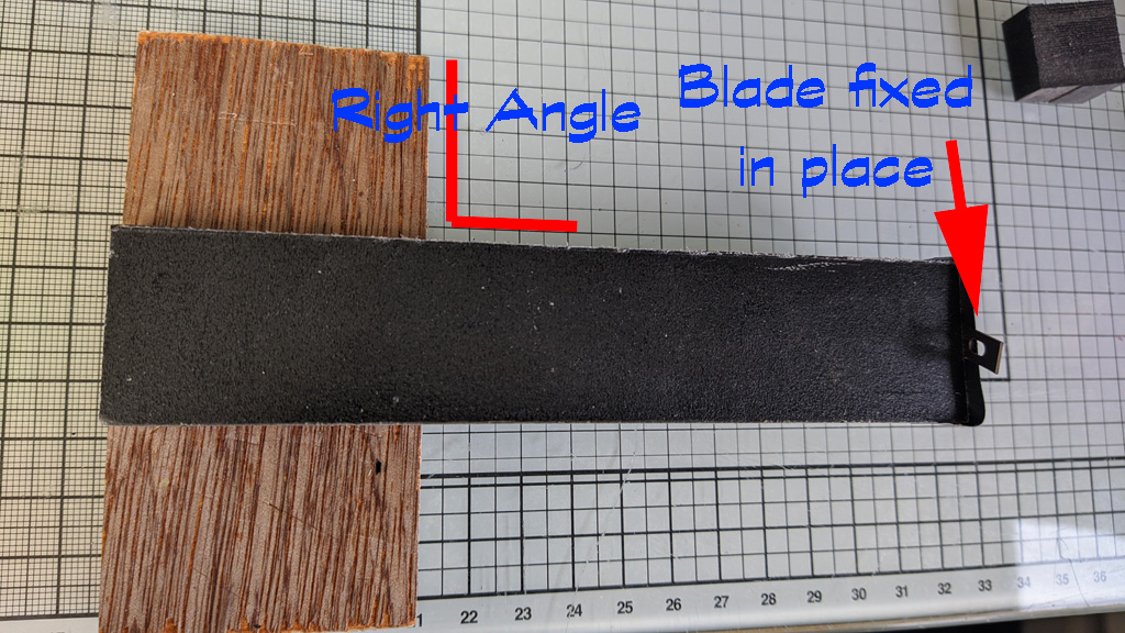

This is what I needed, so I should have said long parallel cuts rather than strips:
Re: Scratch built buildings and applying textures to foamex
Post by Lonsdaler » Tue Jun 09, 2020 12:55 pm
Even for large pieces, I think you could apply the principles of the balsa stripper.
I've mocked one up here - A small strip screwed to the end of the long narrow piece would hold the cutting blade in place and allow adjustability for depth of cut.
