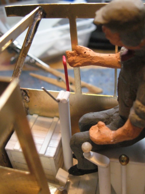

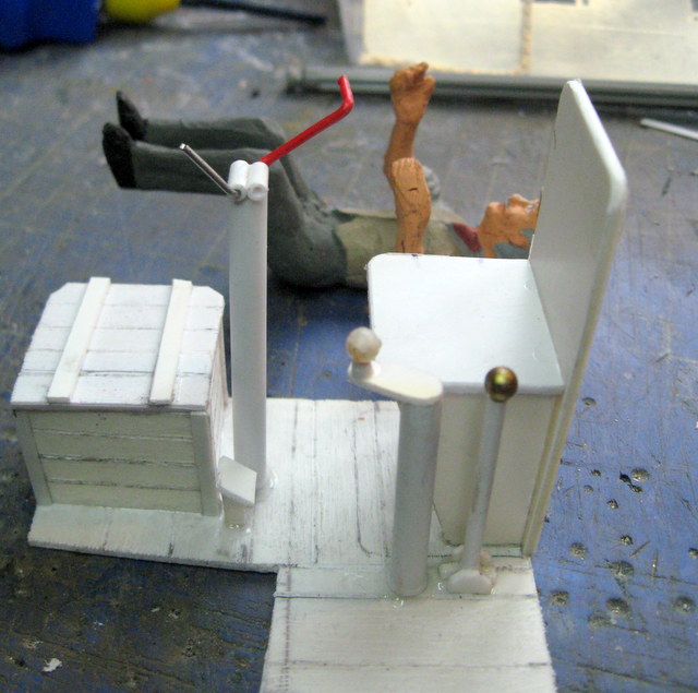

On more familiar territory today. Firstly, I tackled the interior detailing of the cab - using plasticard and a few other bits and pieces.

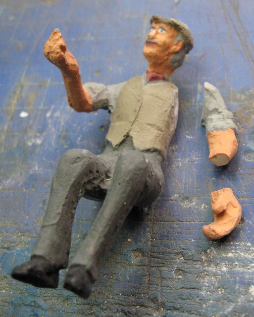

The driver needed minor surgery to give the impression he was actually in control.
The seat has been lowered since this photo was taken, but all the bits seem to fit OK and are based on a photo of the interior of the cab so I think they are in the right places.

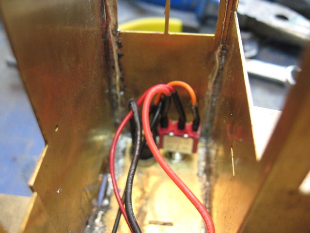

The other job was soldering up and fitting the electrics (a bit blurry but you get the gist)
These are then covered by the fuel tank which is actually in the cab near the driver. Let's hope he doesn't like a smoke whilst on duty!

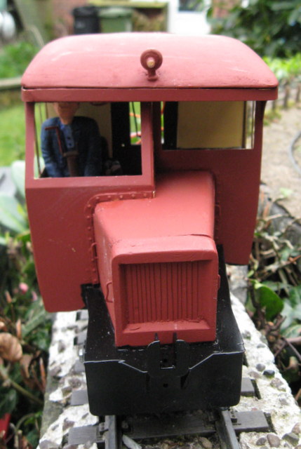

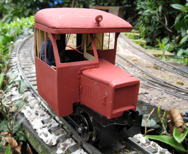

The cab section is almost finished structurally. I've installed all the electrics including a soundcard and given her a test run (video to follow). As you can see, she has been through the paintshop for a coat of primer.
There is still plenty more to do. The roof and bonnet are only loose fits at the moment. The bonnet holds the batteries and the roof holds the electronics, which is still a bit of a bird's nest.
There's also a fair bit of filling and rubbing-down to be done before applying the final livery. The interior of the cab is more or less finished except for glazing and internal window frames and bars.
She's still a little bit stiff legged when she runs but I'm hoping a bit of tweaking will sort that out. The good news is that the electrics work as they are supposed to and my handiwork doesn't look too disreputable.

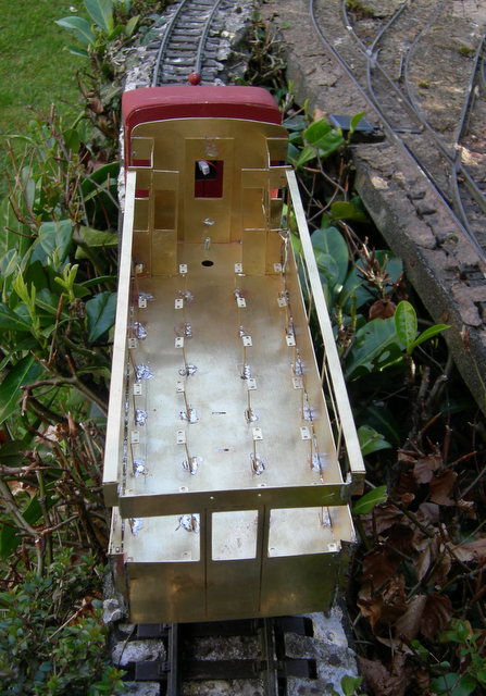

A tad more progress.
The main structure for the trailer is now assembled.
It was easier than the cab - fewer, larger pieces and so easier to get the iron in to the awkward corners. A 100W iron might be useful for delivering the heat but I find it a bit unwieldy! Please don't look too closely at my soldering - remember I'm still learning :?
All those gaps will be filled with carved bass wood. I've made a start on carving the roof (and my thumb!!! :roll: ) but have run out of bass wood and so will have to await deliveries. The good news is that I've run it on all the possible sticky bits of my railway and as far as I can see there are no clearance issues!! :thumbright: I even tried running it through some R1 radius LGB points and it managed them with no problem!!
