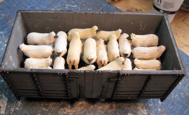

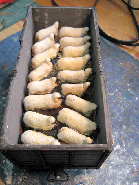

Had a first attempt at creating a plaster cast sheep load. I suppose it might look OK from several metres with eyes half closed. I might try another one with the sheep bunched more closely together - ie mostly backs and heads with minimal gaps between the sheep. This is actually quite tricky as when a new sheep is pressed into the moulding medium (ie PlayDoh), it squashes the impressions which have been made previously and they become mishapen and I end up with humpty backed sheep. However, for a first effort .......
The casting - don't look too closely at their faces - a bit scary!
The load inserted. I suppose it looks a bit better inside the wagon

Good try Rik, but they do rather look as though they are swimming in a mobile sheep-dip tank!
I think you're right though, there aren't enough of them.

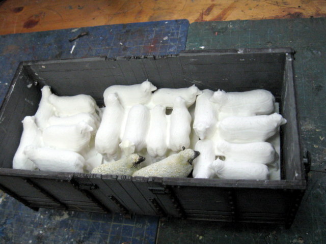

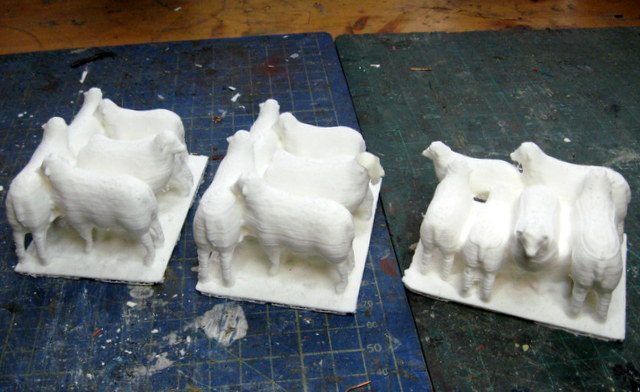

The latest on this. Yesterday, I received a parcel from Philipy containing three clusters of 3D printed sheep.
Before sending him a series of photos taken from various angles, I had arranged them on a baseplate of corruflute which was exactly 1/3 of the area of the wagon. Unfortunately, I didn't notice that some of their snouts and bums were overlapping the baseplate and so Philip had to reduce them in size slightly so they would fit. He even printed one set in reverse to try and overcome the regimented layout. The threesome fit nicely in the wagon, with a little bit of spare capacity for another couple of sheep.
Of course, they need painting which will make the baseplates 'disappear', but I am delighted with the outcome. A lot more realistic than my blobby plaster cast version.

They don't look too bad in the wagon, Rik, I'm looking forward to seeing the painted versions.
For anyone interested, Rik sent me 50 pictures of the one group of sheep, taken from all angles, and I then used some free photogrammetry software to create a 3D virtual model in the computer. This was then transferred into Blender to do a file format conversion, then into Sketchup to tidy it up, then into the Slicer program, and then in to the printer!

I've now painted the 3D printed sheep which Philip kindly did for me. I think they look pretty convincing....

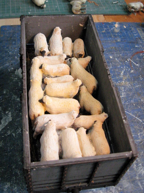

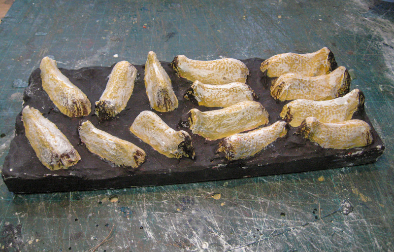

I also decided to see if I could improve on my plaster casting - I bought a kilo of plaster and I'd hate to see it go to waste.
I bunched these more closely together and I think it's an improvement. But I don't think I can match the 3D printed ones.

Your plaster ones look Ok but a bit too regular in arrangement, I think.
