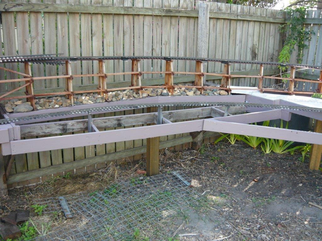

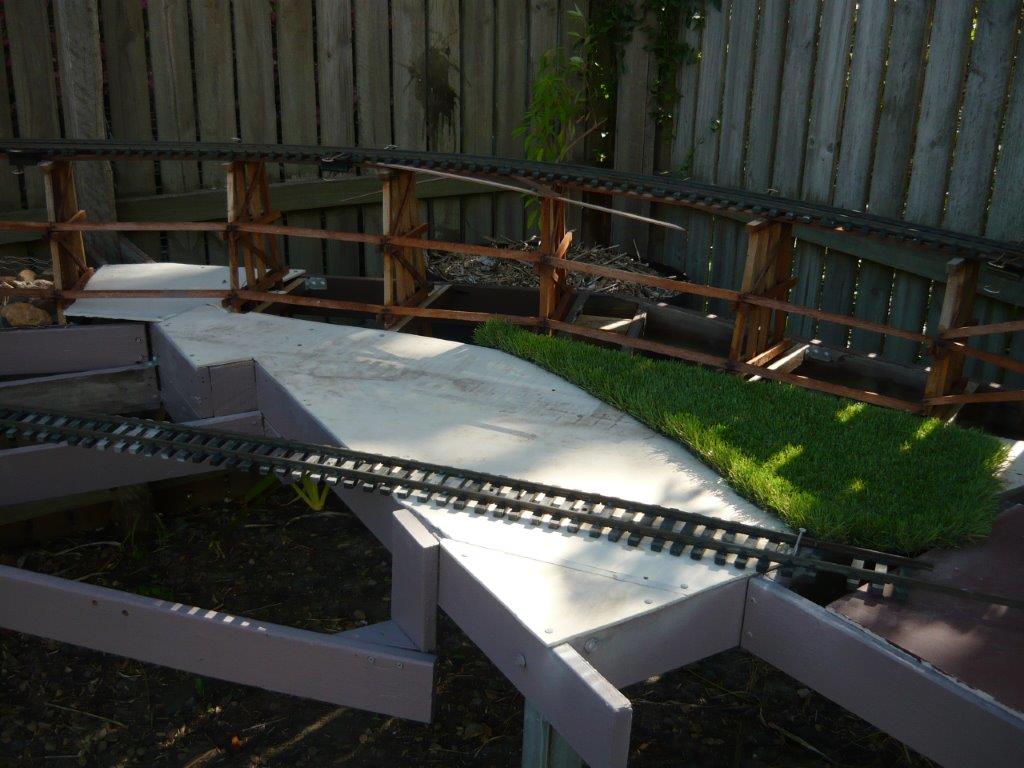

Progress Report #1
The "High" trestle looked a bit out of place with a rocky base under it and a track on level ground in front.
I decided to lower the roadbed in front and add a "Low" trestle to continue the rocky creek bed/gully theme, this will take the gully to the layout edge.

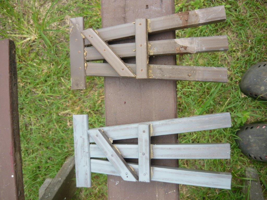

To make the low trestle I recovered a trestle that was used on my old layout, it was made out of plastic molding and looked shiny and un-natural so I scribed "wood grain" using a razor saw and painted it grey to try and get rid of the plastic shine.
The idea is to extend the rocks under the high trestle out under the low one, which will also curve across the corner.
I have some offcuts of synthetic turf that I intend to use under half of the high trestle to simulate a grassy creek bank.
All under the high Trestle that does not have rocks will be "Meadow" as well along whole length of the line either side of the low trestle.
Under the Low Trestle the will be rocks held by mesh and chicken wire.
The pile of the turf is a bit high and if it looks silly close to the sleepers I will paint a strip of brown and yellow along the edge to simulate poisoned grass.

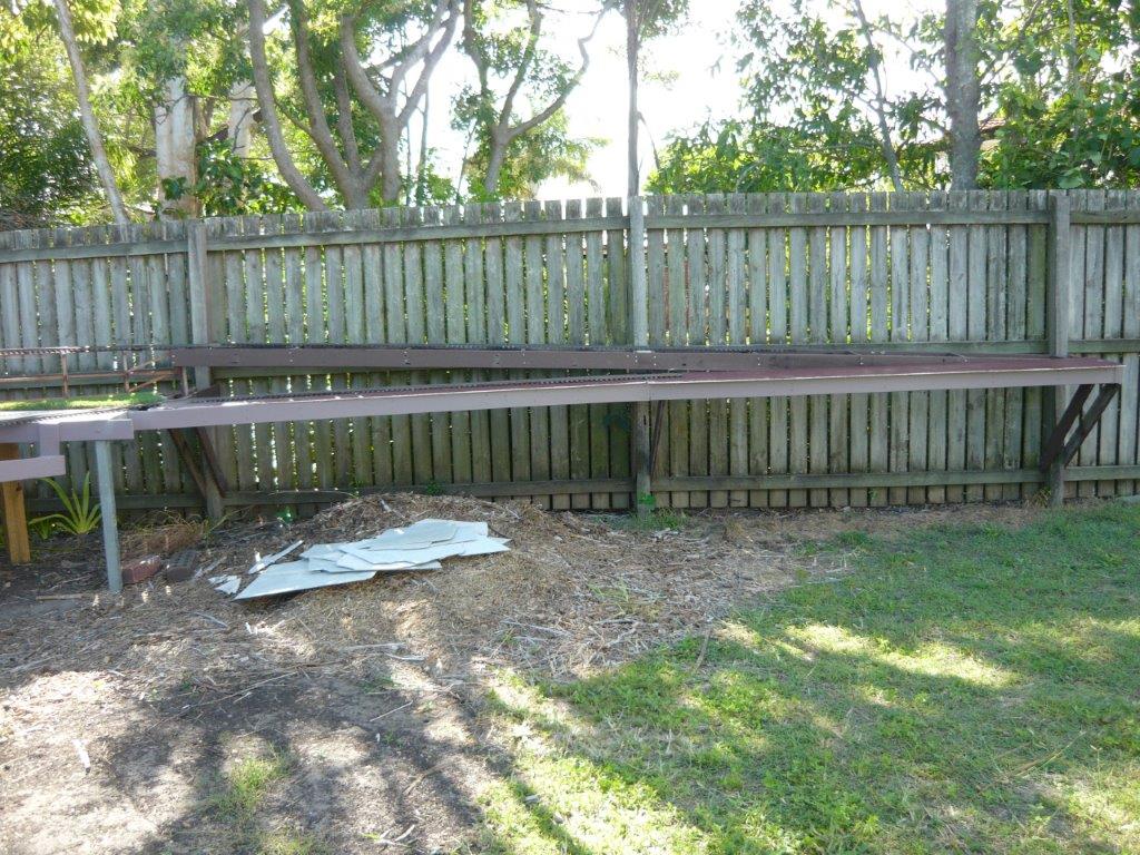

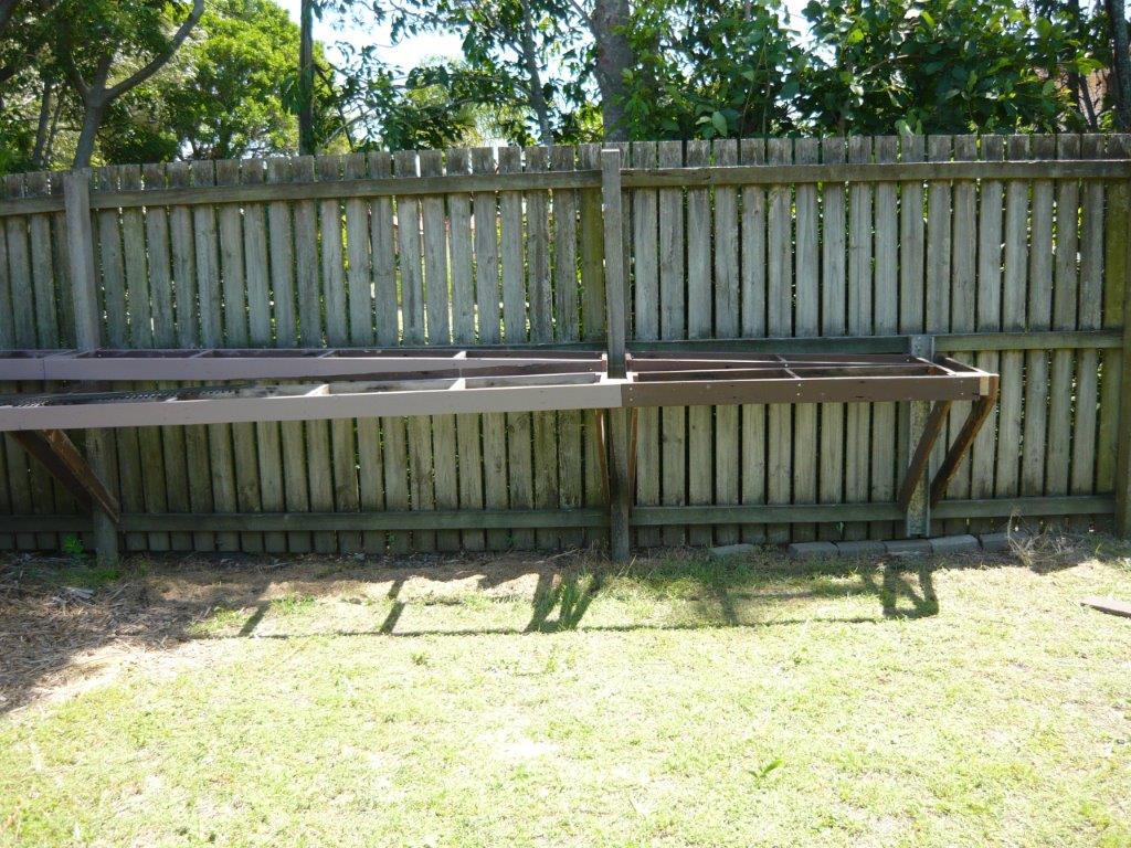

The benchwork that takes the line down from the low end of the High Trestle to the level of the lower line is complete.
It is a bit steep at 5% but its is a mountain line after all, so a whole heap of playing/testing will be required to see if it causes a problem for the trains.
Blog will be update in near future.

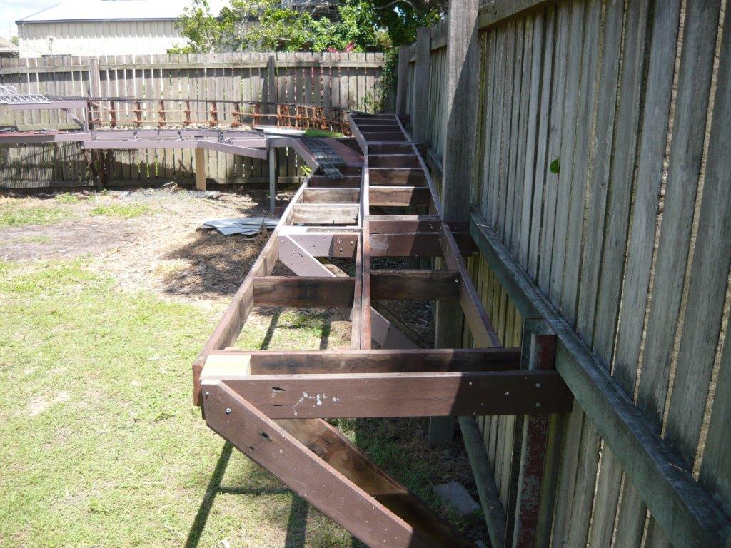

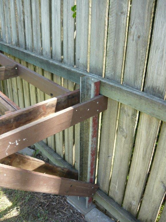

I had a think about the 5% grade and decided that it may be to steep, so I extended the horizontal to 6.1 Metres (20Ft in old money) with a drop of 255mm (10 inches) this gave me a grade of 4.1% which should be OK.
Because the support rails are in between fence posts I had to put in a small post between the rails, I use some galvanized C Purlin to do it.
Now that the 2 lines are at the same level they will now pass through a 180 degree 3.1 Metre (10 Ft) Diameter curve leading to a straight which will head back parallel to the lower line at the same height before turning 90 degrees.
I laid some boards out on the ground to get an idea of what I will have to do, looks like at least 3 posts to be concreted into the ground.
