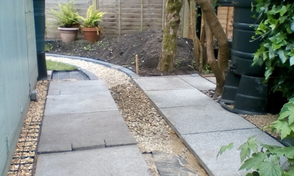

Brief spell of summer-like weather over the weekend so I managed to complete the platform section of the trackbed.
First picture is work in progress:
Second is complete. The turning to the right on the right hand platform will have crossing gates when finished. The bricks sticking up at the bottom of the left hand platform are temporary markers.

I completed the platform section today. I managed to cut some curved platform sections from 40mm slabs, picture below. I've never used a large angle grinder before. I have to say it was a terrifying experience! But not quite as terrifying as some of the YouTube videos I watched. You know if you have not done something before you can usually find some good instructional videos on YouTube? One of the ones showed a guy purportedly showing you how to cut slabs with an angle grinder. He was wearing flip-flops, no gloves, no eye protection, holding the slab in place with his foot. Idiot.

Looks like another great job to me.... the dust carries everywhere though.

YouTube is great for instructional videos and you have made a good job of the platform.

You're right about the dust, it does get everywhere. Luckily it rained shortly after I had finished cutting which washed a lot of it away. I'm hoping the loco will be ready July but more likely August.

Great job on the platform. You should really get someone to hold a hose pipe near to were you are cutting Dave for two reasons.
It helps to keep the blade cool. Believe it or not they do get very hot and can shatter Dave. I have seen my brother when he did some cutting of slabs to go around his pond and wow, did they fly.. ;)
It also keeps the dust down. When the guys did our patio in the last house, they were cutting with all the dust getting everywhere, the next door neighbour was not best pleased. Luckily she is a good friend and didn't fallout with us.
Anyway, I got my hose pipe and with it set at just over a trickle, not to much to get throw all over us, it kept the dust way down. No more upset neighbour...... :D :D

Thanks for the advice Rod. I foolishly left the shed door open while doing the first cut so I have to clean that out when the dust has settled. I'm hoping I don't have to use that beast too often, it frightens the bejezus out of me. How people wield chain saws while hanging in a tree I will never know. I suppose I am glad there are people willing to do it! :-)

I have a diamond disc for my chopsaw which for me is a more controlled way of cutting stone.

Another way to cut slabs is by using the diamond disc to score a line on the cut point on both sides of the slab, then supporting the slab on blocks a smart blow on the cutting line with a rubber mallet usually results in a clean break of the slab. Obviously this doesn't completely remove the dust problem but it certainly reduces it to a more acceptable level.

Good idea for straight cuts Phil, and I use that technique for bricks/pavers, but I needed curved cuts for the most part.

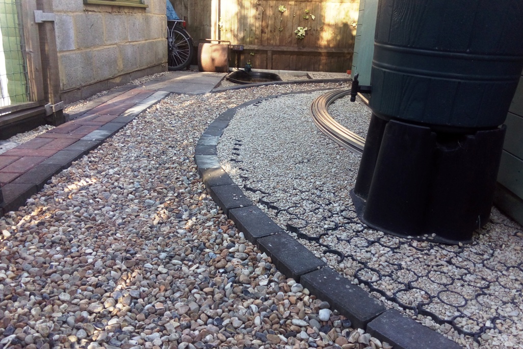

Bang on schedule, I have finished laying the track bed so I now have a complete circuit. I planned to finish this phase in June so just made it. First picture shows the last bend to be laid. In the background you can perhaps see a small pond in the corner.
Second picture shows the completed station platform. In the background on the right is a crossing gate.
Next step is to assemble and lay the track. I have allowed the whole of July for that but as my grandparenting duties end mid-month I hope to finish this before the end of July.
