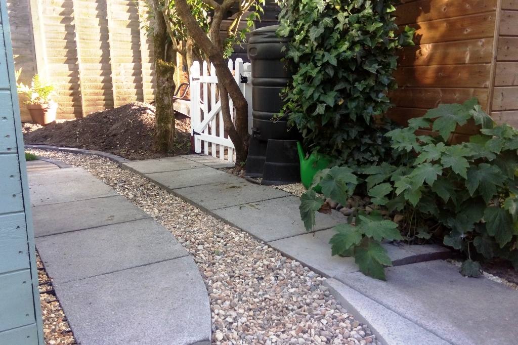

I completed the platform section today. I managed to cut some curved platform sections from 40mm slabs, picture below. I've never used a large angle grinder before. I have to say it was a terrifying experience! But not quite as terrifying as some of the YouTube videos I watched. You know if you have not done something before you can usually find some good instructional videos on YouTube? One of the ones showed a guy purportedly showing you how to cut slabs with an angle grinder. He was wearing flip-flops, no gloves, no eye protection, holding the slab in place with his foot. Idiot.

Post by idlemarvel » Sun Jun 30, 2019 7:43 pm
Bang on schedule, I have finished laying the track bed so I now have a complete circuit. I planned to finish this phase in June so just made it. First picture shows the last bend to be laid. In the background you can perhaps see a small pond in the corner.
Second picture shows the completed station platform. In the background on the right is a crossing gate.
Next step is to assemble and lay the track. I have allowed the whole of July for that but as my grandparenting duties end mid-month I hope to finish this before the end of July.

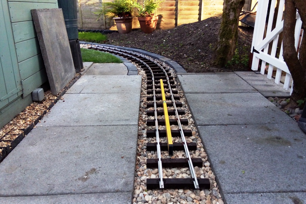

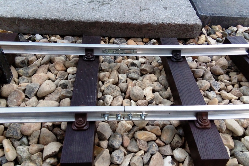

Post by idlemarvel » Fri Jul 05, 2019 8:40 pm
I have started building track panels and laying some track. Just two panels so far but the layout is so small there are only 10 panels in total so 20% of the way there! Well not quite as I have to add the ballast and do some fettling but should be done by end of July if not sooner.
The spirit level is just for show but it is level! For those interested the track is 5/8" aluminium with recycled plastic sleepers and chairs from PNP. I have set the sleepers to approx 150mm spacing which if you scale it up is the same as on PECO SM-32 track. This is to give a narrow gauge feel to the railway. (PNP do more prototypical mainline type sleepers as well.)
The track panels are assembled from the rails, chairs and sleepers. The rail comes in 2.5m lengths. The chairs slide onto the rail and then plug into the sleepers. There's a nice touch if you want to ease the curves a bit, if you turn one chair through 180 degrees that widens the gauge by 1/32", and if you turn both chairs 1/16". The rails are connected with fishplates and 4 bolts. The process of building the panels is a bit laborious but somehow satisfying!
