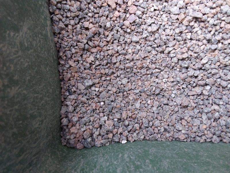

Peter, the stone that I have used is a horticultural grit that I got from a local garden centre and what is surprising is that is actually quite a sharp grit. I know that it looks quite rounded in the photo, who ever said the camera never lies? I will endeavour to take a close up shot of it later.

This is the horticultural grit that I've used straight out of the bag before washing.
I estimate that the average grit size is 3 - 4mm, as can be seen some of the grit is a bit larger at maybe 5 - 6mm but they are few enough to pick out if they cause a problem.

Yes, I've got some of that in the garden for potting grit. It's a little larger than my granite, but I've had it in mind for when I run out, although it is a different colour - red rather than greenish.

Sorry to say this but I covered that one too!
Peter Butler wrote: Sun Apr 14, 2019 6:22 pm Personal experience of using SBR and a variety of ballast materials has given me an insight into what works and what is less likely to.
My own first attempt was to use horticultural grit, which I took a long time to sieve out the larger lumps and only use the smaller. I quite liked the appearance of the grit but it failed in service after a couple of seasons.
I just hope you have more luck..... please update as time goes by.
