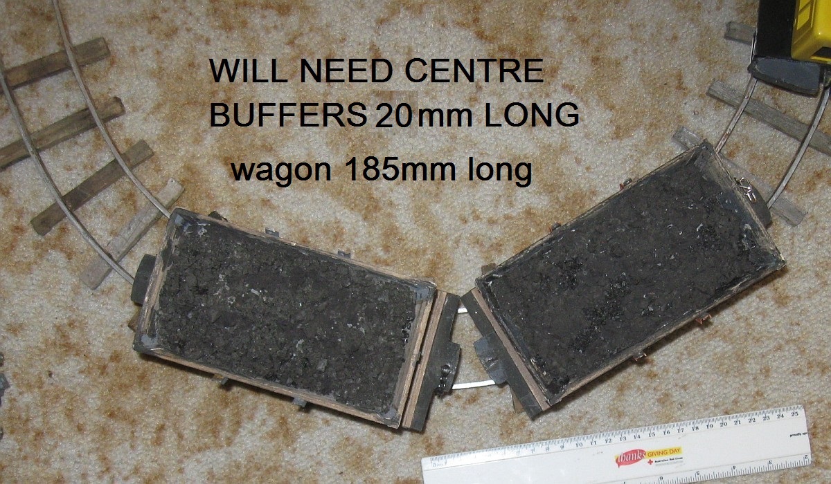

They are a fantastic idea Tom. Very, very clever. I have always liked the centre chopper types. BUT how would they go on the tight curves? They would have to 'swivel' a lot. Can they do that?

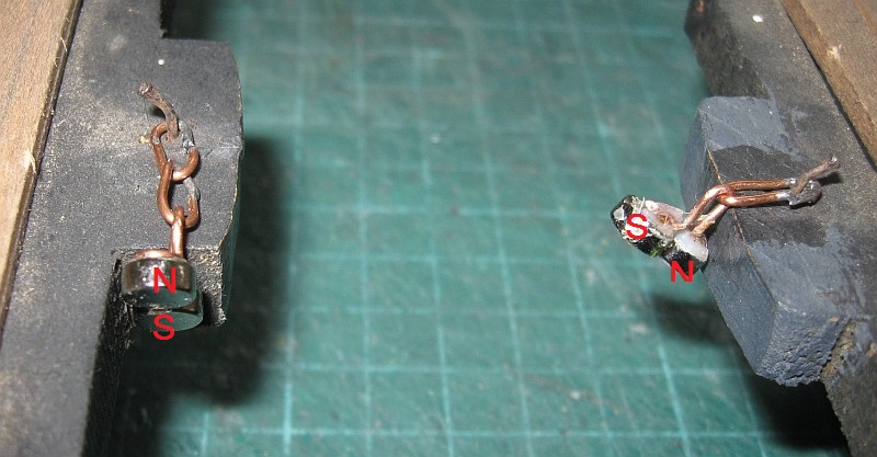

When I said magnetic I was thinking of this type of thing - 2 magnets - one north pole and one south pole so a wagon could always 'grab' another.
These were just experiments - not completely successful. They are too 'wiggly' and can get all tied up!
I haven't really thought about how to get them uncoupled.
Greg from downunder.

Just a thought for you - I've also always liked the way Tom's magnetic choppers work, but only having one Accucraft fitted loco it has never been economically viable to retrofit them to everything. I've played with various other DIY couplings thoughts but never found anything that I'm happy with. Then about 3 weeks ago, looking again at Tom's video of them in action I remembered that I had 3d printed some extra coupling pockets for him some while back, and that got me wondering whether I could actually print a whole coupling.
So far it's looking hopeful, the only bit left to do is fit the self-centring springs, which are currently somewhere on the way from China. The printed couplings I've played with so far have been to basically the same dims as Accucraft, but there is no reason as far as I can see why the pockets couldn't be made as wide as necessary to allow for whatever side play is required to go round your curves. The only slight unknown is the size of spring necessary to not get knotted. That then might require the pocket to be made longer and that in turn might increase the amount of swivel required, and that then might in require a longer spring, etc ....!

They negotiated 2ft 6" with ease, I reckon they will work for you.
I will get a photo of two items coupled together so you can see how much they can swivel.
