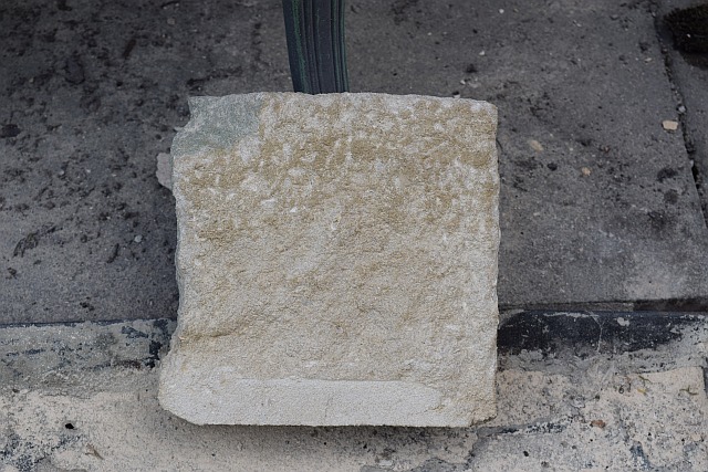

Well I had a go at stone cutting today. As I suspected this stone doesn't like being chiselled and I ended up with a load of bits instead of two slabs.

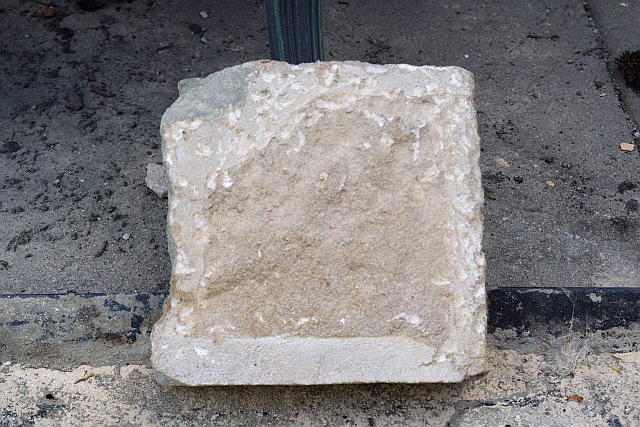

So, I got my small angle grinder out and cut a line right round, and that splits Ok, but obviously leaves a small smooth border, which clearly doesn't look natural.
DSC_0001 (1) small.jpg (193.82 KiB) Viewed 11412 times
However a couple of minutes work with a lump hammer soon roughens that up
DSC_0003 (1) small.jpg (204.13 KiB) Viewed 11412 times
Then a few more minutes with a steel wire brush blends it all together.
DSC_0006 (1) small.jpg (181.88 KiB) Viewed 11412 times
I don't think I'll win any commissions for repairing cathedrals, but it will do for what I want!

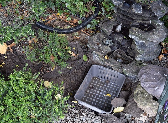

I've done a bit more this past few days but nothing much worth photographing. Basically I've acquired a small plastic box which, with one side removed and possibly a hole cut in it for the supply pipe, will become the former for the top end of the stream. I haven't yet fully decided whether to run the supply pipe over the top or attach it to a tank pipe connector in the side. Running it over the top will be easier to do but harder to disguise whereas going through the side will look much neater but prone to leaks and water syphoning back. In the picture, the pipe will come in from the back LH corner and the stream will flow out either from the front LH side.
The large lump of slate just visible at the RH side will be split and used to form a junction with the waterfall at the back and cover the inlet pipe.
Yes I know that slate and Cotswold stone aren't normally found together but we have very peculiar geology in Elderbury, it attracts geologists from all over the world. Thats actually the main reason for the railway building Appletree Halt, to enable the hordes of geologists to use the train to do field trips!

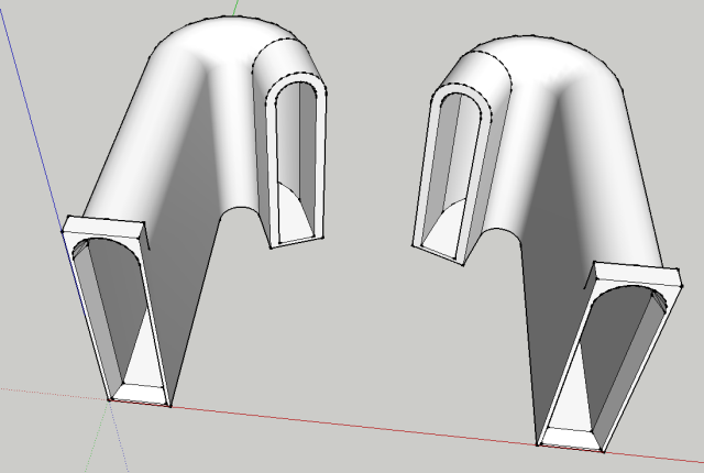

Well, I've decided about the water supply position. It will be fed over the top of the end of the tray in the picture above, between the tray and waterfall. To do that neatly and hopefully fairly unobtrusively, I'm planning to 3d print some custom pipework and I've spent 3 or 4 hours over the past two days doing the drawings, which for the sake of completeness I'll post here. There are basically three components, each having two mirror image halves, so eventually I'll print six objects then glue them together.
1) 2 halves of the incoming supply pipe

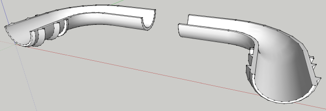

2) The 'manifold'
manifild end on.png (53.25 KiB) Viewed 11303 times
manifold top view.png (76.68 KiB) Viewed 11303 times

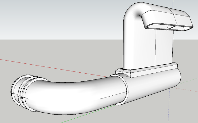

4) Complete system with all of the components assembled.
complete system.png (49.66 KiB) Viewed 11303 times
The spouts wll hook over the end of the box.

Peter Butler wrote: Sat Sep 15, 2018 8:23 pm I can't imagine how you came up with the design.
Peter,
Like most of my idea's/projects it just sort of growed.
I was contemplating some sort of clip to hold the 38mm ID flexible supply pipe to the top of the tray edge and wondering if I could print something, but in the back of my mind I thought that a 38mm (44mm inclding wall thickness) lump would be too difficult to disguise, so I started wondering about going to a flatter but wider profile with the same cross-sectional area to avoid throttling the flow.
Before getting too complicated a design, I started to think about how it could be drawn. The Sketchup drawing program has a tool called "Follow Me" which I have used a number of times previously for producing things like chamfers. Basically if you draw, say, a diagonal across a corner, highlight the adjacent edge and click "follow me" it automatically runs the triangle to the end of the highlighted line, which can be any shape, like round a door frame for example and you get a chamfered edge to the frame. Well, I had a brainwave at this point, but tested it with something fairly simple. I drew two concentric circles, 3mm apart and removed the centre to give the end of a tube with an external diameter of 38mm. I then drew a line from the outer edge at right angles 150mm long, added a 90deg curve to the end and drew another straight line from the end of the curve. So far so good, but nothing I haven't done before, so now for the bright idea. I highlighted the three lines, hit "Follow Me" and clicked on the face of the tube end, and in a split second it did just that, and I had a hollow tube with a bend in the centre! I then used "Follow me" three more times round the circumference of the pipe to produce the triangular barbs to grip and stop the flexible tube. Finally, because it is easier to print without overhangs, I split it lengthways so eventually I will print 2 open half-tubes, which is the first drawing above.
Following that, I worked out the dimensions of the flattened tube to hook over the tray edge and drew the shape as a long rectangle with one inner curved end and one flat end. I then drew the adjacent lines, similar to the first pipe( different dims obviously), hit F-Me again and got the hollow hooked shape. This was then copied and mirror-imaged so that when glued together flt-to-flat, I will have the area to cope with the same volume - actually I rounded it up slightly to make some notional allowance for friction flow losses in the narrowed pipe.
All I now needed was a piece of pipe, which I'm calling a manifold for want of a better term, with a long thin hole in one side and a fitting to take the two hook pieces. This was drawn using similar techniques.
I hope all that makes some sense if anyone has been daft enough to try reading it! :scratch:
Tom,
I shall print it in ABS and use Plasticweld to stick it all together.
