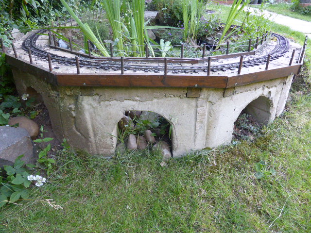

OK, Viaduct Part 2 - Illustrated.
This view shows it all well (a bit too well, perhaps...):
The malformation of the arches is due to the plastic sheet not sitting perfectly over the quarter-logs. The shortcomings of my shuttering are rather obvious too!

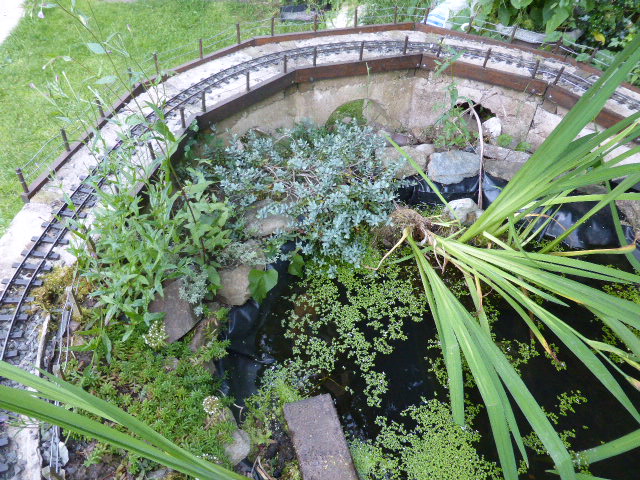

The next photo shows the view from above. My trial arch was the one to the left of the centre one. When I had all the moulds and shuttering in place I stood back, looked at it, and thought "Hmm - it doesn't look quite right". I measured it and couldn't find anything wrong. As you see from the track alignment, my first impression was right! No matter - I have an idea for using that feature for scenic (and possibly comic) effect.

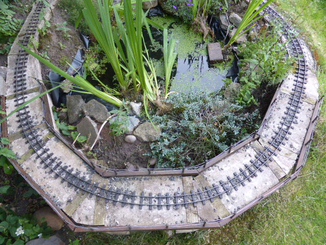

And another view from on top, this time from the other side.
The small pond wasn't very obvious in my previous photos. There WILL be an outflow from the pond into a stream running through one of the arches. One day!
I admit that my viaduct is a little scrappy, and at times I wish I had done better. But the important thing is that it exists and trains can run over it! And I never set out for the finescale look - it doesn't work against the plants in the garden anyway.
