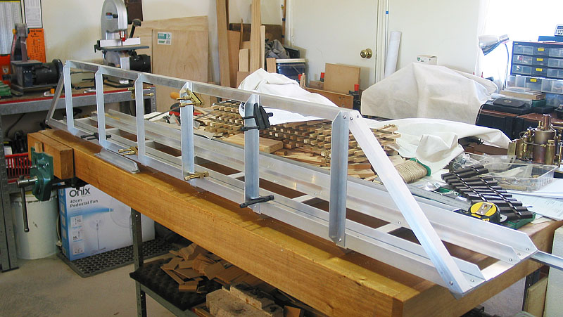

The first photo shows the base assembled. The track is designed to locate between two 20mm x 1.5mm angles and a piece of AMS sleeper strip can be seen checking that it will indeed fit. The lower chord of the truss is made from 25mm x 3mm angle, as are the cross members. The walkways along the side of the track are 32mm x 3mm flat. A VR bridge would be decked and ballasted, but I decided against doing that.

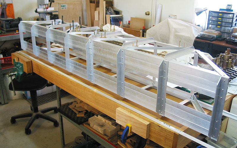

The third photo shows the bridge with both side trusses installed, the 20mm x 1.5mm top cross braces in place and the 12mm x 1.5mm angle braces in the truss being installed. The bridge became noticeably much stiffer once the angled braces were installed in the trusses and there was no visible deflection when the bridge was supported only at the ends and I pressed down hard. It won't notice the weight of the Garratt, or the local brushtail possum and cat populations if it comes to that.
The next photo shows the side trusses complete, but the 12mm x 1.5mm angle braces on the top and bottom still need to be added. While the bridge was now rigid vertically, the horizontal and torsional strength was still low.

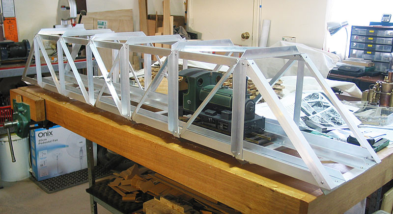

The next photo shows the bridge fully assembled, with the Hunslet loco sitting on a short piece of track to provide an idea of the scale of the bridge. This is by far the largest model I've built since changing scale and it barely fits on the workbench. With the angle braces in place on the top and bottom, the bridge was now as strong torsionally as it was under vertical and horizontal loads.
