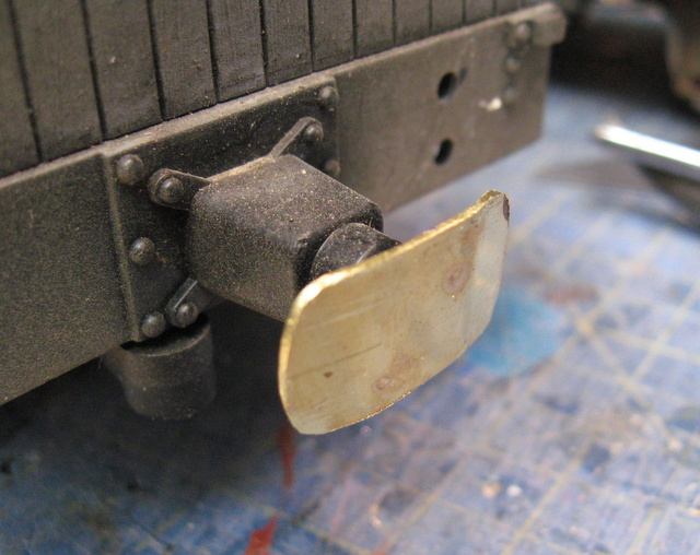

Still needs some refinement but the principle seems ok. Got some phosphor bronze on order and some heavier gauge brass wire for the loops - the paper clip loops are a bit too easy to bend out of alignment.
I was hoping I could get away with using the centre buffers on my 'bashed' LGB stock but they aren't wide enough and have a tendency to lock when being propelled. Looks like I'll either have to find a way of widening them, with plasticard or brass shim, or replacing them with Binnie Carmarthen buffers.

Have you looked at these Pasidump brand? If you only need them to push, they might be OK.ge_rik wrote: Sun May 13, 2018 7:46 pm I was hoping I could get away with using the centre buffers on my 'bashed' LGB stock but they aren't wide enough and have a tendency to lock when being propelled. Looks like I'll either have to find a way of widening them, with plasticard or brass shim, or replacing them with Binnie Carmarthen buffers.
https://www.ebay.com.au/itm/152805495920?rmvSB=true
Being a rough-as-guts modeller, I'd just use a piece of wood like these on my rake of coal wagons that I rarely uncouple. (I use chains on the nail you can see) You could shape them better than me, I'm sure.
I certainly wouldn't use plasticard shims - breaks too easy if you do manage to lock buffers. Brass would be OK.
Greg from downunder.
- Posts: 7863
Re: Couplings
Hi Greggregh wrote: Mon May 14, 2018 12:39 am Have you looked at these Pasidump brand? If you only need them to push, they might be OK.
Yes, I did get a pack of those when I was going through the evaluation phase. I'll dig them out and see how they look. I'm struggling to get a response from Peter Binnie - may have to wait for Llanfair before I can get more Carmarthen buffers.
You're right, brass shim will be better than plasticard.

I'd agree with Greg, plastic buffer extensions wouldn't survive the first derailment.
I'm not sure a glued joint between a metal plate and a plastic buffer would be that strong either, although you could try 'Loctite Super Glue All Plastics'. It comes in two tubes and uses a surface activator as well as glue.
A shaped block of wood has a lot going for it. The easiest way to make a lot of them to the same shape is to shape a stick of wood to the desired cross section from above, then cut off slices to make individual blocks.
Another alternative is to use a buffing plate in front of dummy buffers like the example below, which can't buffer lock and is fixed with screws.
This was knocked up in a few minutes, which was quicker than trying to describe it in words. It looks ugly and the shape needs refinement.
It occurred to me afterwards that a piece of wire bent into a U, recessed flush with the buffer face and glued into holes in the buffer beam would do the same thing and would be a lot less obtrusive.
Something like this would work well for bogie vehicles with long overhangs and also at the rear of locos with a long rear overhang.

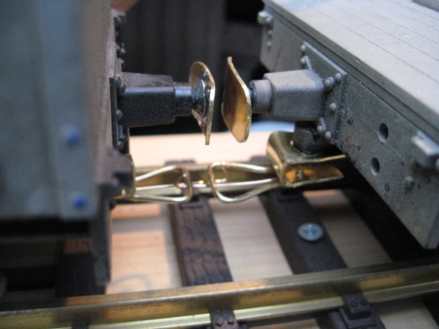

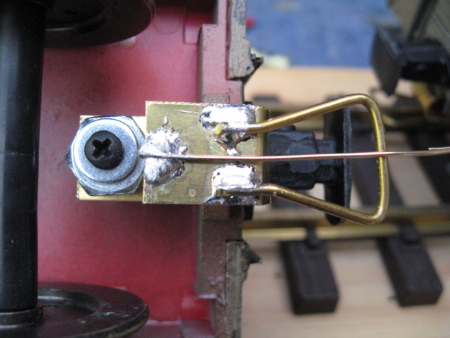

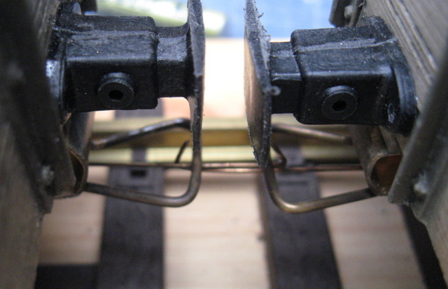

More progress. All the bits and bobs I ordered over the weekend have arrived and so I've had a chance to try out the new materials. 1.5mm brass rod for the loops and 0.7mm phosphor bronze for the hooks.
I've done some testing and this arrangement seems to overcome some of the problems I was having previously with the loops becoming misaligned and the hooks not springing back after a few uncouplings. These are the prototypes and so look a bit rough and ready. As soon as the Binnie buffers arrive (paid for this morning), I'll be able to go into proper production.
I've had a go at chemical blackening. Seems a bit hit and miss at the moment. Might need to practise a bit more before I get the process perfected.
Getting closer!
Getting closer!

I've fiddled with the jig for the loops and I'm beginning to feel more at ease with it. I'm finding that over-bending and then slightly unbending again gives me a sharper angle. There's a certain amount of tweaking of angles required, but at least the bends seem to be in the right places.

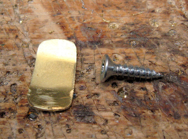

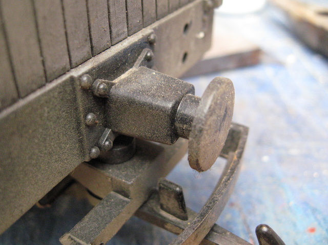

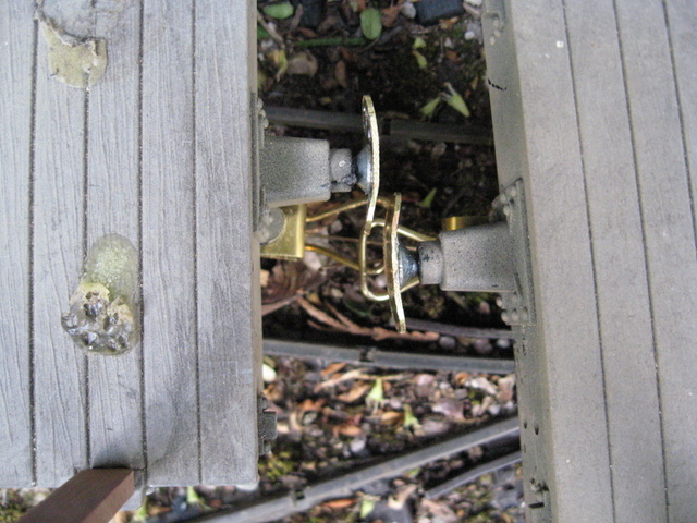

Whilst I'm awaiting delivery of more Binnie buffers, I've been experimenting with ways of replacing LGB buffers with something wider to avoid buffer lock when stock is being propelled.
The LGB buffers are somewhat small which is why they need replacing....

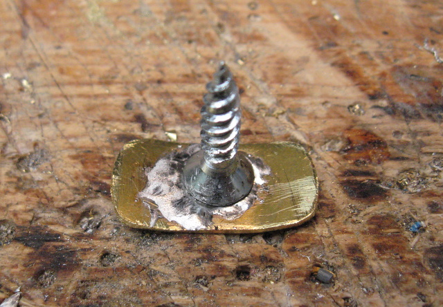

However, I have discovered they can be removed, leaving a 4mm dia hole. I discovered that a No.8 woodscrew is a tight fit and so will act as a self-tapper. So ......
With a bit of solder and some burnt fingers, I end up with a reasonably passable buffer .......
Which simply screws into the housing on the buffer beam.
More importantly, it doesn't lock when the wagons are being propelled around even the sharpest (R1) curves.
There's still a bit of tidying up needed - I've ordered some brass screws and I'll chemically blacken the the buffers, but I'm pleased to have found a relatively simple way of replacing the buffers on ex-LGB wagons with something which seems reasonably realistic, is simple to make and is cheap!
- Posts: 5965
Re: Couplings
Seems as though you've cracked it, Rik. Well done.
I wouldn't be surprised if there are more than a few copy cats, sooner or later.
