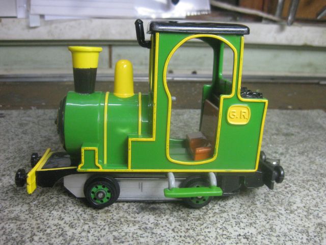

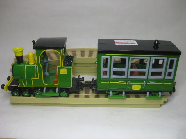

Hi,
In between bashing and pickling boiler end plates I have put wheels on the new carriage which like its big brother has had its doors glued shut. The locomotive will pull both carriages at the same time but not around the tight curves of the test track. I will now have to look for some Postman Pat figures to drive and ride the train.
Regards Tony.
Regards Tony.

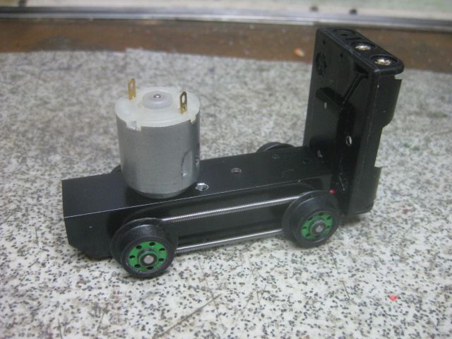

Tony, I wonder would a little more friction to the centre axle help. Could a little roller deflecting the drive band down slightly between the second and third axle work, though not wanting to get away from the simplicity of the project which is part of its attraction.
- Tony Bird
- Posts: 601
- Joined: Thu Jul 29, 2010 8:25 am
- Location: Cardiff, South Wales, UK.
Re: Glendale Rocket Project.
Hi Grant,
A very good idea and perfectly possible but alas not with the chassis as it stands as the motor would need to be moved a little, maybe when I have a go at Mk.2 I will try it. I have used a jockey pulley but in my a case sprocket to take up the wear on a chain drive electric locomotive chassis, the chain had worn but not enough that a link could be removed.

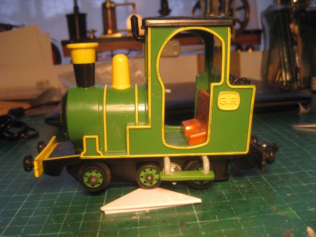

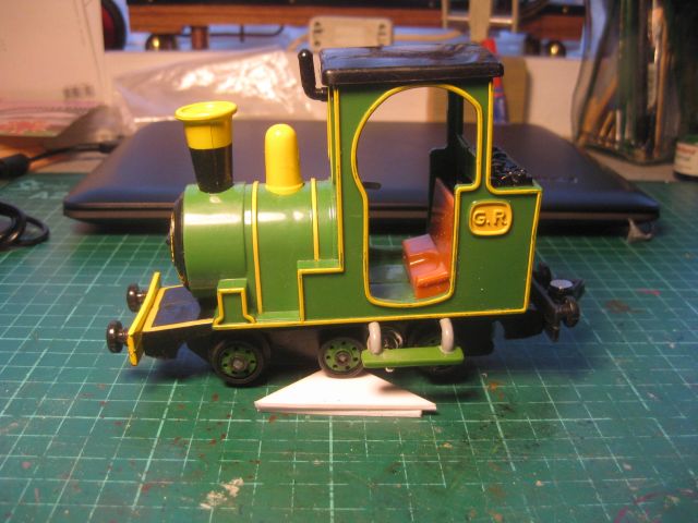

I have however improved the traction of the chassis, when building steam locomotives I usually balance them around the centre of the distance between the driving wheels. This usually requires a weight to be fitted to the front or rear buffer beam to achieve a rough balance. When I picked up the model it was very heavy at the back because of the batteries the motor not anything like balancing them. The hasn't happened before as all the chassis I have made have had the weight between the axles not outside.
So I balanced the model on its centre axle. It needed three and a half lead washers to balance the model. These washers were glued into the smoke box and then painted This done the model would stay in place with both front and rear buffer beams touching the table. The traction now is such that the motor will stall before the wheels slip. The Glendale Rocket now easily manages to pull both carriages and pushing it two Thomas the Tank Engine carriages as well. I have always found balance my steam engines improves their traction but never thought of trying the same on electric locomotive, to be fair most are probably nearly in balance anyway.
Regards Tony.
Regards Tony.

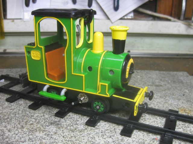

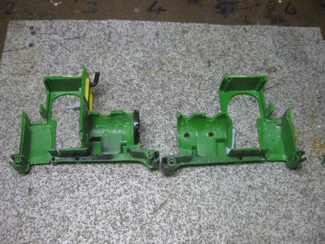

Hi,

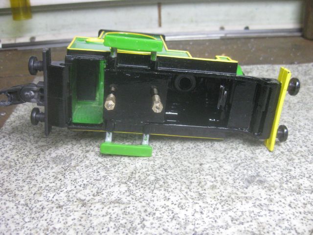

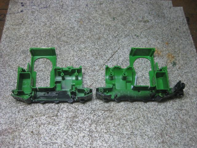

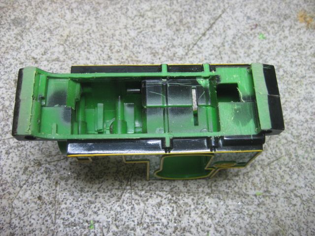

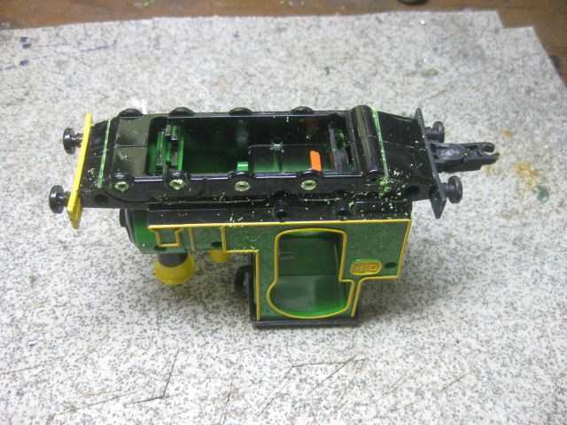

As we go away tomorrow for a bit and I had got to a convenient stopping point with the boilers I am working on so to fill it time I thought I would do a bit of work on the Glendale Rocket Mk.2. Starting with cutting the body about to see if it was possible to fit thee AAA cells in the same place as Mk.1 had two.
This was a none electric version of the Glendale Rocket. The roof was removed along with the wheels and the first cut made. The body was dismantled. Part of the chassis was cut away. And filled to shape. Leaving it looking thus. The inside of the body had almost all the fixing points removed. Other parts of the model replaced. The body assembled with battery holder fitted. Body at end of play. So it looks as if I will be able to fit R/C to this model but it will be some time before it is completed as when we return it will be to finish the boilers.
Regards Tony.
Regards Tony.

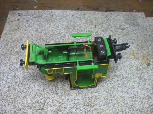

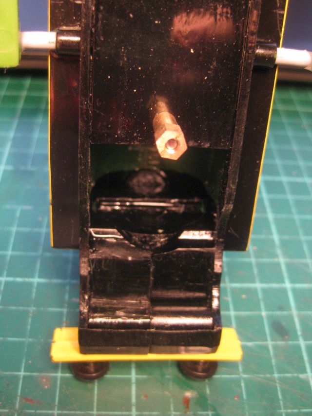

Hi,
I have been back from far away places for a bit
not sure I like the temperature here though.

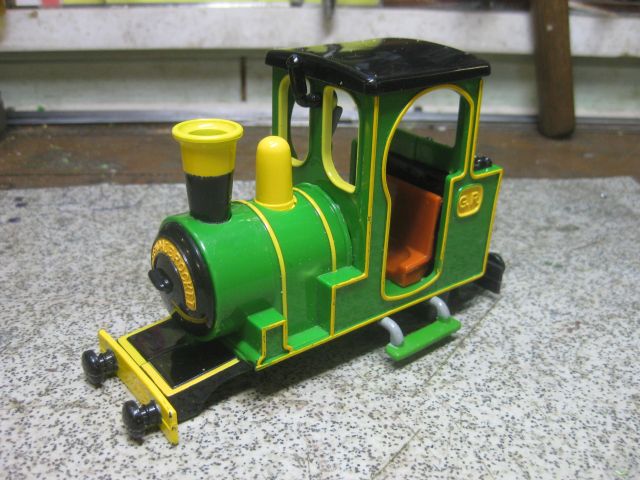

I have part made a chassis for the Glendale Rocket Mk.2 it is much the same as Mk.1 though it has a slightly shorter wheel base and is an 0-4-0 which gives a little more room. There is more weight to balance the extra battery in the smoke box and a slightly larger motor is fitted.
I might get some more done tomorrow.
Regards Tony.
