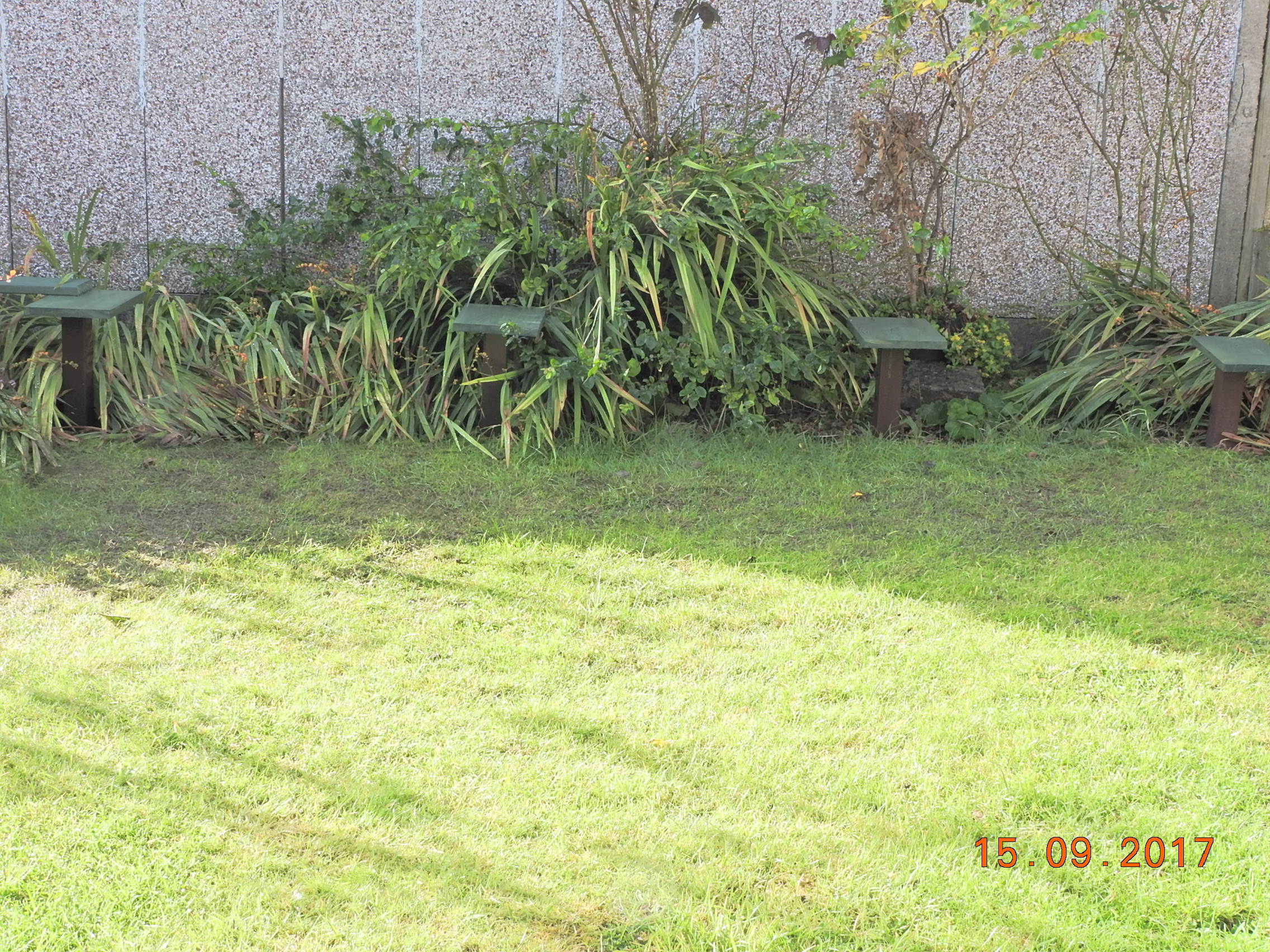

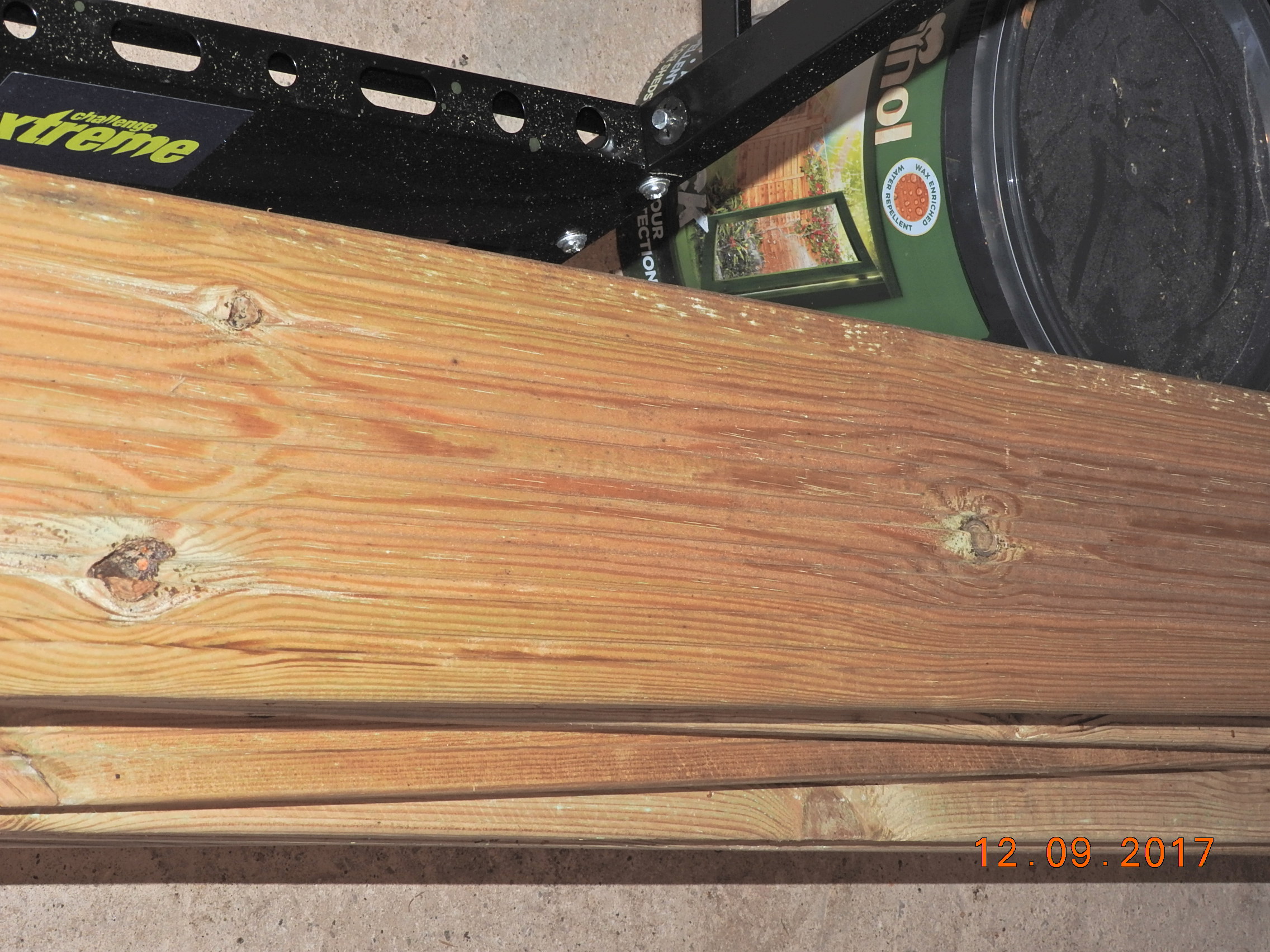

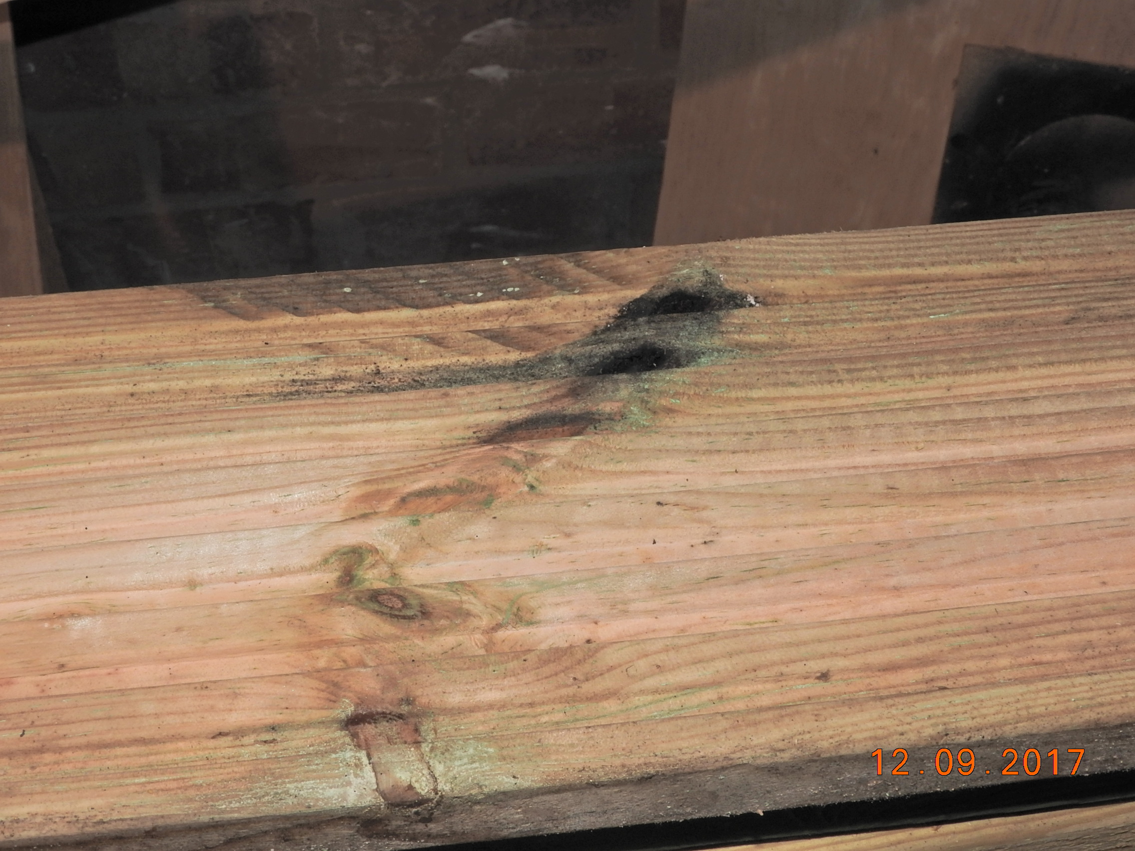

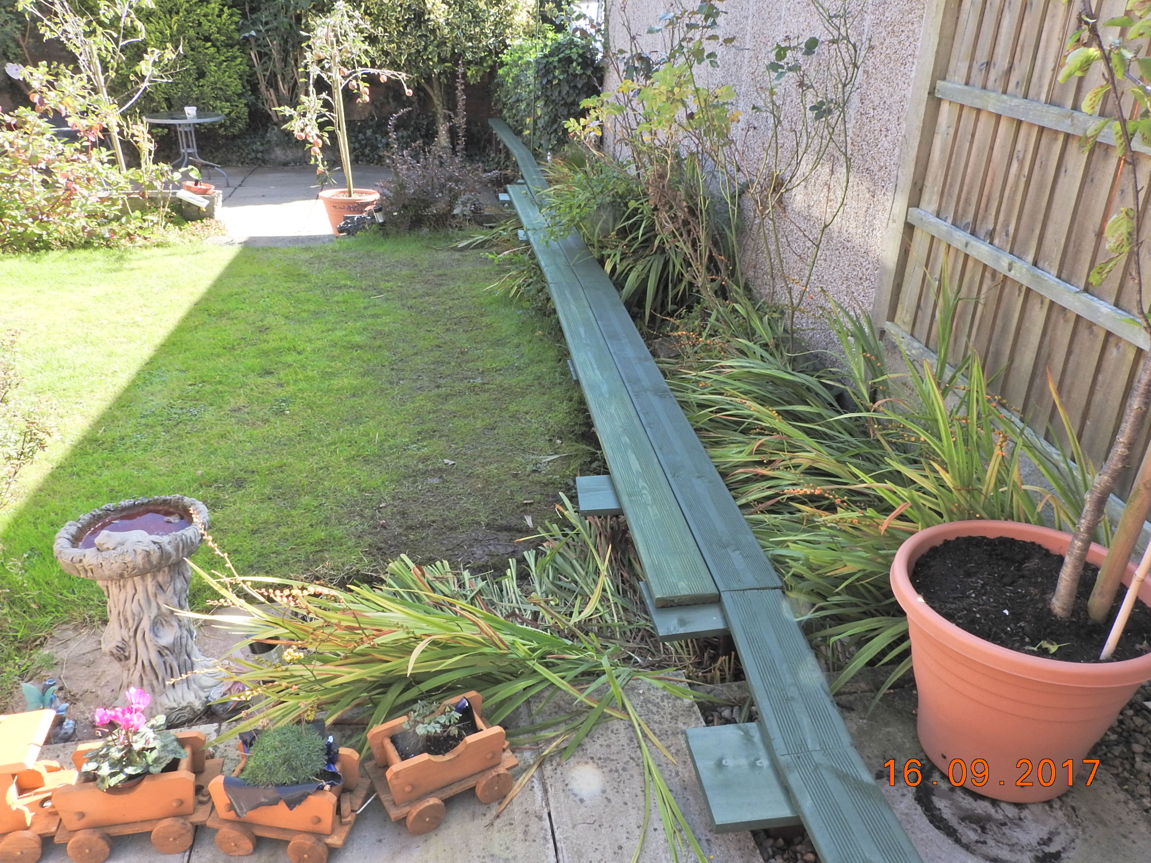

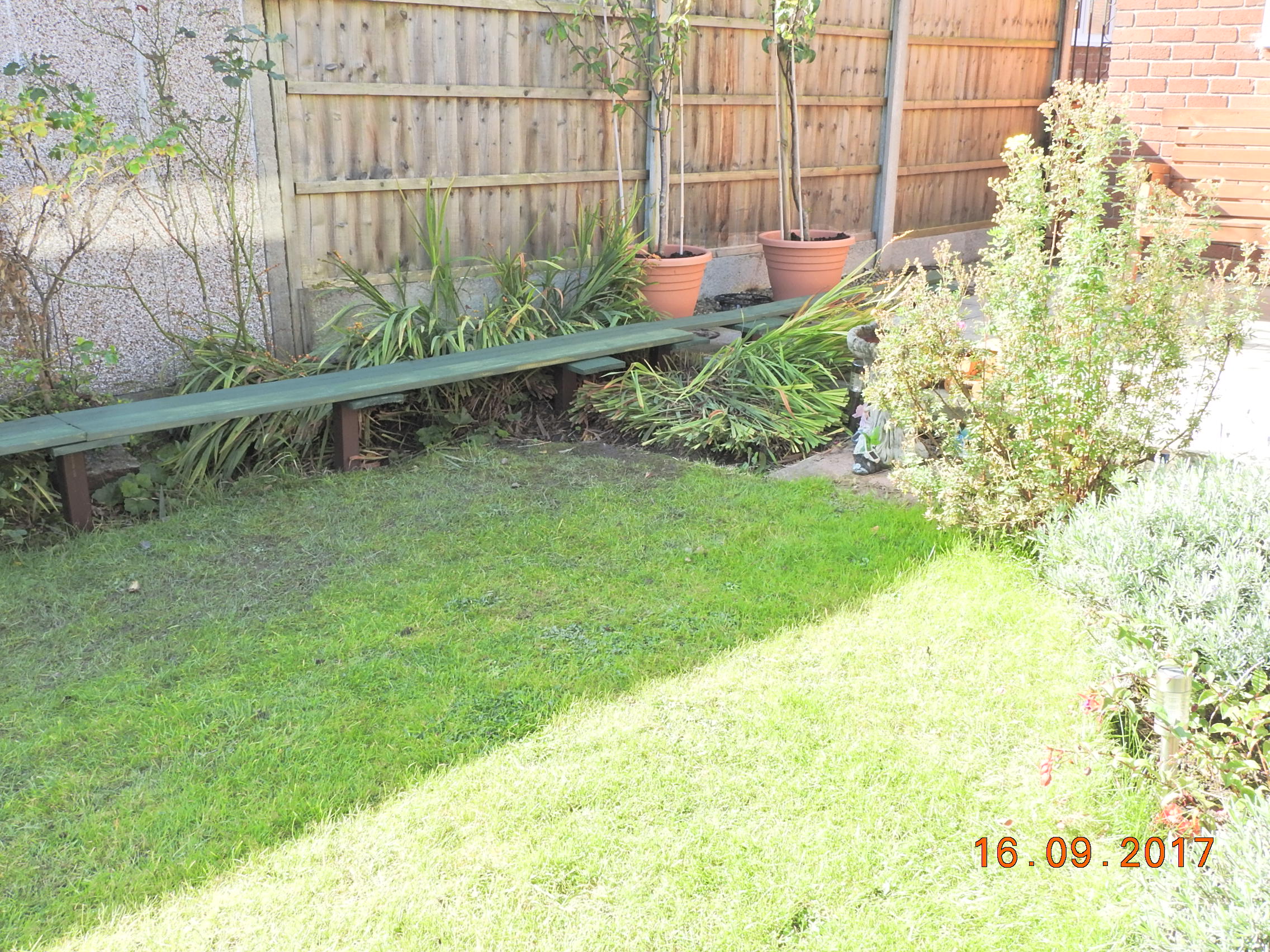

I bit of progress done at last a break in this rubbish weather here, been raining on and off (mostly on) for 3 weeks now. Got the board on Monday, not happy with it, my fault for buying blind online.
These are the good ones. They came wet and they should have been pressure treated, but they haven’t. So i have needed to wait until yesterday for some of them to dry out. A few photos on were i am at the moment, the photos show you how badly the lawn is coping with all this rain, it as never been this bad. Clay soil doesn’t help I’am afraid.

The colour of the boards and supports blends in well with the garden.

I wouldn't worry about the knots in the boards they really don't matter. It's twists that are both a disaster waiting to happen, and difficult to do much about.

A fine beginning. It won't hurt to slosh plenty of wood preservative on all of it, even the bits that are pressure treated.
It's worth checking carefully what you buy as some fence/shed paint is just that with no fungicide or anti rot treatment in it at all.

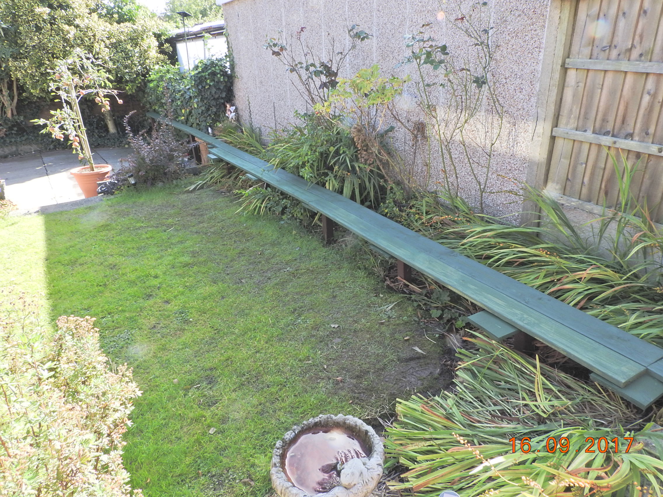

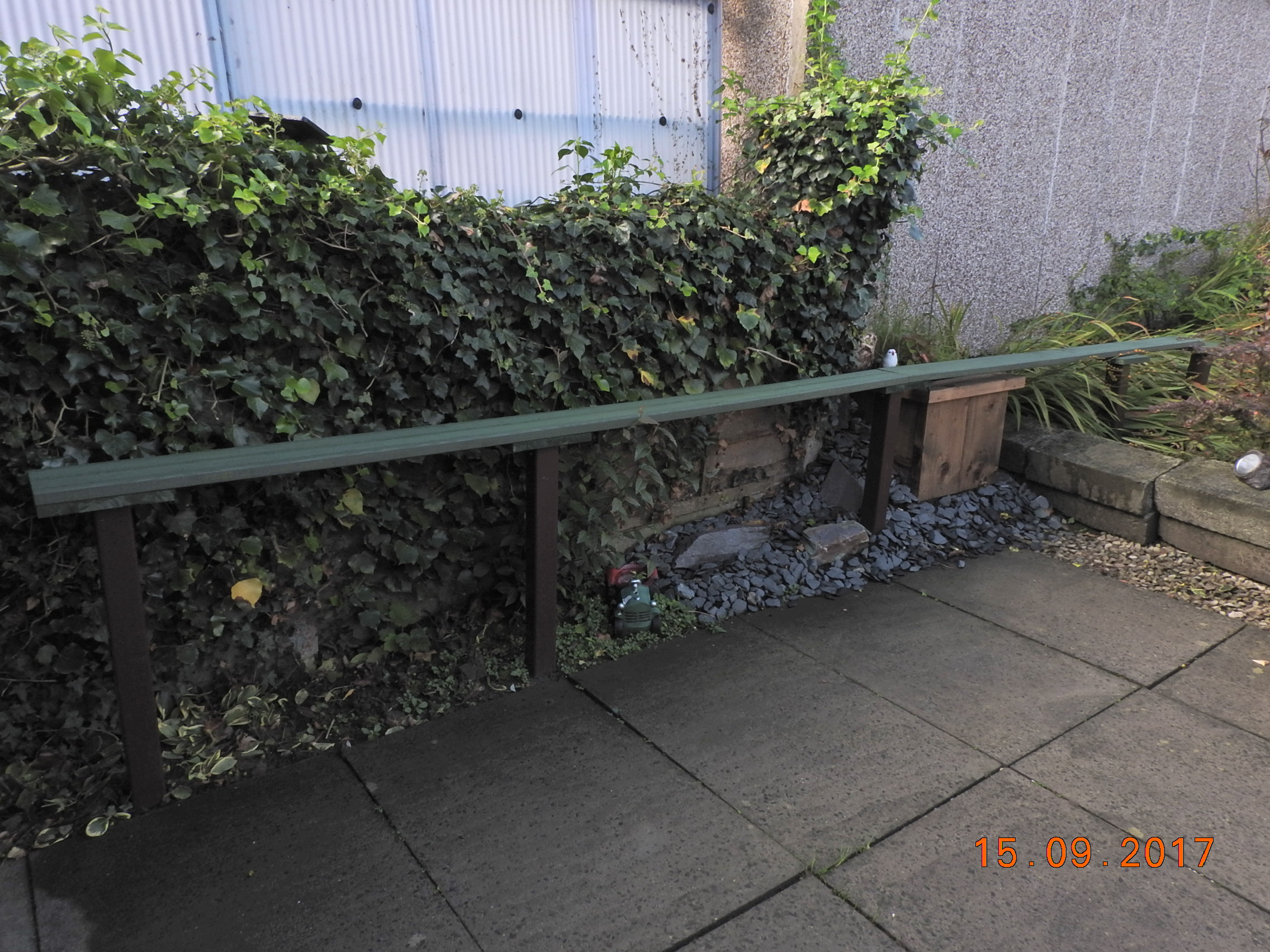

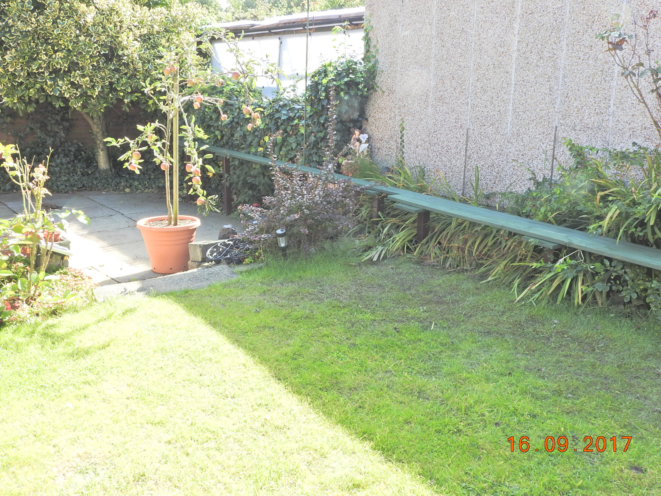

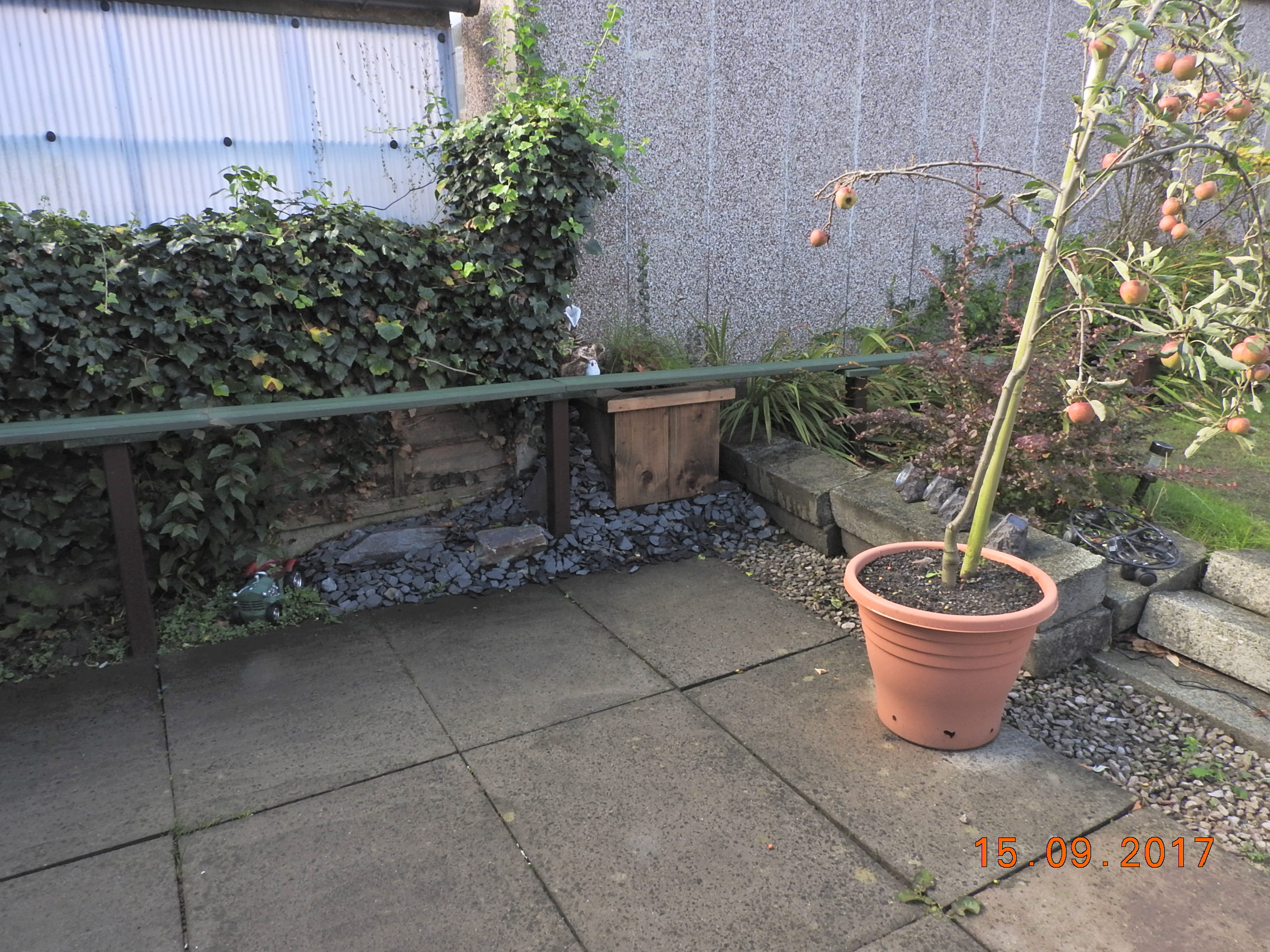

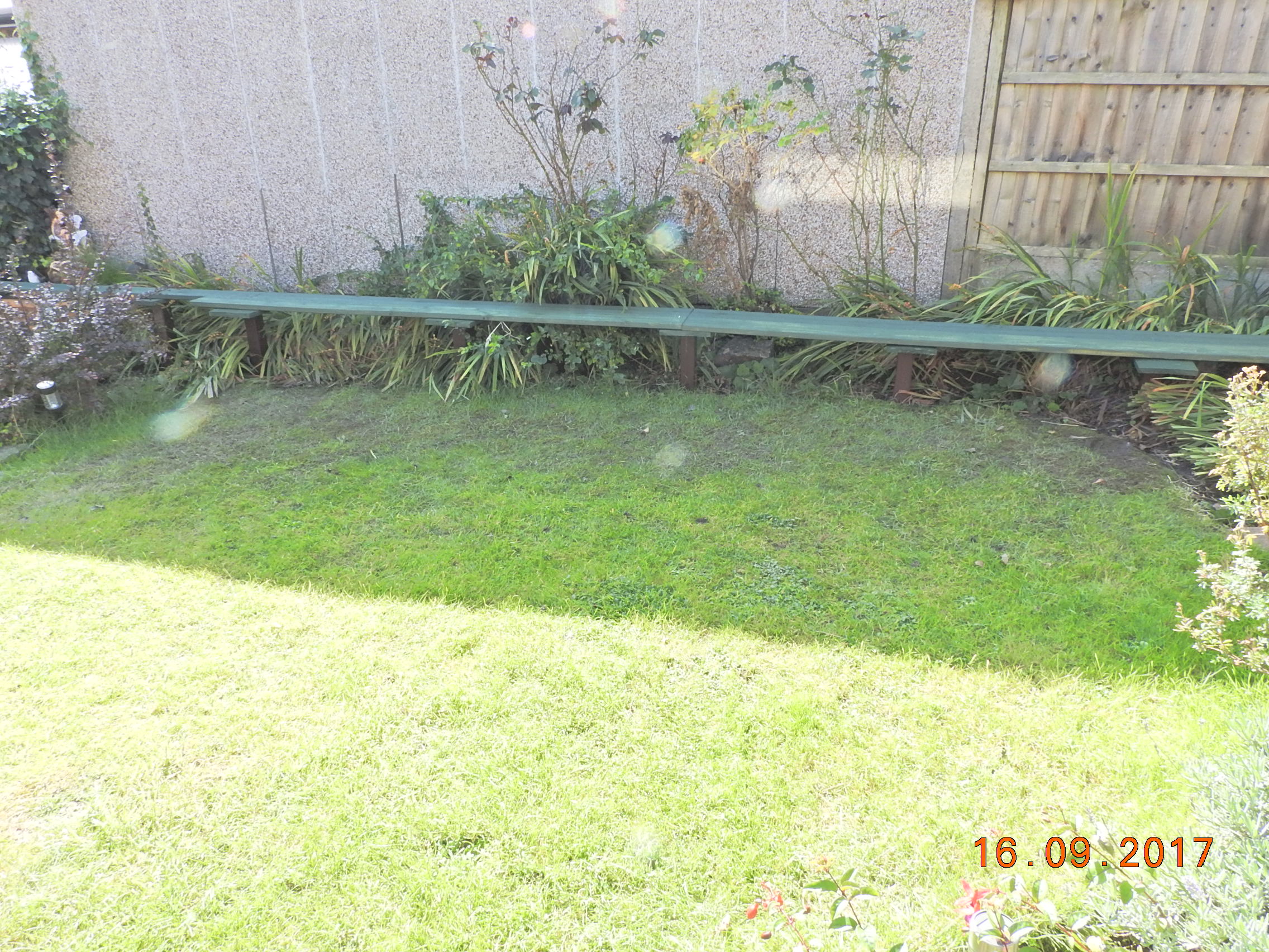

Some progress been made this morning, one of my son-in-laws came to visit this morning and after hearing what caused my visit to the hospital offered to finish putting the rest of the boards on down the side by the garage.
End of the line where the station will be.
The inside board is for the track that will go around the Garden
At the far end i am hoping to put a bridge that will span at least 4’ and the end nearest will go around the birdbath.

I would screw it down with just enough to hold it in place. But allow enough room for movment. Use brass screws if possible to avoid corrosion problems. Leave an expansion gap at each rail joint.

Those timbers look like decking which is heavy duty and treated so should be worth the investment. You are fortunate in having assistance on hand. My own track is screwed down by drilling a few sleepers and countersinking screw heads flush with the surface. Eventually they will tone down and blend in with surroundings. Expansion gaps are essential, especially at this time of year as the heat of Summer (that was a joke!!!!!) will certainly cause distortion.

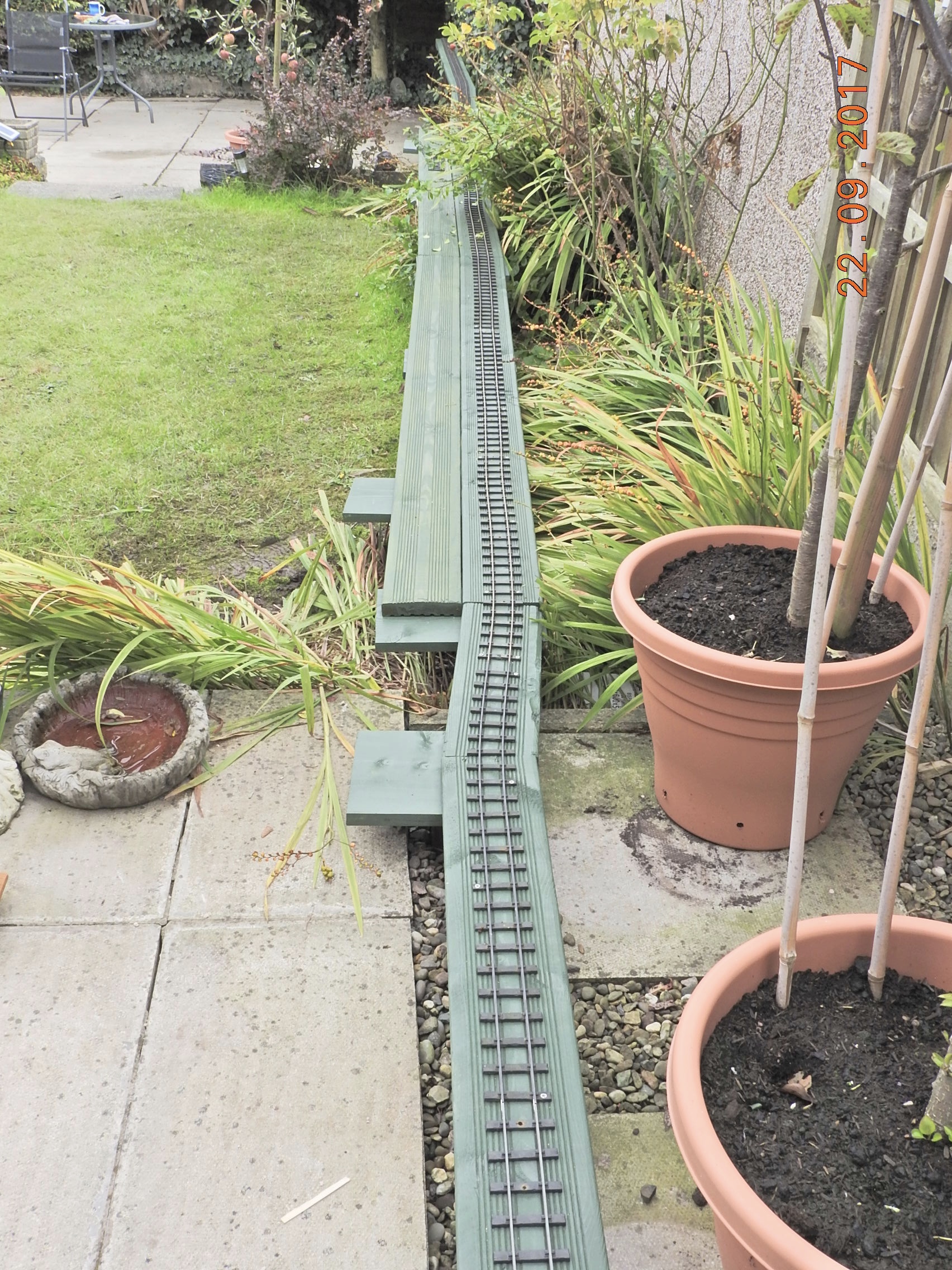

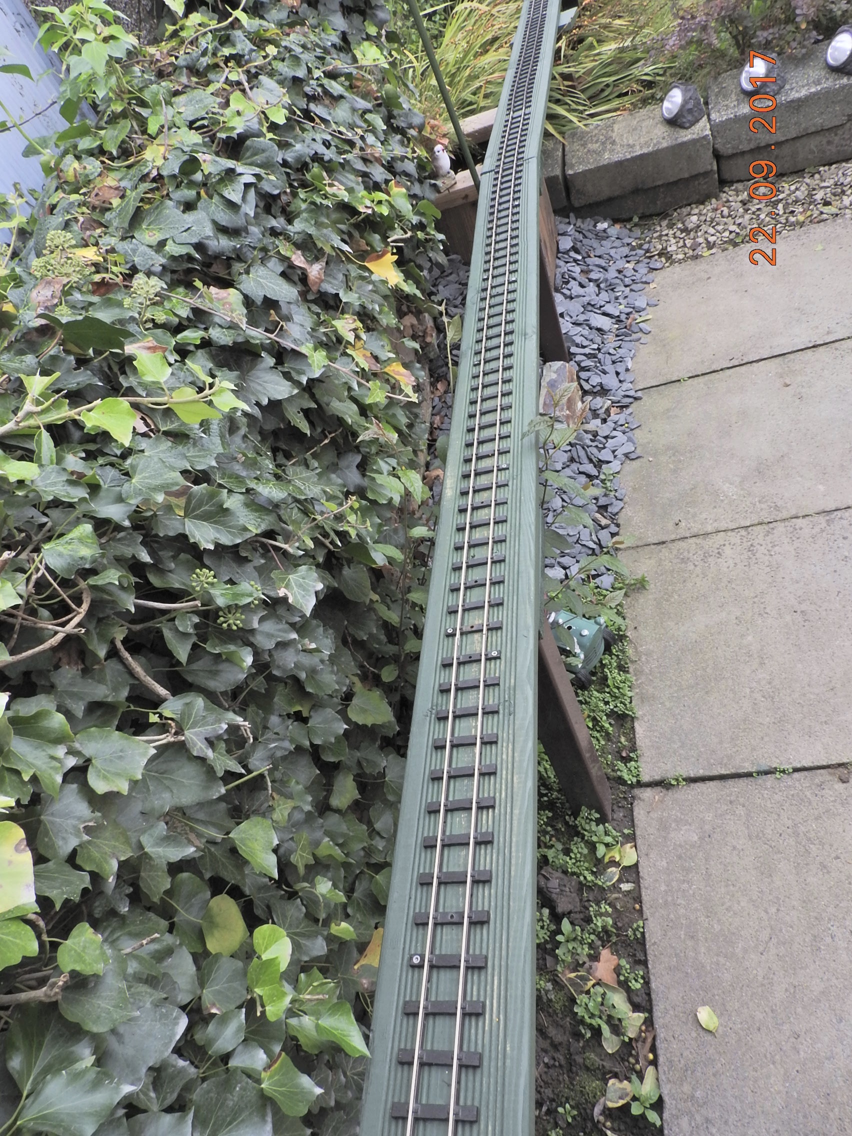

Well laid some track today after my little excursion yesterday for my birthday, Anne is getting into the garden layout, she has bought somethings for the disused slate mine, a fork lift and figure, i haven’t got the heart to tell her the figure is a driver and the fork lift doesn’t really go, but i am not going to criticise her for doing it, at least she is taking an interest in doing something on the layout.
Some photos of the track
I think it looks ok the way it runs slightly of centre, it was done like that so it didn’t look to straight.
