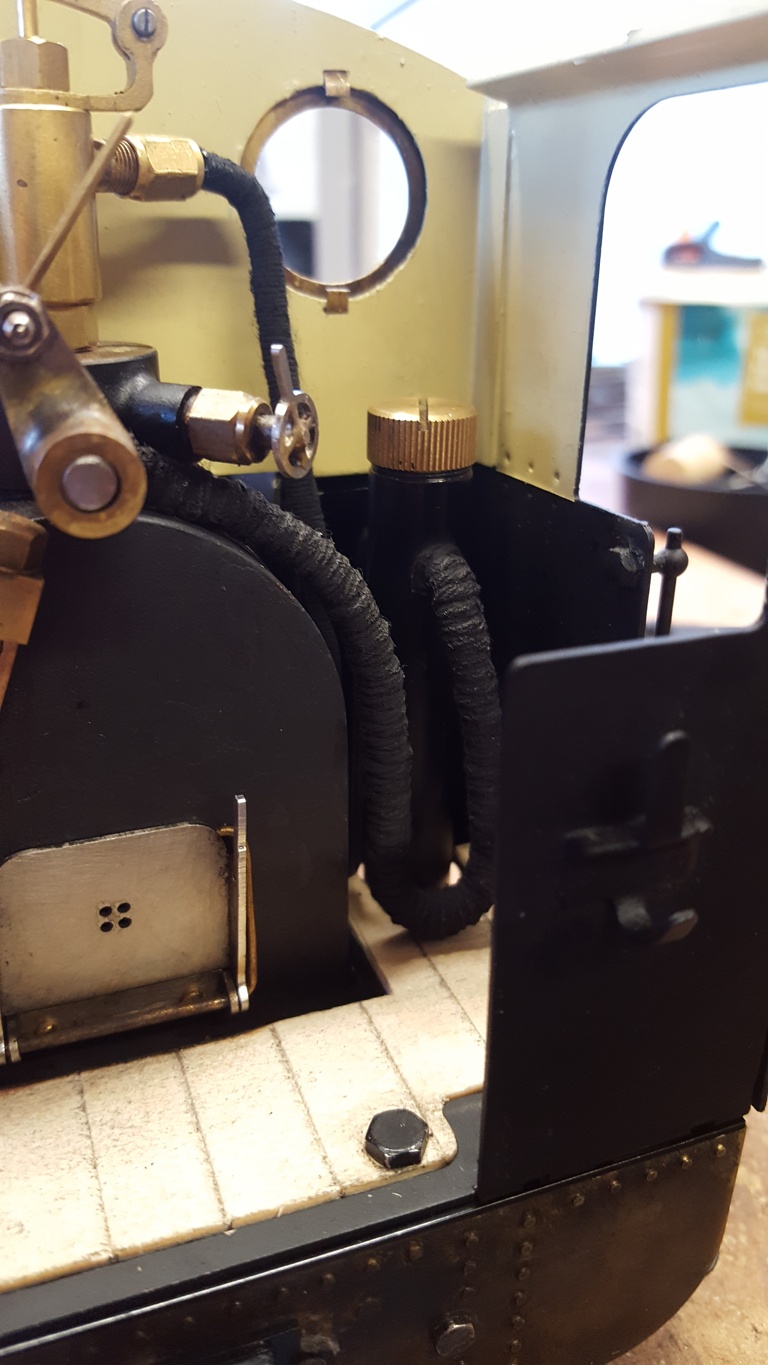

Having seen the length of the steam line from the lubricator to the steam chest, I'm not surprised that you're getting a "wet front end"...
I will be amazed if that doesn't make some difference, TBH?
Keep us in the loop, please.

Hi Tom,
That's a long loop of tubing before the lubricator, I'm inclined to think it's unnecessary

I see your point mate but the reason it's like that is to allow for the whistle pipe work which I am going to redo and will possibly lag as well?dewintondave wrote: Wed Jan 31, 2018 9:29 am Hi Tom,

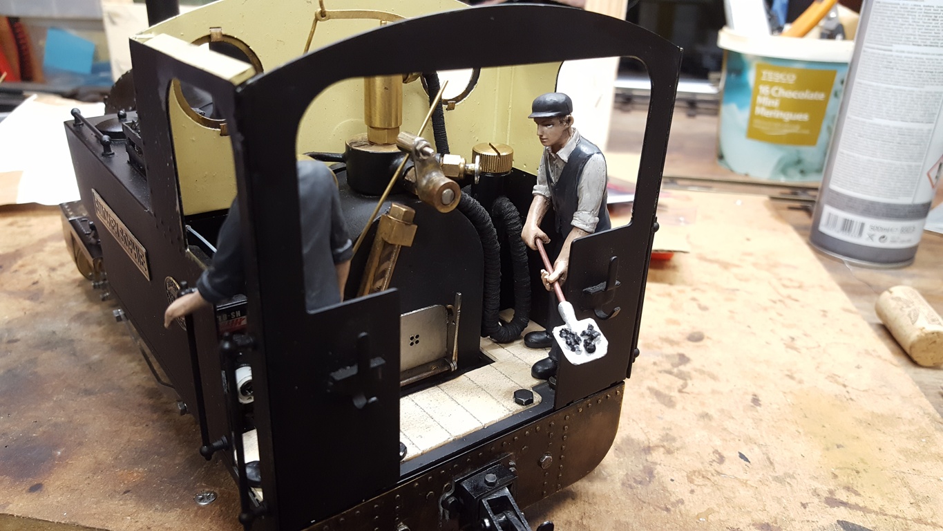

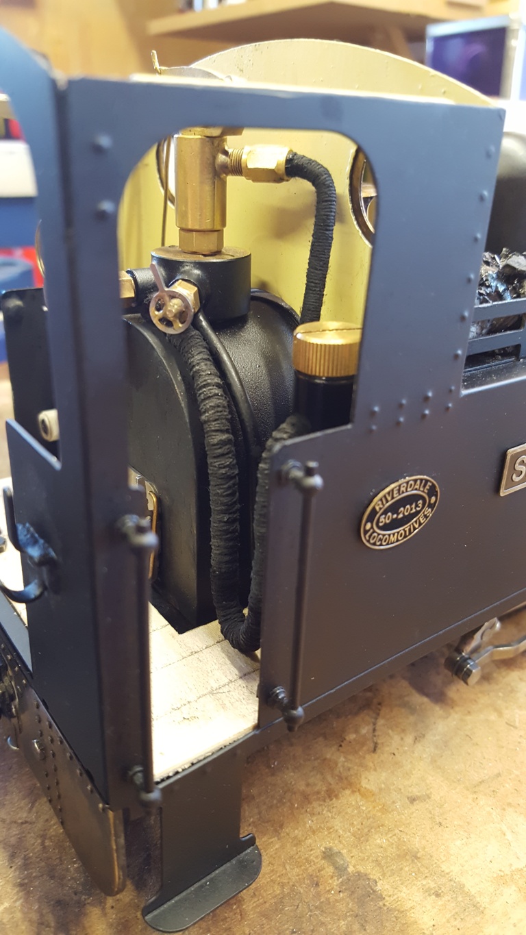

Ready for testing:
The whistle pipe has been replaced with a new one so it does not show in the cab front window. The pipe lagging for the whistle is purely for show as it's much thinner than the steam pipe lagging you see in the pictures.
- Posts: 1890
Re: Wet exhaust coal firing
That looks well done Tom, like the black. I imagine there's a yard or two of cord in that lot.

Looks good, and it can't possibly do any harm and will probably have a positive effect?
And either way, it looks great.

Neatly done. The black lagging makes the pipework less obtrusive, but I'm not sure how long the cab floor on a coal fired loco will stay that colour...........tom_tom_go wrote: Sat Feb 17, 2018 8:06 pm The whistle pipe has been replaced with a new one so it does not show in the cab front window. The pipe lagging for the whistle is purely for show as it's much thinner than the steam pipe lagging you see in the pictures.

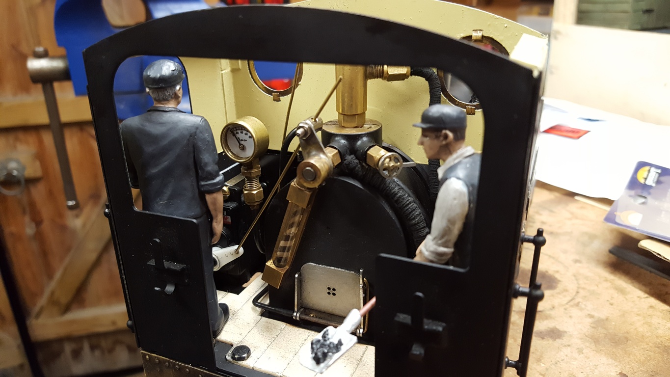

Didn't your fireman like those bits of coal, thought he'd heave em out the back!
PS it's hard when you have to get non scale things like a coal shovel, into a scale cab!
The size of the coal pieces would not last five minutes in her fire!LNR wrote: Wed Feb 21, 2018 1:34 am Didn't your fireman like those bits of coal, thought he'd heave em out the back!![]()
I don't like the shovel so might change it for a Locoworks brass one I have which has been chemically blackened.
Maybe if I fit a tender he would be digging the right way

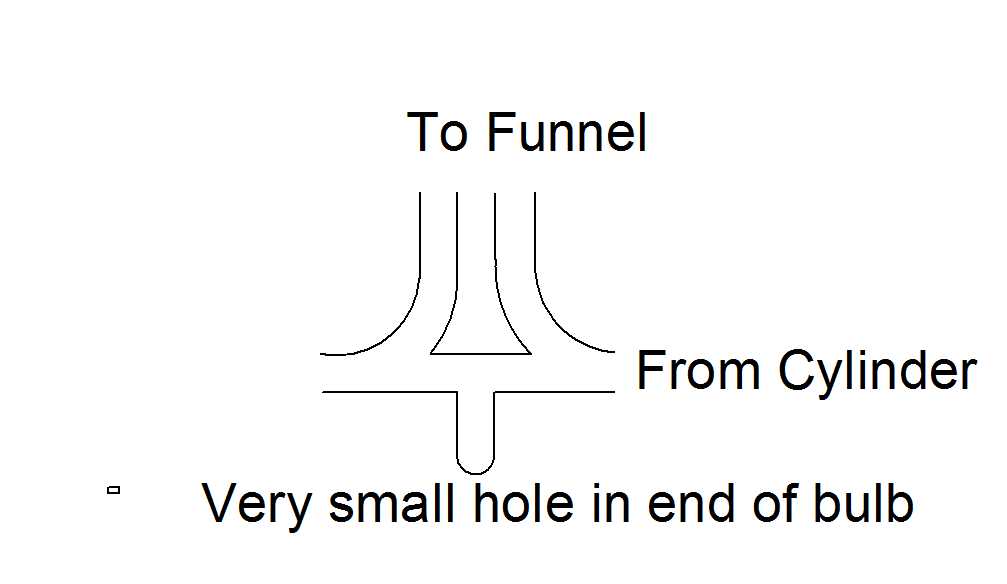

I attach a drawing of a theoretical solution to Wet Exhaust.
I have done no experimentation on my theory, and have no qualification whatsoever in the field.
Per the drawing, the cylinder exhausts are joined at the lowest point by a T junction. the bottom of the leg of the T is blind but for a very small hole. (how small to be determined by experimentation) The theory is that the condensed water will accumulate at the lowest point of the T and be expelled by exhaust steam pressure. The hole must not be large enough to let excessive steam out. An alternative would be to put a leg on each exhaust and not connect them.
Perhaps someone has tried this before? did it work?
Tim
Tim
Hi Tim,
I had a similar idea but this will impact the exhaust draft.
The hole needs to be temporary to clear the condensate so you would need a servo or lever to open and close it.

I was hoping to find a hole size which would not expel much steam but at the same time pressure the water that has condensed at the bottom of the tube. Maybe the water tension would prevent the water expelling through such a small hole?
Tim
Tim
