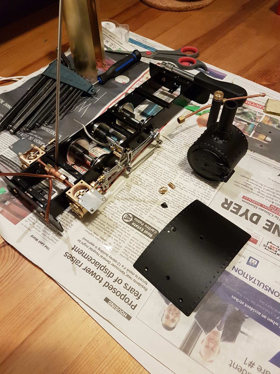

Lots pf progress last week. As of Sunday night, this is where I'm at.
Rods and cylinders fitted. The valve gear is fitted to one side, but unfortunately, in my enthusiasm to make the most of my having the apartment to myself Friday night, I failed to heed the warning of the instruction manual, overtightened the expansion link bush, and broke it. So I've only been able to fit the valve gear to one side, and I'll have to order up a replacement from Roundhouse in the morning...
In the meantime the smokebox, roof and lubricator are all painted in Plastikote matte black engine enamel. Tomorrow I'll see if I can pick up the top colour. I'm hoping to go for something like FR Victorian Maroon, but getting something in a BS paint code isn't going to happen here without going to a very specialist auto body shop, so it'll be something that looks 'pretty close' to my eye.

Good luck with the paint colour Ted, I tried for the same colour when painting my Hunslet, biggest trouble I found was getting an auto colour that wasn't iridescent. Shame about the link bush, that would try my patience waiting for a replacement.

Its looking good, yes one must be careful when tightening anything that is hollow, be it a banjo bolt on the steam turret or the bushings on the expansion link frame bushing. Looking good otherwise! Can't wait to see the body color. My friends lined black Pearse Countess is due here to my house today Have to regauge it for him to 45mm. My own green Pearse Countess will be here later this week or next, along with 2 Brandbright bogie coaches all done up and filled with people. Cheers Mike

big-ted wrote: Mon Mar 27, 2017 6:21 pm One of the rear cranks seems like it's not on completely straight, despite my best efforts to line the g-clamp up correctly. We'll see if it binds with the connecting rods on. If so I guess I'll have to bring it in to work and use the big vice (with rubber jaws!)
I don't want to piss on your parade but this may come to bite you in the bottom later so I would get it sorted now by using a vice with rubber clamps as you mentioned.

Afraid I agree with Tom completely Ted. The rear cranks have the long crank pin so anything out of true is excentuated, even worse than the other cranks. Personally I would be taking the offending crank off, and examining it under magnification if necessary, to make sure you haven't picked up a corner or burred it in some way. There's not a lot of metal in that area and it is easy to drag a fragment of metal down to the shoulder to prevent the crank pulling down square.

I'd also agree with Tom, if you haven't yet sorted out that axle crank, square it up now, while you can still get at it without dismantling the loco. Not sure if rubber jaws would work, as I use aluminium safe jaws on my bench vices. A couple of blocks of wood might be better if you don't have aluminium jaws available.

Thanks all. Good to know the paint on the frames should be ok. Yep, the crank was removed and straightened. Bizarrely, pressing it on as far as it wanted to go resulted in it becoming crooked. I pressed it on with a vice as far as I could without it getting crooked, tightened down the screw, and that seems to have held it straight. Trying to wobble the pin by hand couldn't budge it, so I'm hoping it's ok. I do still worry that the crank pin screws and crank pins themselves would benefit from some loctite but, again, I'm doing everything by the book now!
Smokebox now assembled and footplate painted, but I can't really do much more this weekend since I'm still waiting on the expansion link bush. I could start soldering the body but I need to practice on something first since I've not soldered with a torch before. I think I'll try and build another tin plate tipper wagon since I have plenty of tinplate saved up.

Buffer beam and buffers fitted to loco, and cheesehead screws painted with Humbrol enamel to match the buffer beam. Boiler and smokebox just rested on for now whilst I wait on the expansion link bush for the other side.
