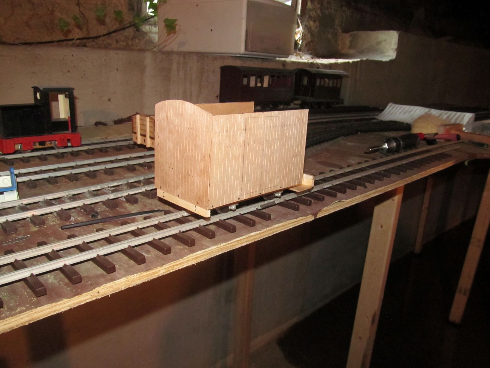

by IrishPeter
Here goes...
Sentry Box Brake 1
Sentry Box Brake 1
Sentry Box Brake 2
Sentry Box Brake 2

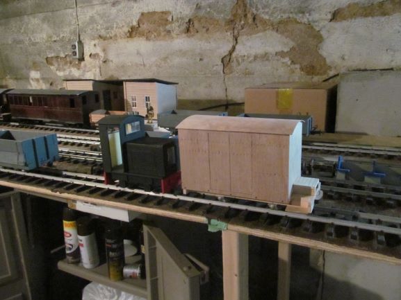

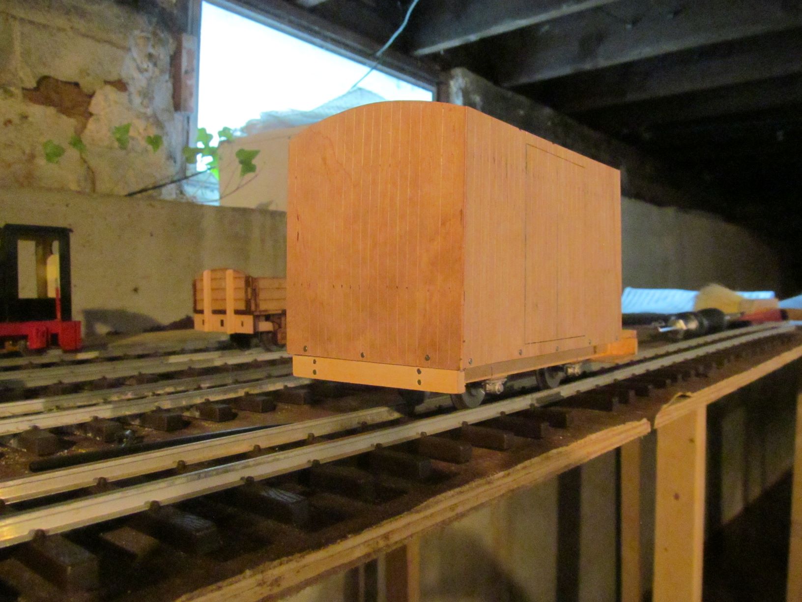

Re: Rolling Stock for the Far End Tramway
Posted: Wed Nov 28, 2018 5:10 am
by IrishPeter

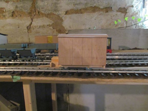

The sentry box van seen broadside on. Small rolling stock like this comes from the early days of the Far End Tramway so far as thinking is concerned
Broadside shot
Broadside shot

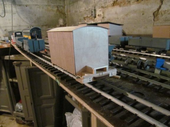

Nice three-quarter shot. Not sure about the extra step on the balcony.
Van 3/4 shot
Van 3/4 shot
Little Black Diesel No. 2 and the Sentry Box Van
Van and the usual motive power
Peter in Va
Posted: Wed Nov 28, 2018 8:15 am
by FWLR
Nice van there Peter. Can't help with the step....it does seem a bit odd...But it's your build mate and if you like it that's all that matters.
Posted: Thu Nov 29, 2018 2:25 am
by IrishPeter
I did decide it was a bit odd, and knocked it off. The original idea was to make the floor of the sentry box high enough that an ordinary height guard could peer over the top, but the van sides are 96mm, and with the curve of the roof that ended up being 104mm in the centre, which meant that even with the step, the guard would have had to have been considerably over the Victorian average of 5'6" to be able to peer over. Instead we'll just make him a nice little sentry box to keep the worst off. As things develop a bit, I think the small stuff will end up being allocated to maintenance of way duties.

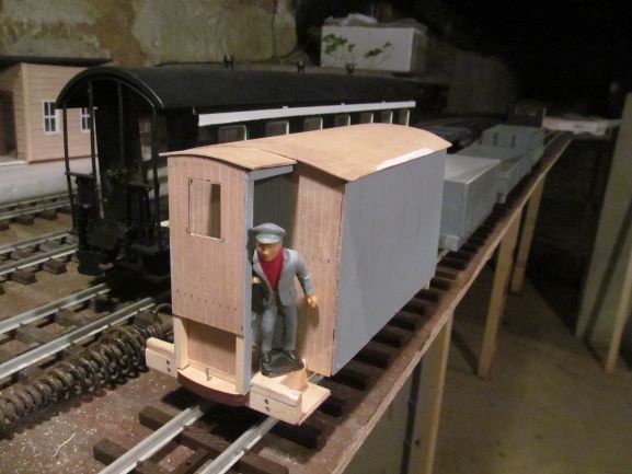

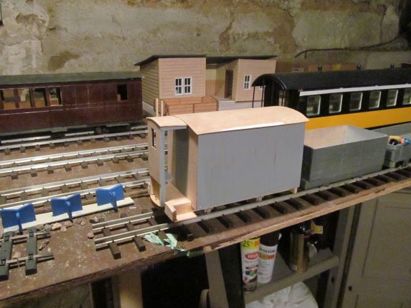

Posted: Thu Dec 06, 2018 4:50 am
by IrishPeter

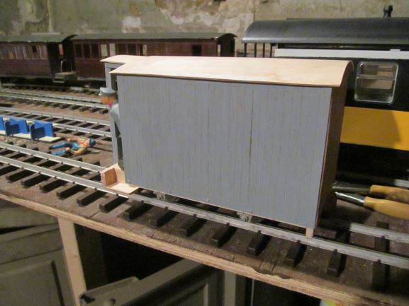

The sentry box van is somewhat further along. Here is the evidence...
3/4 View
3/4 View
What the shunter sees...
End View
End View
Another view...
Ole fills in as the Guard
Handrails and faux brake mechanism are still needed, as Ole needs something to hang on to - he is a bit fond of a beer and a bump (repeat as necessary until the pain eases) when off duty. He fell off a freighter about five years ago and has been helping out on the railway ever since. I am also thinking of adding some curtains to help keep the rain off.
Side View
Side View
Somewhat scruffy grey paint is a hallmark of the Far End, goods vehicles are well maintained mechanically, but the aesthetics are a bit lacking as they are needed back in traffic earning money. I will paint the ends of vehicle red, to give drivers something to aim at.

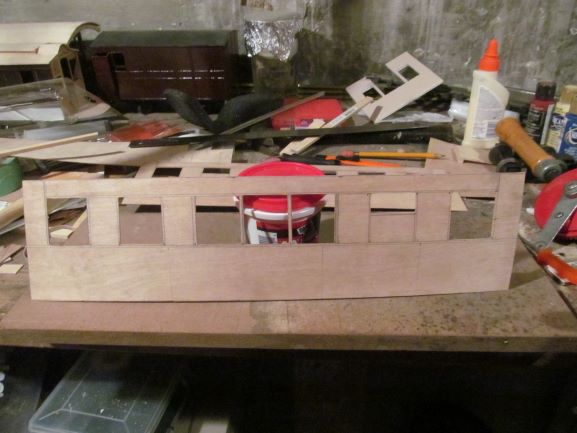

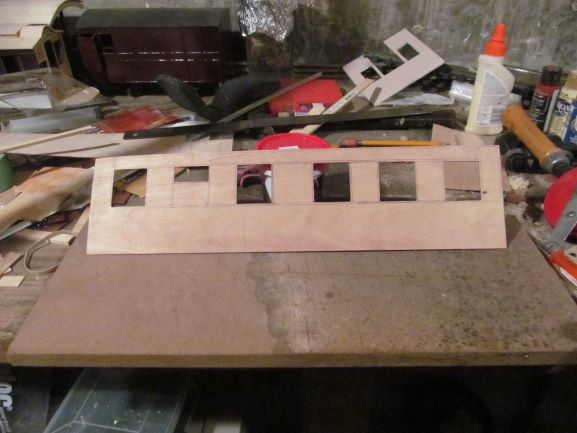

There is also another project down in Nibelheim, and this is to increase the quantity of available SM32 carriages from one to two.
Carriage - left
Carriage - left
Based on a carriage built by Sachsishes Wagenfabrik, Werdau, in 1926 for the SAR/SAS narrow gauge. The original had a roughly 8 metre body on a 30' frame, so that fits in with the longer of my two standard frame lengths. The frame length was dictated by the SAR-SAS specification, which was basically in Imperial measure, and the rest was left up to the builders - in this case a German firm uses to using metric. The SAS NG had a mix of British and Dutch/Belgian/German built stock due to the peculiarities of South African politics as when the Afrikaner parties had a share in running the government the orders tended to go to Hannomag, Cockerill, Henschell, basically anyone who was not UK based, as payback for the second Boer War.
This carriage has a small 1st class compartment to the left; then the loo - this was a long distance carriage; and finally third class to the right. I suspect the prototype was probably an all-third or a composite without a loo originally, however, the sheer length of the Avontuur branch would have soon required the management to provide facilities, or for train crews to be very patient at the main stations! I went for the German built vehicle because I liked the look of it, and so I would not have to cut 18 x 4 windows (or 16 x 4, if it had a loo) to model the British-built compartment/semi-corridor stock. The next photo shows the other side. The two small windows were opposite one another, so there was either one large lavatory compartment, or more likely two, one for each class. The odd thing is That I have not been able to find the water tank for the flush, so I might be wrong about the purpose of the compartment with the small windows.
Carriage - t'other side
As you can tell. My workbench is a disaster area, and I had a fairly profitable day off.

Posted: Thu Dec 06, 2018 8:42 am
by FWLR
Like the way you have Ole peering out of the van, very good.
The new build looks very interesting..... :thumbright:
