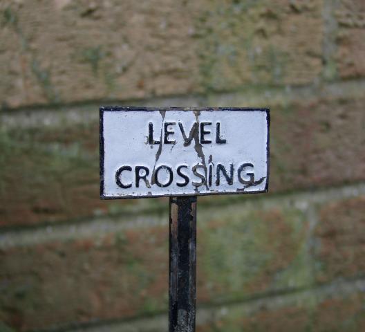

Attached is an example of some that I etched a couple of years back, using Ferric Chloride ( from Maplin).Big Jim:115769 wrote:Alan, I doff my cap to you Sir!
....Come on folks have a go and post your results and tips, ...
It's a bit battered, having been trodden on a few times by clumsy 12":1ft feet that can't read, hence the flaking paint! It is soldered to a piece of brass BH rail as a post.
As for tips: give the back of the work piece a blast of any old rattle can paint. It will stop the etching process from wasting itself and speed up the etching of areas you do want removing.

FWIW, I wrote an article for the old "Model Railways" magazine back in the mid 80's, about DIY etching. I actually etched a complete 4mm coach sides and ends again using Ferric Chloride. The masking for that was done with Humbrol paint in a bow pen, not something I'd recommend really!
