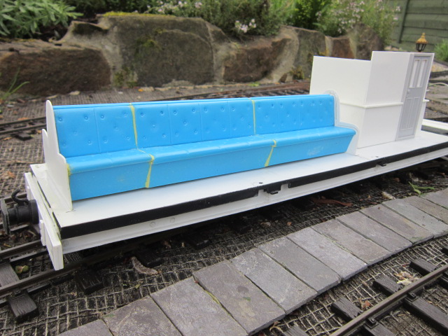

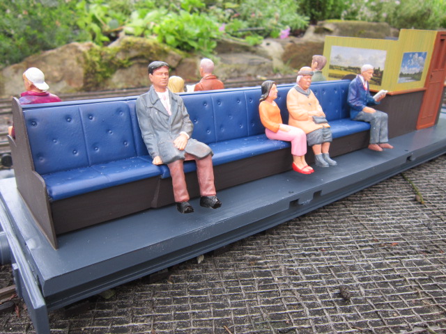

LNR wrote: Mon Nov 27, 2017 10:45 pm Buttoned padded seats, now that's the thing!!
I can see you get most satisfaction from DIY but there is a helping hand available should you choose it. I fitted out my Observation Car with padded sets which I bought from IP Engineering. They are cast resin in blocks of four seats and easily modified to suit your requirements....
Saves a lot of work.

That looks very realistic Peter. Certainly worth thinking about.
D.

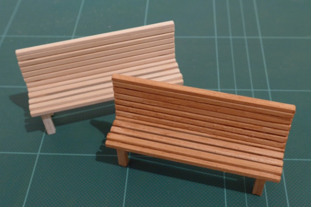

River Lin wrote: Mon Nov 27, 2017 11:07 pm
I can't make up my mind whether to stain them a bit darker but i quite like them as they are.
D.
David,
Personally I do think they should be a bit more coloured, not necessarily darker as such.
There ought to be a series of marks where the bodies sit most, i.e in the 4 corners and then couple in between those?

River Lin said,
I don't know about the UK, but all the slatted seats I've seen are a varnished golden grain colour if that makes sense. It's a while since I've used Obechi but isn't it a fairly pale timber. Perhaps a golden oak colour would best represent many coats of varnish. As ever colour is a very personal choice.
Re: NWNG Railways No.1
Post by FWLR » Tue Nov 28, 2017 9:23 am
You are correct about the UK, but does it always have to be done the way people expect them to be, I personally like the lighter colour, it stands out a lot more, for me anyway. But a little darkening were people have sit would look great too, it shows they have been sat on at least. :thumbright:
River Lin
Posts: 411
Location: Leicester
Post by River Lin » Tue Nov 28, 2017 7:33 pm
Hi all and thanks for the range of comments
I think that is much better. A much more natural oak colour. They looked stark white against the teak interior.
This is antique pine before sanding and a sealing coat.
D.
David T.
Posts: 5726
Post by Peter Butler » Tue Nov 28, 2017 7:58 pm
Far better in a slightly darker colour. That gives them a more substantial appearance and more in keeping with the original timber used.
