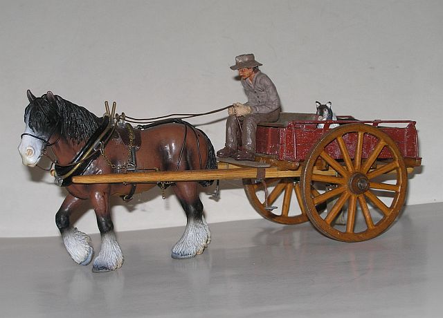

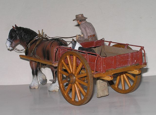

So, next we have a little more horsepower. The dray was built before the Bakers cart, and in order to do the harness,
I used black and brown wire, which unfortunately looks like, well, wire. I hadn't tried the leather with glycerine at this
stage, and wanted reins etc. to sit where I put them. Once again wheels of ply, steel tyres, no springs on these working

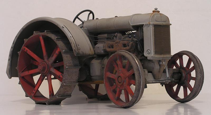

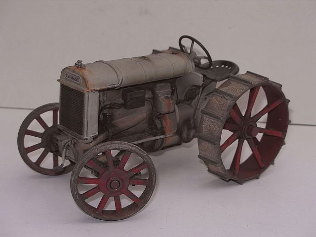

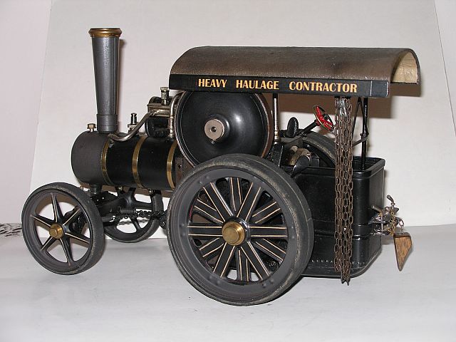

drays, only the bend in the seat board. It wouldn't be a dray in Australia without a Cosco Fertilizer bag hung underneath on the axle for the horses nosebag. This next one is not for close ups. Its origins are obvious. I measured up a Fowler B6 and found the Wilesco pretty close in
all except width if I remember. Disguised with road tyres, flywheel cover, water tank, scale steering wheel, tow hitches
front and back and a suitable canopy along with loosing the blue colour it might pass at a distance. The Fordson has been covered before, much molded on detail removed, to be replaced with separate items, wiring, control
rods, steering wheel, crank handle, and a paint and chip job.
With guards as they mostly were in Australia, as the guards were to provide some safety when the tractor reared up on its
hind wheels on striking hard ground with a plough. Unlike England our topsoil is measured in inches, not feet. Without guards, it appears much smaller, being 1/16th. scale it should be.
Only one to go.

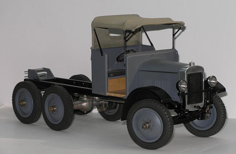

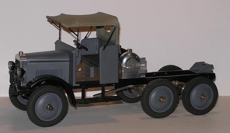

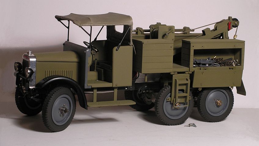

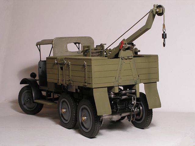

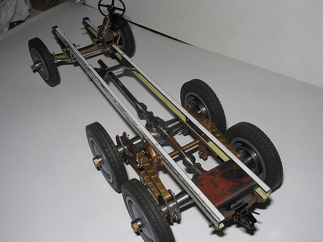

Last one.

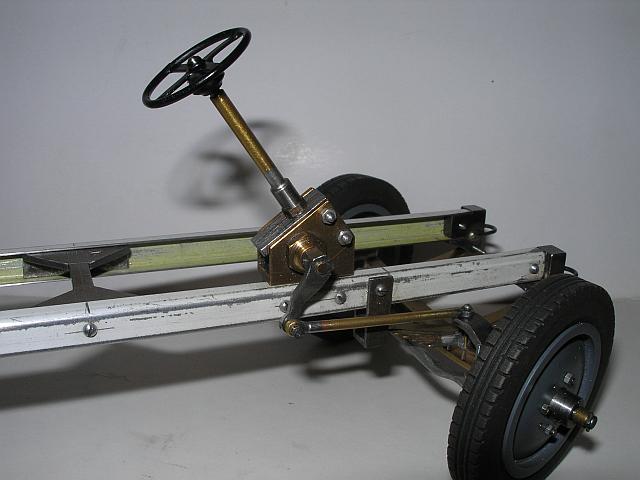

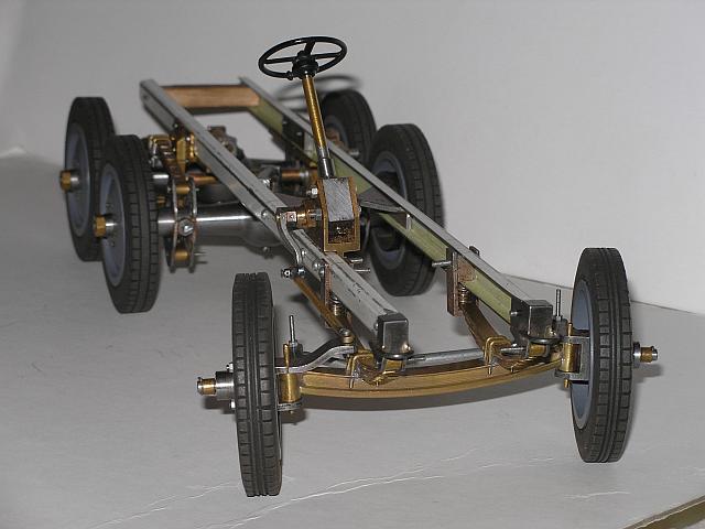

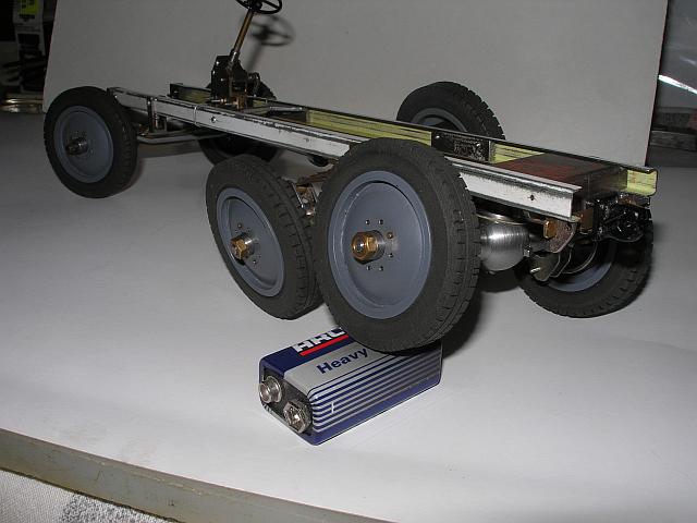

This came about from reading an MOD requirement for an articulated twin axle suspension for trucks.
On finding patent drawings and following it through I was missing something. I started building, and finally found the
missing action of the puzzle. Thornycroft used this suspension, plenty of info on the web re measurements etc. so the pics. tell the story. Chassis, steering, front axle ( a piece of brass track) rear diffs and axles set up with tyres machined from plumbing grommets. Close up of the steering box, drag link etc. Rear view showing the patent suspension, upper and lower spring sets brake drums prop shafts and the all important gimbals (the missing link) I actually achieved slightly more articulation than the patent called for as this pic. shows. each axle had to be capable of moving through so
many degrees ( 18deg. I think)with out affecting the other axle. on with body work, starting to look like a truck, hopefully a 1927 Thornycroft A5 RSW (rigid six wheeler) Building the large winch that the army fitted when these were used as gun tractors (became the Tartar) it's front and rear capable. Jumping ahead in time frame,( my railway) those conversant with these things will know that the body is straight off a WW2 Scammel .
Crane works, full recovery gear, snatch blocks, slings, ground spades, anchors, rigid tow pole and pintle hook all carried in the lockers
or stowed on board. Not finished, but then I never finish anything, and it's a bit dirtier these days.

Wow that is a magnificent project in it's own right, never mind all the other aspects of your railway. You clearly must have at least 36 hours available in each day in your part of the world. Would you please expand on your intriguing statement that you turn your tyres from plumbing grommets, suitable tyres have always been a real problem for most model vehicle builders.
- Posts: 1888
Re: A Quiet Sunday
Hi Phil,
Talking to a friend at the GSSU who was into tether cars, said he turned wheels up from grommets, said he'd bring some in next day. I got six and needed an extra one for the spare and thought I'd seen something similar at Clark Rubber. So that's where I obtained one that machined the same as the other six. I can't tell you what they're intended for, just that they are rigid enough to machine like machinable rubber. I even found I could polish the surface. From memory they were about 100mm diam. x 12mm thick and had a hole of about 25mm. An advantage of tyres for that period is they were pretty basic shape wise (many trucks were using solid tyres still) so just a matter of machining the two diameters, putting grooves in and parting off. The sipes went in afterwards by hand with a Dremel with a diamond tipped cut-off wheel.
And have been for me too.pandsrowe wrote: Fri Jan 19, 2018 9:04 am suitable tyres have always been a real problem for most model vehicle builders.

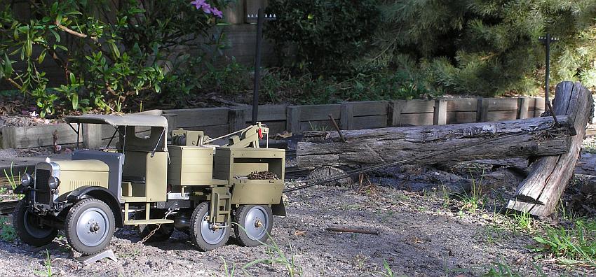

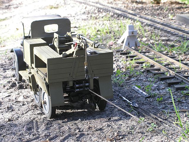

Just to finish off, this is what happens when wanting to see how effective the ground spades were. I set the truck up with a three to one tackle from a ground anchor onto the log skids that used to be at Warringine.
The winch is very slow, and I was running the mechanical loco as well and went to change a set of points.
This is what greeted me when I got back, the ground spades work, and the log skids are no longer.

It's the fine attention to detail that does it. Plenty of research must have gone into getting the small details right. Those ground spades make a lot of sense when you see them in (simulated) action.
