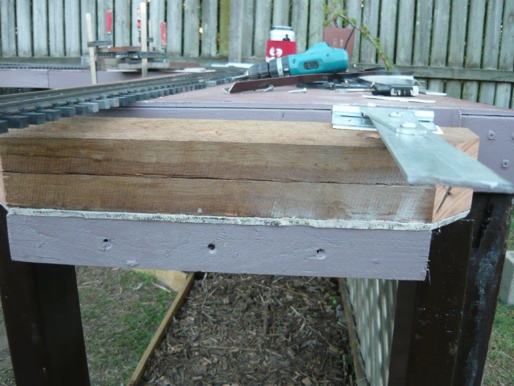

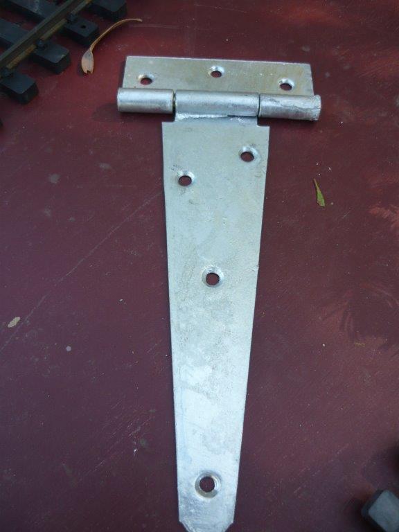

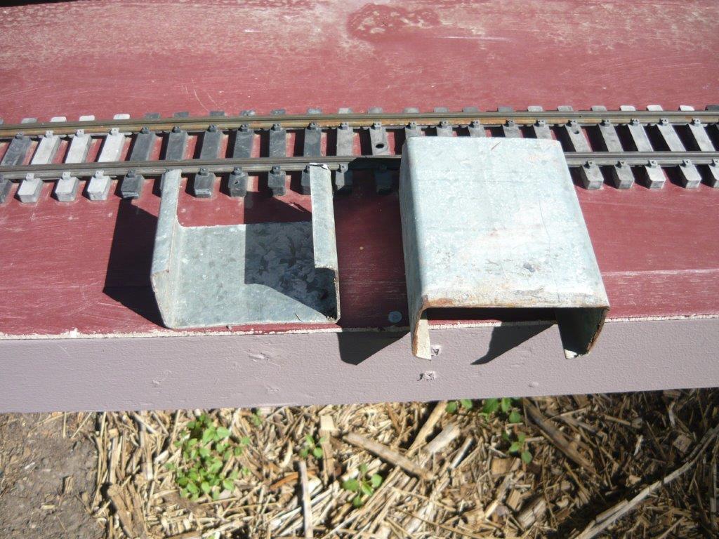

Pictures of the mounting block made from "C" Purlins and the new more robust hinge.
Type of Purlin pieces used The mounting block New hinge

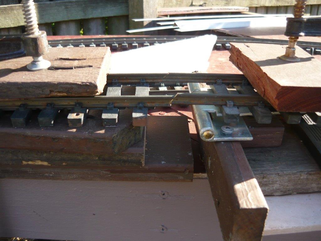

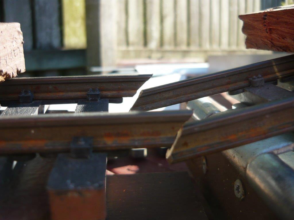

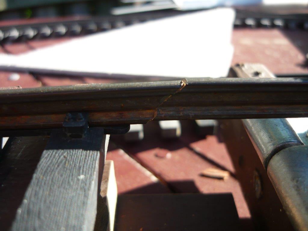

Bridge Design MkIII proof of concept jig has been built and the design has been tested with positive results.
As previously stated the secret of the opening is the 45 Degree cuts in the rail which allows the moving rail to drop away from the fixed rail without fouling.
The moving arm of the hinge is level with the baseboard and the gap that the rail folds into is not real wide.
The error I made with the MkII was that I put the bridge support on top of the hinge and when the rail was added the gap was just unworkable as the support folded into it, the bridge support will now be level with the top of the hinge and will not fold into the gap.
So now the bridge construction can now begin following the concept principles.
Closed Open Close up (closed) Close up (Semi Open)
- Attachments
- Proof of Concept Jig (Rails Semi Open Close up).jpg (68.63 KiB) Viewed 17718 times

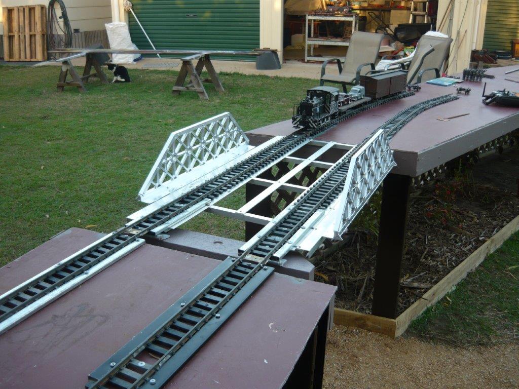

The lift up bridge is finished!!!
From a concept put forth by a modeller Korm Kormsen who frequents a US forum of putting the hinge under the track, as opposed to the convention of having the hinge joint above the track, to the finished thing has been a Ben Hur type production.
Trains can now cross the entrance to the firepit area with no problems.
Bridge non hinge end is located by using "Hillmans" lift out bridge clamps.
All that need to be done is to design and manufacture a safety device that stops trains from running off the edge when the bridge is open, I use battery power so breaking the track circuit does not apply, some form of physical barrier will be required possibly even a catch point.
More thought on the safety device is required, any suggestions folks???
Blog will be updated shortly.

Well done for persevering to a most satisfactory conclusion, it looks great.
I have never had the need for a lift bridge myself so not able to give advice on a temporary stop device, however, the idea of catch points seems to create another problem in that your battery locos will continue to travel on a flat surface even if derailed. You would also have to remember to switch them (two points, both ways) so that would be just another activity to remember every time you, and others, use the bridge.
- Posts: 5979
Re: Lift up bridge questions
Well done, looks good.
As for the open side, could you have a spring loaded plate which is held down by the weight of the bridge when closed but springs up automatically as it is opened? A suitably positioned hook/latch could then hold it up in position.
Depending on the actual design it might be possible to have the plate counterbalanced rather than spring loaded?
just a few thoughts.
You presumably don't need anything at the hinge side, since the bridge itself would be in the way of a runaway?GAP wrote: Thu Jun 18, 2020 9:28 am
- Posts: 7894
Looks good, Graeme. Very elegant!
Philip's idea sounds good, but I tend to go for the simplest solutions. I'd just have a piece of wood with a couple of dowels that slot into a couple of holes either side of the track. Of course, being non automatic, you'd have to remember to slot it in when you raise the bridge.
I have a couple of lift out bridges on the PLR, and so far I've never forgotten to install them when running. However, neither is on a main thoroughfare so there's very little pedestrian traffic through them when trains are running.
- Posts: 5693
A slot-in barrier would probably be the simplest way to solve the issue and be perfectly adequate for the situation if it was for one person to control. In this case though, especially with the fire pit in the centre as an entertainment area, it looks as though other people, family members and guests, might have to be considered for access and each would need to be advised on the method, and importance, of ensuring the system was employed at all times. Children would almost certainly forget and adults might not appreciate the idea of being 'told' what to do.
An automatic system would be my own preference.
