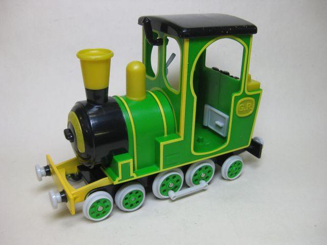

As luck would have it, we have a friction-drive Greendale Rocket as illustrated on page 1 of this thread (23rd April 2015!), which when dismantled should yield one of these:
https://gardenrails.org/forum/myff/1875 ... 351+LR.jpg
But what wheels and method of fixing them to the axle should I use?
(Solutions requiring basic tools only please!)

Thanks, Andrew. Is it just a superglue or similar to fix the wheels to the axle?
I never like wrecking things if I can avoid it, but it isn't obvious how the cab roof and smokebox come off with out force or sawblade...
Next silly question: Is anyone able to tell me whether it is necessary to destroy the toy to access the drive mechanism?Tony Bird wrote: Thu Apr 23, 2015 9:27 am For anyone here in the UK the B&M Discount stores are selling Postman Pat Greendale Rocket toys for £6.99 which are friction powered and will be a lot less work to convert that the electric version I altered. I bought this one yesterday.

If the axle is the same size it might be a push fit. Binnie wheels push fit onto Binnie axles, and I think that worked for the zecar mechanism too. If it won't stay put of its own accord but is close I think I'd go for 5 minute epoxy, to ensure a little time to get it just right...
Don't know about the Greendale loco - I thought of Tony B's article, but I see you've already found that...

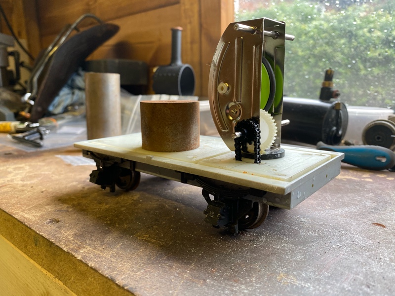

Re: Zach Bond "Momentum Van" project
Came across this thread a while back and liked the idea of a momentum wagon as a temporary measure while I wait for my slomo to show up. Wanted to make it reversible as I have limited space for stock so in the future it can revert back to a normal wagon. It’s an accucraft l&b open wagon and I’ve just bolted the zecar to the top and driven it via a delrin chain and sprocket from the axle, may add another to the other axle to make it 4wd. Haven’t had a chance to test it on tack yet as it’s raining pretty hard, seems to work ok on the bench though.
