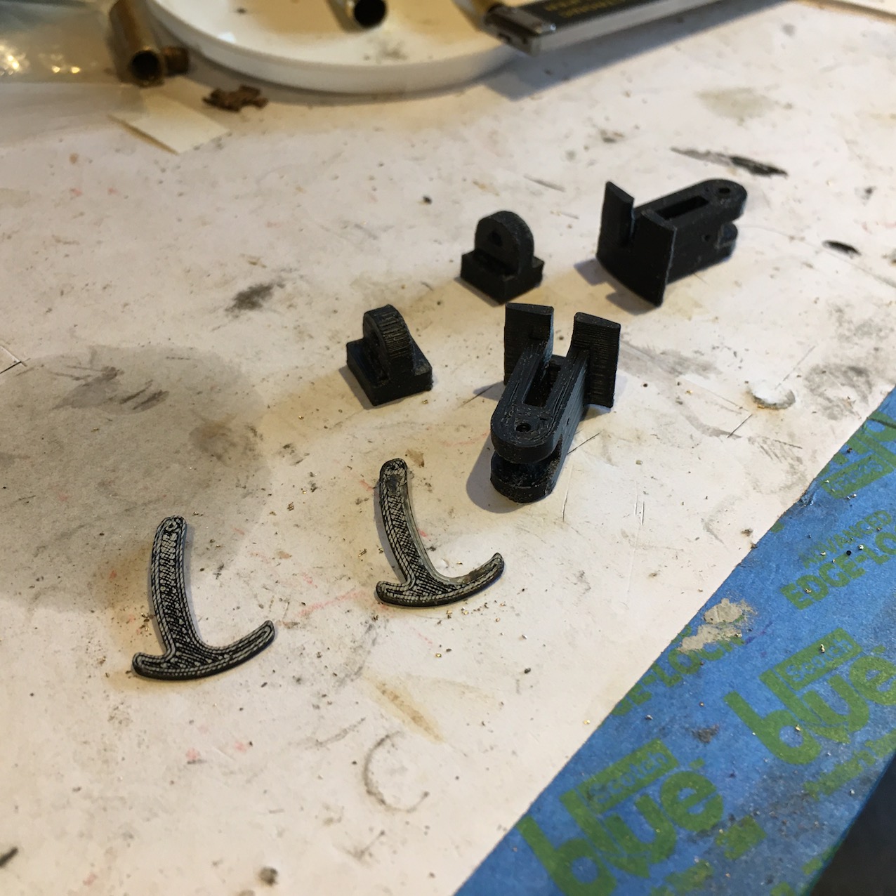

Latest printing progress.
The couplings for Linda ( see thread in the live steam section):
I am sure those hooks will fail eventually - but lets see how long they last! The BIG advantage is that every coupling is the same. They will all engage accurately. I am standardising on these for locos and coaches. They also connect to wagons with the correct wagon couplings.

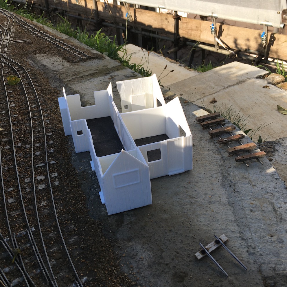

And the station building has all its walls assembled:
It is amazing how large a scale model of something real actually is! Internal walls and ceilings are to be added not for appearance but to impart rigidity to the model.

Those choppers look well engineered. Are they sprung to return to centre?
- Posts: 1208
- Location: South West Wales
Re: 3 D Printing 16mm models
No they just lie where they want to. Doesn't seem a problem.

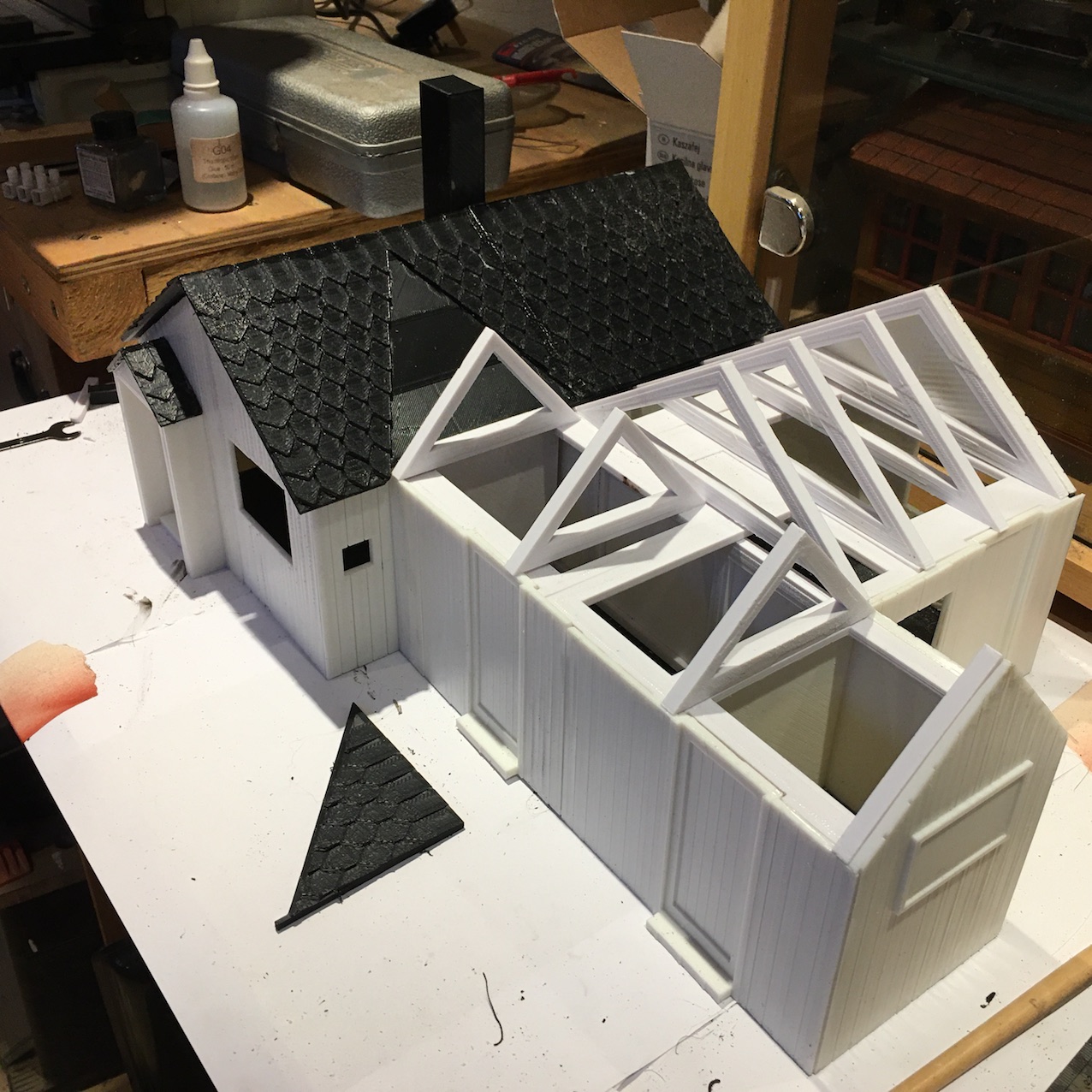

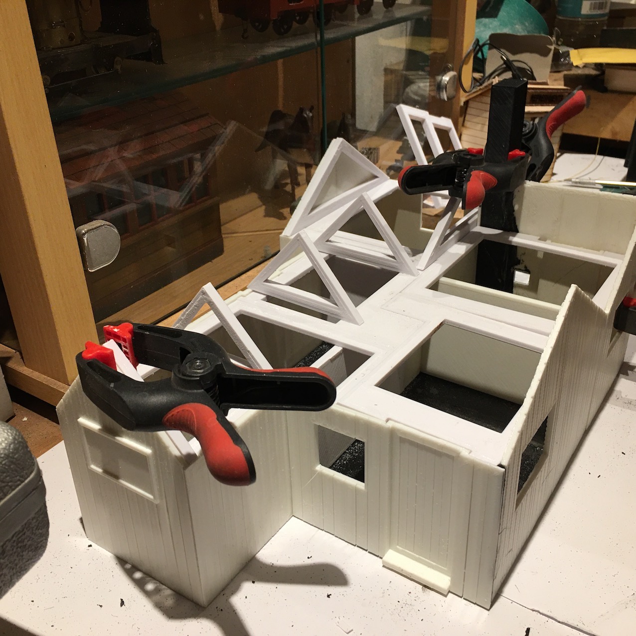

I have fitted skeleton internal walls and skeleton ceilings into the station building to stiffen it.
I am now in the process of printing and fitting roof trusses into position:
and I have started to detail the roof sections prior to printing:

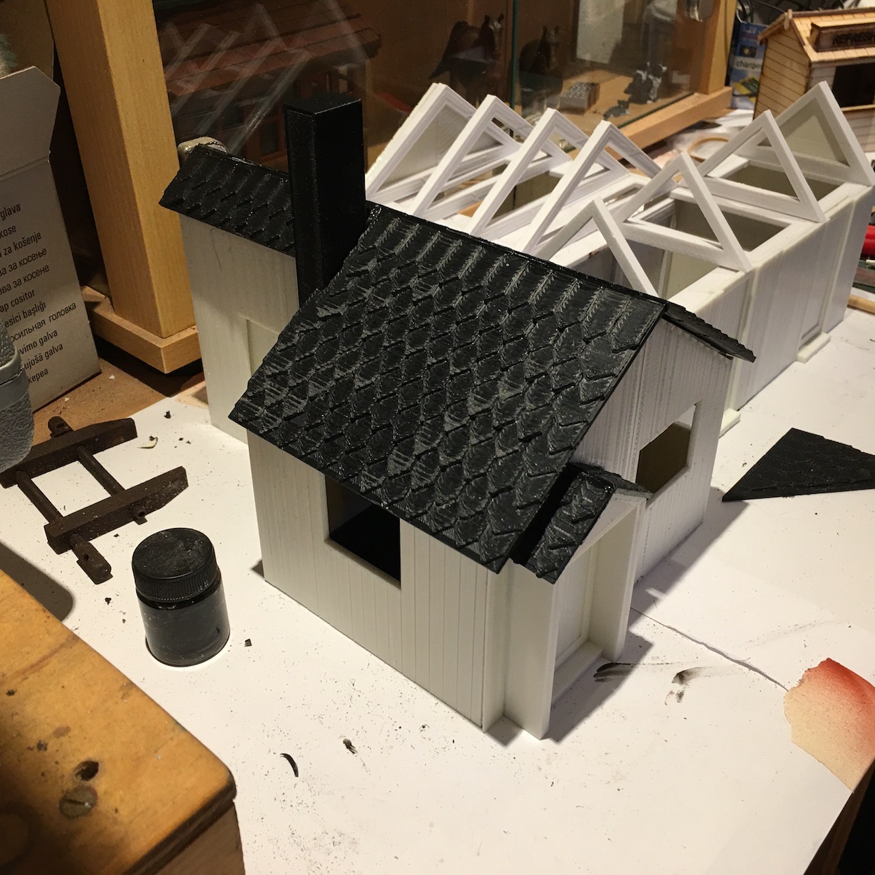

The roof trusses are all finished and installed:

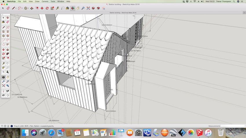

and I have updated the slate profile to agree with the photos:
First roof section is now printing. It will take 9 hours.
As an aside I have just started to use a new supply of ABS filament. It is from a different supplier and it seems to be printing at a lower temperature and more reliably. Perhaps I should stick to this supplier in future!

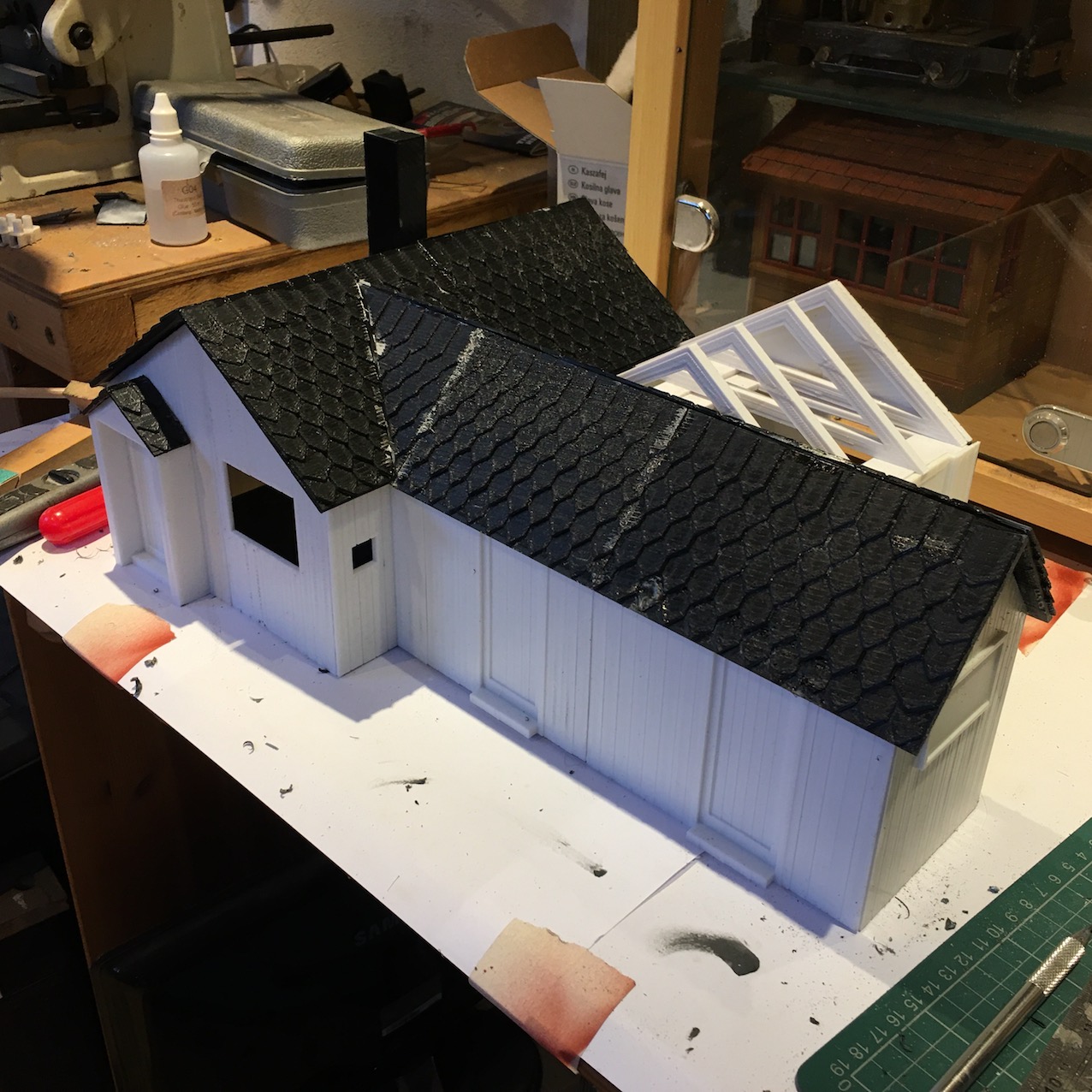

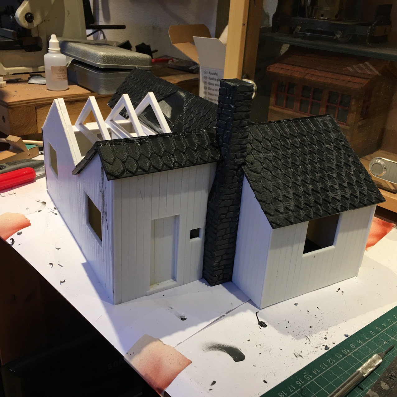

I am making good progress with the station building. The roof panels are printing well so far. The triangular profile of the lower edge of the slates is (as far as I can tell from photos) pretty close to the shape of the original slates.
So three views of the roof so far:
There will be ridge tiles to go over the ridges of the roof - so I am ignoring the slight gaps along the ridge.
I am particularly pleased with the roof on the porch.

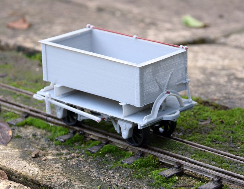

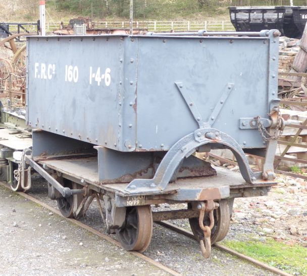

An FR-ish Tipper because I drew it up from photos not actual drawings and I know some bits aren't quite right.
However, first the kit of 3D printed parts: The real thing:

That is VERY nice!
- Posts: 6070
Cheers Trevor.
I'm not very happy with the body, tbh. I tried to be too clever by slowing down the print speed AND increasing the minimum layer time, and ended up making the striation effect worse! Still I know what to do ( NOT to do) next time.

The station roof is still printing.
Another 6 panels printed and the second roof glued into position:
I have also started to add the stonework details to the chimney using a Bromley Crafts mylar template and wall tile adhesive. I have added black acrylic paint to the adhesive to make ir a dark gray:
And the last roof is printing out - in 4 sections.
I am starting to think about ridge tiles and window frames.

Well that looks pretty darned good to me......philipy wrote: Sun Nov 15, 2020 3:28 pm An FR-ish Tipper because I drew it up from photos not actual drawings and I know some bits aren't quite right.

Those roof tiles look the biz! This is the sort of thing that 3D printers do well, which would be tricky to do otherwiseTrevor Thompson wrote: Sun Nov 15, 2020 6:16 pm The station roof is still printing.
