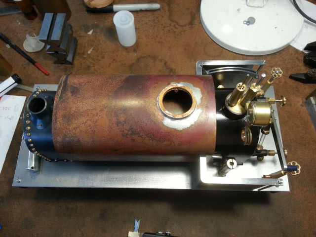

We're getting there, very slowly. Boiler feed fitted

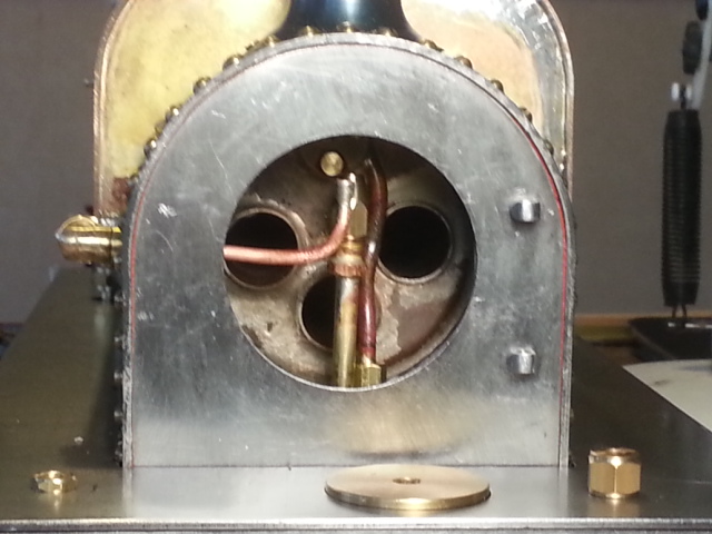

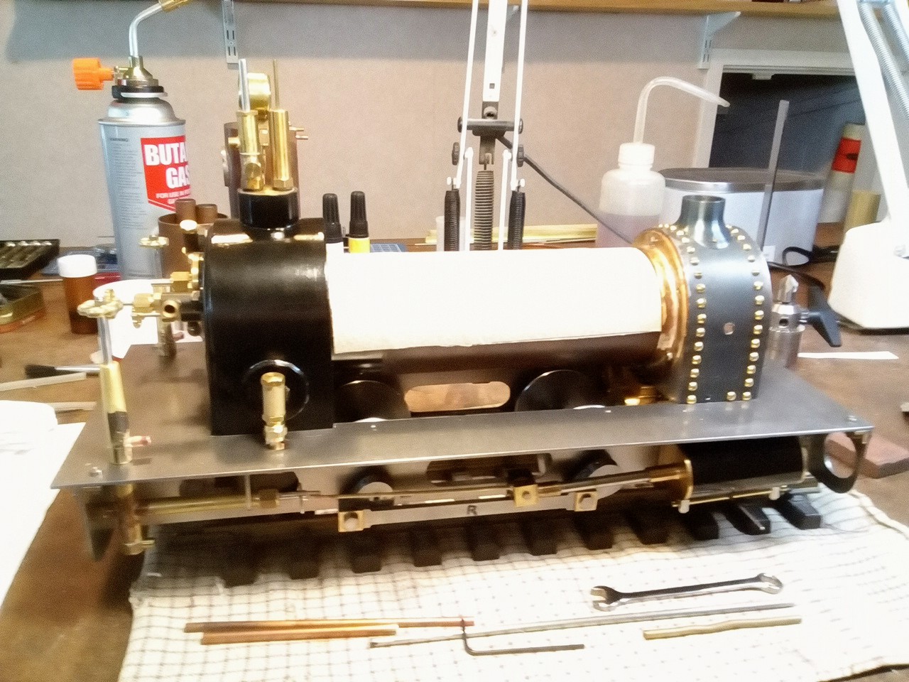

Pushing on with the blower. I drilled the nozzle 0.45mm diameter as my small Jacobs chuck couldn't grip anything smaller
Best wishes,
Dave
Re: Wild Rose ~ Quarry Hunslet
Post by tom_tom_go » Mon Dec 10, 2018 10:05 am
Good trick I learned from TonyW is to fill the boiler up with water until you get about 40 PSI and then open the blower.
If you get a nice fountain shooting out the chimney you know the blower position is going to be efficient!

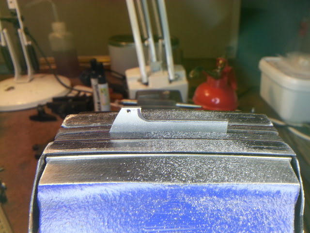

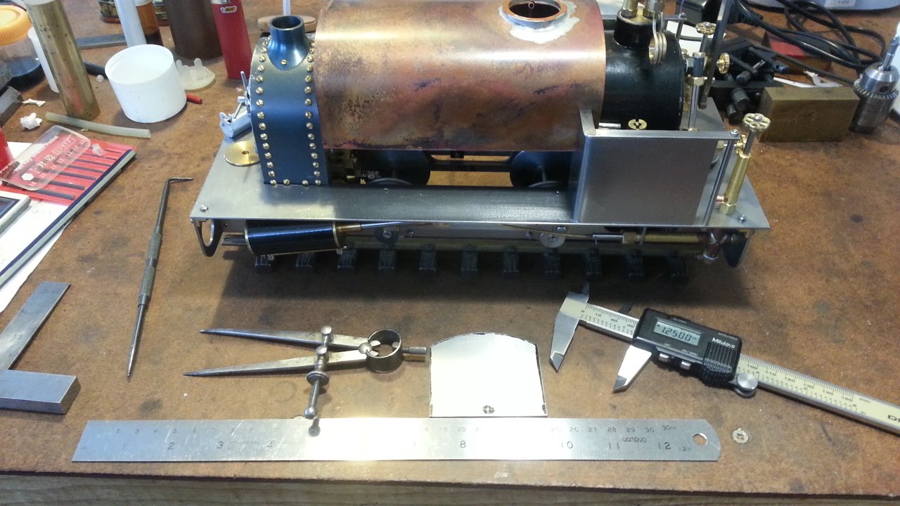

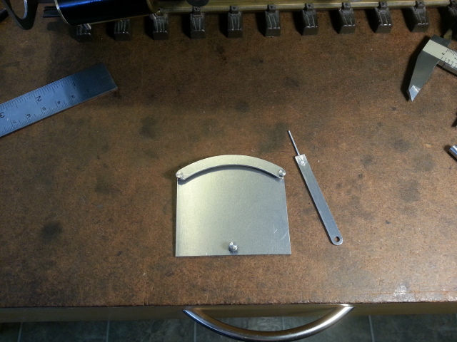

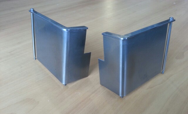

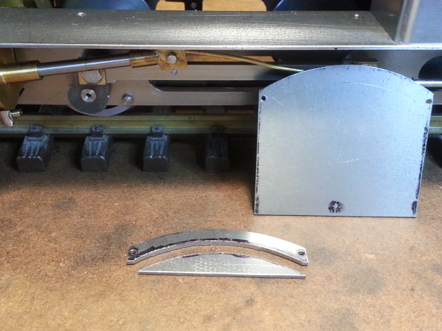

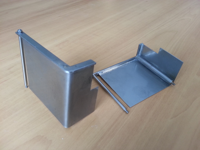

Before I can make the reverser I need to make the bodywork to see how much space is available for it. One side is now complete, the other is in progress.
The main panel is a piece of 0.6mm steel sheet bent around a 1/4" bar for the radius. The top piece is 1/4" x 1/16" strip brazed into a 90 deg angle. It's all soft soldered together
Best wishes,
Dave

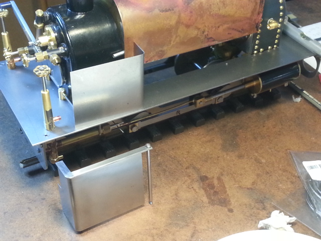

Post by dewintondave » Mon Jan 28, 2019 4:45 am
Second side completed on this hot Auckland Anniversary day ☑️
Best wishes,
Dave
Post by tom_tom_go » Mon Jan 28, 2019 7:06 am
Solid work, is steel easier to soft solder than brass?
dewintondave
Posts: 697
Location: New Zealand
Post by dewintondave » Mon Jan 28, 2019 8:05 am
Steel solders very easily with zinc chloride flux 👍
It was easier than soldering the copper/brass tank Tom
Best wishes,
Dave
Post by bambuko » Mon Jan 28, 2019 8:41 am
Very tidy work :thumbright:
Copper will be more difficult to solder because it conducts the heat away very well.

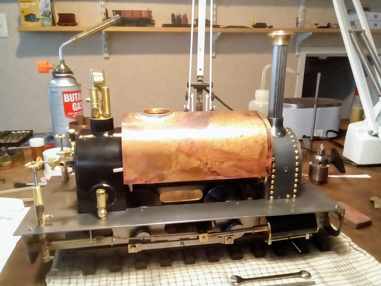

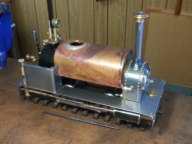

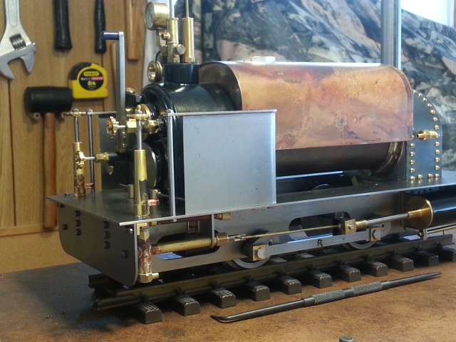

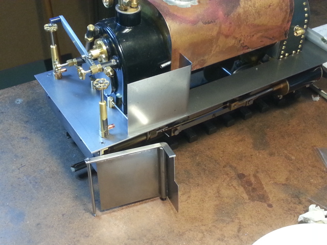

The bodywork is installed. I put most of the bits on the loco for the photos. It's coming together. The bodywork panels needed converting from external threaded fixings to internal threaded, due to an oversight...
Best wishes,
Dave

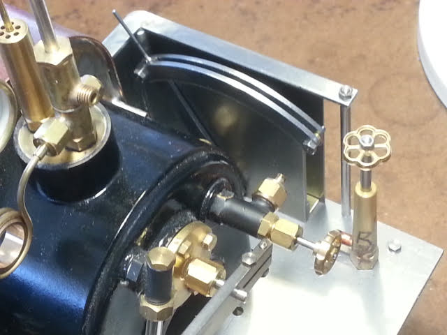

I've been working on the reverser over the last few weeks. It needs to be big to get enough throw at about halfway up the lever to swing the rotary valve through 90 degrees. 5/16" brass angle is soldered to the reverser base and screwed to the footplate. As brass has a higher coefficient of expansion than steel the base has a nice gentle bow in it 😃
Best wishes,
Dave
Post by tom_tom_go » Mon Feb 18, 2019 7:58 am
That's huge!
