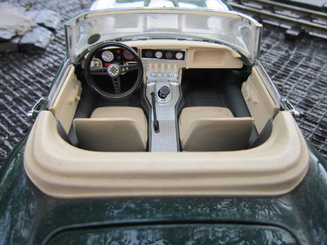

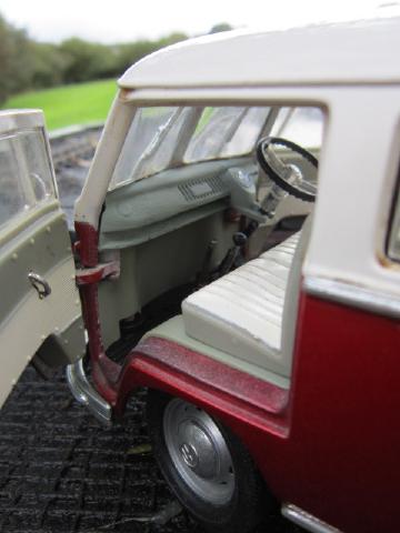

Well now!  flushed with success after the first left to right hand drive, I thought I'd do another.   Why are they all LHD, even the ones normally found on British shores?
Anyway, I recently bought this next model at a Vintage Show from a dealer.  It was a bit scruffy and no box, but that's ok.  I bargained for it (as everyone does round here) and paid just £12.00. Very happy with that, thank you!
So strip down to get access to the dashboard and saw out the binnacle with the steering wheel.   Fill the gap with Miliput and paint to match.   Then fit the pedals, steering wheel and speedometer on the right (correct) side.  Looks good!

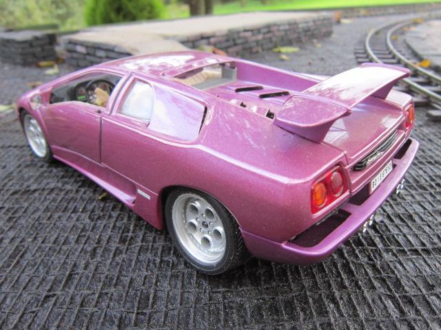

No!!!!!!   not the Lambo......
You're right, I wouldn't do that to my favourite car of all time.   You can't improve on perfection!

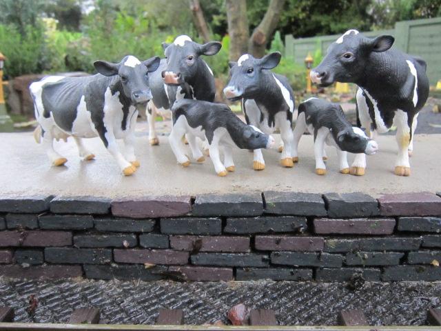

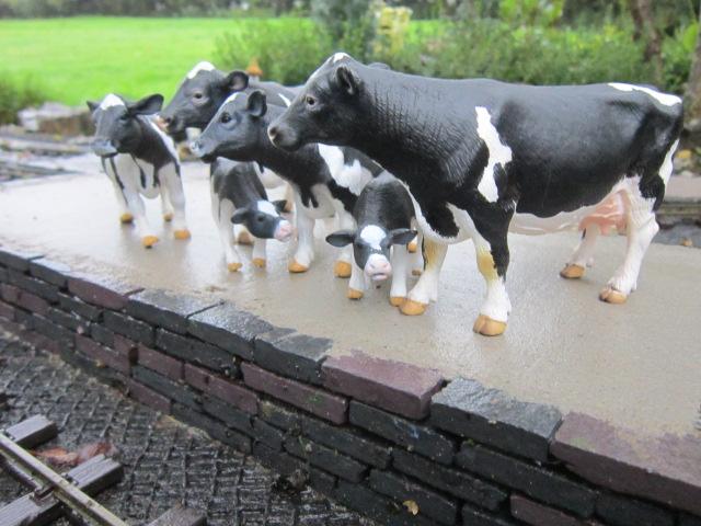

Another scenic addition nearer to completion..... The cattle dock.
Although I have yet to fix the slate floor slabs and the fencing, I have been stocking up on my animals.
The best quality in this scale are made by Schleich and are superb models from a range of suitable animals. Trouble is, they cost about £6.99 each (plus postage if you buy on line).
We have a local 'Charlies' store so I can see before I buy.
However, today I accidentally came accross a boxed pair of cow and calf on offer at 'The Works' for just .99p. I bought the last two as they are almost as good in detail, made from very similar material and well finished, although slightly smaller. I'm sure not all cows are the same size!
With a little extra paint here and there to differ the markings, they look just fine.
In the picture, the two larger ones are by Schleich and the rest bargain buys!

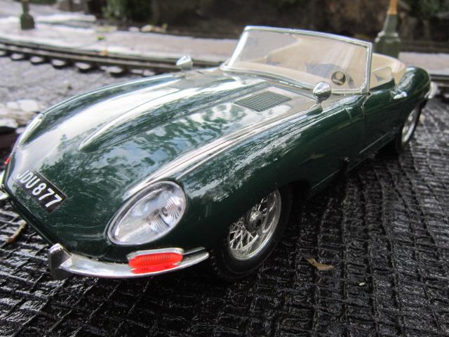

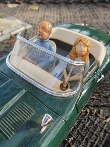

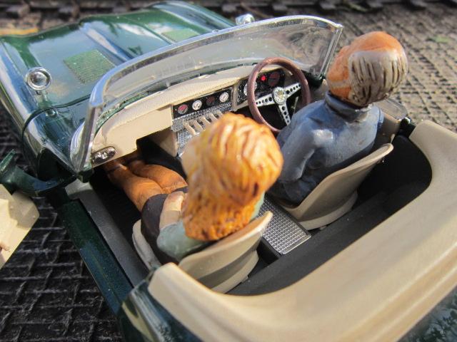

Finished the Jag now.... Middle aged man with young companion, (obviously his niece!) out for a spin.
Posts: 1142
Location: haverhill suffok
Post by jim@NAL » Tue Oct 29, 2013 8:24 pm
that looks brill .could be hes neice or the young girl from the office at work

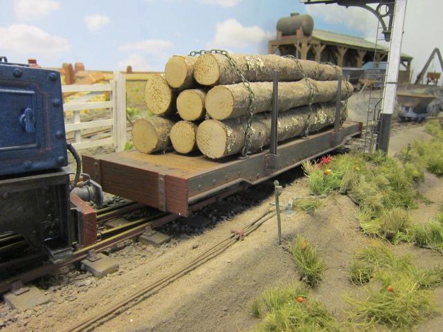

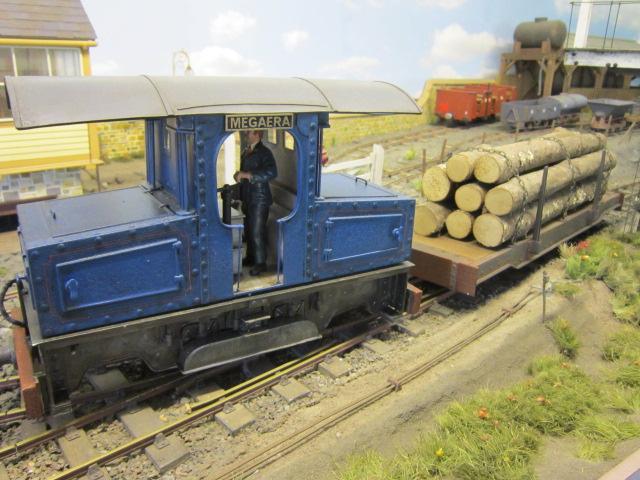

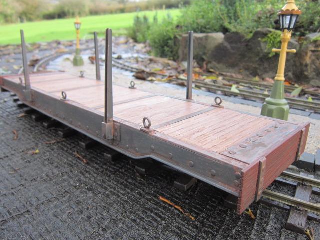

More indoor activities..... It has been so wet here recently, and the railway is covered in leaves you can't see most of the track anyway. I have decided I need a timber wagon to move the trees which have been felled by the volunteer forestry workers clearing alongside the line.
First I made a plasticard bogie wagon with posts in sockets on the sides.
A coat of paint, some weathering and planking on the top..
Finally, the logs with chain to prevent them shifting.
I'm very pleased with the effect and already moved on to the next project.

Very nice job that!
Big Al
Post by Big Al » Sat Nov 09, 2013 11:42 pm
That looks good Peter, a well made wagon very nice.  I have a pile of kits to get stuck in to now the weather has gone tit's up for the winter. What glue do you use on the plasticard.

Big Al:91556 wrote:    What glue do you use on the plasticard.
Thanks Big Al,  the solvent I use is Dichloromethane and can be purchased on-line from Biostain Ready Reagents Ltd. You can get it on ebay, item number 140574254717 in 500ml. for £12.99 with free delivery.  (I have just ordered some so I know it is there!)
Nothing else comes near to this stuff.  Put it on with a brush and it welds the plastic together permanently.

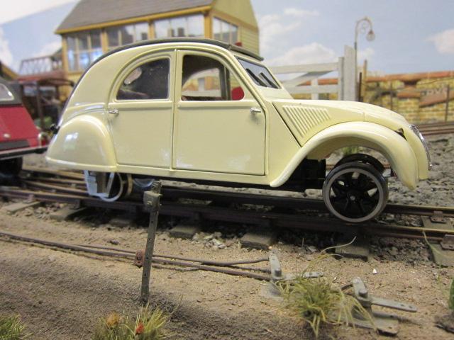

Post by Peter Butler » Sun Nov 10, 2013 5:42 pm
And for my next trick.......!

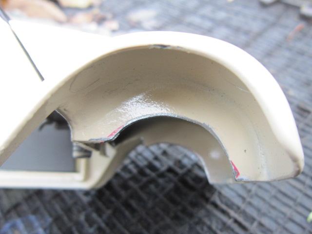

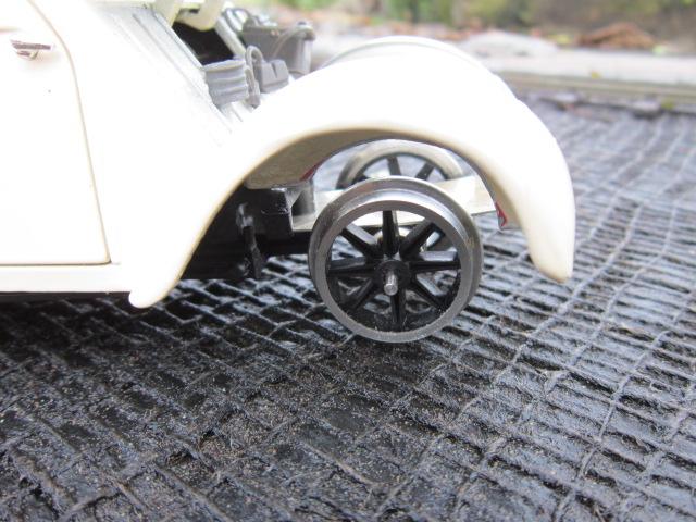

This arrived yesterday morning (Saturday) after a successful bid on ebay.
Yes, I know the box is empty, but that is because by the time I took the picture I had already started to chop the vehicle..

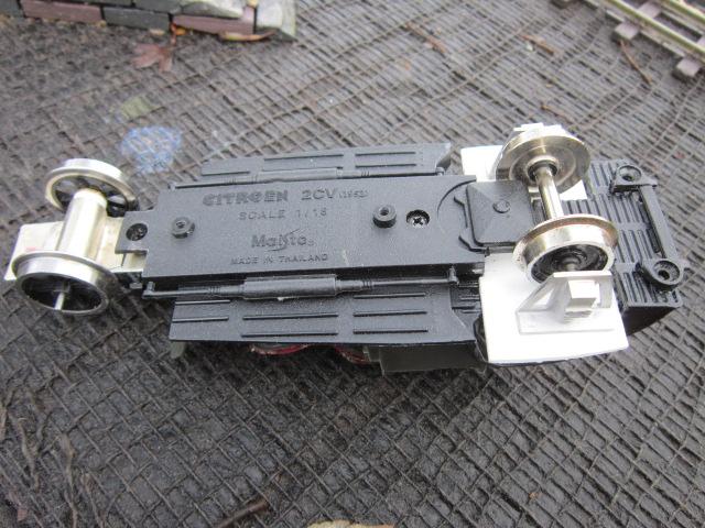

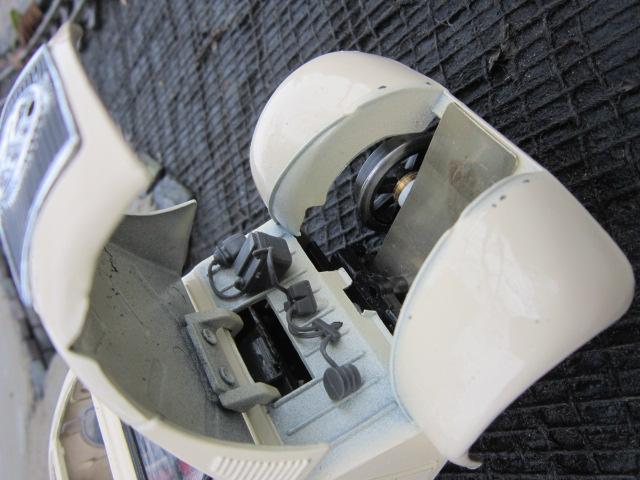

In order to convert it to rail use I needed to cut out the wheel arch to take the narrow (32mm gauge) wheels. I tried to use a Dremmell but it is too tough to cut with a slitting disc. My solution to this was to use my BIG tool. (no smirking at the back).

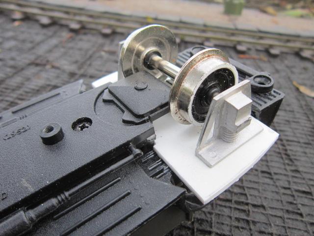

Having cut out a nice smooth arch I made a supporting plate to hold the front axle.
Next fitting the rear wheels.
The completed chassis.
The reason for all this work is to make an unpowered companion to my existing 2CV which has a 12v motor fitted and works very well on track power. As I now have an outdoor railway I need to provide battery power so the new car will carry the batteries etc and make the vehicle useable in both directions.
So that is as far as I got today. To finish I have to fit a connecting bar between the two and an electric link from battery to motor via some sort of switch.
Now I think I have earned a night out in the pub!
