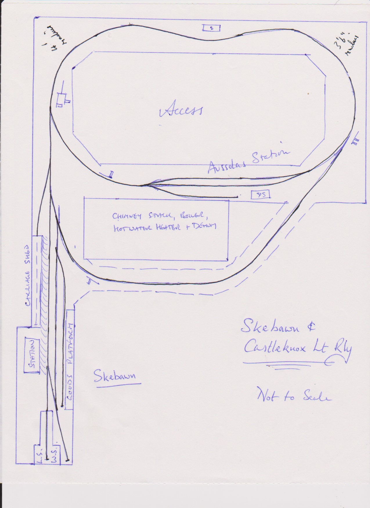

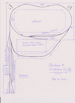

Post by IrishPeter » Fri Jul 28, 2017 5:32 am
Well, one of us managed to resize it... Sorry it is a bit small, but I struggle with computers, and, of course, just when I get used to something the Evil Empire comes out with a new version of windows.
Anyway, there will be some (a lot) of revisions before the final product appears, but here is version 2.0. Skebawn is along the long wall of the basement, and the layour as shown is going to give me a few headaches as the loop points are at the back of the chimney stack. The layout is largely cribbed from Schull. The other possibility is something derived from Castlederg, which is also a long narrow layout.
Peter in Va.

Post by IrishPeter » Fri Jul 28, 2017 2:13 pm
Scan_20170728 (3)[2506].jpg (339.73 KiB) Viewed 5187 times
This might be a bit bigger...

great looking drawing

Re: The Skebawn and Castleknox Light Railway and Tramway
Post by tom_tom_go » Sat Jul 29, 2017 9:00 am
Fair enough Peter.
Few points if I may:
  • How do trains return to the station without reversing from the main line?
  • The headshunt for the goods platform is small compared to the size of the siding which means you again go onto the main line for any stock movements
They are not criticisms. I just find these days that this stuff matters to me when building a railway as it needs to have logic like the real thing :mrgreen:

Post by IrishPeter » Sat Jul 29, 2017 2:21 pm
tom_tom_go wrote: Sat Jul 29, 2017 9:00 am Fair enough Peter.
Eventually, the Castleknox end of the line will appear somewhere, but I have not quite decided where yet. In the meantime it is run round at Aussolas after so many laps, and head back to Skebawn. As I use chopper couplers, with choppers at one end only, I do not like to turn stock around. Mind you, if I trace many more derailments to centring springs being too stiff, they may get replaced with buffer and bog chain anyway.
The logic is simply that the line connects Castleknox with Skebawn, which is why, ultimately I want to show both ends of the line, though the Irish Broad Gauge side of Castleknox will be vestigial. Skebawn has the usual small market town activities with rail traffic being mainly mixed goods, coal for the gas works, and cattle to market. Aussolas serves an estate and a small village/failed town, so provides a little cattle traffic, and the odd load of coal for the big house. This being Ireland, most folks burn turf at home.
The headshunt is a problem. I had three goes at making it fit, and was not happy with any of them, because they involved making the loop around the back of the chimney tighter than 3'6." The blue line is a vague indication of where it should go, if I decide I can made it fit there. In any case, I would imagine that on a quiet Irish Tramway running three round trips a day, shunting out onto the Main would not be too much of a problem.

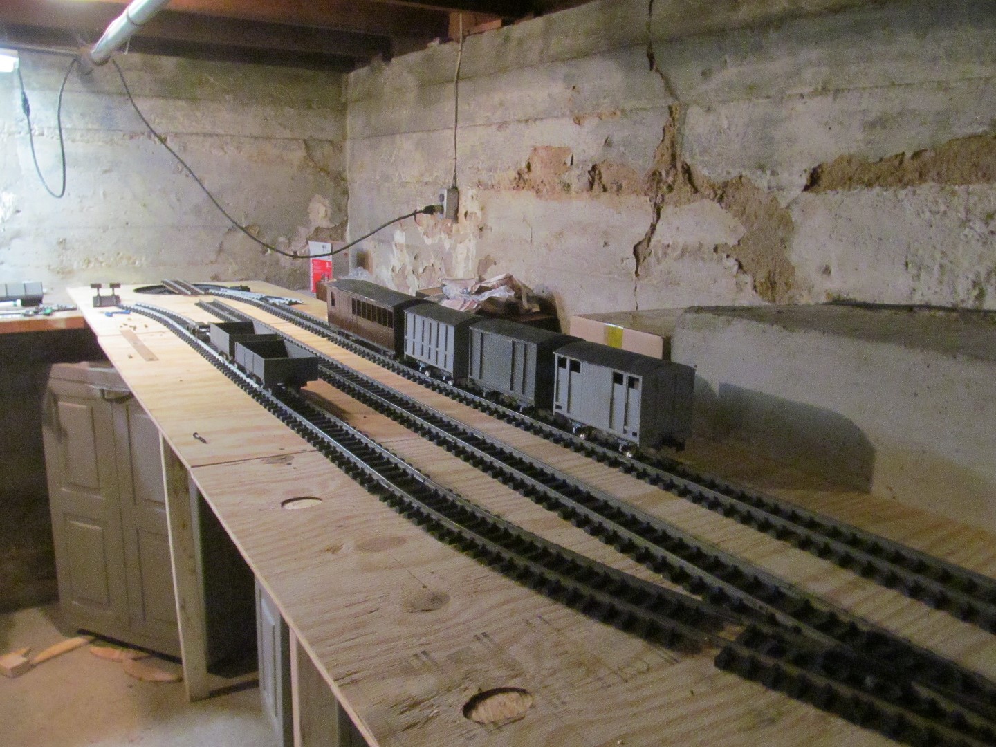

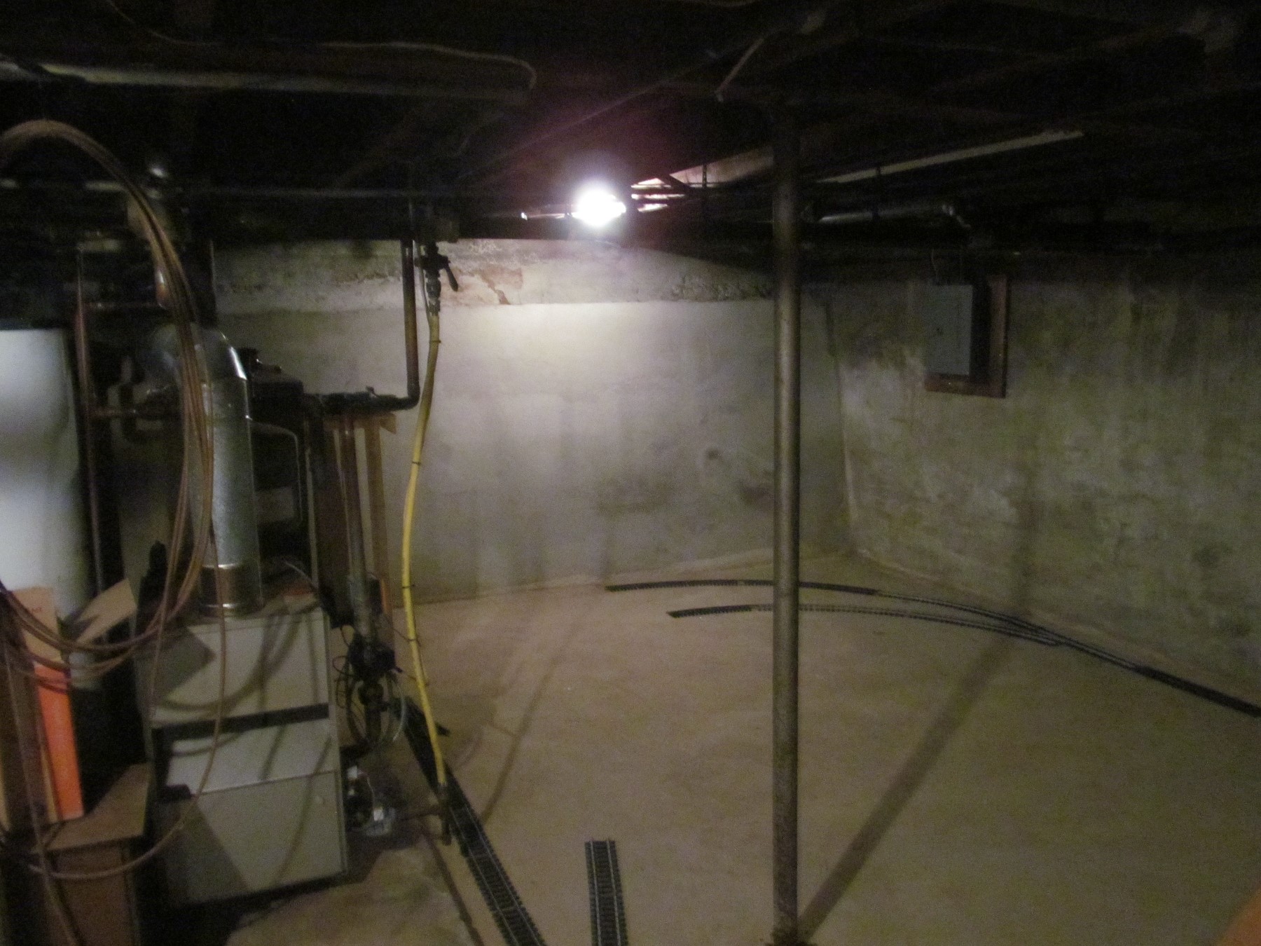

Post by IrishPeter » Sat Sep 16, 2017 5:40 am
I attempted to take some general shots down there tonight but the flash battery was dead, and it is a dark hole down there, so only the best lit area would photograph. More photos over on the Projects board. Here is a taster...
General view towards work bench, and turntable end of main station
Railway 1.jpg (420.88 KiB) Viewed 7245 times
Looking into the void... this is the area into which the terminus leads from the back left hand corner of the shot.
Track 12.jpg (505.98 KiB) Viewed 7027 times
