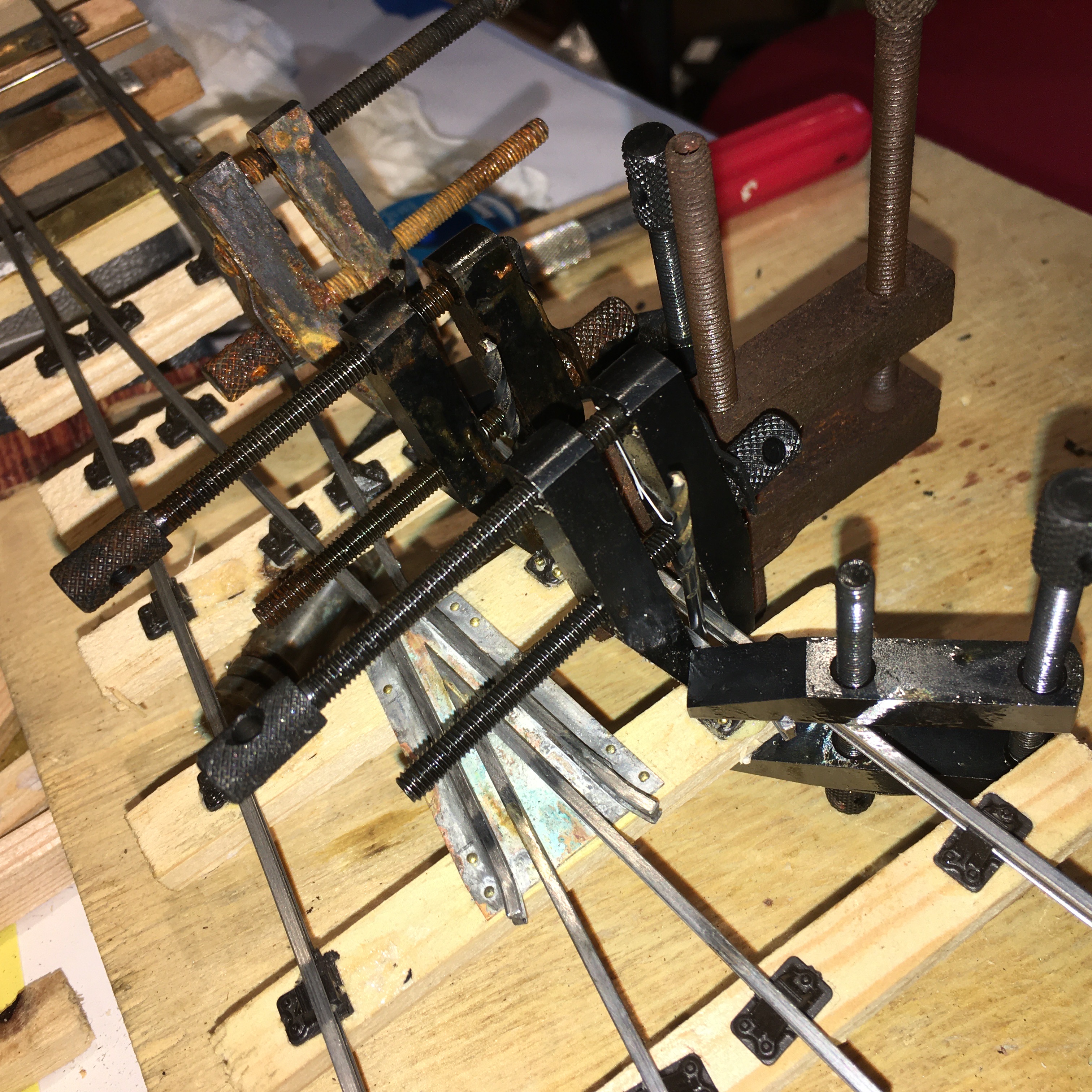

I have "cut and shut" those check rail chairs on the point. I used 2.3mm drills as spacers and clamped the rails up to the spacers as in the following photo. I did drill out the false bolt heads and glued and pinned the chairs down in their new position:

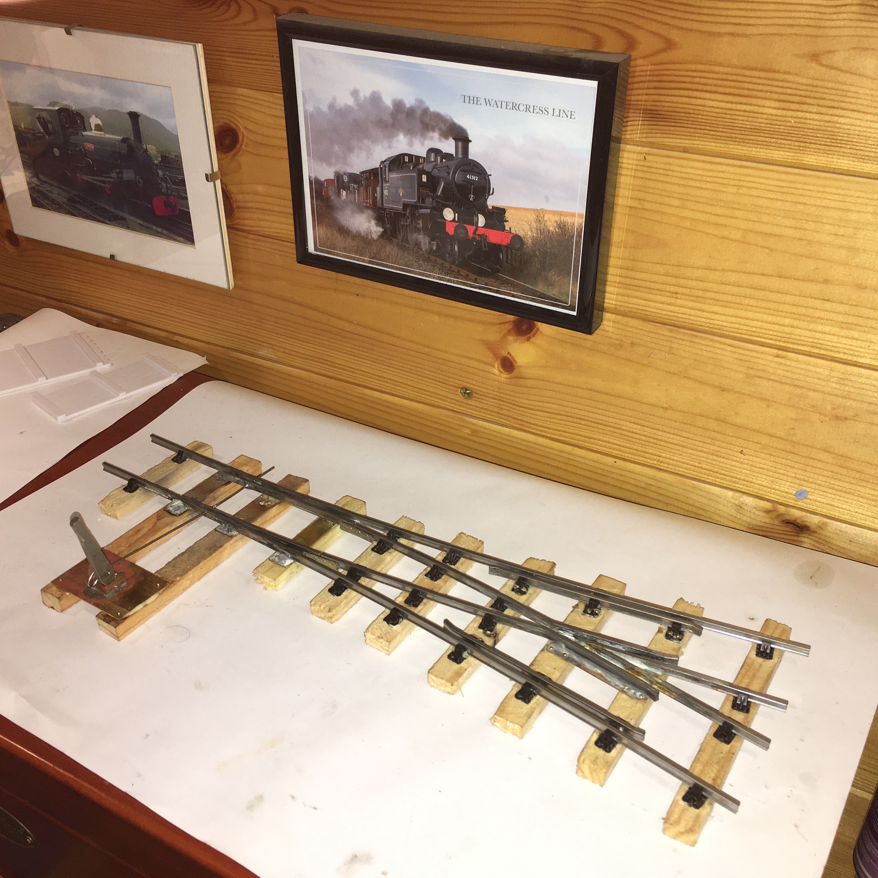

and finally a photo of the finished point:
The gap between the check rail and running rail ended up being a pretty even gap of between 2.45mm and 2.5mm - which seems perfect to me. Of course the final test was with a wagon and coach - nothing attempted to climb the frog - so I think that is a success.

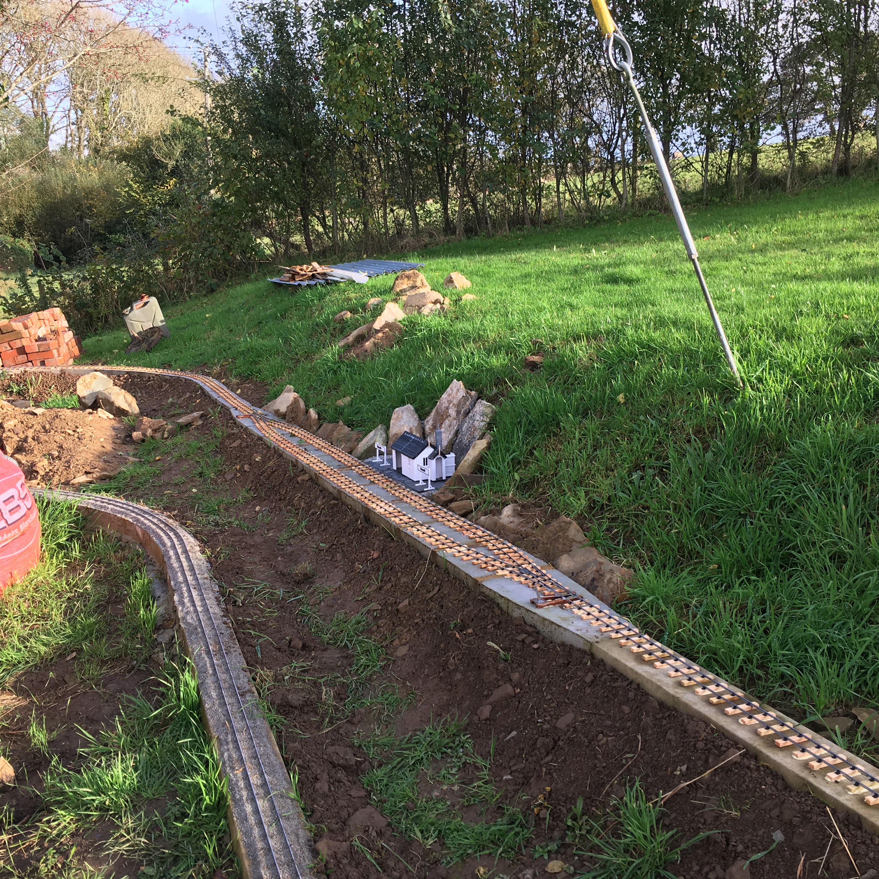

It has been raining here for the best part of the week - which has slowed progress down a bit. I have however managed to lay track into the passing loop at Dduallt station:
The photo was taken before the track was fixed down - which I hope explains the kink in the near track!

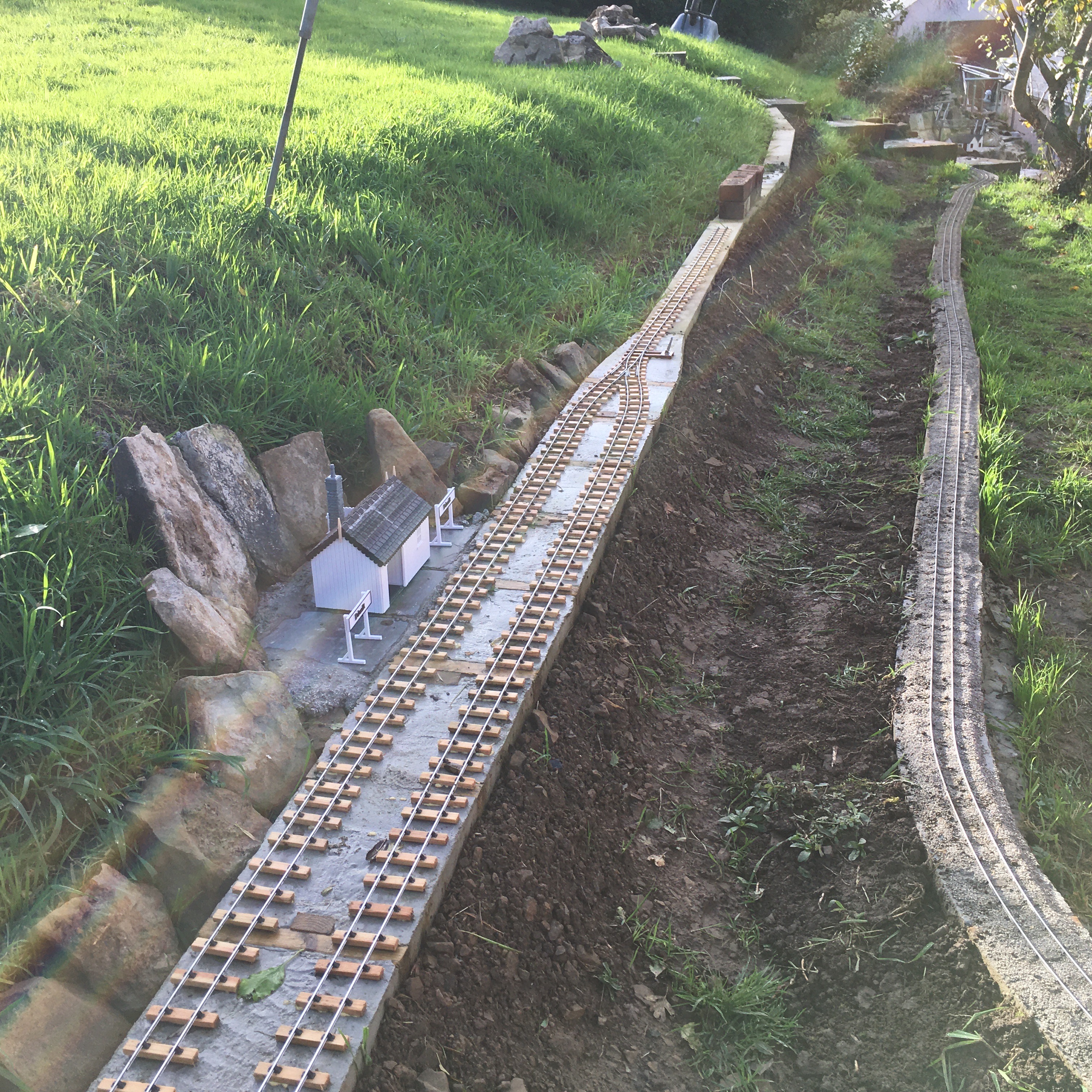

The passing loop is complete, and I will now be able to run trains up the line to the new station. It isn't finished but this should give you an idea of what things will be like:
The station building and signs are not permanent yet, and the landscaping into the bank behind the station needs completing - or I will end up with grass everywhere again.

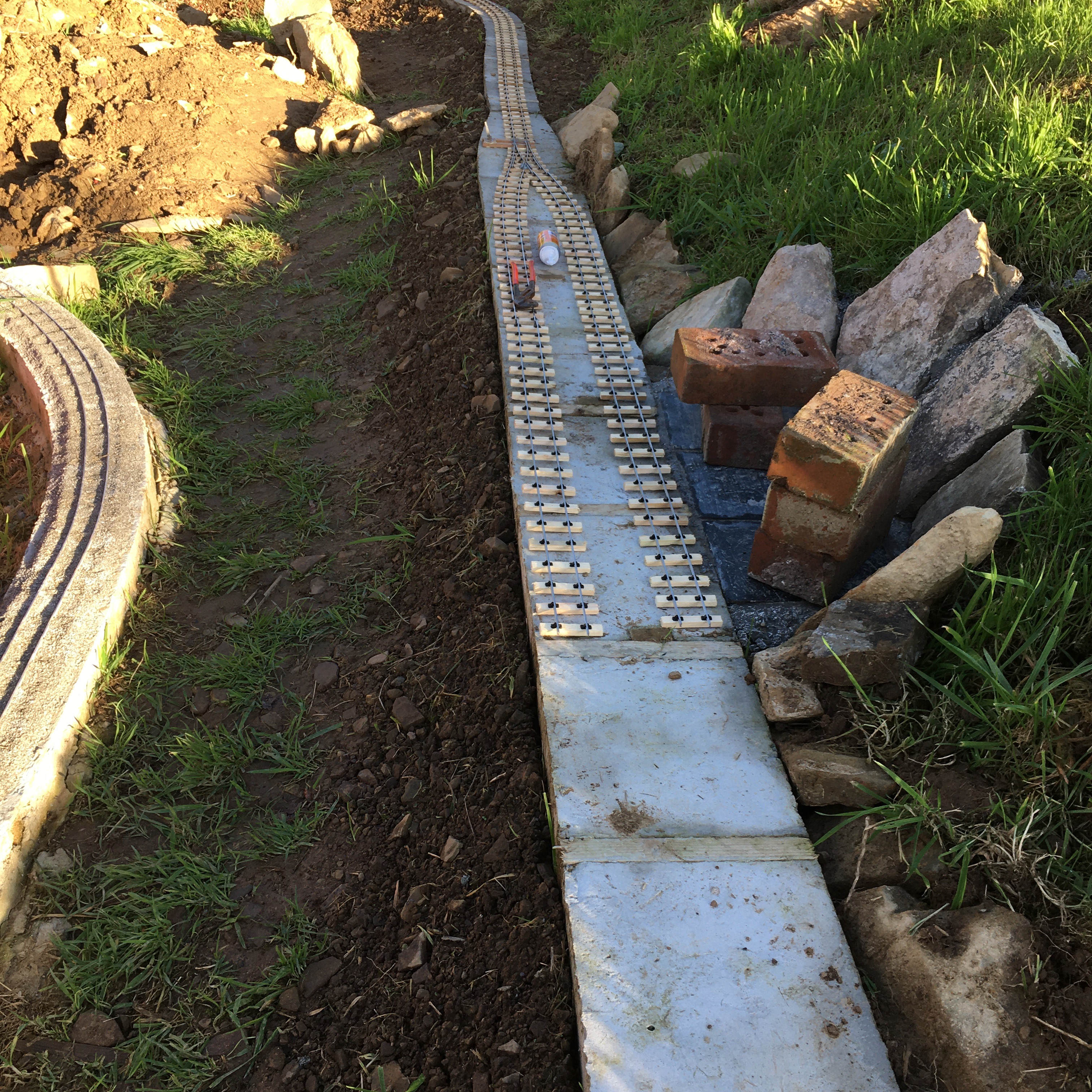

The weather is deteriorating here in West Wales (we have had a week of rain and wind) so I don't know how much further I will get before the spring. However I hope to at least get track laid as far as the steps:
