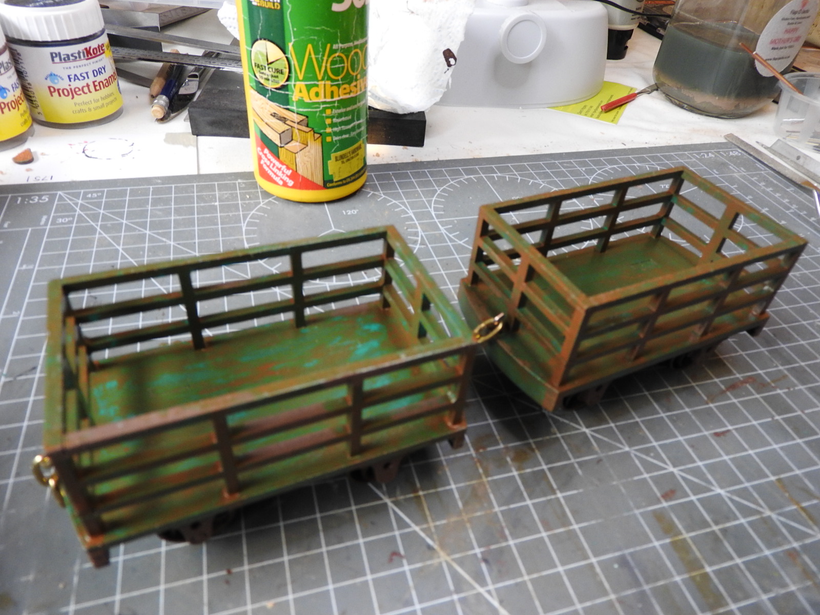

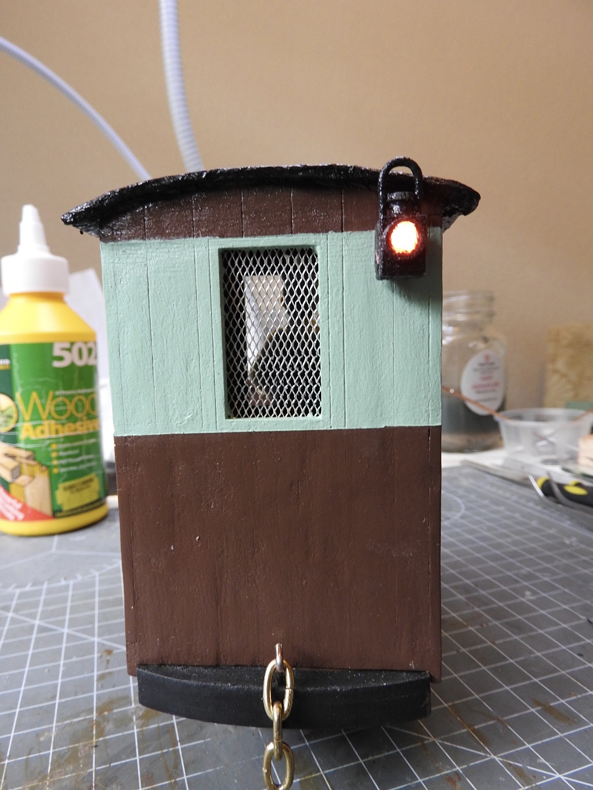

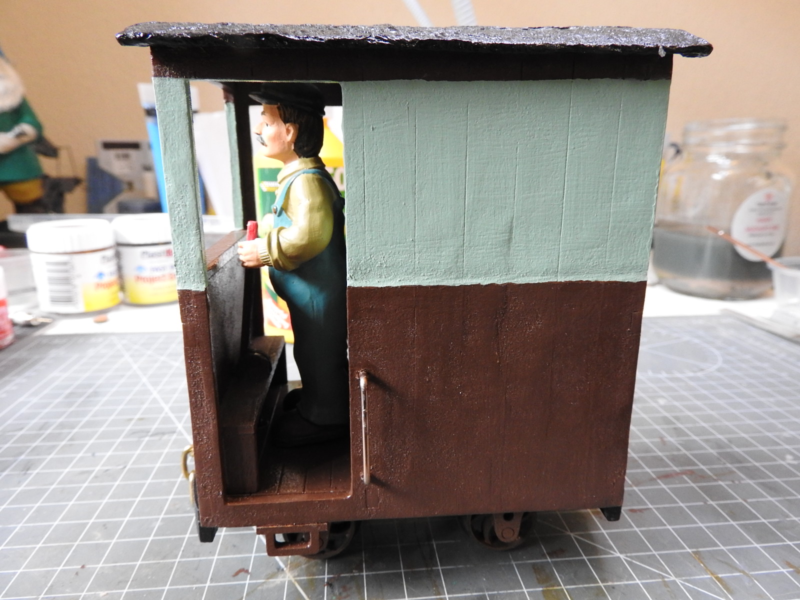

Re: Fairy Wood Light Railway (Update Some Rolling Stock)
Post by FWLR » Thu Mar 29, 2018 6:19 am

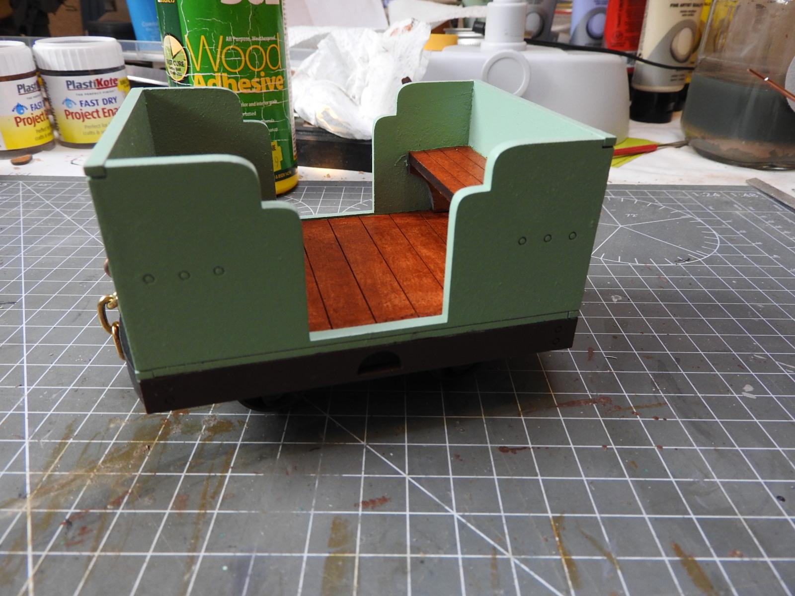

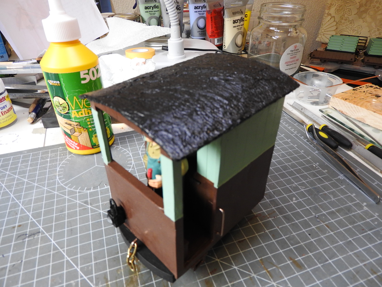

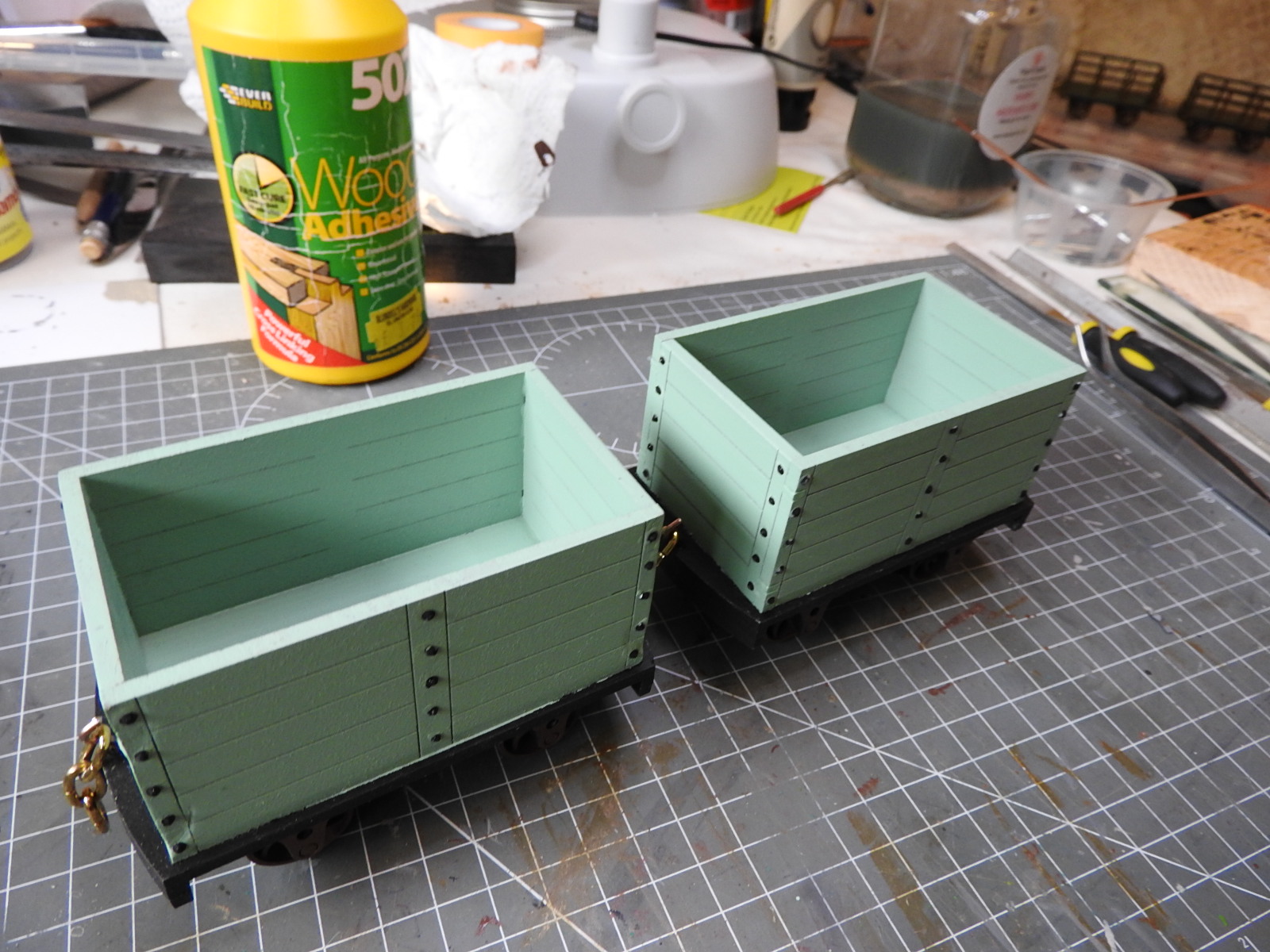

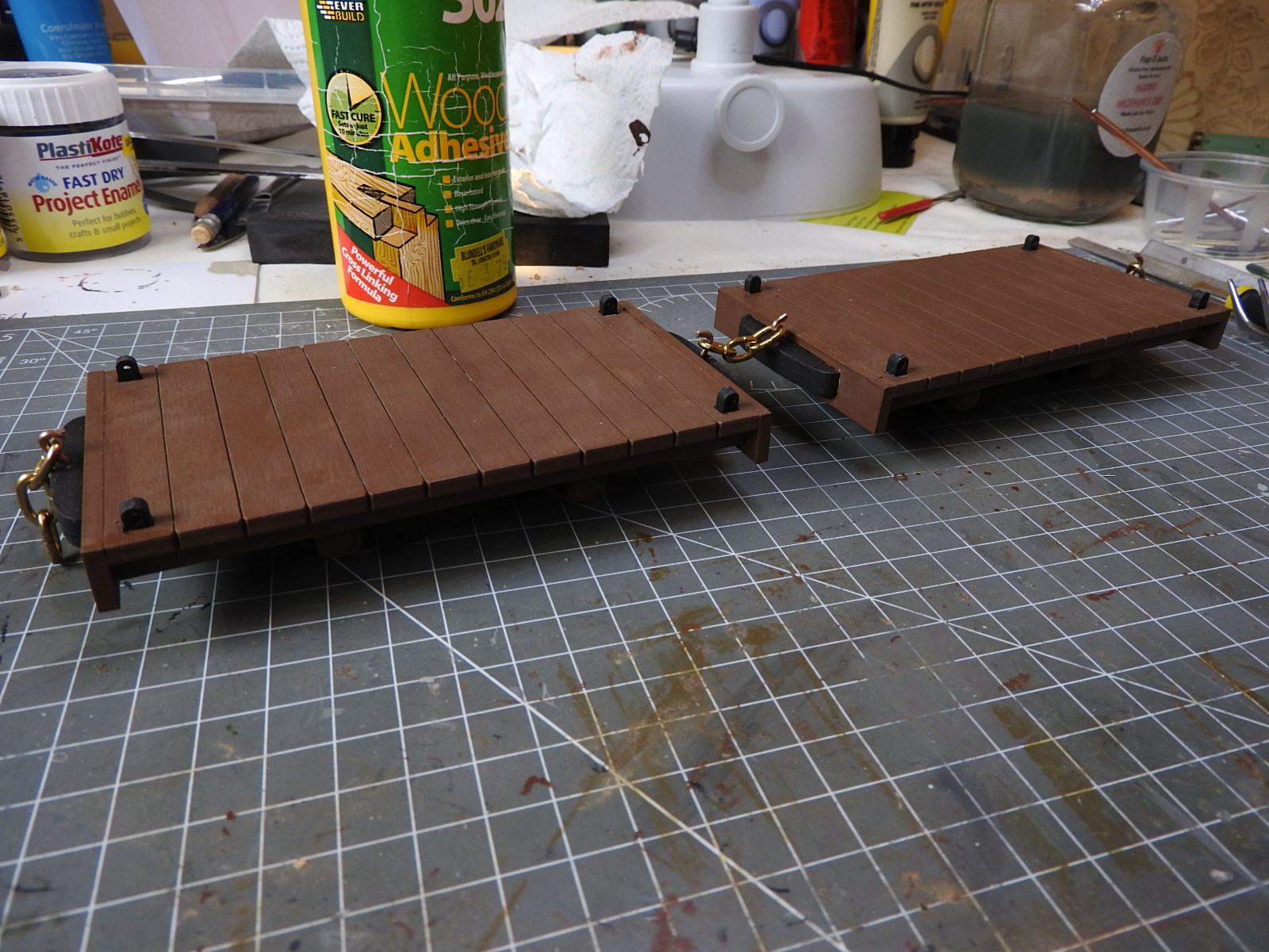

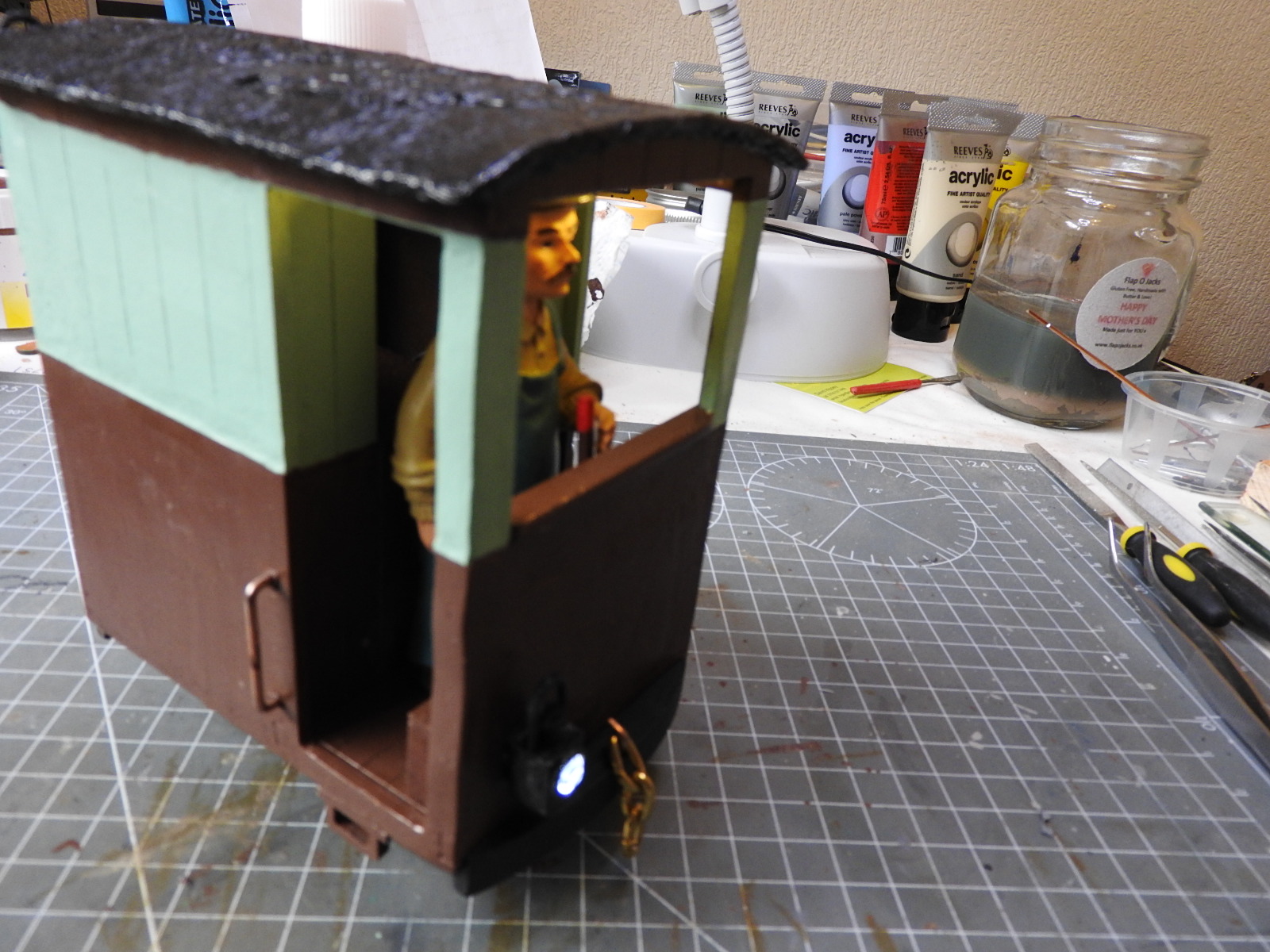

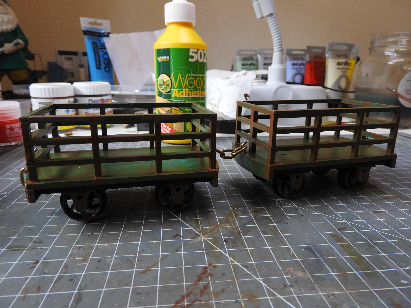

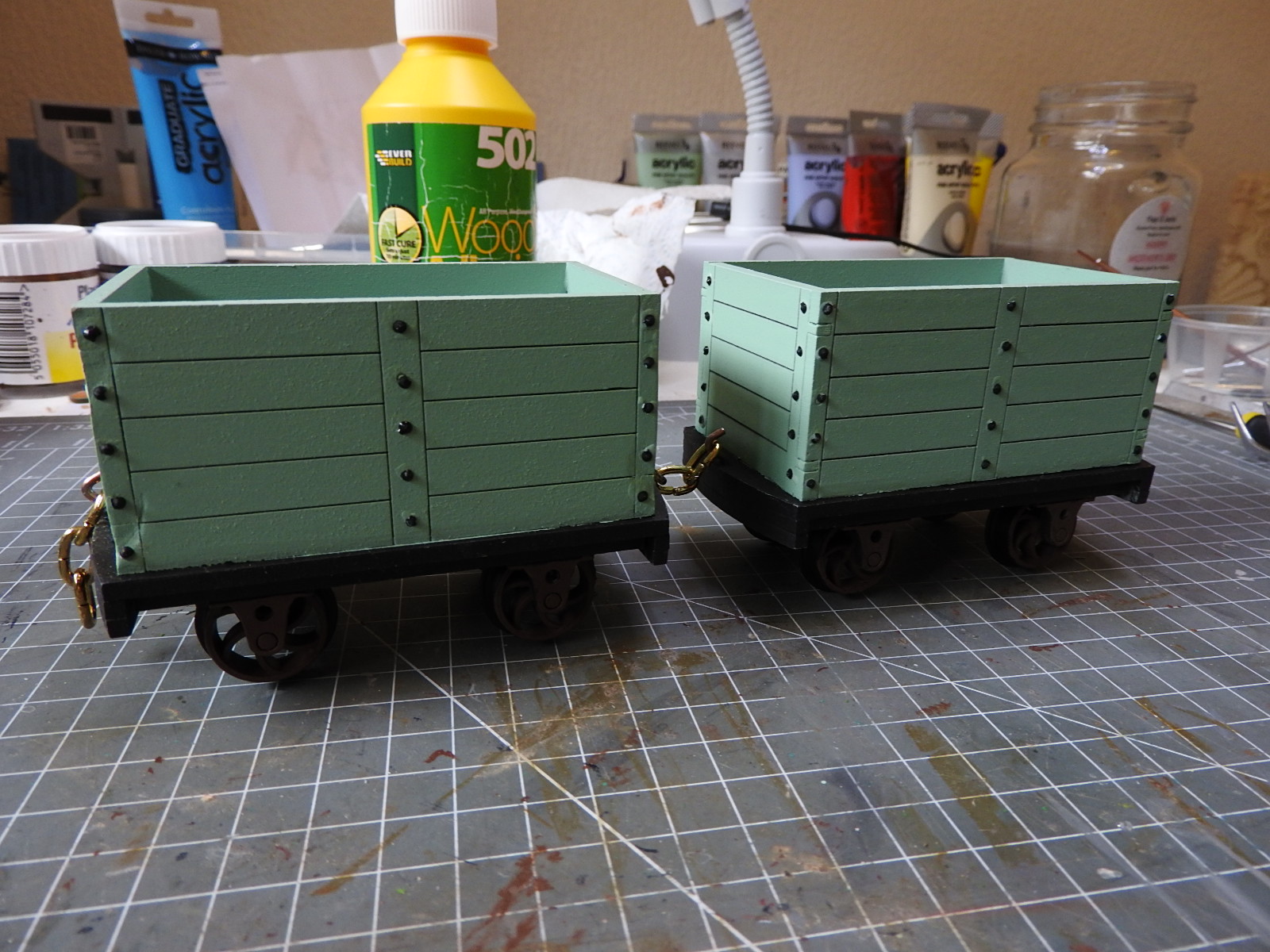

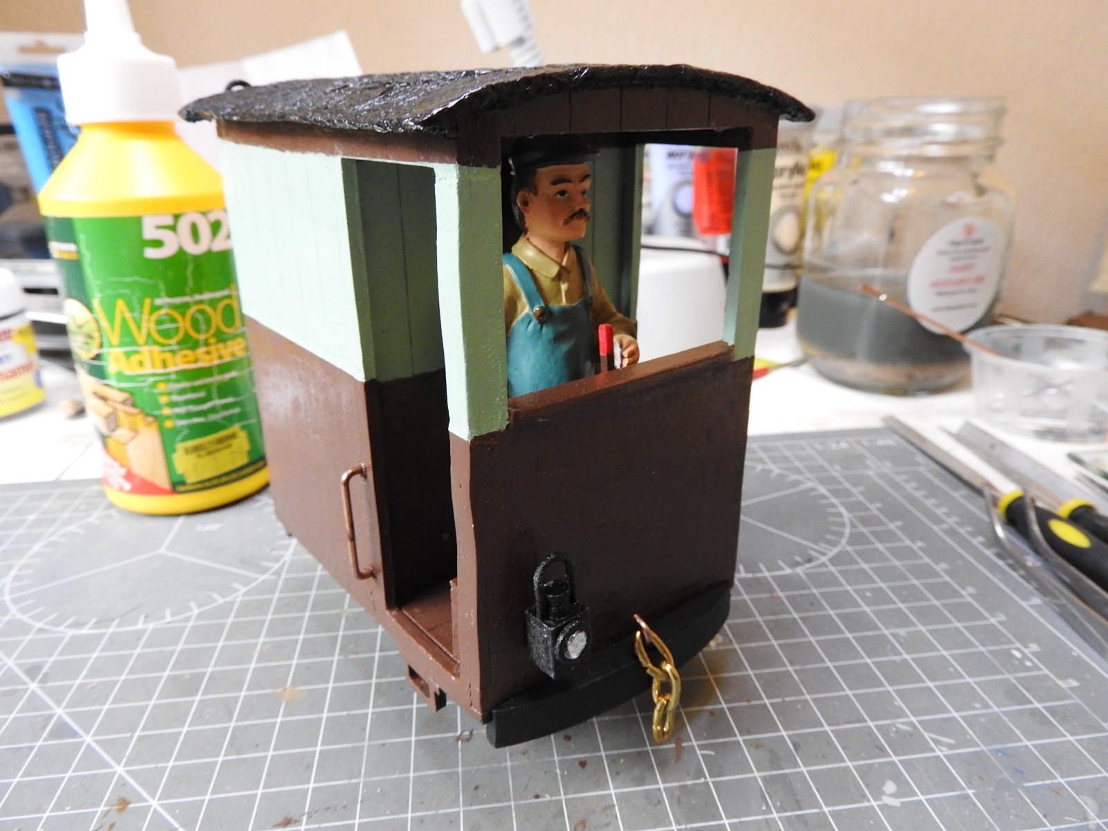

Did a few kits while I was poorly these last couple of months, not brilliant but Anne is happy with them. I like the Brake van, with the lights I fitted, you can’t see the red colour of the lamp, think it’s a camera thing, but they do improve the van.The roof is plasti-card with kitchen roll laid on with neat PVA, it goes all crinkle like tar as been laid on it. The body lifts off to get too the battery, not to happy with the paint work, I had to brush it, because Anne was insistent that I wasn’t to go to the shed while I had that flipping virus.
Anyway here they are.
The first two are Anne’s slate wagons that she wants to use has a static scene for her little slate mine, I do have a small flat wagon that I intend to convert to a little engine, that will have no working motor.
But that is a few weeks off yet, got others things to do, like sort the shed out with the damp issue when it gets a bit drier and do some more on the line, lots of little jobs that keep on coming…..lol. Oh and get some people, then the youngest Granddaughter will be happy there are some in the coaches and wagons…..

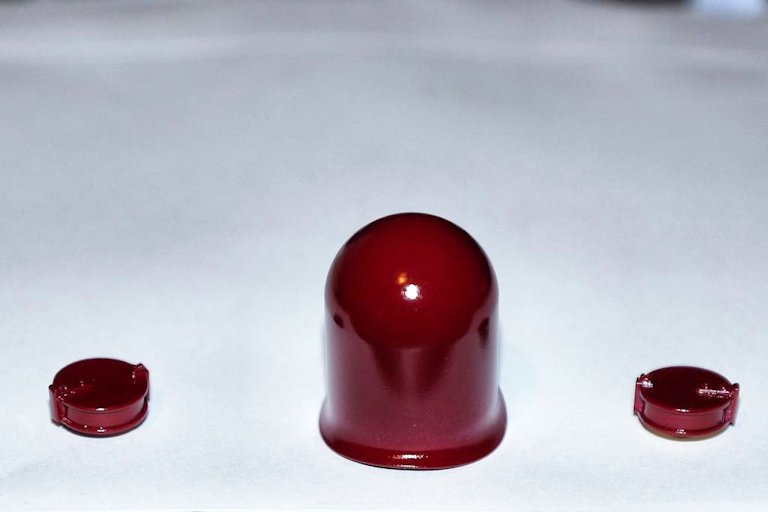

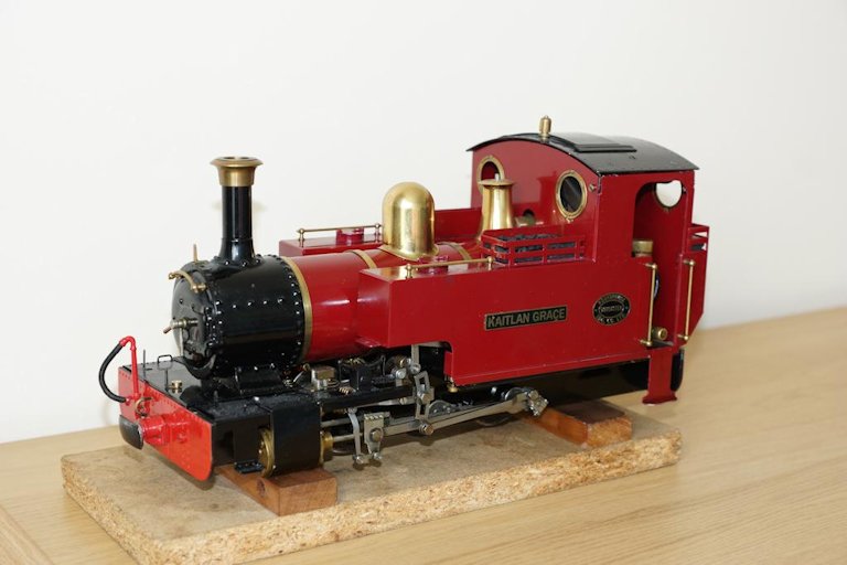

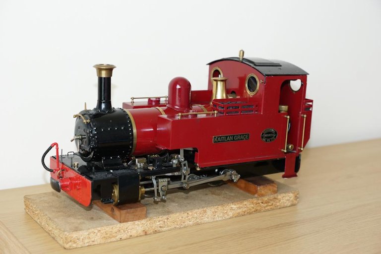

With Rod's permission, here are my pictures and some background of the repainted dome for my Lady Anne.
Most locos have a painted dome so I wanted to repaint mine in body colour. I also wanted a change of tank fillers which were also to be in the body colour. I contacted Roundhouse to ascertain the paint code/shade. (current models paint codes are now on their web site). When I explained my aim I was advised that as mine was an older model (2005 build) the paint used then was Rover Damask Red. Also as my dome was a polished one they suggested an unpolished dome was more suitable for painting. I purchased an unpolished dome from Roundhouse, and some tank fillers from Swift Sixteen.
I bought from my local Halfords the appropriate paint. I suppose any car paint supplier can supply the paint. Halfords is an acrylic formulation in a spray can. Red's can be translucent. I tried first on some scrap metal using black etch primer, but felt the colour not quite right, being a little too dark. A second attempt using grey primer was about right.
So the dome and tank fillers were sprayed accordingly. Two light coats of the final body colour. I will add a varnish in a day or two. The body is only placed on the loco for the pictures as there is a little more work to be completed.
I may also paint the boiler bands and handrails, but I haven't yet decided.
Lady Anne with a polished brass dome
Lady Anne with a painted dome

I do like both of your Lady Anne dome’s and I think the painted dome is very nice and clean, but I also like a bit of brass, so for me I would keep the boiler and handrails brass. But it’s your engine Ian and you do what please’s you mate, they both look great to me.
And thank you Ian for posting and showing me and the rest of the members how you achieved your match, it seems like there is a big difference in paint hues between Roundhouse and other company’s paint’s….
Keep on posting on here if you like by the way…. :thumbright: :thumbright:

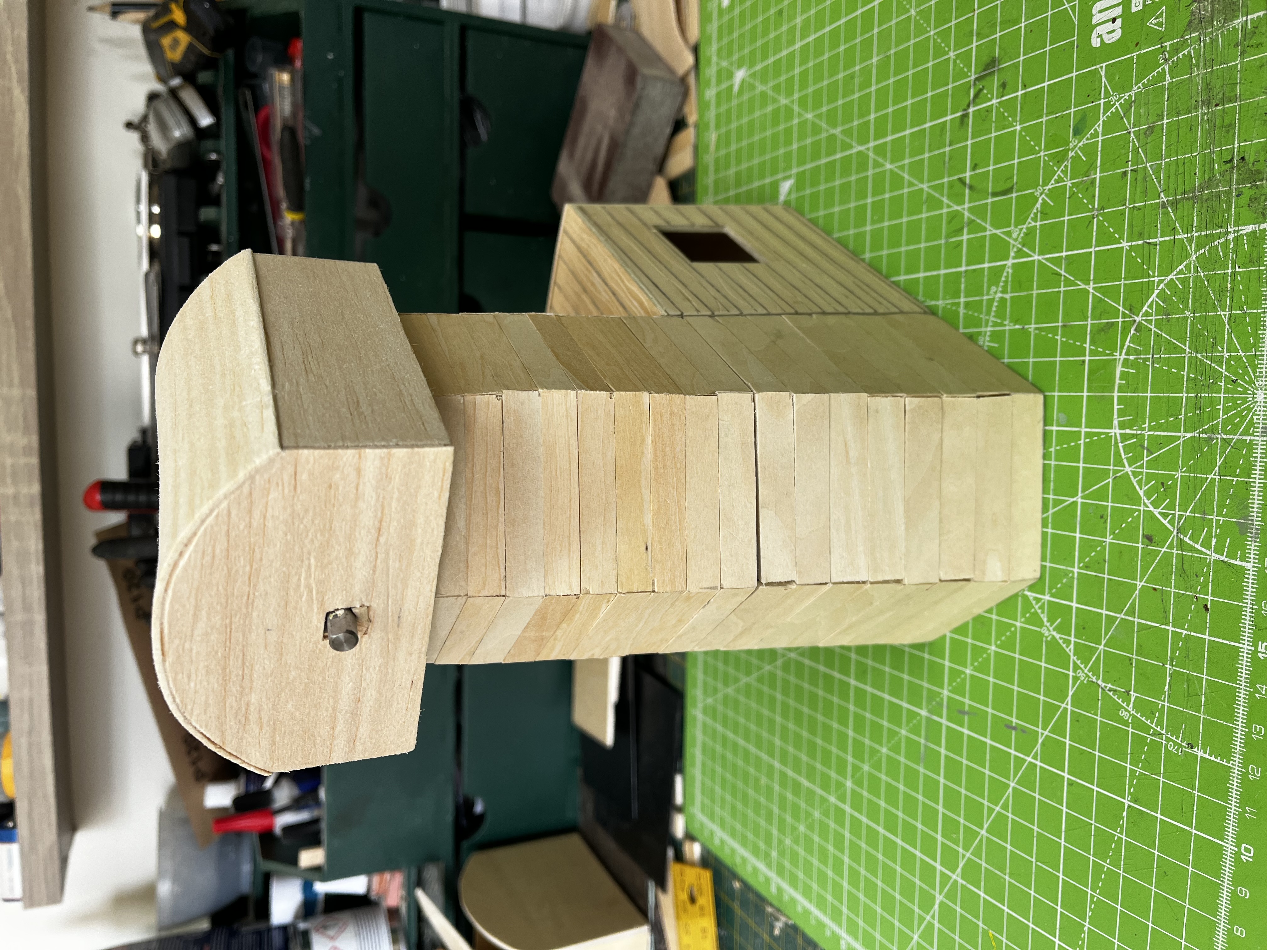

Post by FWLR » Wed Apr 23, 2025 11:40 am

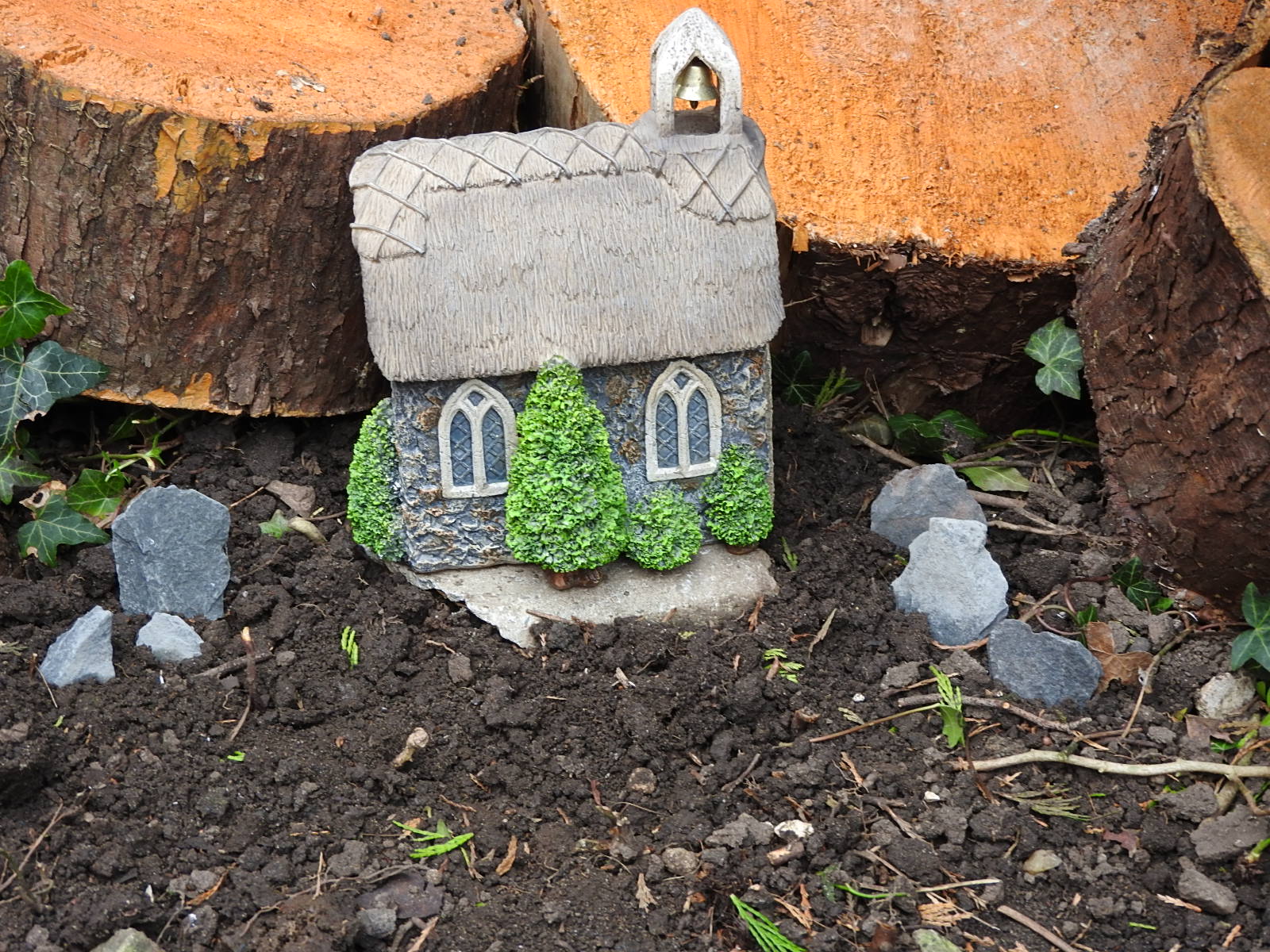

It's time I kept our Fairywood Light Railway going and stop going of track, no pun intended.. :P
I'am not going to put everything I have done with builds of new lines and such because they are in other threads, well not unless the Admin's think I should carry on with the other line's on here. I don't see any benefit only maybe members and non-members would find it easier to follow our progress. It would be an heck of a job though...... :thumbup:

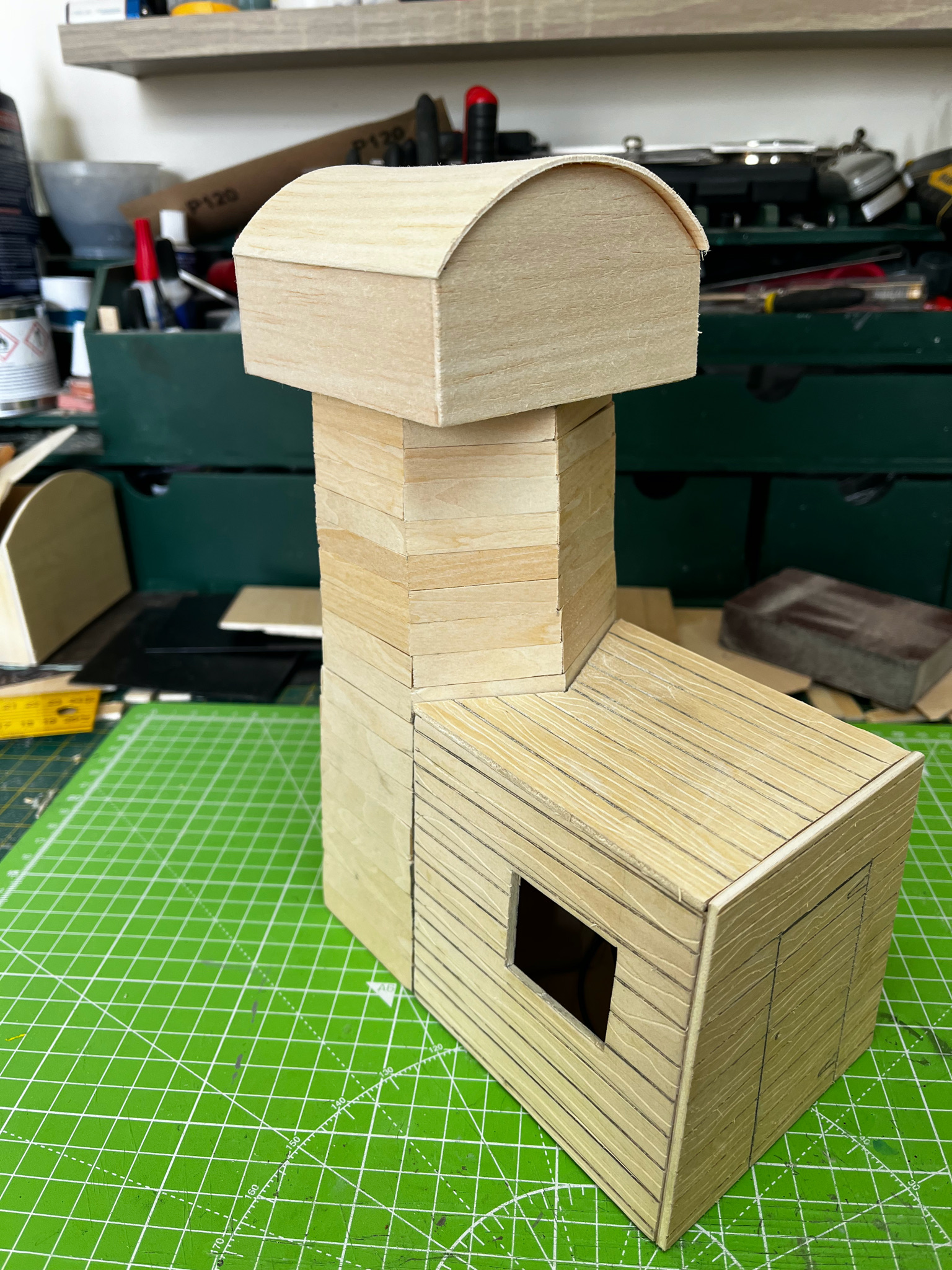

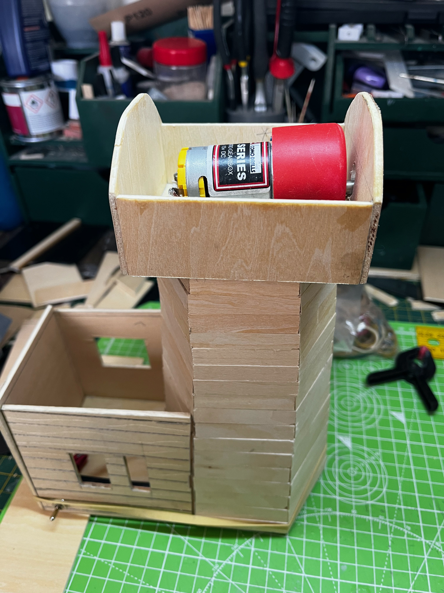

Anyway I have finished a build :thumbleft: it has taken sometime to do because of various happening with health and all that rubbish. It not something I planed to have on our new line, it was supposed to be for the line at our previous address, but I think you know how builds get put on the back-burner and it takes some time to get back to it.....
Any ideas..... :scratch:
Posts: 726
Location: Staffs. UK
Post by Phil.P » Wed Apr 23, 2025 2:44 pm
I think it could be a windmill?
Posts: 847
Post by drewzero1 » Wed Apr 23, 2025 7:00 pm
A windmill vane with operating shutters? :scratch:
Posts: 7886
Post by ge_rik » Wed Apr 23, 2025 7:53 pm
Or a Leonardo da Vinci helicopter.....

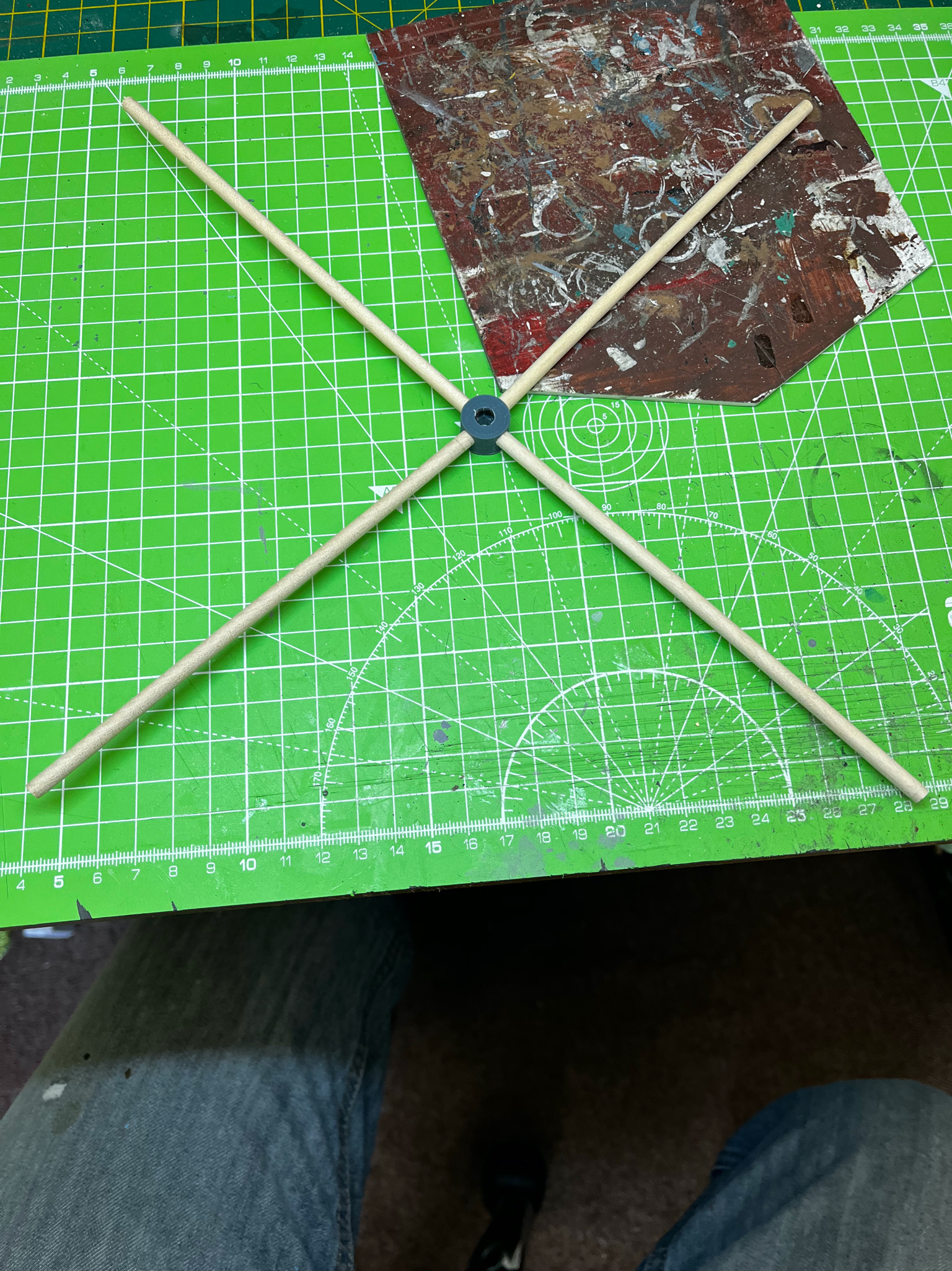

Post by FWLR » Thu Apr 24, 2025 7:03 am
Unfortunately it’s not a da Vinci helicopter Rik, although it would be an interesting idea 🀣🀣🀣

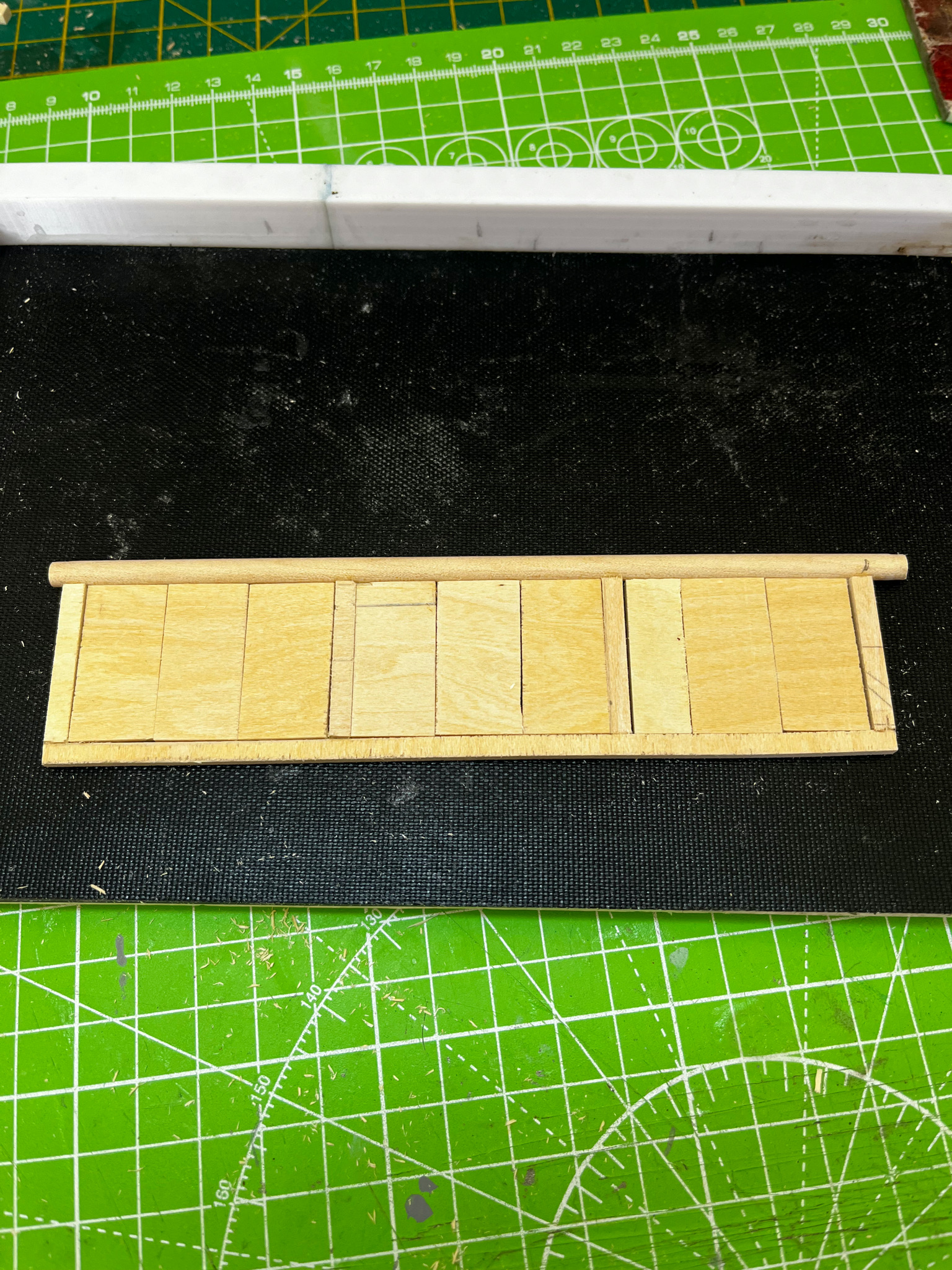

You’re all correct though :thumbleft: :thumbleft: but has usual with me I haven’t taken photos of the complete build :imsorry
I have taken a few though so here’s some more.
I used this motor that I have had in my lots of β€œthat will be useful for something” :lol:
The Naughty Elf’s in the Fairywood garden had some fun with the building after getting a bit tipsy drinking some Fairy juice, not me by the way :lol:
