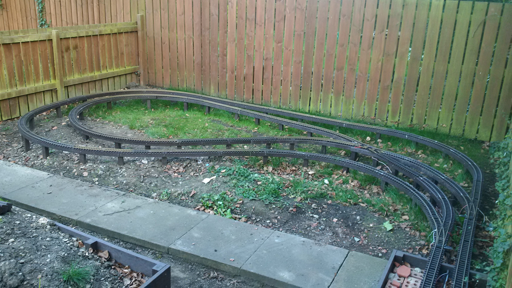

Post by stevenfitch » Mon Feb 13, 2017 8:10 pm
tom_tom_go:122723 wrote:I prefer the simple plan, less cluttered and train set looking.

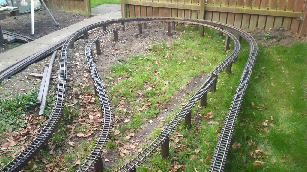

I think I may have the outer loop Lower than the inner (by lowering what is there now) then when the 'scenery' is built up around it will look a bit more natural.

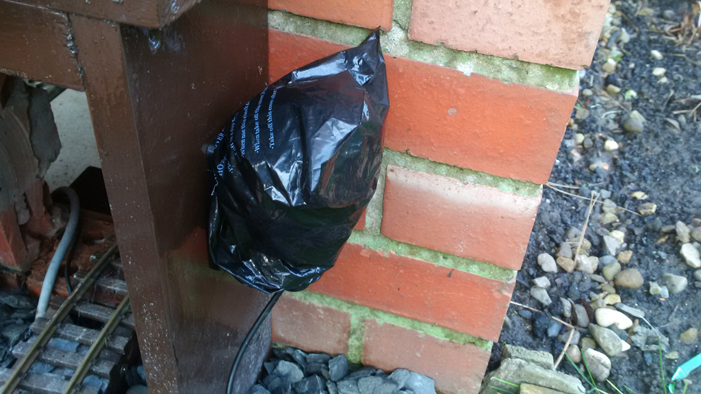

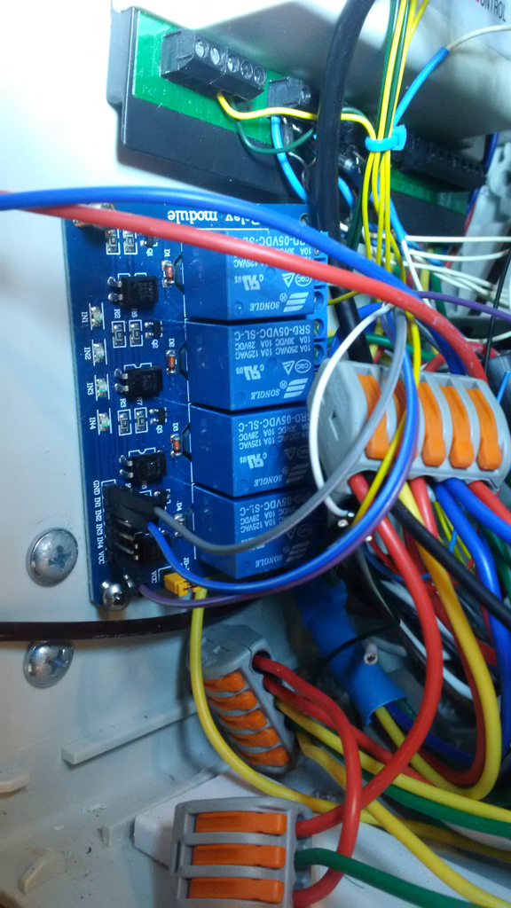

Post by stevenfitch » Sun Mar 12, 2017 9:55 pm
Installed a dusk / dawn sensor on the outside of the garage, this is then connected to a DS64 input (via a relay) so TrainController on the PC knows if it is dark outside and turns the loco lights, carraige lights and tail lights on when trains leave the garage.
Test it with a black bag to simulate darkness and all working.

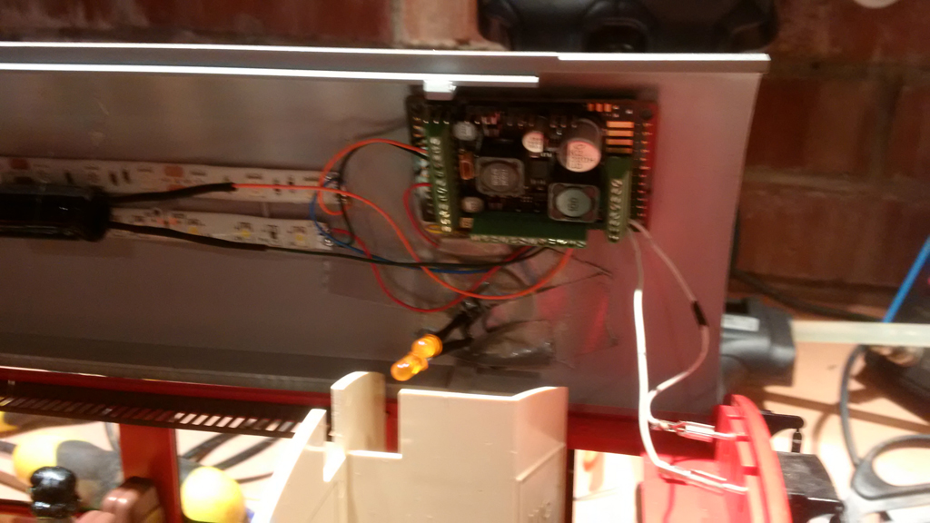

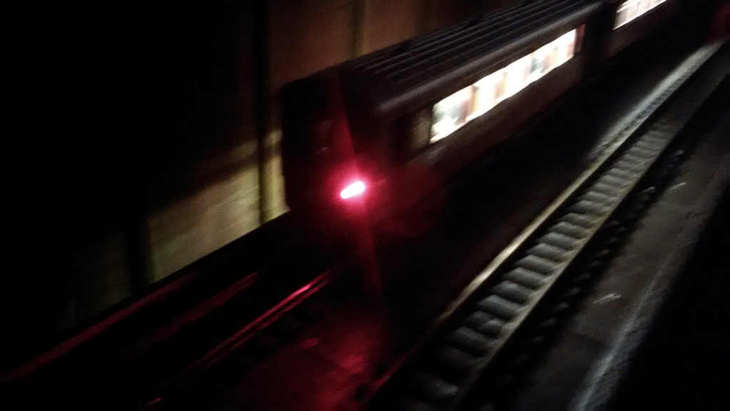

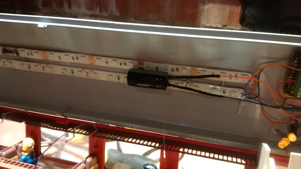

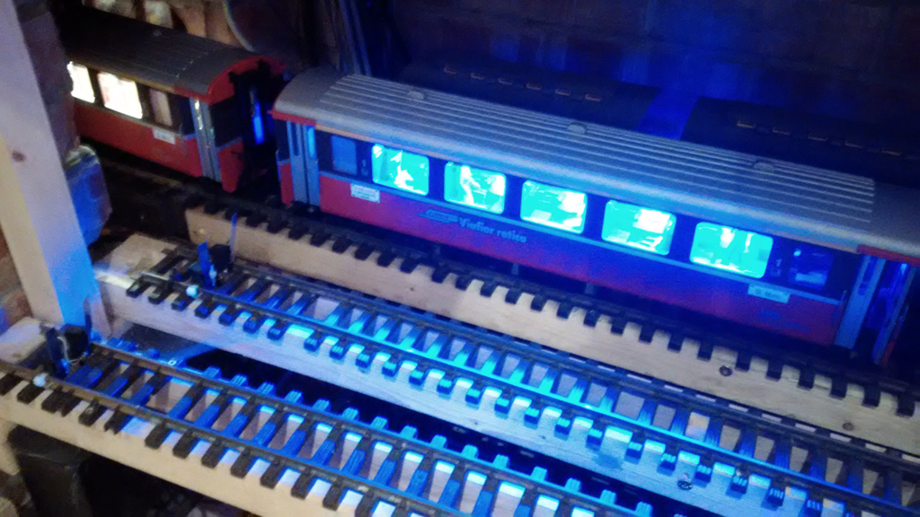

Post by stevenfitch » Sun Mar 12, 2017 10:04 pm
Using LED strips inside two coaches and a couple of spare decoders i had...
We now have a choice of blue, white or combined lighting + the rear coach has a red tail light and the other one has separate lights in the toilet compartment.
Post by Big Jim » Mon Mar 13, 2017 8:40 am
That is a very cunning idea.
It just shows how far this hobby had moved over the years.

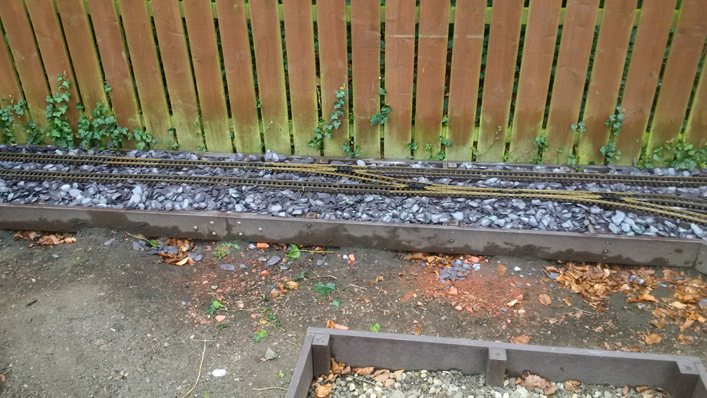

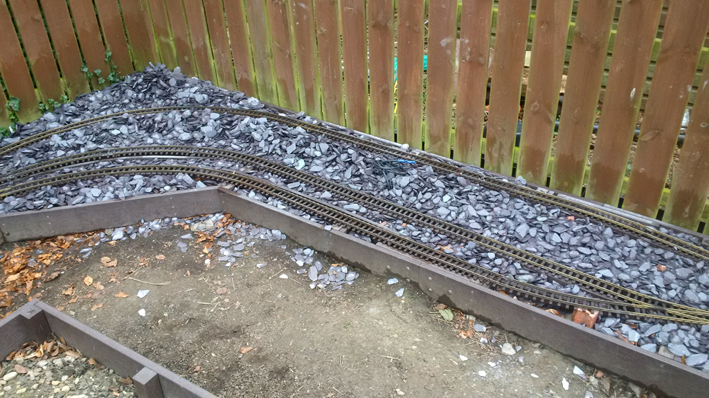

Post by stevenfitch » Sat Apr 08, 2017 7:23 pm
Back area trackwork in progress, just the block wiring left to connect.
Half way through
Half way through
Finished track ready to be fixed in place
Re: UK Rolling Stock in G - Project not yet started
Post by tom_tom_go » Sat Apr 08, 2017 9:06 pm
That is going to be a busy railway when it is finished Steve.

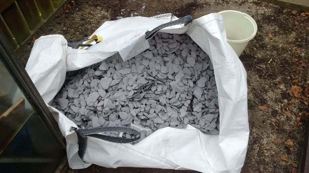

Post by stevenfitch » Thu Apr 13, 2017 1:24 pm
On with the 'scenery' - this arrived full this morning
Then got spread out to fill in the back area, piled up high at present as from past experience it settles quite a bit.
Will possibly do a top cover of smaller size slate chippings (20mm i used everywhere else, these are 40mm as that's all the patio center had in a dumpy bag)
Next step is some of that plastic fake grass to go round the vegetable patches

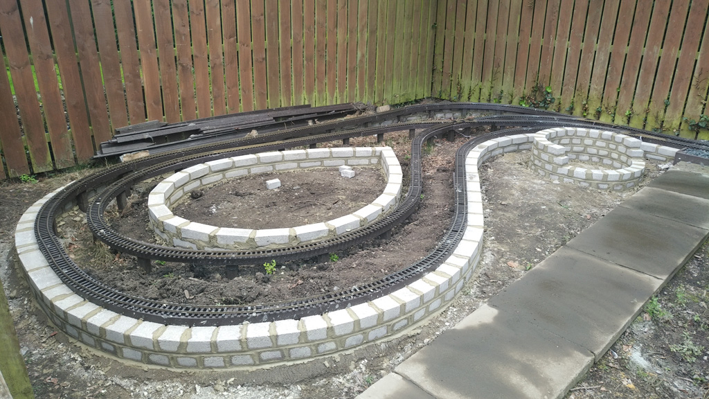

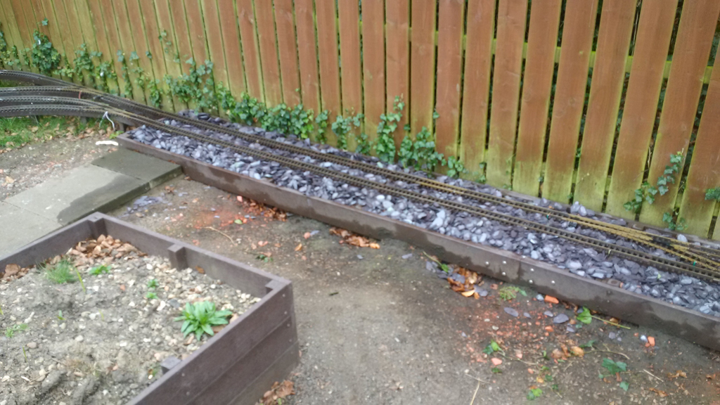

Post by stevenfitch » Fri Aug 04, 2017 8:04 pm
Progress has begun on landscaping / walls on the back return loop area.
Post by tom_tom_go » Fri Aug 04, 2017 8:11 pm
Getting there Steve, looks promising...
