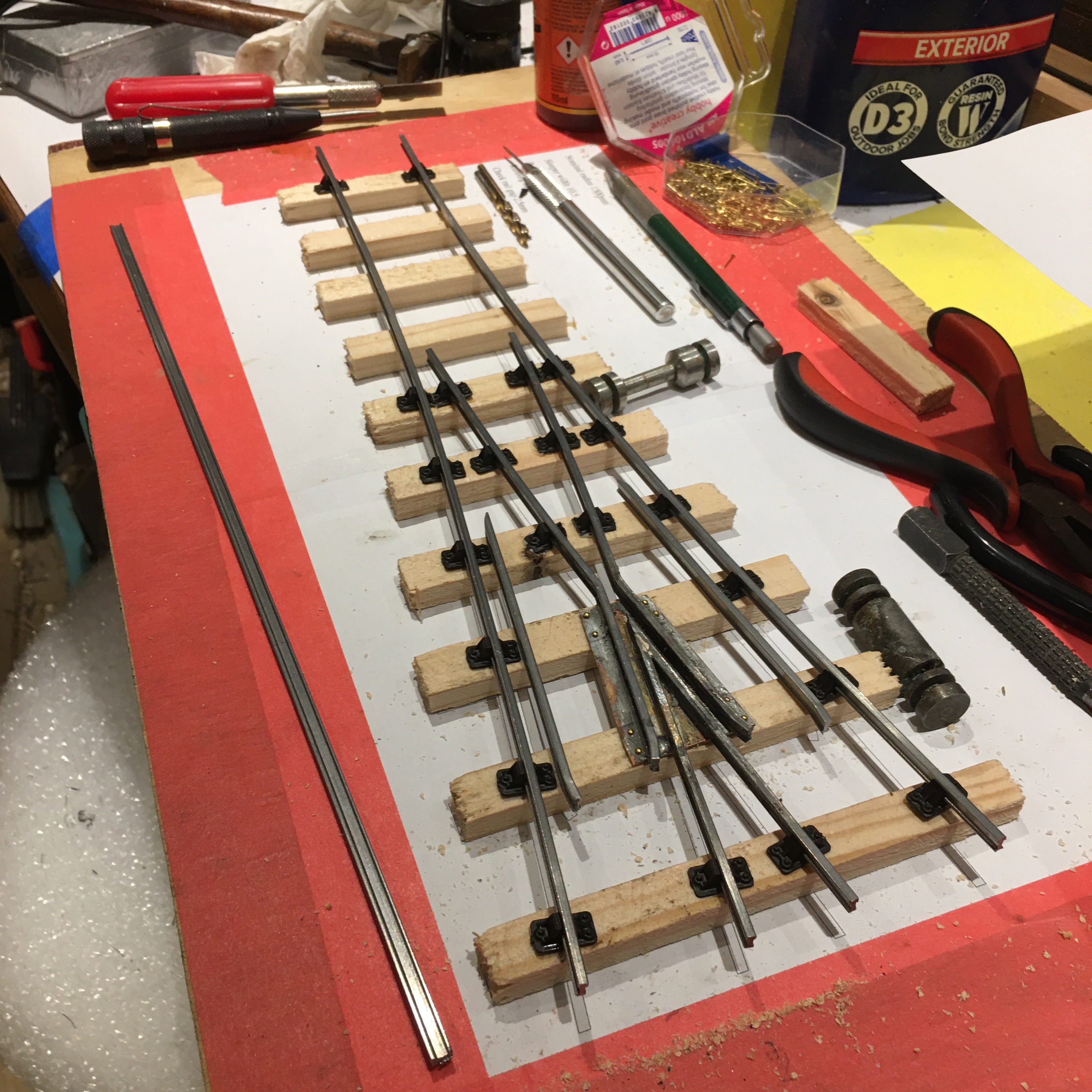

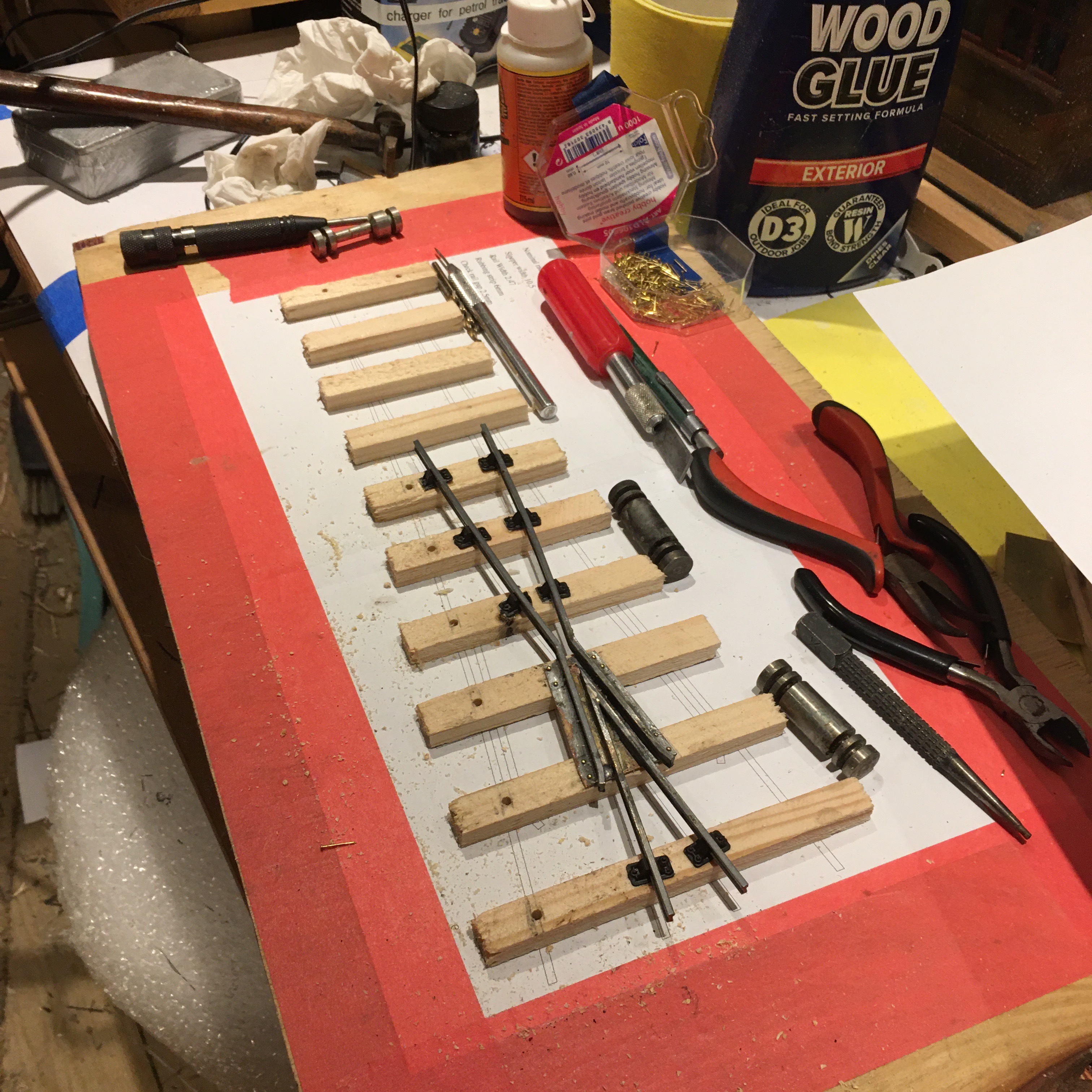

The point is progressing:
the soldered frog and wing rails fitted:
The chairs are fitted into holes, and glued in place as well. There are 8 brass pins holding the frog in place (as well as glue).
and the outer rails temporarily fitted in place:
I positioned the outer rails using the track gauges, marked where the rails crossed the sleepers on both sides of the rail, and drilled holes central between the two pencil marks. The temporary assembly is to make sure that the holes were actually in the correct places - and that the track gauges fit easily. Proper check rail chairs to be fitted before final assembly.

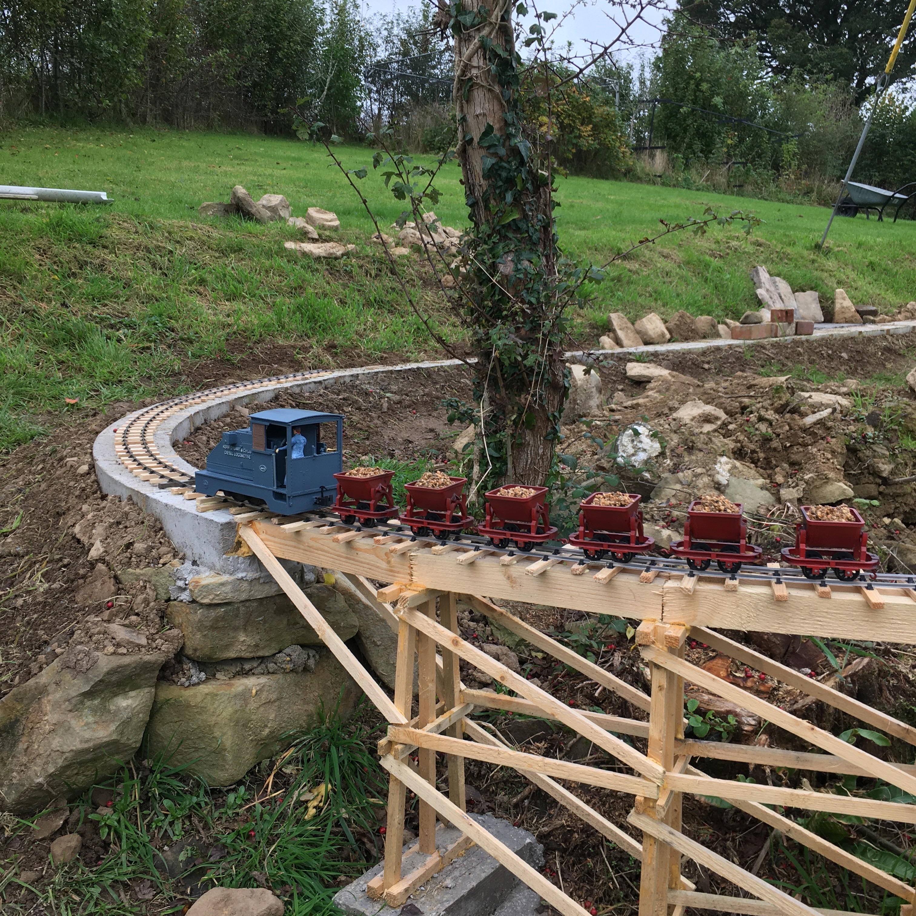

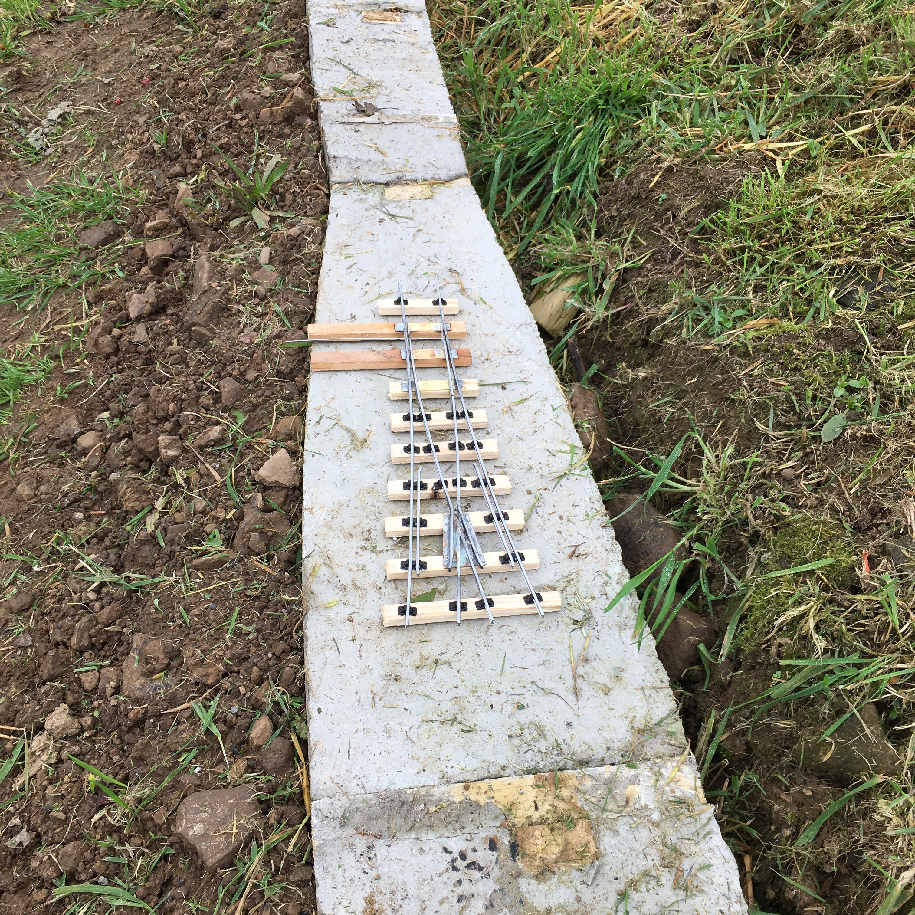

Going back to progress on extending the railway.
The track has now reached "dry land" at the other end of the viaduct: and I am thinking about the passing loop. The first point offered up to see if it fits:

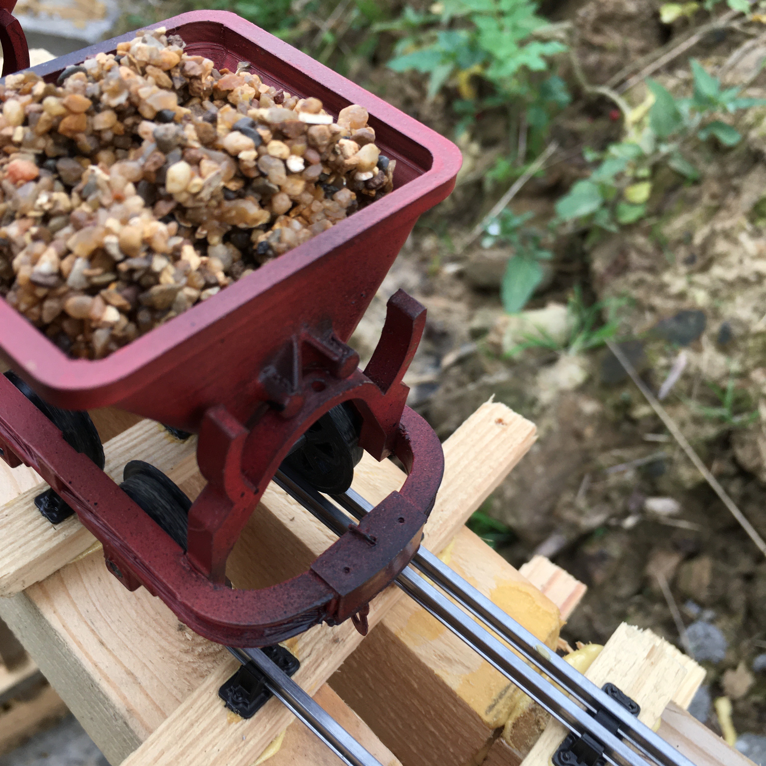

I have realised that I have actually made an error here. The check rail chairs that I have used are actually designed for G1. And for Course scale G1 at that. So the end result is that the gap between running rail and check rail is 3mm rather than the 2.5mm which seems correct for 32mm narrow gauge. Bit of a pity really all that effort and extra expense and it isn't correct. Too late now! However I have tried a few different vehicles on the viaduct and the check rail isn't far off touching the back of the flanges - particularly on 4 wheel stock. Perhaps since it is on a curve that brings the flanges closer to the rail - so perhaps it isn't an issue. If you look closely at the photo you should be able to see that the flange on this wagon is near enough touching the check rail:Lonsdaler wrote: Fri Oct 08, 2021 6:21 pm I can't see how you've fitted the check rail - is it a double shoe or have you sliced part off the checkrail shoes? Either way it looks great. Looking forward to seeing it progressing.
On the other hand it is an issue on the point. The wheels on test wagons just climb the frog - and its that 3mm gap which is the issue. So I am going to modify the point. I will cut through the middle of the check rail chairs (only 3 each side) and prize up the check rail. If I cut through with a cutting wheel in a dremel that should allow me to close the cut, and pin them down again at the correct spacing using a track gauge to make sure they go down in the correct position. I have noticed that if I cut off the bolt heads with a knife I can usually get a 0.9mm hole in the correct place and then use brass pins - the sort used for making model boats.

- Posts: 1209
- Location: South West Wales

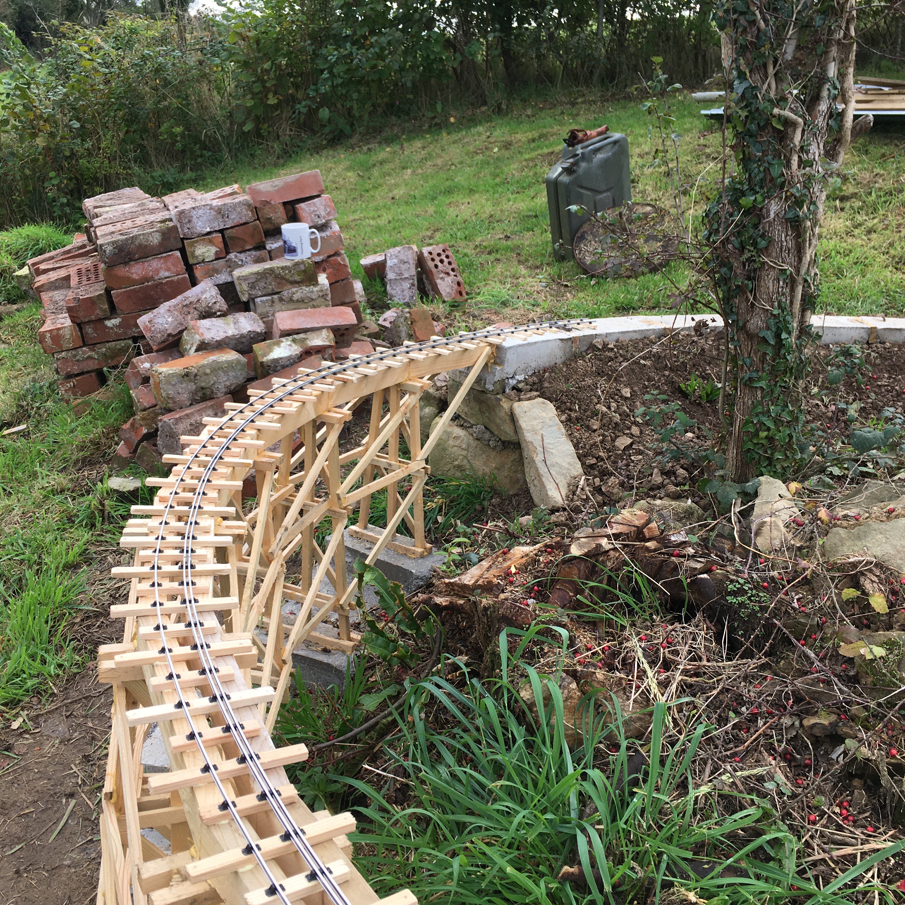

Testing the track on the viaduct:
The first train to pass all the way from one end to the other.
and to arrive on dry land at the other end.
Next stop the passing loop and Dduallt station building.
- Posts: 8052
Better that way round than vice versa ........Trevor Thompson wrote: Sun Oct 17, 2021 8:32 pm ....... the gap between running rail and check rail is 3mm rather than the 2.5mm which seems correct for 32mm narrow gauge.

On the point:
Could fit a thin brass shim, folded to slip over the check rail?
Something similar is often done on G scale track..
- Posts: 1209
Yes I think you are right. The more I think about it the more I am happy with it. I have been thinking about how a tight check rail might introduce lots of friction. Imagine a long train going uphill and all the wheels touching the check rail - that could be a lot of extra friction. So may be its just as well as it is.ge_rik wrote: Sun Oct 17, 2021 9:10 pmBetter that way round than vice versa ........Trevor Thompson wrote: Sun Oct 17, 2021 8:32 pm ....... the gap between running rail and check rail is 3mm rather than the 2.5mm which seems correct for 32mm narrow gauge.![]()
- Posts: 1209
That is an idea I hadn't come across. If I had fixed the point in place it would have been a good solution. Since it is still in the workshop I think I can move the check rail.Phil.P wrote: Sun Oct 17, 2021 10:44 pm On the point:

Other than for appearances sake, I'm not sure how effective a check rail will be, but even at 3mm the gap looks more prototypical than my attempt using individual Peco chairs. It's all looking the part, and it's survived first contact with a train - well done. Interested to see what you are going to do about preserving the wood/ colourationTrevor Thompson wrote: Sun Oct 17, 2021 8:32 pmI have realised that I have actually made an error here. The check rail chairs that I have used are actually designed for G1. And for Course scale G1 at that. So the end result is that the gap between running rail and check rail is 3mm rather than the 2.5mm which seems correct for 32mm narrow gauge. Bit of a pity really all that effort and extra expense and it isn't correct. Too late now! However I have tried a few different vehicles on the viaduct and the check rail isn't far off touching the back of the flanges - particularly on 4 wheel stock. Perhaps since it is on a curve that brings the flanges closer to the rail - so perhaps it isn't an issue. If you look closely at the photo you should be able to see that the flange on this wagon is near enough touching the check rail:Lonsdaler wrote: Fri Oct 08, 2021 6:21 pm I can't see how you've fitted the check rail - is it a double shoe or have you sliced part off the checkrail shoes? Either way it looks great. Looking forward to seeing it progressing.
