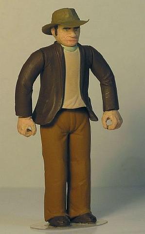

Post by LNR » Tue Nov 22, 2016 2:31 am

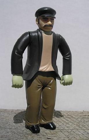

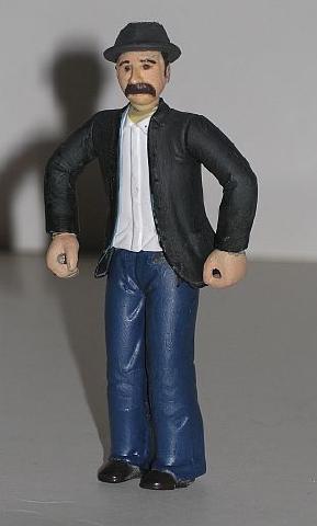

I often find I want a job in the workshop that requires minimal thinking, something straight forward, that can be finished quickly.
So chop some hands and legs off.
Drill hands and arms for pins so they can be re-positioned, likewise legs off below the knee, drilled for long pins to give some extra height (Don't know where Mr. Bachmann gets his figures from, but they all seem very short in the legs) add styrene tube sections to save a bit of putty, add putty file and paint. Unfortunately can't change the "I'm a weight lifter stance" but they'll do.
I'm sure most would know this bloke, generally hangs out on a gangers trolley with a mate.
Now I hope he looks a little more Australian. He's eating better his hands are no longer green, and he got a new hat with brim of foil too!
His mate got the same treatment. Both had about 10mm added to the legs.
Disclaimer- no humans living or otherwise, were hurt during this procedure.
Posts: 7987
Post by ge_rik » Tue Nov 29, 2016 8:52 am
Brilliant! Can't spot the join (as a certain Eric Morecambe used to say!).
PS Shouldn't he have corks around the brim of his hat? (Sorry, yet another national stereotype wheeled out from the archives!)
Posts: 1888
Post by LNR » Tue Nov 29, 2016 10:18 am
Thanks Rik,
when up in the Territory, if you saw anyone with corks around his hat you knew you were looking at a tourist. Always a good laugh.

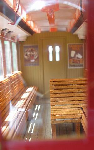

Post by LNR » Sun Dec 25, 2016 1:10 am
Christmas day, Australian Summer. Carriage is hot, been sitting in No. 2 road.
Better get some windows open!
Not many passengers today.
Post by Soar Valley Light » Wed Dec 28, 2016 9:20 pm
I love that Grant, it's a great shot. The photography itself is creditworthy but the subject is really remarkable. Well done and thanks for the continued inspiration.

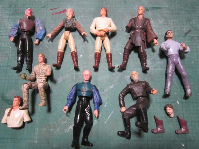

Today our Club exhibited at the local Toy and Train Fair and one of the traders kept her promise by giving me a bag full of moulded figures, each very close to 16mm scale. But..... as my railway isn't set in the 22nd Century there may be some work to do......
Some have parts missing, so a bit of careful surgery is required.

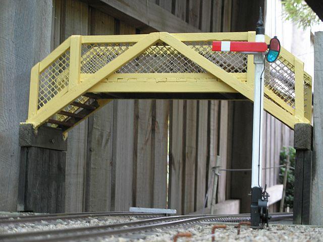

Post by LNR » Sun Mar 12, 2017 8:08 am

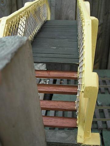

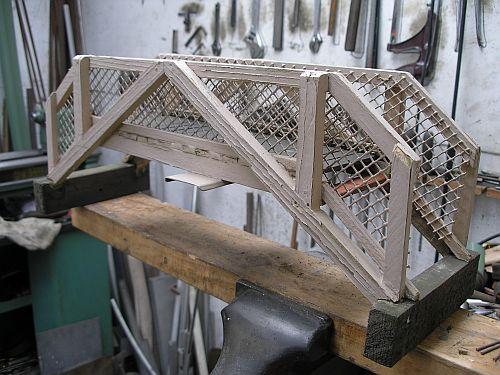

Public Works were on the job recently, the footbridge at Leawarra has been closed "Out of Use" due to missing steps.
The bridge got a new set of merbau steps, nailed in this time.
A strip of the old flaking paint work and the first coat of new paint applied.
More coats to follow.
Posts: 1142
Location: haverhill suffok
Post by jim@NAL » Thu Mar 23, 2017 12:33 pm
very good bridge I like the colour and looks perfect too scale

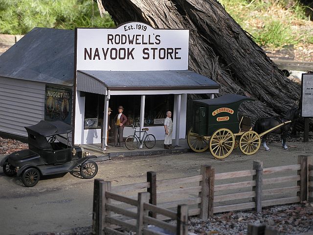

Post by LNR » Thu Mar 30, 2017 3:22 am

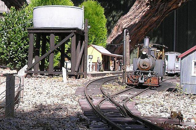

Just testing picture loading.
GR 7.JPG (98.57 KiB) Viewed 9037 times
Posts: 1511
Re: A Quiet Sunday
Post by Lonsdaler » Thu Mar 30, 2017 9:22 am
Looks like a nice bit of evening sun, or is it light reflected from a window elsewhere? Either way, another stunning tableau. 8)
