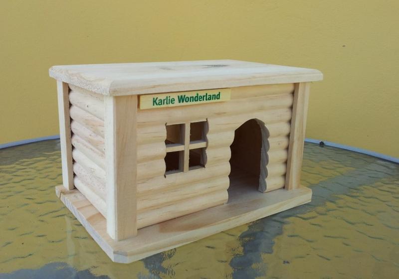

I was at the pet shop and when i walked past the rodent section, a couple of items caught my eye.
Very cheap too , i will see how they hold out to the elements. Here are a couple of pictures in their original state and after i coated them with lacquer to make them last longer
Necessity is the mother of invention as they say :-)
