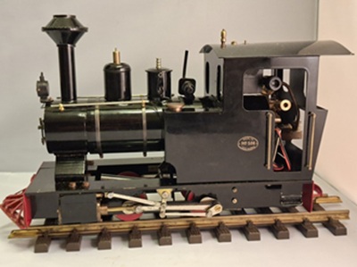

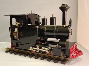

Hello,
Since I received no response to my inquiry in the thread,viewtopic.php?p=187742#p187742 I decided to buy the Merlin. It was being sold by an American seller who had several other locomotives on offer (including a Roundhouse 7/8 scale "Jack" version, partially built).

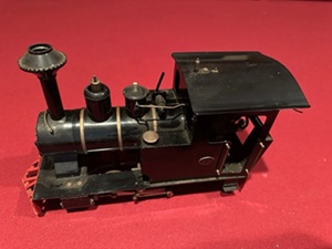

As seen in the auction photos, the engine was offered in a rather grimy condition. That is always the issue with eBay auctions: what is the overall condition of the item being sold? An inquiry to the seller yielded no response other than a price reduction; I suspect he didn't really know what he was selling.
After delivery from across the pond, I confirmed that the photos hadn't lied: there was a lot of dried, stubborn grime—a mixture of steam oil, dust, and other residue—on the bodywork. An initial test using compressed air resulted in no movement. The linkages, valve gear, and steam rods on the left side had apparently been secured with a contact adhesive that prevented any movement. So, I softened everything with solvent. The result, using compressed air, was lively movement in both forward and reverse directions.

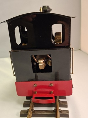

Some components—such as the chimney top, the smokebox (not the typical Mayflower U-shape), and the dummy turbo-generator—appear to have been taken from the Merlin "Matterhorn" model. A solid cast-tin cowcatcher is also fitted. The windows are rectangular in shape, unlike the round ones found on the Mayflower models.
I utilized the existing blanking screw on the boiler backhead—just as I did with the Merlin Mayflower "Hutzel" viewtopic.php?p=163647#p163647—to install a steam whistle; this time, however, I extended the banjo bolt and installed an inline Regner refill valve.

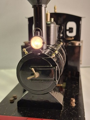

I also fitted a headlight using a Regner 6V bulb and Teflon-insulated wiring. The cable is routed through a 2mm stainless steel tube (which now serves as a handle) to the cab and power supply.
Testing on a roller test stand using steam yielded good results. However, a run on 45mm track revealed that a significant amount of steam pressure is escaping from the rear of the piston rods (at the seals).
I will be taking the Merlin to a model engineering exhibition in Tulln, Lower Austria, next week, so videos will follow.

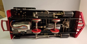

A battery pack and a receiver for a 2.4 GHz control system still fit inside the frame.
