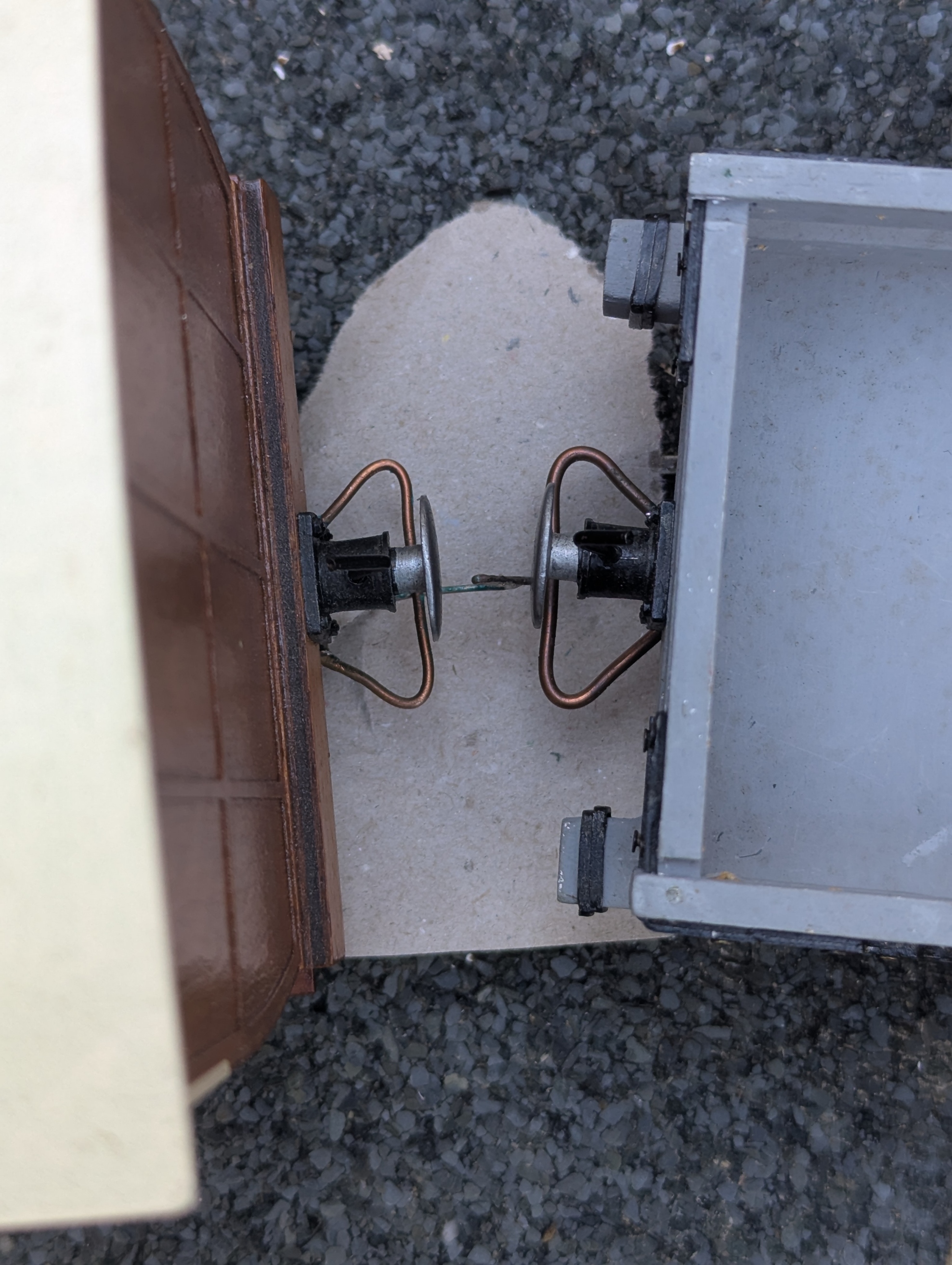

Thank you Philip and Rik for your comments and advice. On reflection I can only agree with Philip about the more exacting standards of S4 modelling when judged against the relative "sloppiness" of SM32. Although most of my curves are set at 5 feet I do have one that reduces to 4 feet and I can see problems in getting chopper couplings to work with a high degree of reliability in these circumstances. I have therefore dismissed that idea and gone back to working on Rik's solution.
First of all, because I felt the coupling action was too "harsh" , I substituted the phosphor bronze hook with a thinner wire of sprung steel as here I wasn't happy with the result (still making the wagons bounce down the track rather than couple up) so went back to the phosphor bronze spring but added a double loop - thereby making it longer. There was a small improvement but not significantly so. See here Finally, and having remembered how Sprat and Winkle couplings work I made the hook pivot rather than use a fixed point. Rather than start from scratch , having made about six of Rik's brackets with attached bars, I soldered the hook to a short stretch of brass tube which has a length of 2mm brass rod running through, the ends of which are soldered to the angle of the bar. I soldered a simple piece of brass behind the pivot to make a counterweight. Hopefully all this is shown in the attached photo. I have taken another photograph of this from the side (but have run out of space in this post to include it) and have recorded two short videos of the "before and after" differences which, when and if I work out how to do it will attempt to post on here.
In short however the pivotted version of "Rik's hook" now works without the stock having to crash into one another. The short length of nail that is soldered to the hook in the last photo is to form the dropper to be attracted by a magnet to be placed in the track but as yet I haven't advanced that part of this conundrum. I still need to do more work to arrive at the "ideal" set of dimensions etc. for SM32. The trick is to make the hook so that the paddle side is just heavy enough to hold the hook in the elevated or upper position but needs little sliding resistance to make it slide down and behind the bar. I have also found that using fine emery paper on the sliding surface of the hook substantially assists a smooth coupling action.
My thanks to Rik in particular for providing the initial ideas and inspiration to carry out this experiment. I will post further if all continues to work reliably.
Bryan

Here is the final photograph showing the pivoted hook from the side

I like the ease with which the stock coupled and uncoupled , which reminded me of my S4 layout using Alex Jackson couplings. It was however a comment from Philip about the relative exactness of working standards that set me to have doubts. In particular I have a particular need to couple and uncouple stock on a 4 feet radius curve. The Hambleden model is relatively small (by outdoor garden railway standards) is end to end and has no sharp bends or curves. Above all it is an indoor railway. The question is, would all that work equally well outside with sharpish curves, possibly uneven track (subject to movement thanks to the elements) and things like high winds and "leaves on the line". From what I can discern the hook part of the chopper has to meet its opposite housing over a relatively small "target area". This is clearly reduced even further when choppers are used on both ends of the vehicle. I realise that once coupled up the couplings could swing sideways with the movement of the stock when traversing curves. However, could they couple up on a curve when the two wagons or whatever were at an angle to one another? Given the cost of a pair of couplings ranging from £10 and upwards and with (currently) some 25 items of stock to convert I decided it was not a path I wanted to tread. I hope that my rather throwaway remark now makes sense.
In contrast I have tested my Rik-inspired couplings on the sharpest curve I have and they couple as easily as they do on the straight. This is due to the much wider target area offered by the loop. Here are some photos (In case you are wondering I have placed a piece of paper underneath so that you can see things: it is not normally there!)
