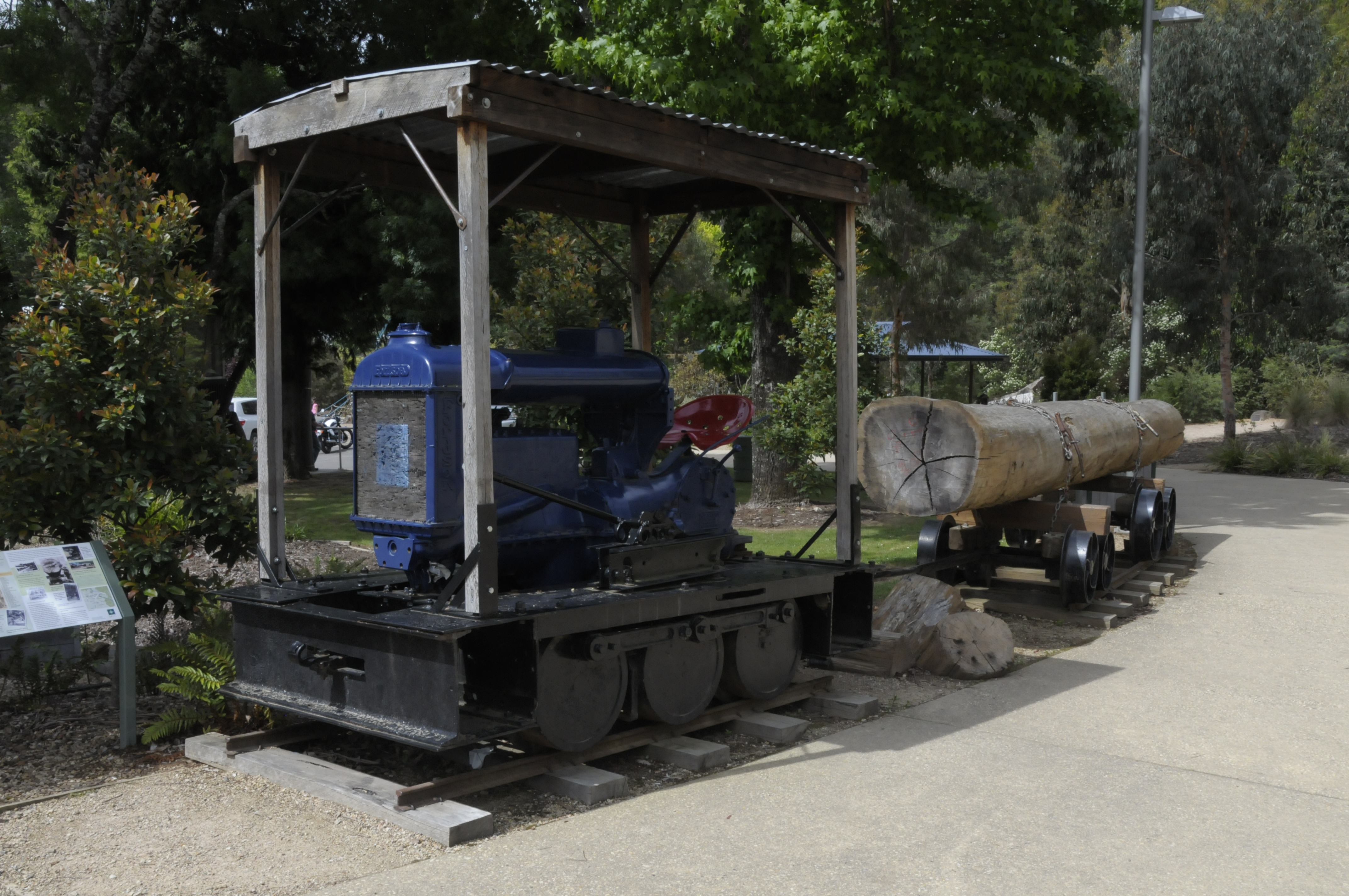

The Days tractor at Marysville was in the 2009 Black Saturday fire that destroyed the town along with the loss of 15 lives but has been refurbished and is now located behind the new visitors' centre.

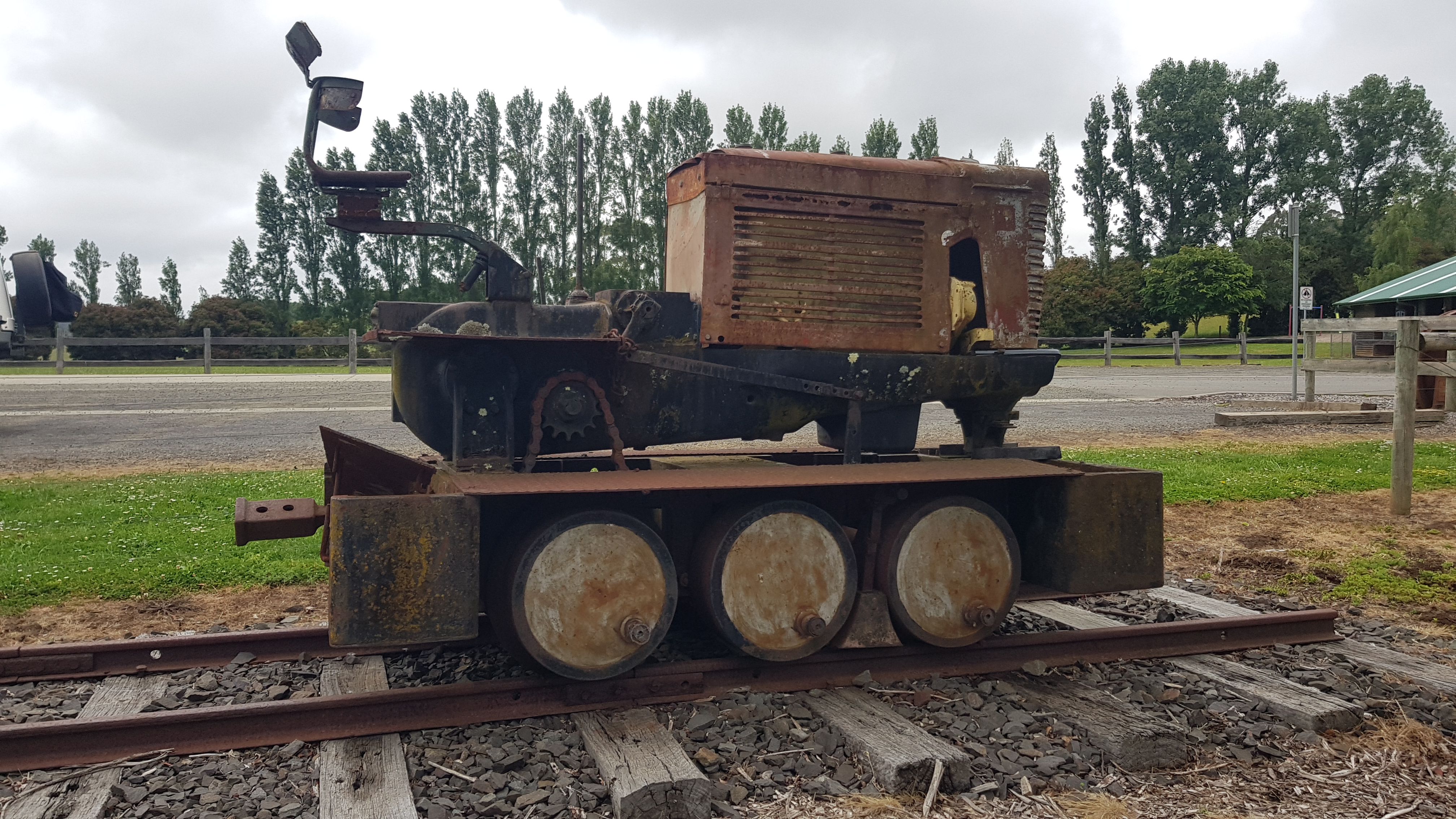

The remains of Ezard's McCormack Deering tractor are at Erica in South Gippsland - as it is unrestored it might give an idea of original colours?

Reply from Peter Evans, one of Victoria's most knowledgeable on timber tramways, sawmills, etc:
Ruaok - red. JS Lee - green. Cheetham - yellow and green. Tractor - as supplied from Dagenham in the UK. Pick a colour ...
I'd take a guess and say the McCormack Deerings were possibly red when delivered - Fordson powered unit - pick a colour...........

The Days tractor at Marysville is unfortunately like grandad's axe and the only original parts left are the wheels. There was a series of colour photos of that tractor posted recently on Facebook that were taken late in it's service life in the early '50s. The tractor at that time was a model F and the remaining paint among the dirt, rust and oil seems to be grey.
The one at Erica has the remains of a McCormick-Deering tractor fitted with various odd bits when it was 'preserved'. When new it probably looked similar to the RUOAK tractor at Alexandra.
