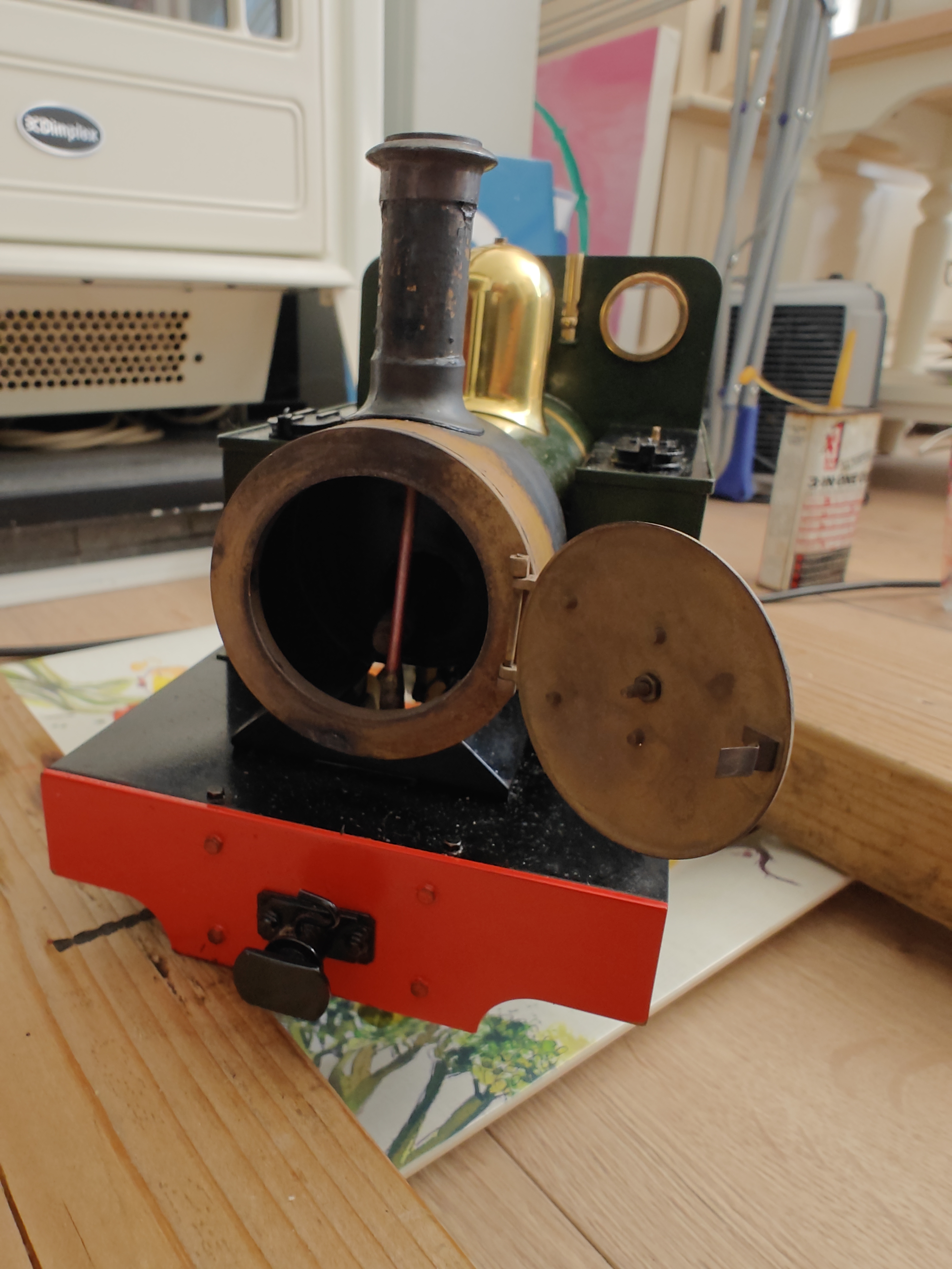

Hello, I bought this Edrig for £200, it's in need of repair and is losing steam under the front... Any ideas? Also what gloss black paint should I use to repaint the front?
Thank you!

Hi Nic,
Now, I know next to nothing about steam loco's but even for those that do, "under the front" doesn't give much to go on, could you be a bit more specific about where under the front?
As for the paint, most folks would paint the smokebox in matt black rather than gloss, but either way it needs to be heat resistant paint and I believe that barbeque paint is often quoted. It also needs to be completely stripped back and degreased first and then given a proper primer before the black, because getting paint to stick to brass is not the easiest thing to do.
No doubt others who know more than me will be along to give you more precise advice.

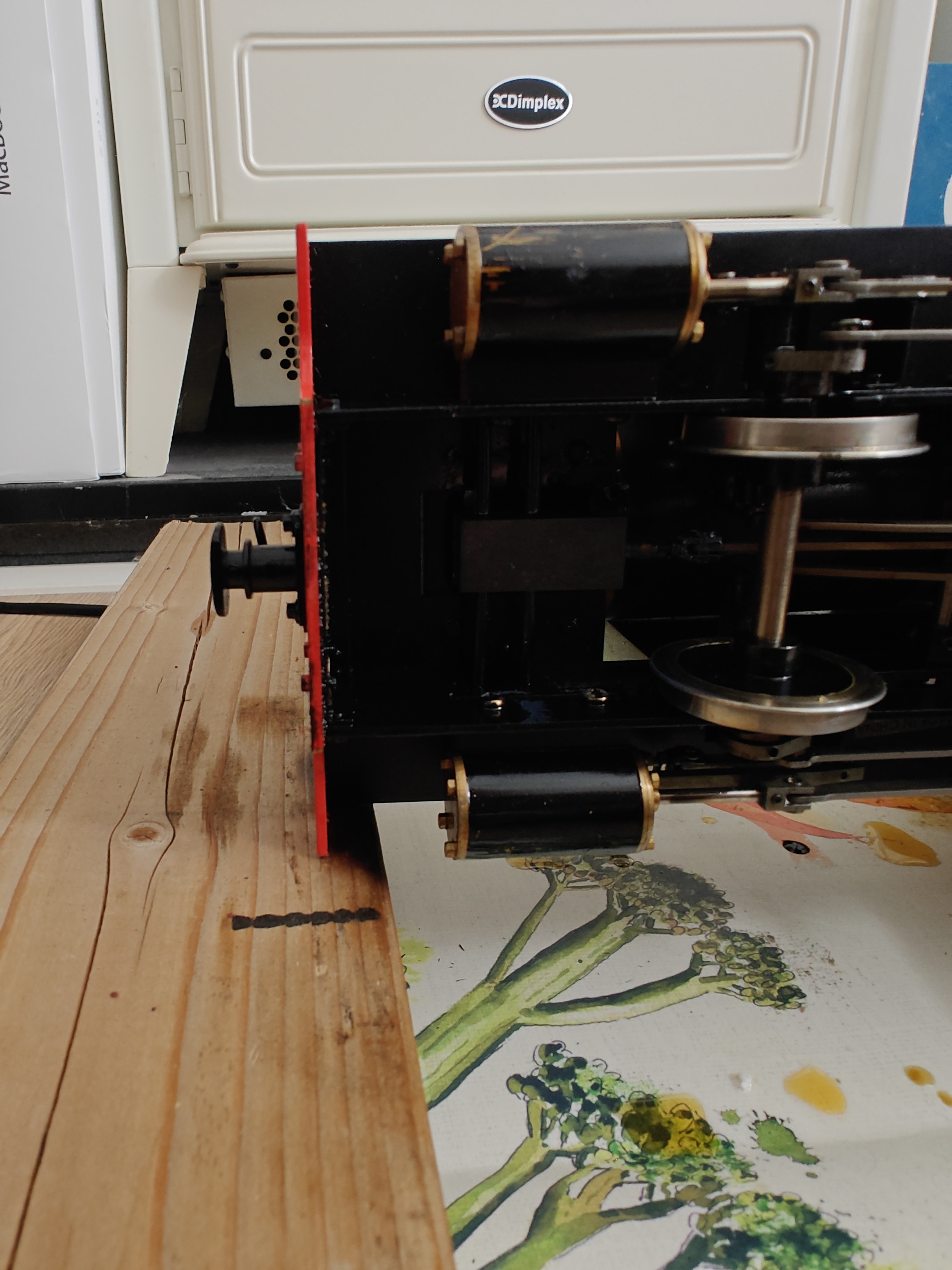

When I open the regulator the front hisses a lot and the pressure drops rather quickly. I can't see the steam coming out, but the front ends up in a cloud from the underside. I'll see if I can have a closer look later as well.

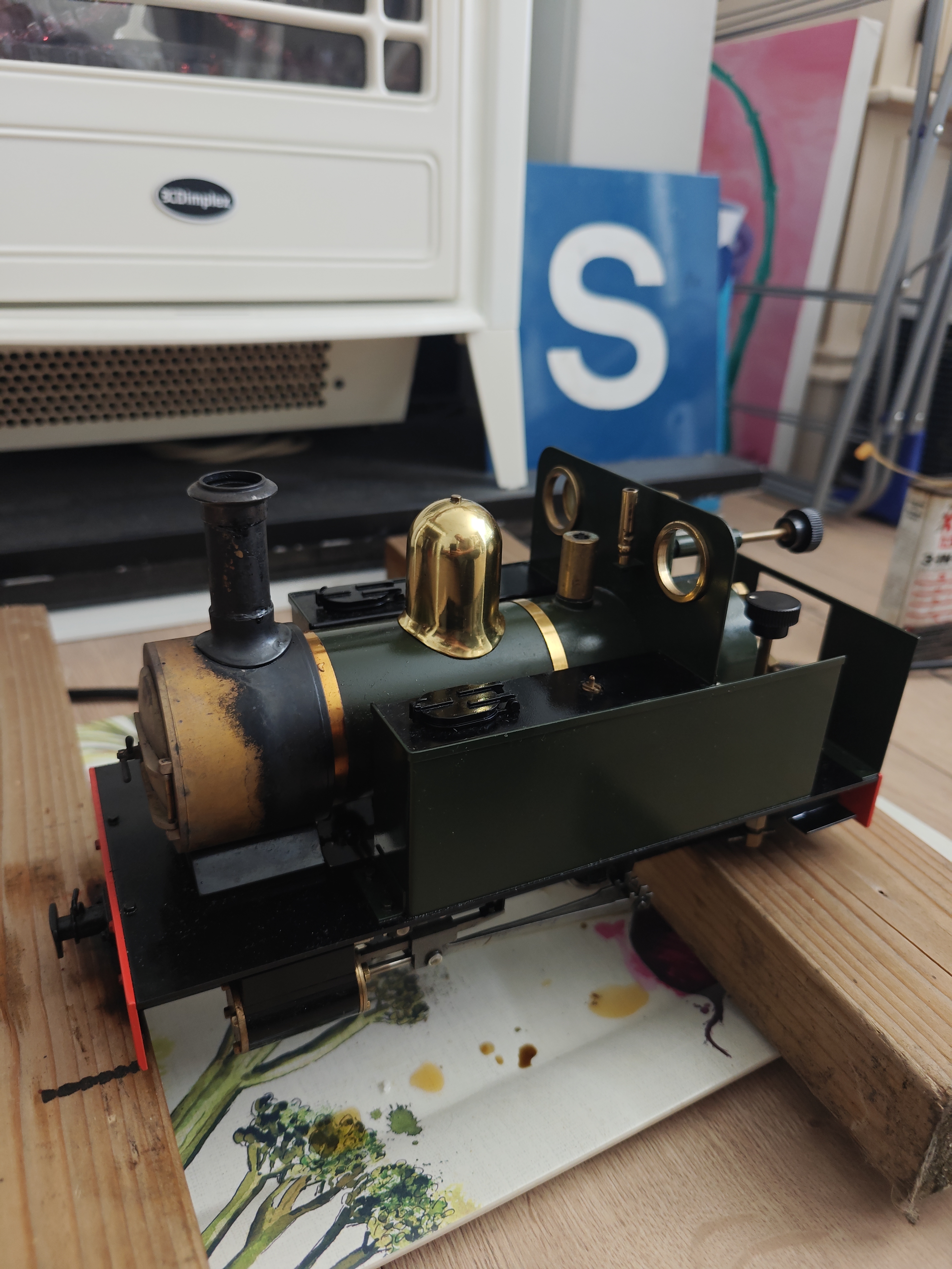

On closer inspection the reverser is jammed... Will have to check this out more thoroughly...

The smokebox can be removed from the frame after taking out the exhaust pipe by unscrewing it.
The smokebox can then be degreased and sanded down to apply new paint.
From the looks of thigs the previous owner left the fire burn in the smokebox and destroy the paint.
The burner should be turned down so that the fire pops back onto the burner when it is in operation.
I have an Accucraft Earl that I have modified and still operate after 16 years of operation. With proper care the engine will give many years of operation.
The price you paid is a real bargain. Good luck with repairs and happy running.

Something to consider, the Edrig is missing the circular lump of metal inside the smokebox door. I think they are steel, to protect the actual door from heat.

I made protection for the firebox door from a piece of .020 brass shim stock. I used a piece of fiberglass material to act as an insulator for the door.
The material I had was .100 thick so it would compress down to make a tight connection to the door. I had not any problem with the paint on the door blistering after that fix.
Charles M

You might want to try my favourite test:
turn the loco upside down, put on some compressed air (even an adapter with a bit ot hose you blow into is ok, you do not need high pressure) and then spray the steam lines with some dishwashing liquid.
Any leak will create bubbles so you know where to investigate further.
Might be a broken solder joint.
Hope this helps.

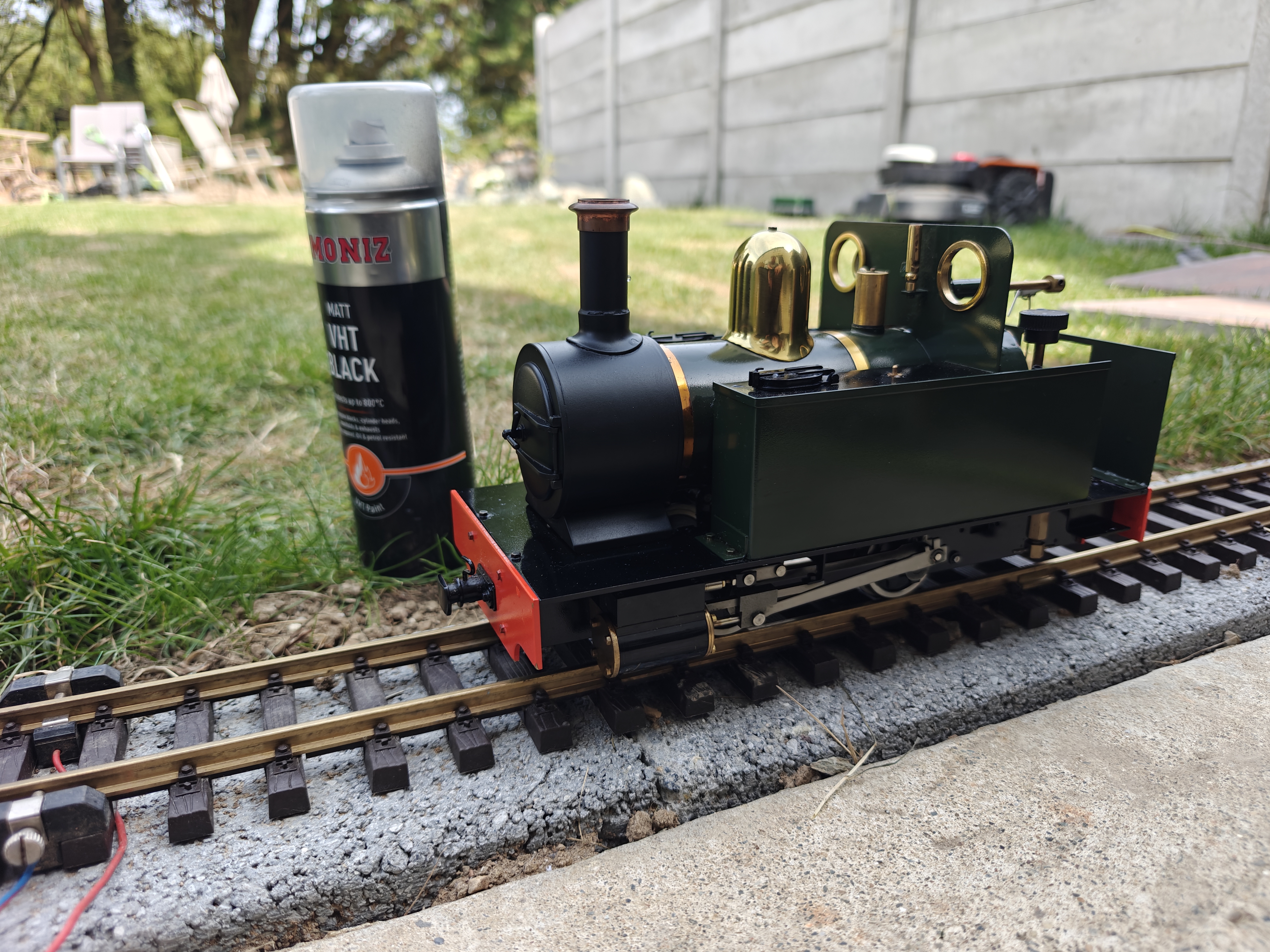

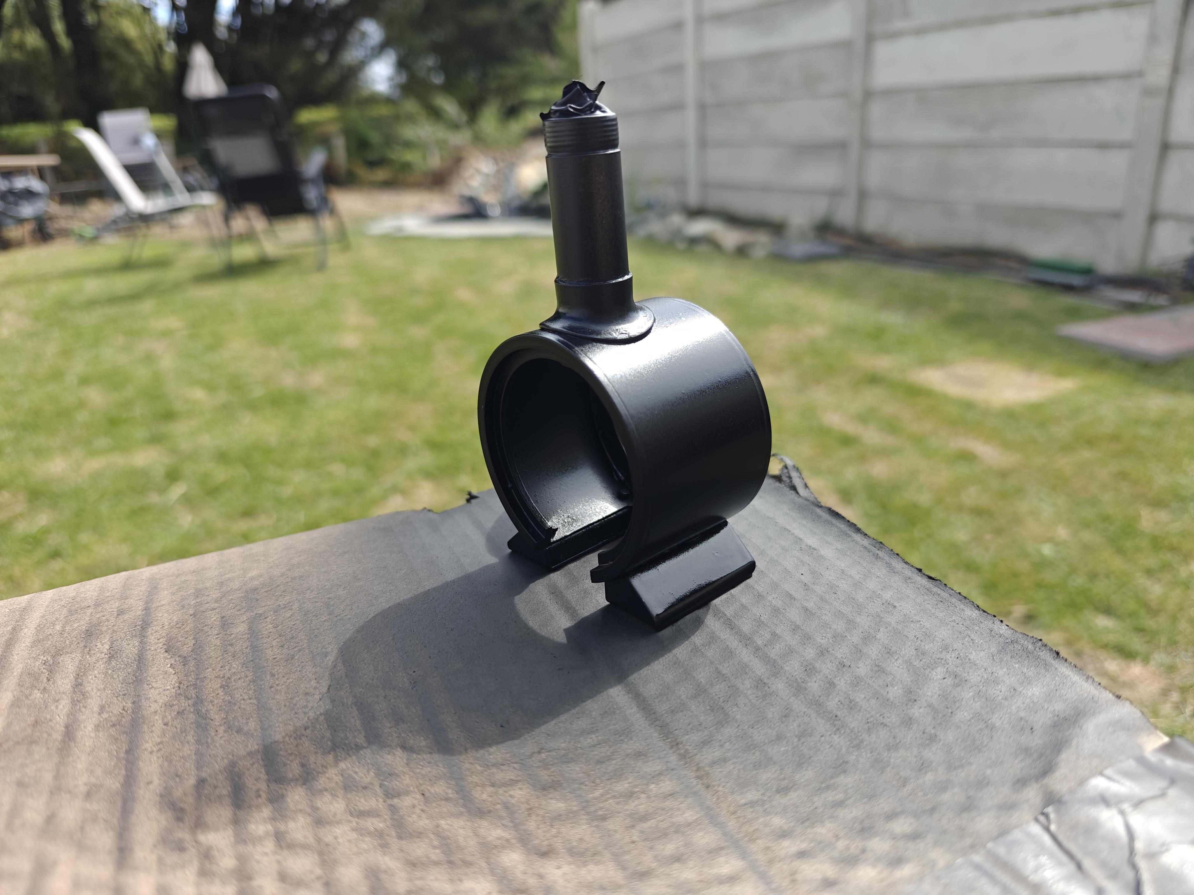

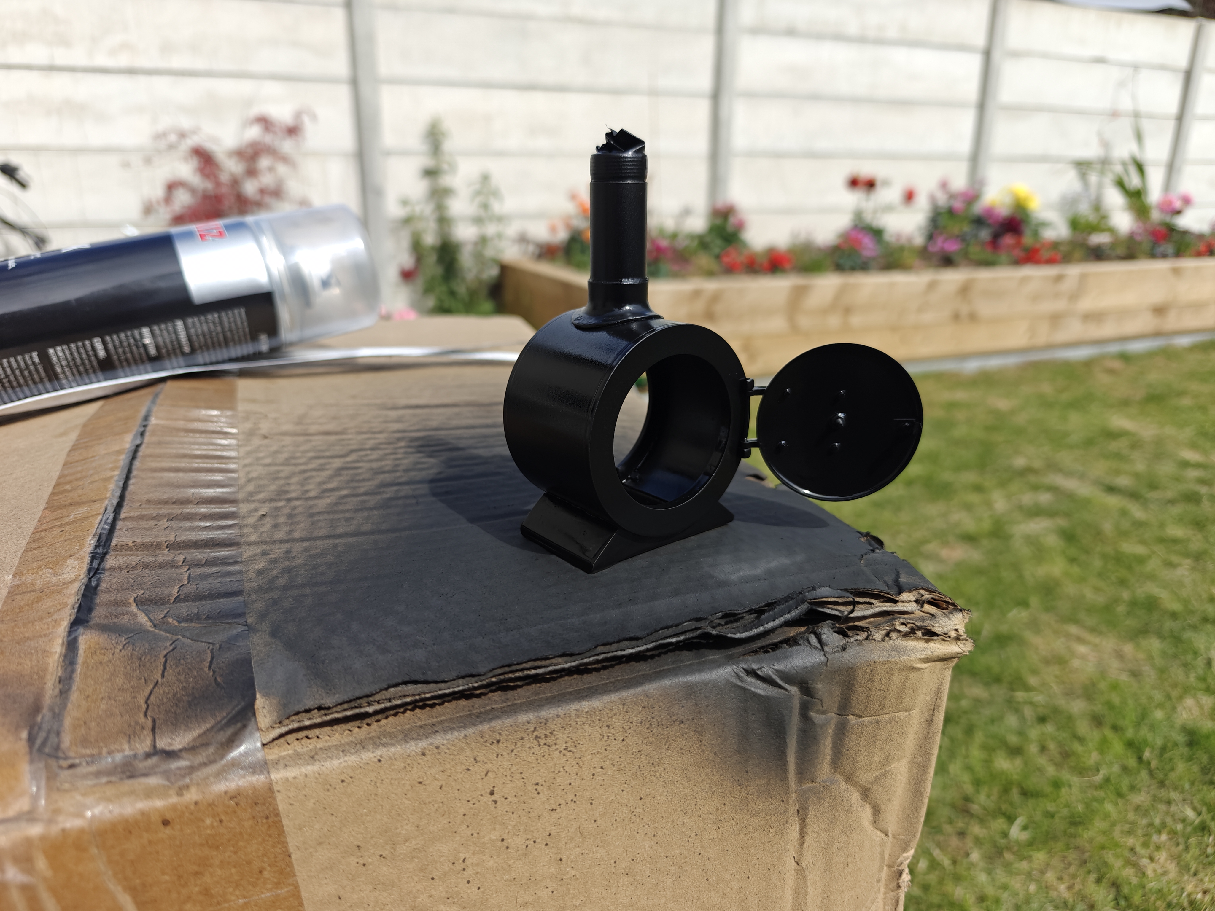

I took the above advice and painted the smoke box with VHT paint, this went very well.

And here is the finished repaint.

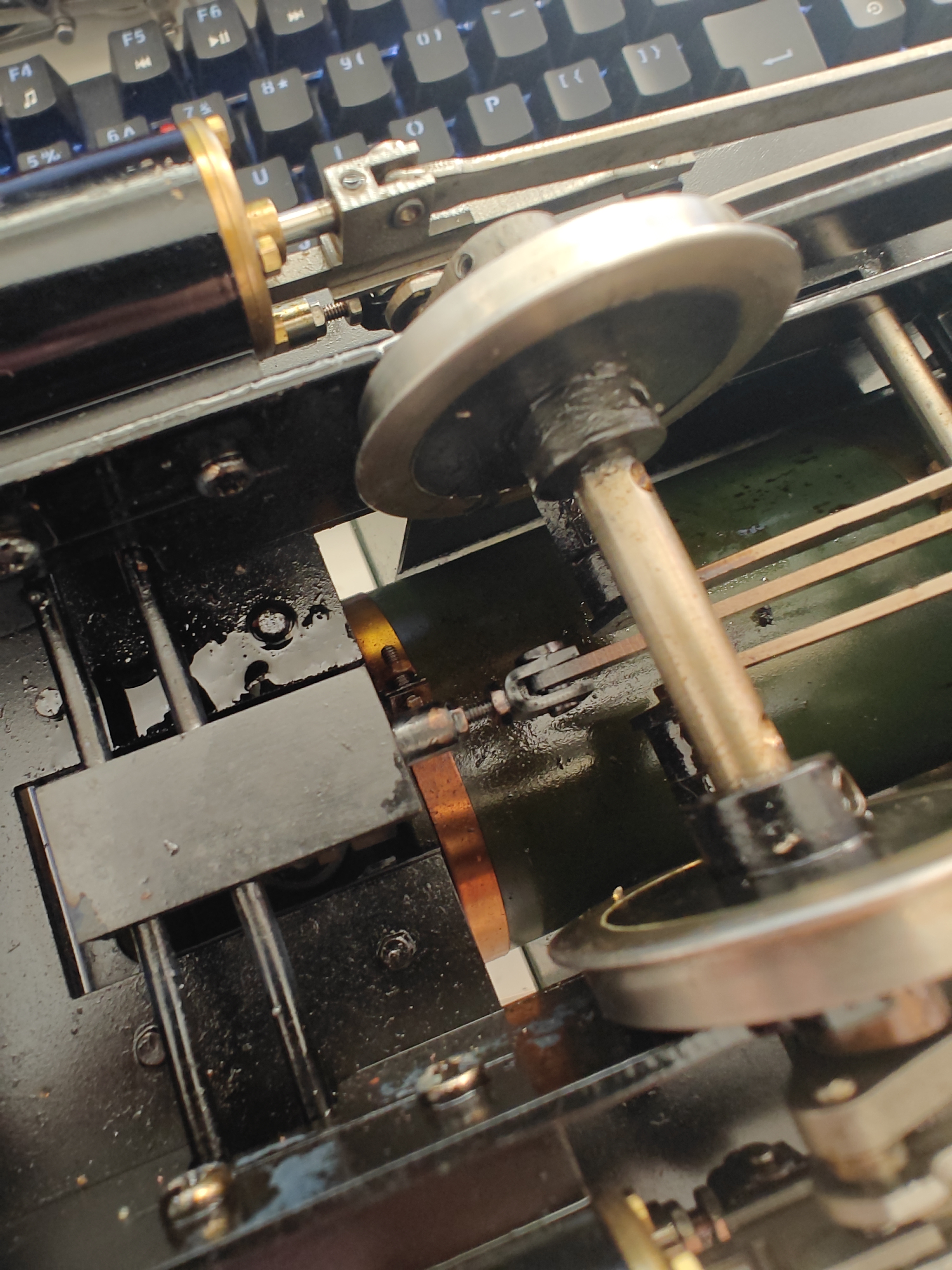

I have yet to however repair the steam leak. I can see a build up of oil under the smoke box from the steam chest, so I assume it is from that. How do I go about repairing this or replacing it?
Thanks.
Thanks.
