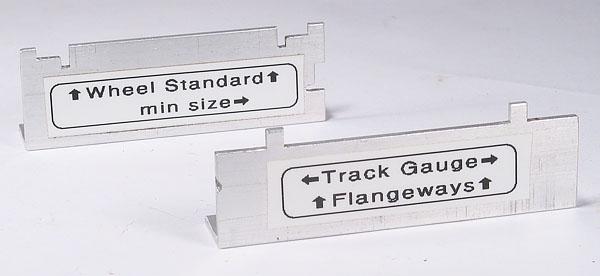

The most difficult step in making your own trackwork is making a start.........Petersfield wrote: Sun Jul 05, 2026 9:36 pm Being able to make my own points to my specific requirements would be convenient - but despite the reassurance in the previous posts it still feels like a huge leap of faith.
Two essential items for making turnouts are in this photo. and they were the first things I made when I changed scale. Mine were machined out of some aluminium angle, but it wouldn't be difficult to make a set by careful marking out and a bit of filing.
https://gardenrails.org/myff/1325589/Check+Gauges.jpg
I use G1MRA coarse standards as I work in 15 mm/ft scale on 45 mm gauge, so no experience of 32 mm gauge. The next link is a good article on O gauge standards by Sam Evans and using them for SM32 wheels and track.
https://www.wis.co.uk/andy/16mm/standar ... sions.html
The first thing I'd be doing is making a set of gauges and checking your track and wheels. You may be surprised by what you find....
