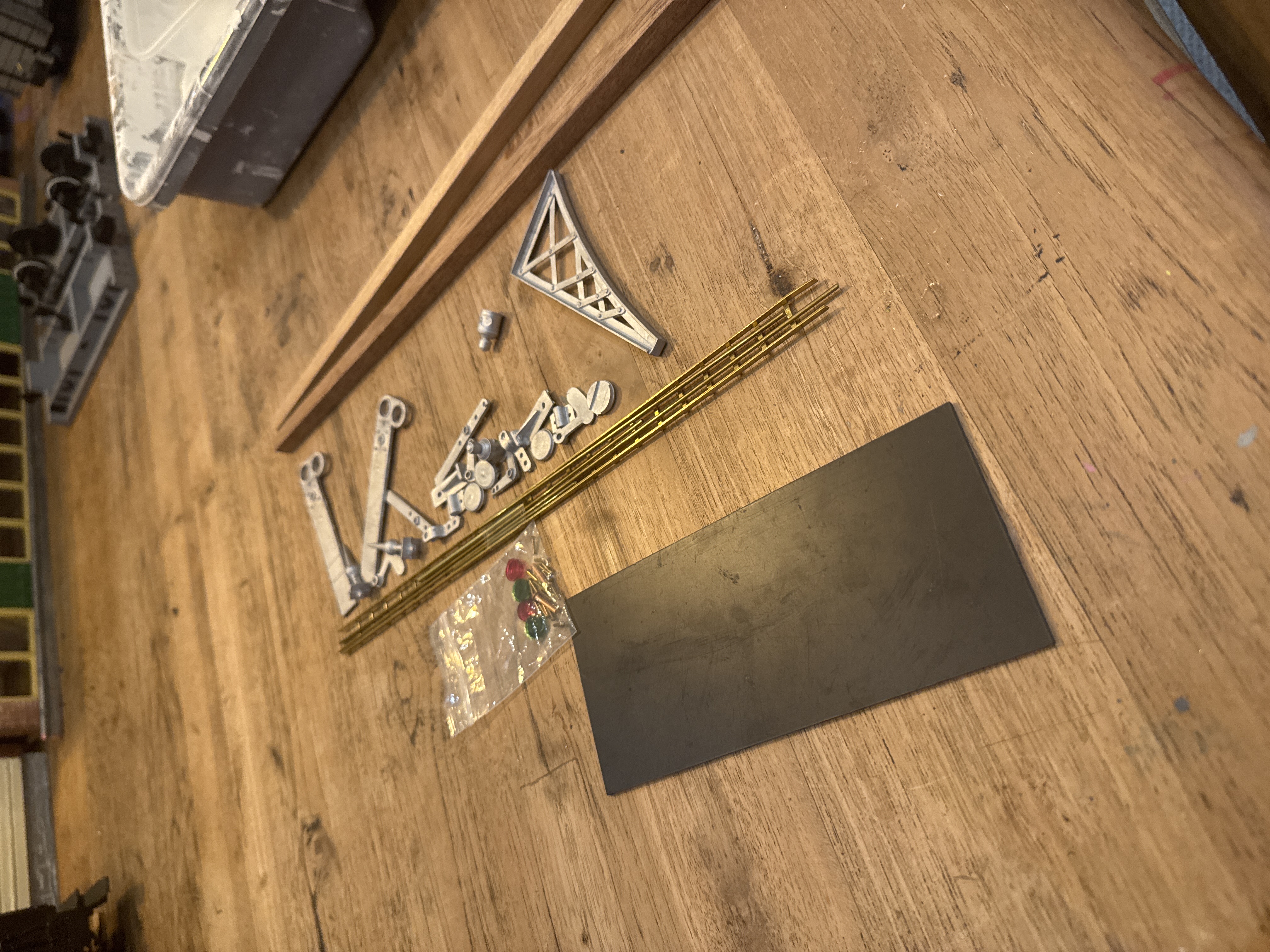

Hi all,
I bought the GRS signal kit but can’t make head or tail of the instructions has anyone got any tips of measurements for them since there are none on what appears to be the instructions. Any help would be greatly appreciated as I’m new to kit building in this scale

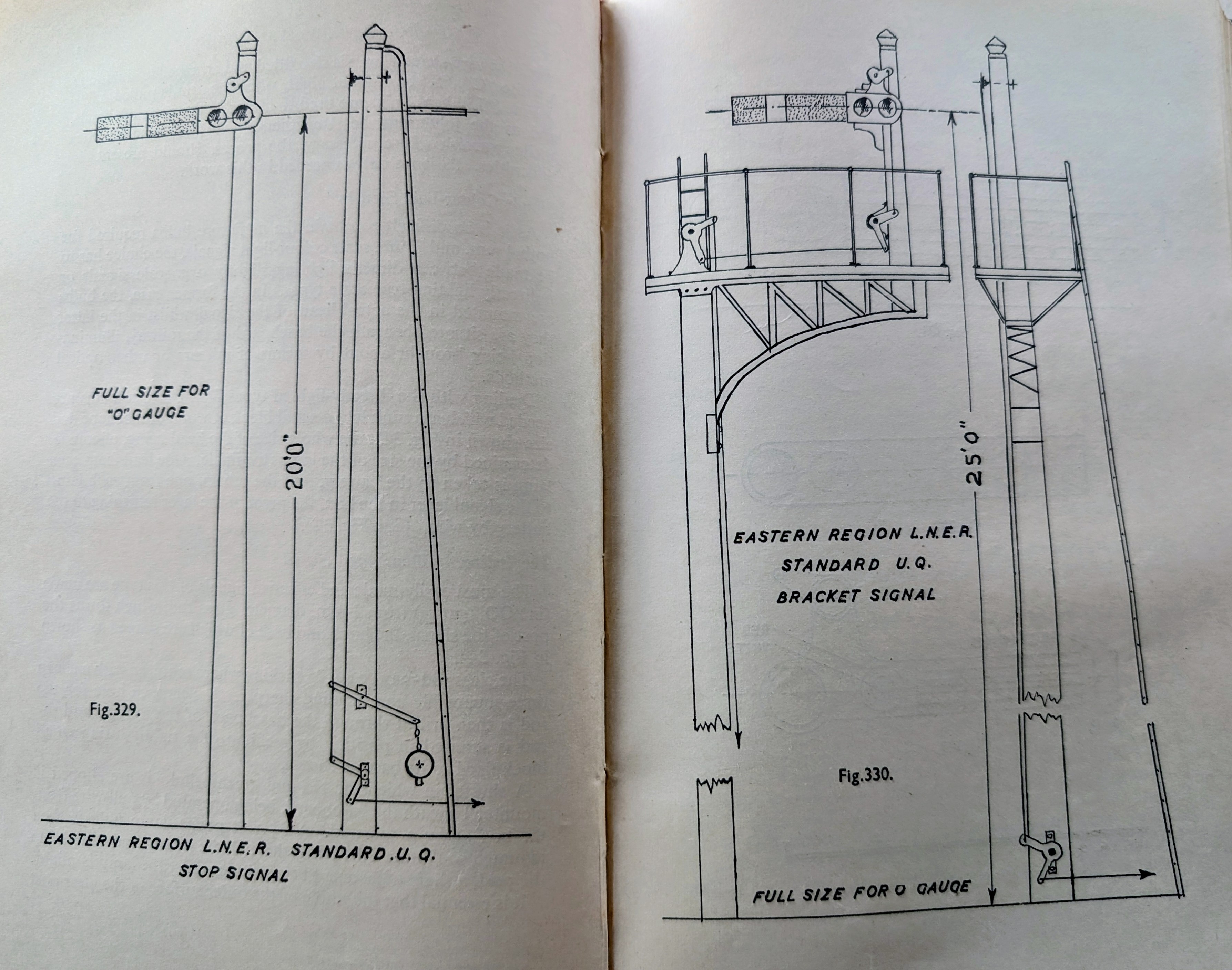

Post by ge_rik » Tue Jun 23, 2026 6:38 pm
Not entirely relevant but might be of interest. Whilst at the East Kiln Light Railway on Sunday, I picked up a copy of Ernest Carter's Model Railway Encyclopedia which includes this drawing.

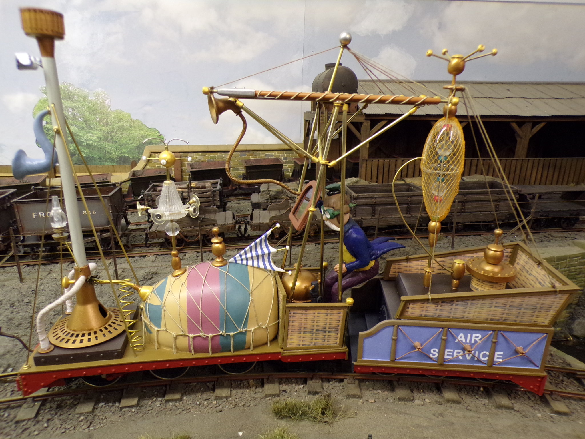

Wow 32cm tall do you have a photo Im planning on giving a 185mm clearance from rail height

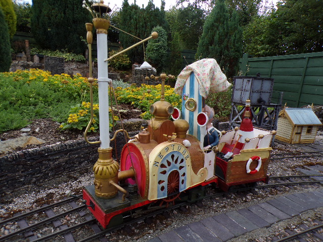

Post by Peter Butler » Tue Jun 23, 2026 9:43 pm
Jack60103 wrote: Tue Jun 23, 2026 6:47 pm
Peter Butler wrote: Tue Jun 23, 2026 6:11 pm
Jack60103 wrote: Tue Jun 23, 2026 3:59 pm
These two operated on the 1951 Festival of Britain passenger carrying line, Far Tottering and Oystercreek Railway and were designed by Rowland Emett. These are scratch-built and battery operated...
I doubt you will see them near your line but there is a video of some of my Emett models working on my line...
