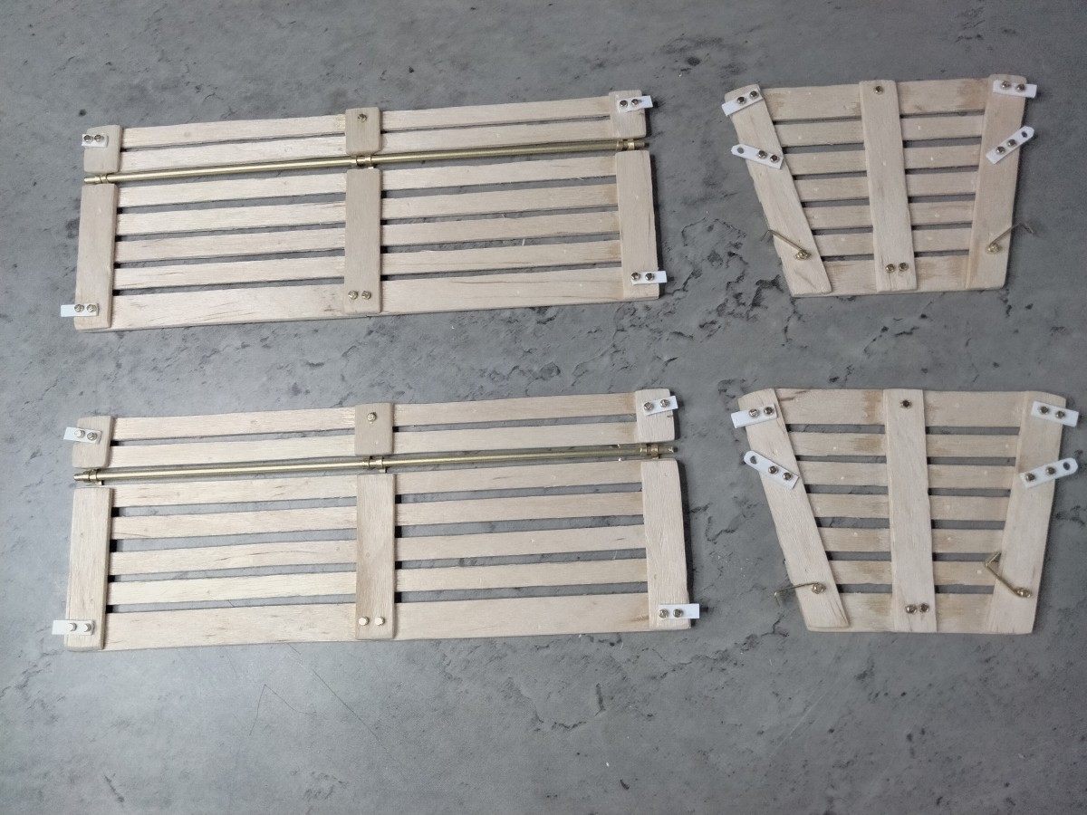

Post by Allu » Tue Apr 21, 2026 7:54 pm
Started to do boltheads, some strapping and latches.

Post by Allu » Sun Apr 26, 2026 3:42 pm
I sprayed the wheels with Rust Effect from Dupli-Color. It creates a nice real rust looking texture. I masked the treads and flanges before painting.
Undercarriage and wagon floor done.

Post by Allu » Fri May 15, 2026 9:05 am
Wagon body parts finished. Next assembly.
