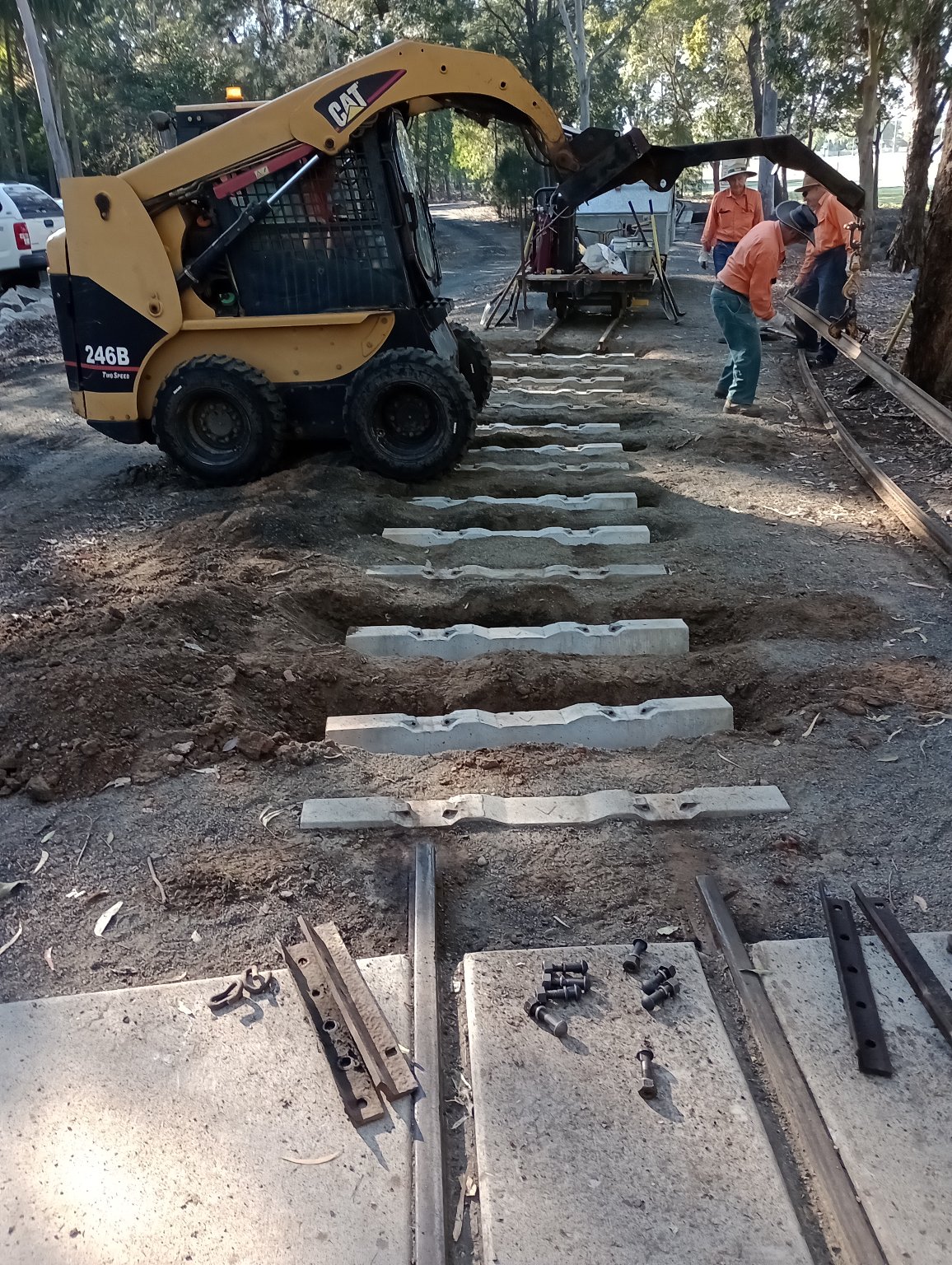

on our 1:1 scale track we do not use check rails for our road and path crossings rail spaced with steel sleepers and a piece of box steel laid beside the rial wider and a bit deeper than the flange and concrete or bitumen poured over reinforcing mesh. They have all sorts of garden maitnenance equipment including excavators, backhoes (JCB's) bobcats and tip trucks with no sign of falling apart after years of use.
The road crossings are on public roads with a fairly volume of traffic.
Personally I would not use the peco sleepers but pieces of plastic wood or even treated timber with slots cut into them mainly for strength and give a stronger base for loads they are there there only to hold the guage after all.
