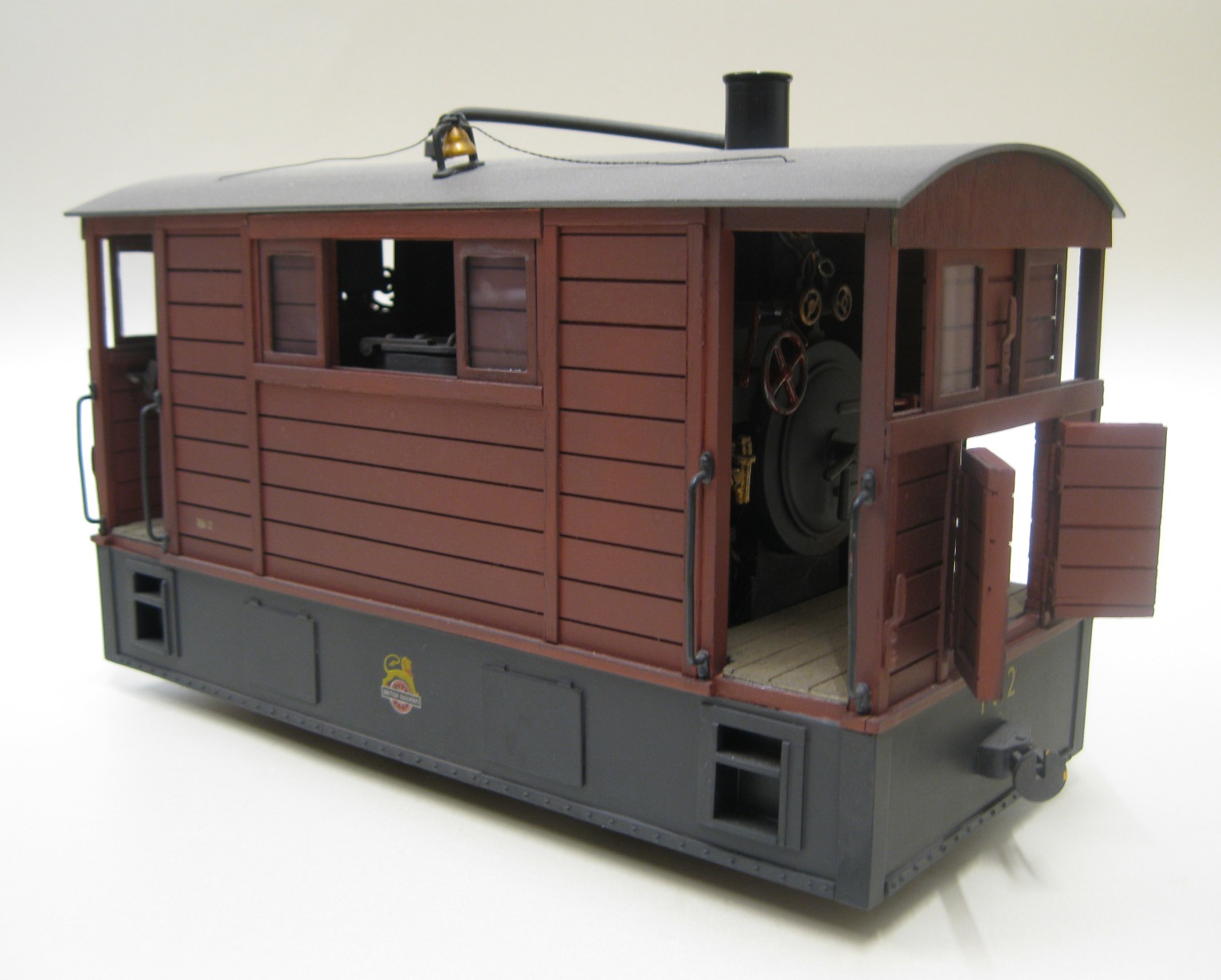

I have arranged a purchase of a (currently) manually controlled battery loco. As part of the deal, RC will be fitted. My thoughts went a stage further and I thought if we're making changes, why not fit sound at the same time? I've had a look on RC Trains' website and Phil gave some good detailed information & advice. A receiver and transmitter (and battery pack) are earmarked. But the soundcard mentioned (MyLocoSound) does not have the specific loco's sounds, they are generic in nature. I'm wondering if I could get something for the loco based on the J70 steam tram. I had a look round online and Digitrains have a sound file for the 4mm scale Rapido J70s ModelRail commissioned. But I don't know if that would be compatible with SM32 equipment. Or excessively quiet given the difference in scale. I did message them last week but they're having to refer to a technical person, no answer yet.
Someone mentioned Fosworks and they also have generic steam sound cards - also a SND-210 with 'sound project of your choice' (do you think they mean I could download a file (such as one from Digitrains) and install it?) but that's a lot more expensive at £250. (I'm not at all sure I want to go that far). I also took advice from an ex TrackShack contact who suggested sound (in his day) was not very good, such as chuffs not being synchronised with motion. He thought someone had lashed up a 4mm scale DCC chip with RC & batteries but has no experience of and thought there might be problems altering CVs etc.. Am I being hopelessly naive or might I have a cunning plan?
I'm not particularly electrically minded, so anything I get needs to be reliable and work with the minimum of fuss and/or programming. If I could get something good, I'm fine paying a bit more. But if the options are rather second rate or generic, I might go with it and accept a lack of realism or maybe I'll do without altogether.
Any thoughts or experiences?

Thankyou all. I'll have a read through Rik's blog posts. A specific J70 file would be nice ... but the brutal truth is it's a freelance narrow gauge in the style of a J70. A very convincing narrow gauge J70 (IMHO) but still not an actual class. My priority would be to have something synchronised (with movement) and convincing. So long as it's not obviously inappropriate, like (say) an A4 or Black Five sound - I could live with a generic branch line steam sound. After all, it will be a bit of a audio-visual compromise as there won't be any steam emerging from the chimney...
I should mention I don't have a smartphone (or tablet), so - so far at least - I've been looking at a separate transmitter of some sort. One of our local group did mention a system run from a smartphone and the gravity slate train I posted a video and/or stills of elsewhere on here is run from the owner's phone. I don't regard myself as a Luddite but most smartphones are expensive to buy or run and after a cost-benefit analysis, given my current lifestyle, I decided I just don't need one and it'd be wasted money. Which I could spend on more important things like garden railways!
I know that's a minority PoV these days but it's how I feel.
Thanks again; any further comments welcome, I want to make a decision soon but not necessarily this weekend.

Thanks. Another member asked about sound recently (the 'Chuffing and Whistle' thread over in the Projects section) and there's been some overlap with this thread. Short version, I'm going to give this a go. Order placed with Phil and Rik's video (officially recommended by MyLocoSoundOld Man Aaron wrote: ↑Tue Jan 13, 2026 12:02 am ... What [soundcards have] evolved into on the other hand, is rather good for the price, especially with the provision to synchronise them with the wheels via a reed switch actuated by four magnets glued to the back of a wheel. I have half a dozen of the most recent and one generation earlier steam card. I think MyLocoSound has really hit their stride with these cards - a good mix of quality sound, and ability to customise to suit individual locos.

Just a brief update - Phil's order arrived and the parts fitted. I haven't been able to test outside but have run the loco - a rather nice quasi J70 - on my shunting plank and am happy. I need to play with the [TV] handset a bit as I haven't worked out how to use it fully, so only have easy access to some sounds. But the 'chuff' (set on the handset rather than via magnets) is loud enough for a SM32 loco and generally tallies with velocity and momentum. Things are a bit busy right now but once I've come to terms with all the options, I will try and do a video.
