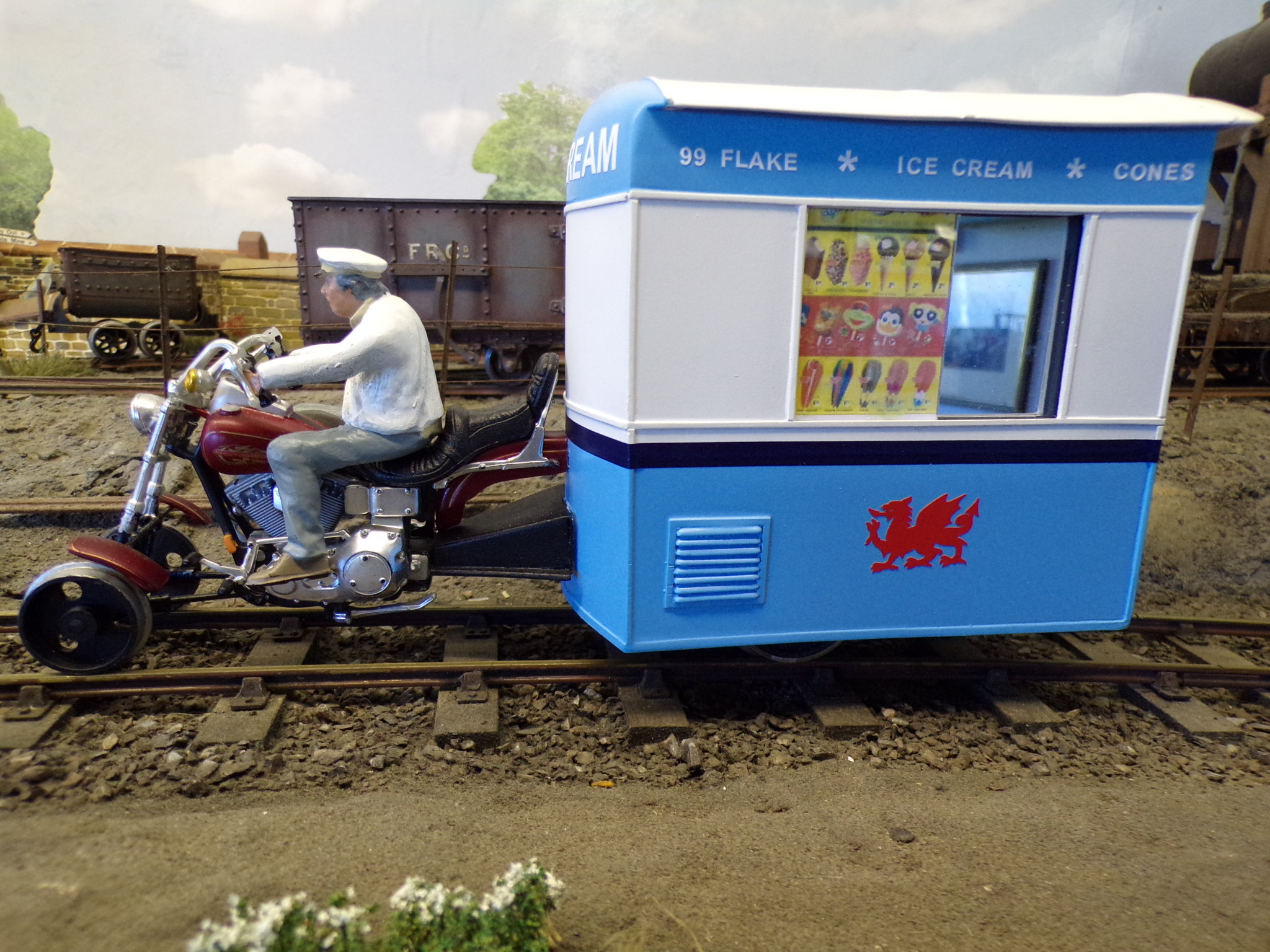

Followers of this thread will have noticed a leaning towards road to rail vehicle conversions, so I'm always seeking inspiration from anything which becomes available. The supply appears to have dried up somewhat recently, so possibly someone else is also doing something similar? Beware, it might be contagious!
As an alternative I was tempted by something completely different.... I do like something different!
I bought one of these....
Apparently it's a Harley Davidson.... something I know nothing about. I thought it would make a nice lineside accessory, but it needed a rider. That's when the fun started! I couldn't find a printed figure with arms and legs spread wide enough to sit astride one, so I bought a seated figure as near as possible and set about removing his limbs. A little anaesthetic was used ( Single Malt!) and his stance altered substantially to suit the requirements.
Some brass rod and modelling putty soon solved the problem....
By this stage thoughts were turning to making more of this item as it began to look more promising than anticipated. What about a motorcycle on rails?
If so, it needed a small trailer to hold the batteries etc...

The finished item of essential railway mobile service equipment is....
A rail-mounted Ice Cream delivery vehicle....
This precedes the passenger trains, stopping at each station in turn, ensuring all of the travellers are well provided for on their journey.
All preservation lines should have one!

Ha ha. Brilliant Peter. You have an abundance of quirky non typical stock.
Sorry Peter I havenโt felt good for a couple of days so only just seen this. Thatโs not what I was thinking of, I thought it might have something to do with a mobile meat and vegetables
or something like that. But this is just something elseโฆ. Iโm blown away by it. Only you can see something others canโtโฆ
Canโt wait to see your next incarnationโฆ
- Posts: 5707
Many thanks for your kind words Rod, I'm sorry to hear you're not feeling well at the moment, perhaps this has cheered you up a little?
It's just for fun after all.
Thanks Peter. It comes and goes unfortunately. Iโm going to see another consultant in April I think to see if I could get a pacemakerโฆPeter Butler wrote: Mon Mar 17, 2025 10:23 am Many thanks for your kind words Rod, I'm sorry to hear you're not feeling well at the moment, perhaps this has cheered you up a little?
It really has cheered me up Peter.
- Posts: 7946
Excellent! Another clever imaginative masterpiece from the master modeller.
A little late in the day here, but I love the ice-cream bike, fantastic stuff. There's something about how the design just "works", and the quality of the finish that makes me feel that maybe, just maybe, it could actually have existed somewhere...
I'll have a 99, please.
