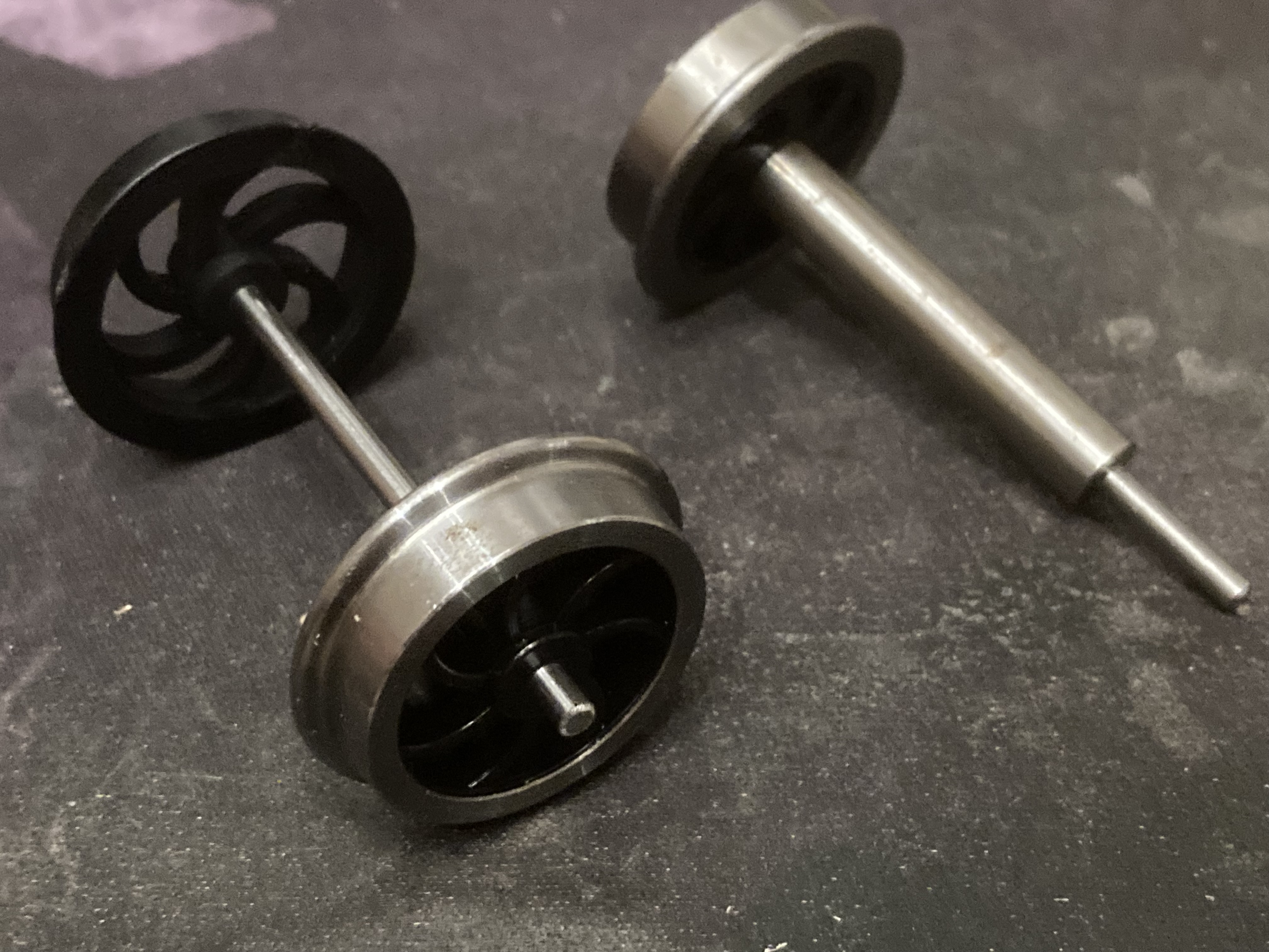

I’m not aware of any all metal wheels available that are press fit on 3mm axles. Slaters 7/8ths scale wheels have metal tyres with a nylon centres but have decent weight due to the thick profile of the tyre. They can be fitted on a plain 3mm axle and are a tight fit so will keep to gauge, but the range is limited and none are 24mm diameter. 2215WD is about 27.5mm diameter, shown in the photo with one wheel removed from the Slaters axle and fitted on a Binnie axle, the other wheel being a Binnie 29mm diameter curly spoke wheel. 2212HUD is 22.2mm diameter.
