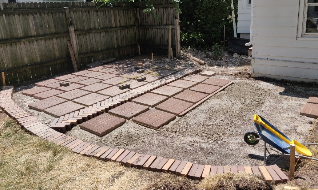

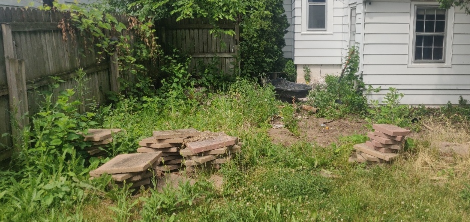

As the surrounding paver patio takes shape, plans for NVT begin to crystallize. The visible area for the main loop has been set at 9 by 8 feet, with potential for a siding around the corner of the house or a spur along the edge of the patio. All I can say for sure is that compared to prepping the area and leveling all these pavers, building the trackbed is going to be a piece of cake. Not looking forward to the retaining wall though, which will be the next obstacle after all of the pavers are fully leveled and packed in.
Paver patio in painfully protracted progress. The NVT will primarily occupy the space between the fence and the house.
For comparison, the same area at the beginning of the month. We've been a little busy!
Rod, my HO shelf layout is built on an old scaffolding board I found in a jobsite dumpster years ago. We've got a great reclaimed building supply store here called ReStore, and I'm hoping I can get some blocks from them for the rear part of the wall (which will be hidden, towards the house). The front of the wall will need to pass approval and there's already an earmark in the patio budget for visible stone. :king:

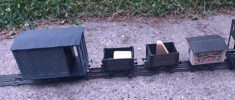

Here's the stock I was working on last night. The GVT brake van was nearly complete but needed a roof, so I formed one out of a cracker box and painted it. The tea van needed the same as well. The wagons are built from popsicle (lolly?) sticks and looked far too clean, though I think I might have gone a bit too dark on the outside.
GVT brake van, open wagons, and tea van out for a jaunt in the yard
The tea van needs buffers and hooks, but so far it looks like I'm more likely to have a train than a track by the end of the summer.

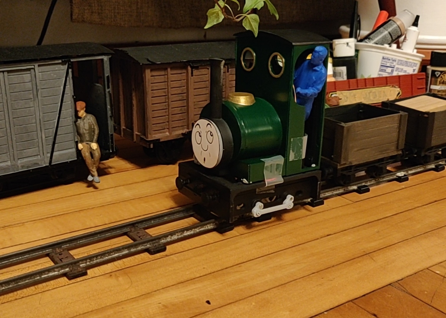

In my last post I conveniently cropped out the locomotive in the front of the train, as I didn't feel it was complete enough to reveal. I've put some work into it this week and I'd like to introduce "Furcy", the latest addition to the Nolwyn Valley roster:
NVT "FURCY" wearing a temporary face to mark the Awdry Extravaganza (and the diorama contest)
He's a silly little engine designed to run on the tight curves of LocoRemote 3d printed track, partially as an exercise in pushing the limits of a minimum recognizable steam engine, and partially to put into practice the lessons from THORNAS' many toddler tests (and subsequent rebuilds). To that end, I've simplified the construction and attempted to include stronger joints and bracing where it may be necessary.

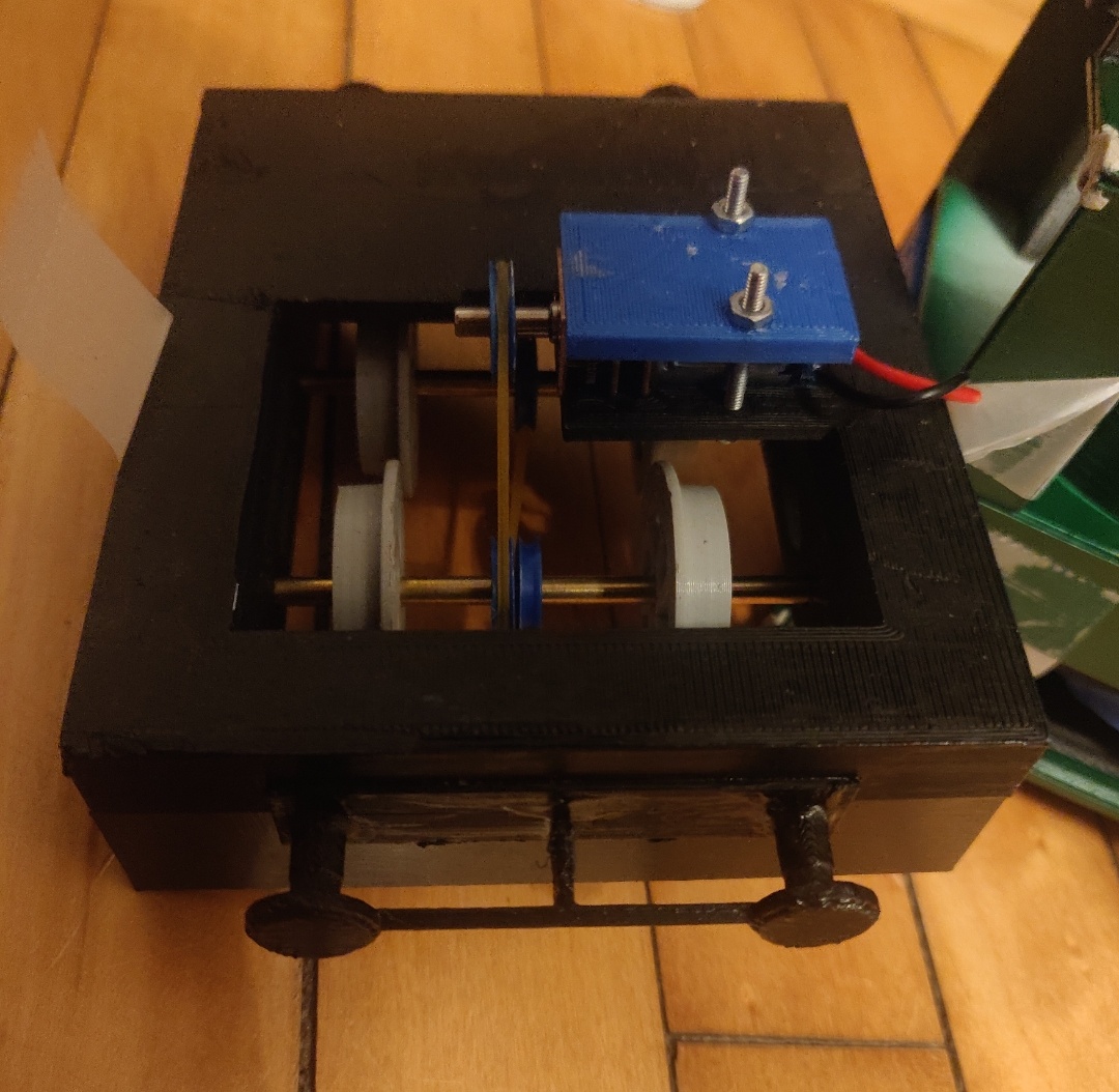

The motor was meant to be a geared can motor similar to that used in THORNAS, and should have taken up most of the space inside the boiler, but I came across what looked like a great deal on some cheaper N20 style geared motors and snapped it up without looking at the dimensions. They turned out to be tiny! I modified the plans a bit to make the loco a belt drive, though it's running on rubber bands for testing until I get around to measuring for belts.
The running gear with tiny motor, and rubber bands standing in for belts-- one has already snapped, and they are not easy to replace on this design.
The motor is rated 3-6V and I'm running it from 3xAA NiMH batteries in the cab. The coal bunker is removable to allow easy access to the battery holder. (Another lesson learned from THORNAS!) Control is currently just a simple on/off switch, but I plan to add a DPDT switch to allow reversing. There should be plenty of room in the boiler to add remote control (much) later.

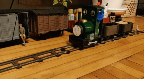

Highlights from initial testing (before snapping the temporary drive belt):
Pulling two wagons, one loaded.

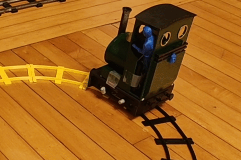

Struggling to negotiate a tight curve... Some adjustments may be necessary.
The rear lamp is actually a knob to latch and unlatch the battery door. I had meant to make the coal bunker span the full width of the cab but made yet another error in measurement. How's that saying go again... measure once, cut twice? Something like that.

There is something that we used to use many years ago when I was in engineering, setting up high speed wrapping machines that had small motors that drove the date code printing head. It was like rope but it was much more flexible and it was joined by reversible threaded wire. It was very strong and never broke unless it was stretched too much. Unfortunately I can't for the life of me remember what it was called. There are companies though that will make drive belts too any length for you. :thumbright:
Posts: 871
Re: Nolwyn Valley Tramway
Post by drewzero1 » Thu Aug 03, 2023 8:55 am
Thanks guys! Rod, I'll have to look into that... I think I can kind of picture it. I'm thinking for now I'll probably make some slightly chunkier pulleys and find some rubber O-rings that will fit, (as I've done with MOKE, see post #1) but I've also been looking into small chains. Unless I redesign the axle boxes to drop out--as I probably should--it will be a fair amount of disassembly to replace a belt. A chain that could be broken and reattached would potentially save a lot of trouble.
