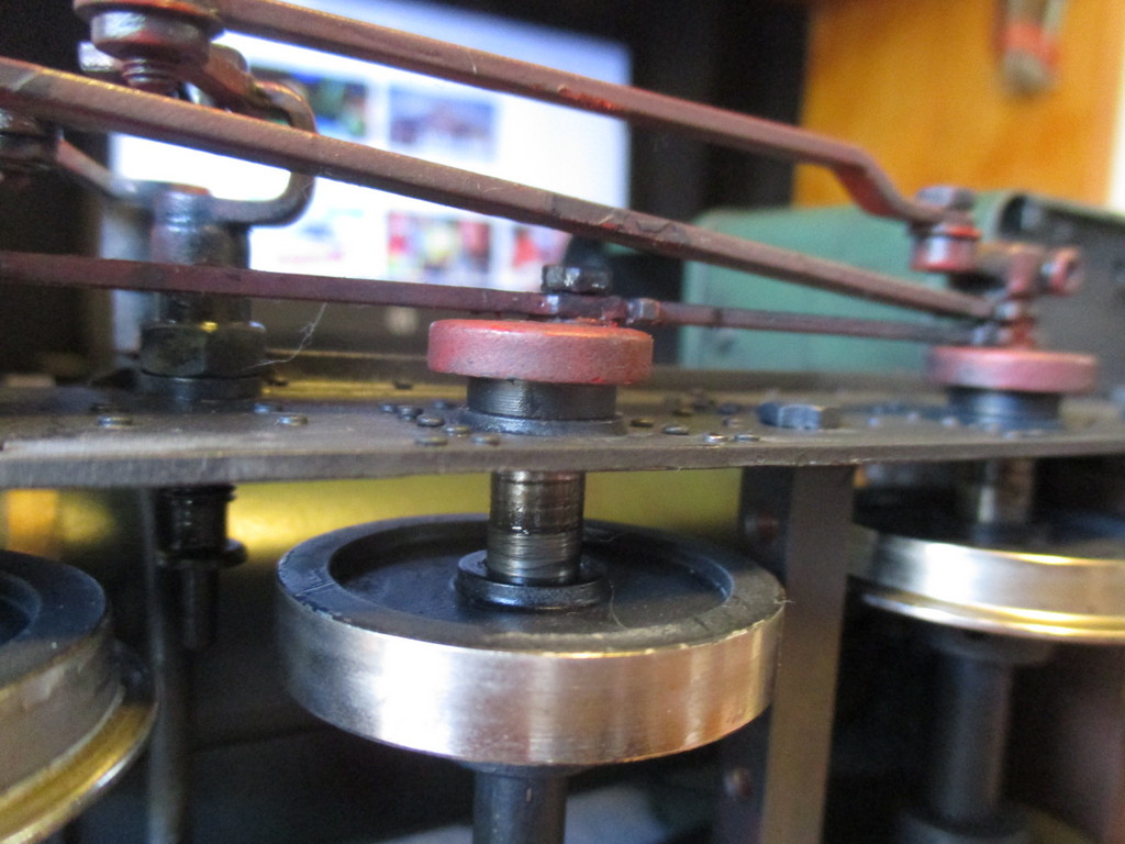

Forgetting the chassis kit came with a 32mm trailing axle, I shortened the loco's 45mm axle on the lathe.
As I've replaced my RH kettles' axle bushings with MF168ZZ ball bearings (narrower than the original bushings) there's now nothing to control axle side-play.
Back when I rebuilt "Victoria", 32mm wasn't on the radar and I was content to let the 45mm gauge wheel centres control the side-play.
At 32mm on the other hand, 2.4mm thick spacers were needed between the cranks and bearings. I machined a set from brass for the Bundy Fowler "Calloway's" rebuild last year, as it was intended to be the "travelling" loco, and easily convertible to 32mm. So a second set was now machined for "Victoria", and a third for the future Hudswell Clarke project.

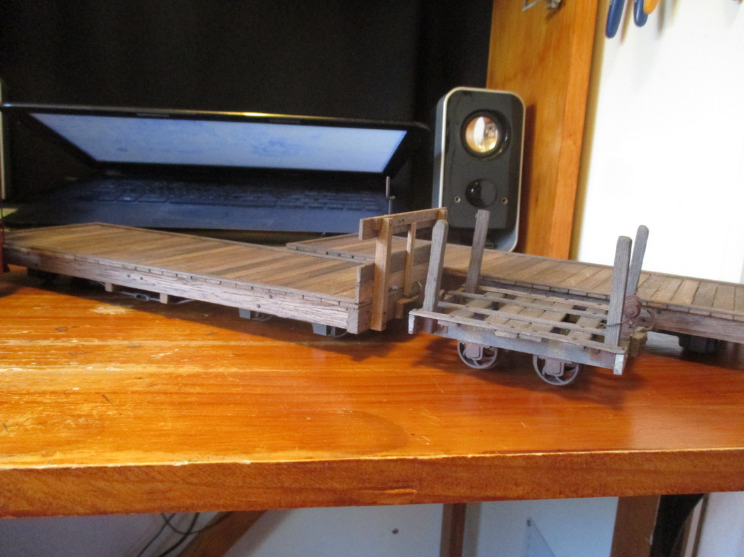

Now having a few locos operable in both gauges (not that I'll likely run them anytime soon), it was time to knock out some rollingstock.
The Mapleton/Moreton-based navvy wagon had it's heavily-rebuilt New Bright bogeys replaced with a pair of Binnie skip frame bogeys, something I've been wanting to use for years. I think they're a perfect fit for a bodged and rebuilt navvy van.
As the wagon was built to accommodate the relatively tall New Bright bogeys, while maintaining a nominal 20mm coupling height, the much-lower Binnies needed 3mm of packing to keep things where they should be.

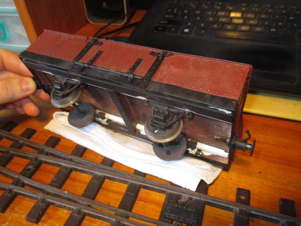

The Port Douglas open wagon's axleboxes were trimmed and fitted between the original frame members, to narrow the gauge and lower the ride height by 3mm. 20mm wheels would've been closer to the prototype, don't know why I used these 24s to begin with. Fitting them now would make the ride height perfect, but painting and weathering them to match would be painful. The drop I've managed brings it within spec, if at the higher end.
The IP laser-cut Fox-style bogeys were carefully pried apart. I didn't want to shorten and make a new close-fitting tab at both ends of four bogeys, so I just did one end and re-drilled the centre pivot hole. Bit of paint and filler, and no-one will know..

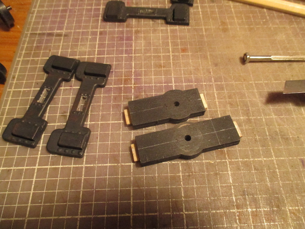

two pairs of RH bogeys were robbed from the repainted toys, and the bolsters were shortened to match the dimensions taken from the new bolsters fitted to "Victoria's" tender. The pivot holes had previously been drilled out to fit the toy wagons' mounts.
The crude "slot" in the bolster on the right was made by a previous owner, for use as a Forney trailing bogey under a modified Accucraft Ruby.
Some quick-and-dirty bushings were machined from aluminium so I can mount these bogeys in my usual way with an M3 screw or stud.

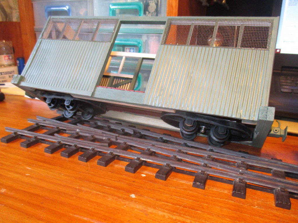

The Fox bogeys were refitted to the Mapleton bogey flats without further change, they too were built to the new height.

The IP Eng. cast whitemetal bogeys of the tramway coach were split apart and shortened as above. Removed some packing under the floor to bring it down to a surprisingly pleasing ride height. It kept it's cast whitemetal buffers, they're more suited to passenger stock.
The Mapleton-style livestock wagon received a set of dumb buffers, and it's New Bright bogeys replaced with a Roundhouse pair.
