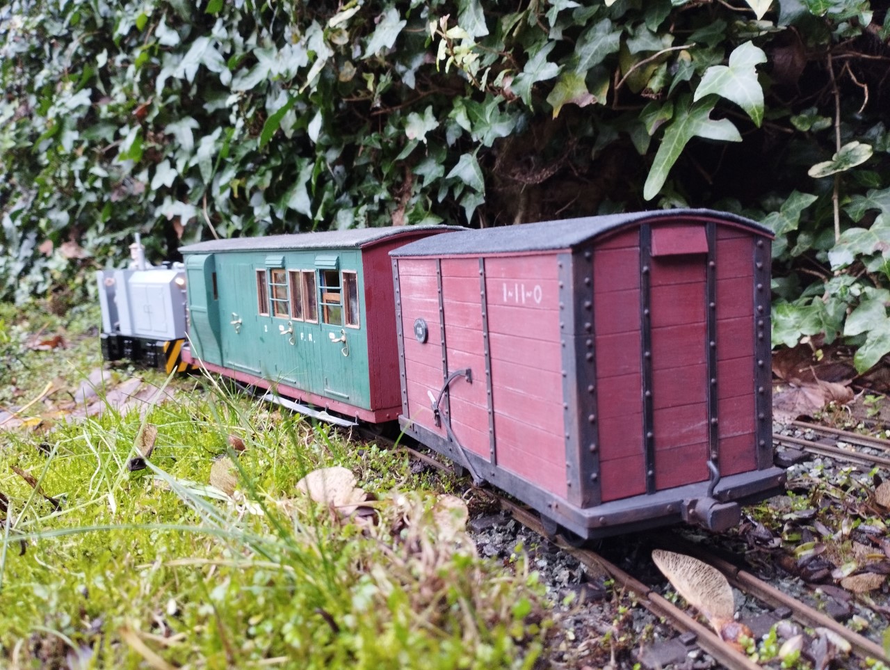

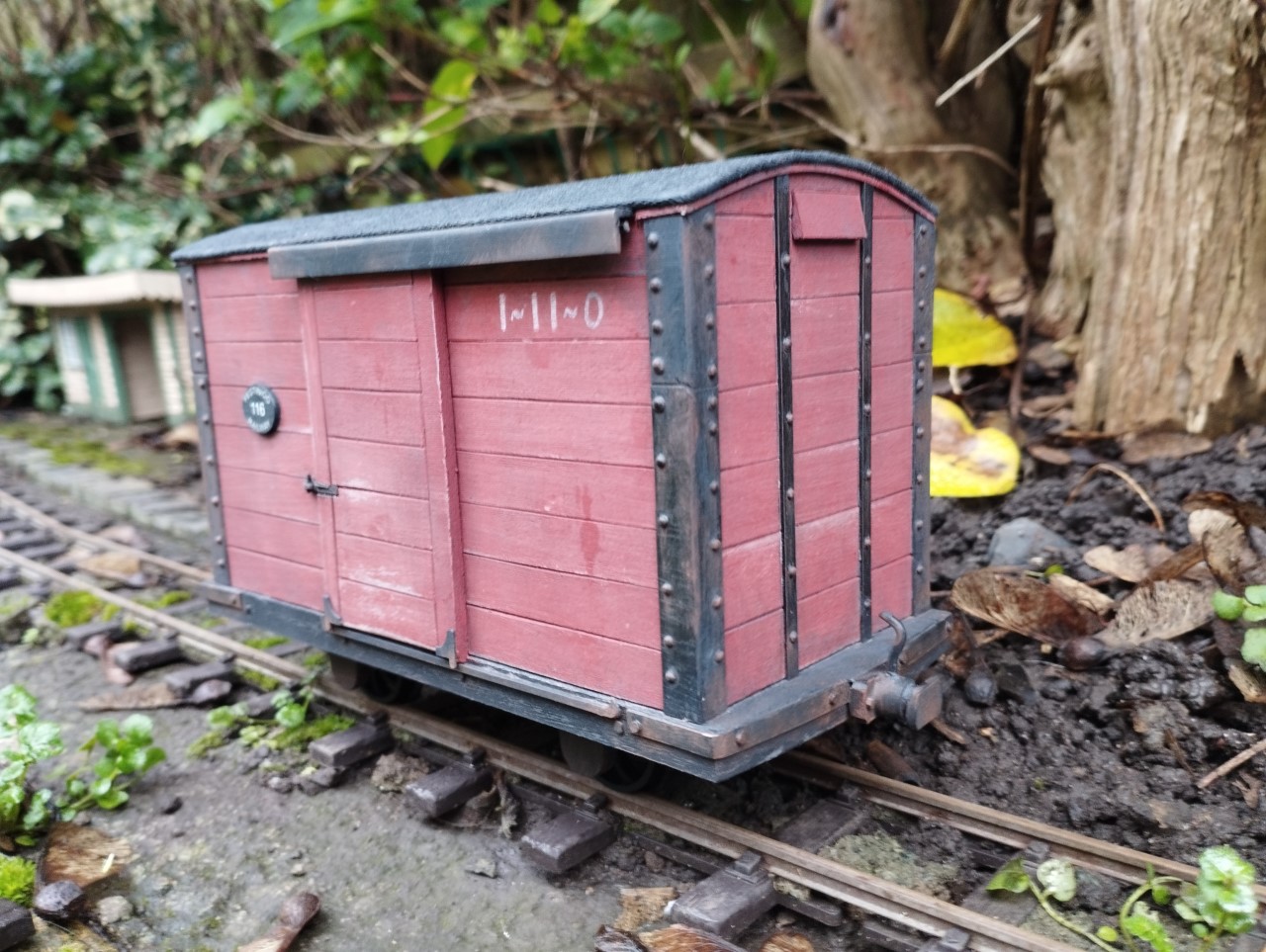

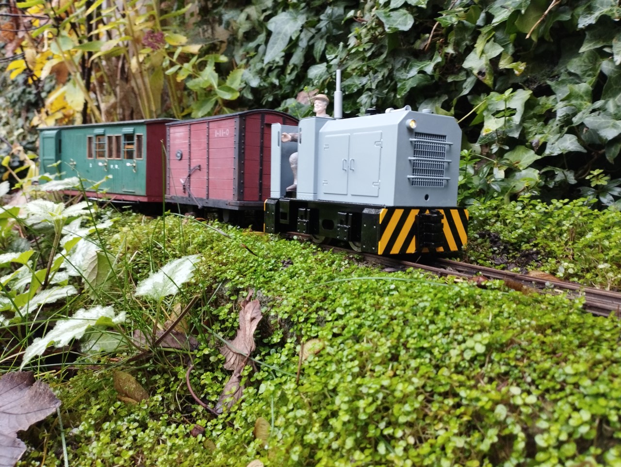

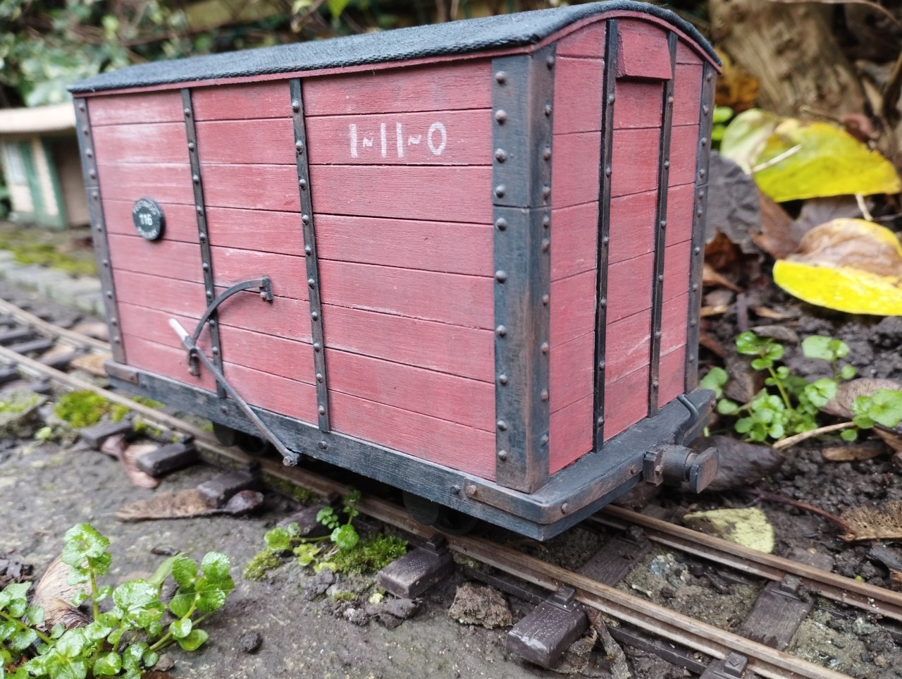

Back before I was distracted by the coal truck, I was distracted by an "H Jones Engineering" kit for the Ffestiniog van currently numbered 99, which was originally 116.
I've built the kit into what I hope is the van's 20s/30s guise, in the process embellishing it with individual plank overlays and rivets, swapping some of the strapping for chunkier alternatives, and adding some extra brake detail.
Here it is posing for its official photograph, and then going for a quick test run...
I'm thinking a "Christmas Mail" train featuring a variety of vans might be fun - watch this space!

Re: (WH)WHR Rolling Stock
Very very nice that van is Andrew.
A Christmas Mail train would be an excellent idea, for which I think you are doing secretly

I like the subtle weathering
Thanks Rik - I wanted to go for "work worn" rather than "worn out" with this one...
