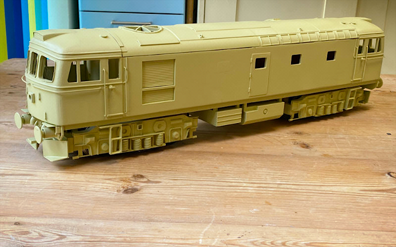

Cabs under attack from filler-primer, plastic putty, several grades of sandpaper; roof parts, not yet. Motorblock artfully placed so you can’t read my notes
May 2021 and Angr607, on this very forum, introduced the 3D print & acrylic, Gauge 1, Class 33 kit from Bowaters Models and, a pleasant surprise, accepted my request to knock out a scaled-up version at 1:27 (to sit with my existing, oddly proportioned fleet).
It’s been my first experience of large 3D printed components and in attempting to deal with the characteristic striation, I’ll admit to being a little heavy handed with filler and subsequent vigorous sanding. I’m modifying the kit to accommodate Piko motorblocks and it will be battery powered with Loco Remote control.
Ideally, to sit with my green coaches, it should be turned out in the original, disagreeable dark green and off-white livery. I can’t face doing one of those, though. Trouble is, so many of the Class 33 liveries seem to have been specifically conceived to make them appear as ugly as possible — have you seen the Network SE effort? Wow! You’ll notice from the snap I’m toying with alternatives that may not be historically correct.
The kit offers a great opportunity for anyone up for serious, OTT weathering though. I particularly remember rail blue versions becoming especially grotty (as we would have said at the tIme) with tatty, dented, flimsy-looking, bodywork panels and miserably faded paintwork: fit and finish you might expect to see at the allotment. Even when quite recently overhauled and repainted they soon seemed to get offensively grubby, too. There are plenty of photos online of horribly scruffy examples.
However. Construction of the kit — which is somewhat semi-scale (that’s fine with me) — is very straightforward and offers plenty of scope to get carried away detailing it, should you so wish. I wasn’t wildly enthusiastic about the appearance of the real ones back in the day but I guess I’ll just have to learn to love them.

Post by BertieB » Tue Sep 06, 2022 1:52 pm
I’m taking a few liberties with it, of course, but it’s coming along quite nicely, I think (unlike the garden).

Post by BertieB » Sat Sep 17, 2022 5:14 pm
It must be the first example of the 33/3 variant: there are a number of detail differences
The first thing I attempted was to mildly reshape the cab roofs, which didn’t seem quite ‘round’ enough to me (or to Andrew, I would imagine). It doesn’t seem to have made much difference though.
And the kit’s bogie sides, unfortunately, don’t match the wheelbase of the Piko motor blocks I chose to use, so I cast all four in resin from a rather clumsy, late night, adaptation of one of the 3D print originals. I ought to do it again really, more carefully.
Otherwise, I’ve tarted the 33 up a little, with cheerfully approximated detail (I’m going for 'early 60s train set' again), which nonetheless I hope will help achieve quite an imposing model. It’s quite big, almost 600mm, which is splendid — and width and height are exactly according to my established loading gauge! Placed alongside my scratch-built stuff, however, it looks a little delicate, as though it ought to be say, five per cent bigger (clearly the kit’s proportions are more accurate than mine tend to be). Still far from finished, obviously.
I’d happily recommend the kit — and the fun you can have ‘embellishing’ it. It’s not dirt cheap and there’s very little in the way of detail or cosmetic enhancement included but you do get a lot of locomotive for your money. More please!
