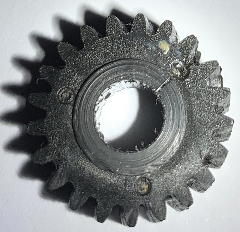

My locomotive's gear broke; I notice 2 teeth are in bad condition, and this is the third time I encounter this problem. I wonder if there is any service to create brass gears? I hope the lifetime will be longer than the plastic counterparts.

It turned out NWSL does not have the right gear for the model. They said this is the first time they heard of gears for USA trains dockside. So my next approach is trying to find a matching pair gear/worm gear with similar dimensions to those I am going to replace.

After searching for the gears unfruitfully, one of my friends made one for me using 3D printing. It turns out the gear (which was printed using onyx, if I am correct) is even stronger than to original plastic version. I tested the run today, it is perfect. Thank you all for those who help me searching for the gear.
