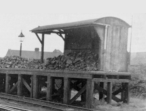

The locomotive is carefully positioned and hides the current lack of a coal-stage. I decided that whilst the foamboard is setup I could quickly build (!) a coaling stage to fit in the corner. I wanted a wooden bucolic affair. I needed real-world images to guide me on the cross-bracing of the staging. Most Google Image hits were of models, but amongst the others was this wonderful affair.
<r><URL url="https://www.warwickshirerailways.com/lm ... s>[url]</s> https://www.warwickshirerailways.com/lms/mrred418.htm<e>[/url]</e></URL></r>
I wondered if it would look right in a narrow-gauge setting. If built in stages (pun noted), it wouldn't require much extra work to trial the wriggly-tin affair but still have a simple stage to fall back on. The decision seemed to already be made after two loaded waggons appeared in the yard.
