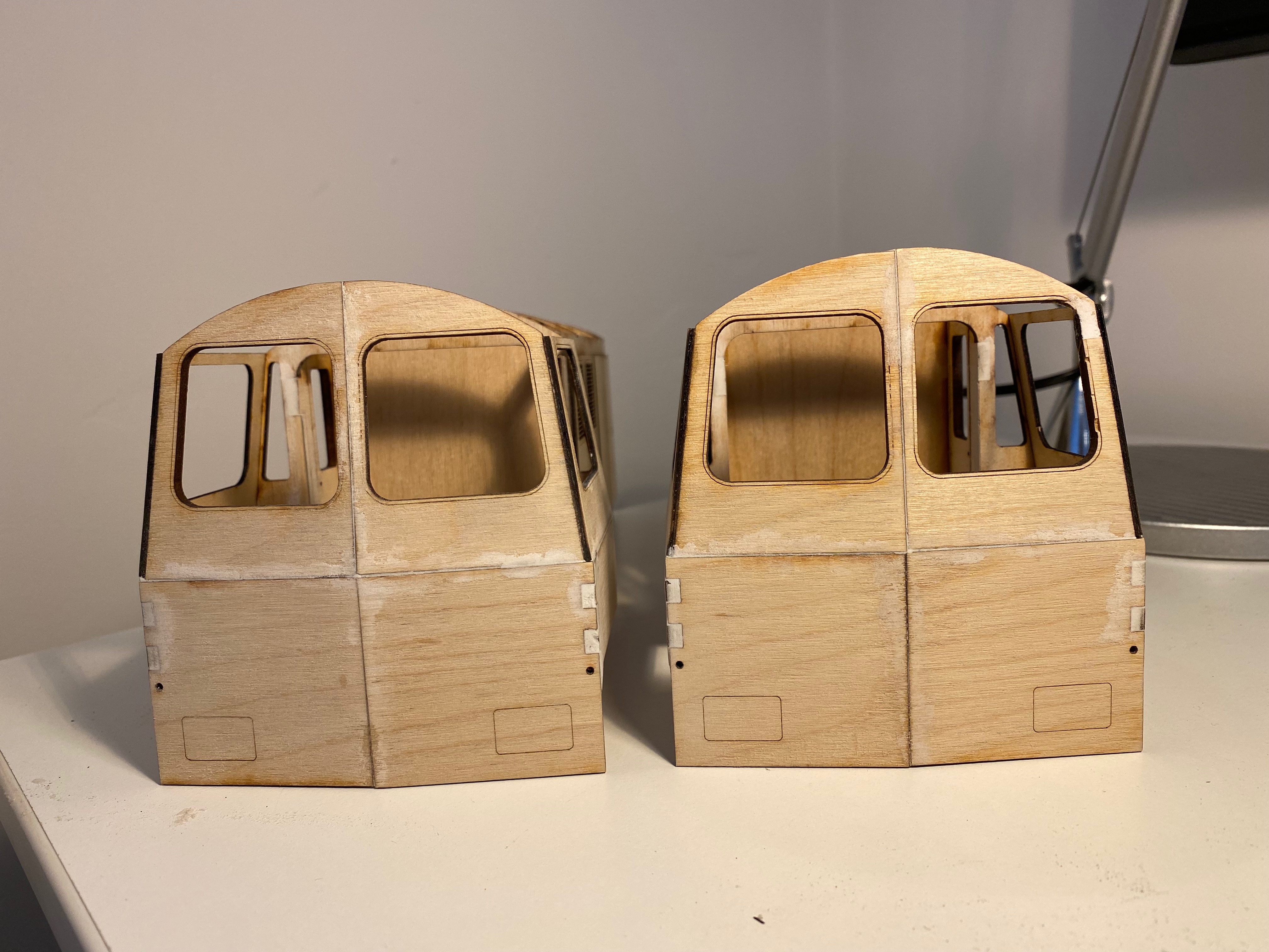

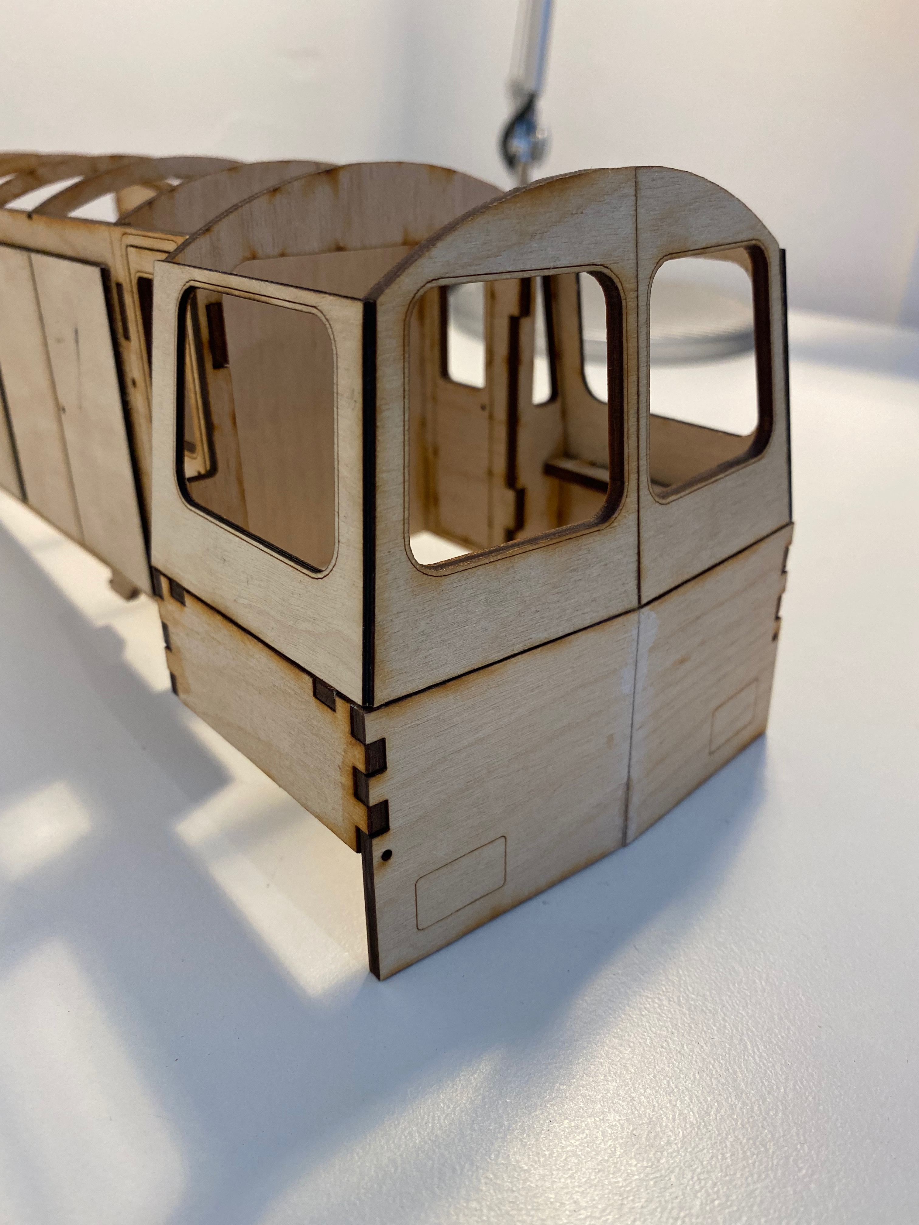

A chamfer needs to be created on many of the cab pieces to achieve the desired angle of the front. I think I've made a satisfactory job of putting this together and I'll use filler to hide the gaps..
Speaking of filler here are the two cab fronts after some filler and a light sanding. I think I'll probably give the entire locomotive a coat of primer and then touch up any gaps as required.

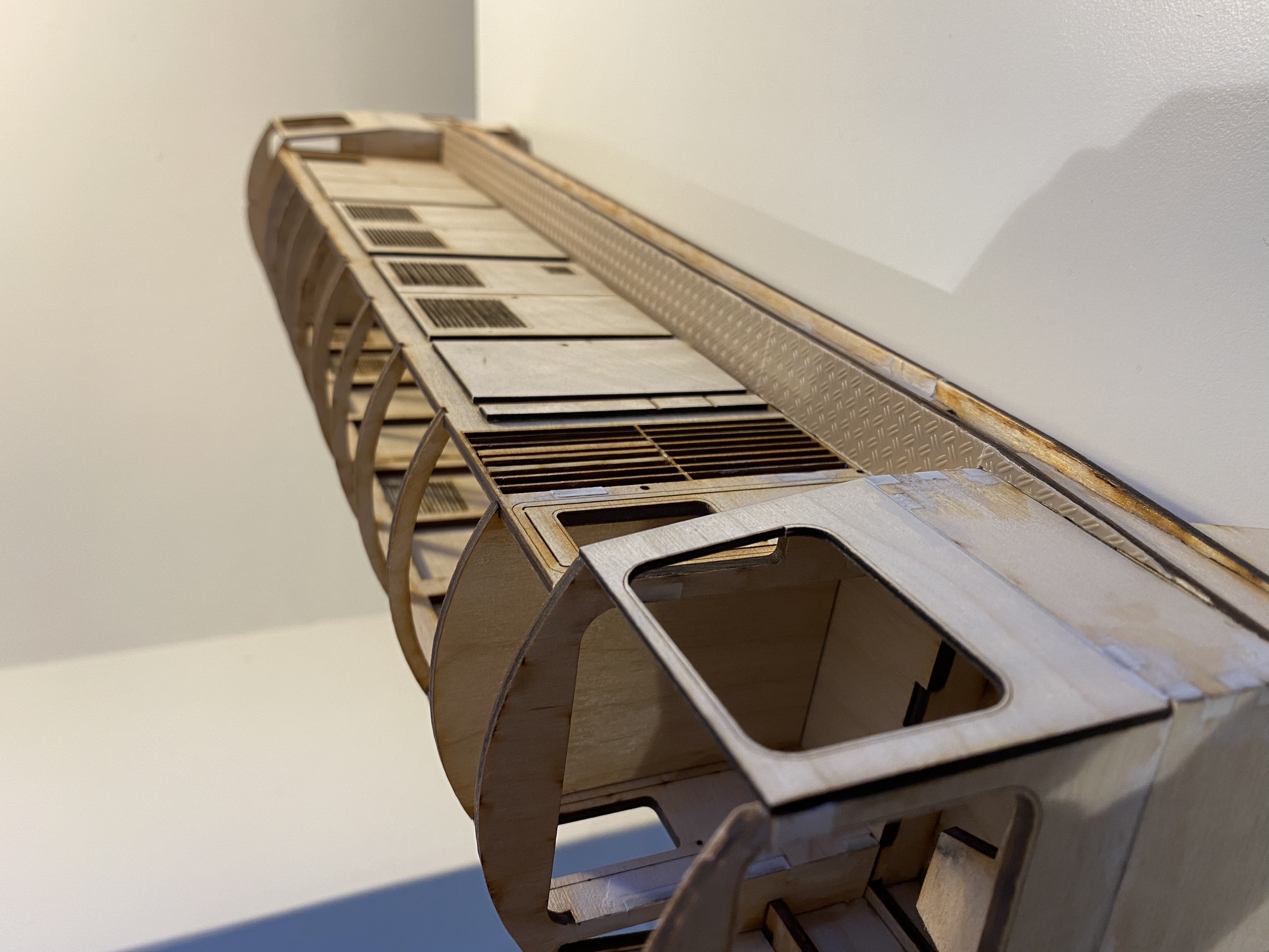

I've now fitted the side panels to the locomotive. It's starting to really come together. The main chassis has been lightly sanded. I've tidied up the 3D printed parts with some model filler so they can now be attached. Currently pondering whether to fit the roof before the primer goes on, I figure it might be easier to access without the roof in-place.

georgesheppard wrote: Mon May 03, 2021 3:12 pmI've now fitted the side panels to the locomotive.
Something odd with those doors. The two with vents at the right hand end should be in positions 5 and 6, not 5 and 7.
The little vent on door 4 is for the exhaust from the cab heater.
The two sides are not mirror images of each other.

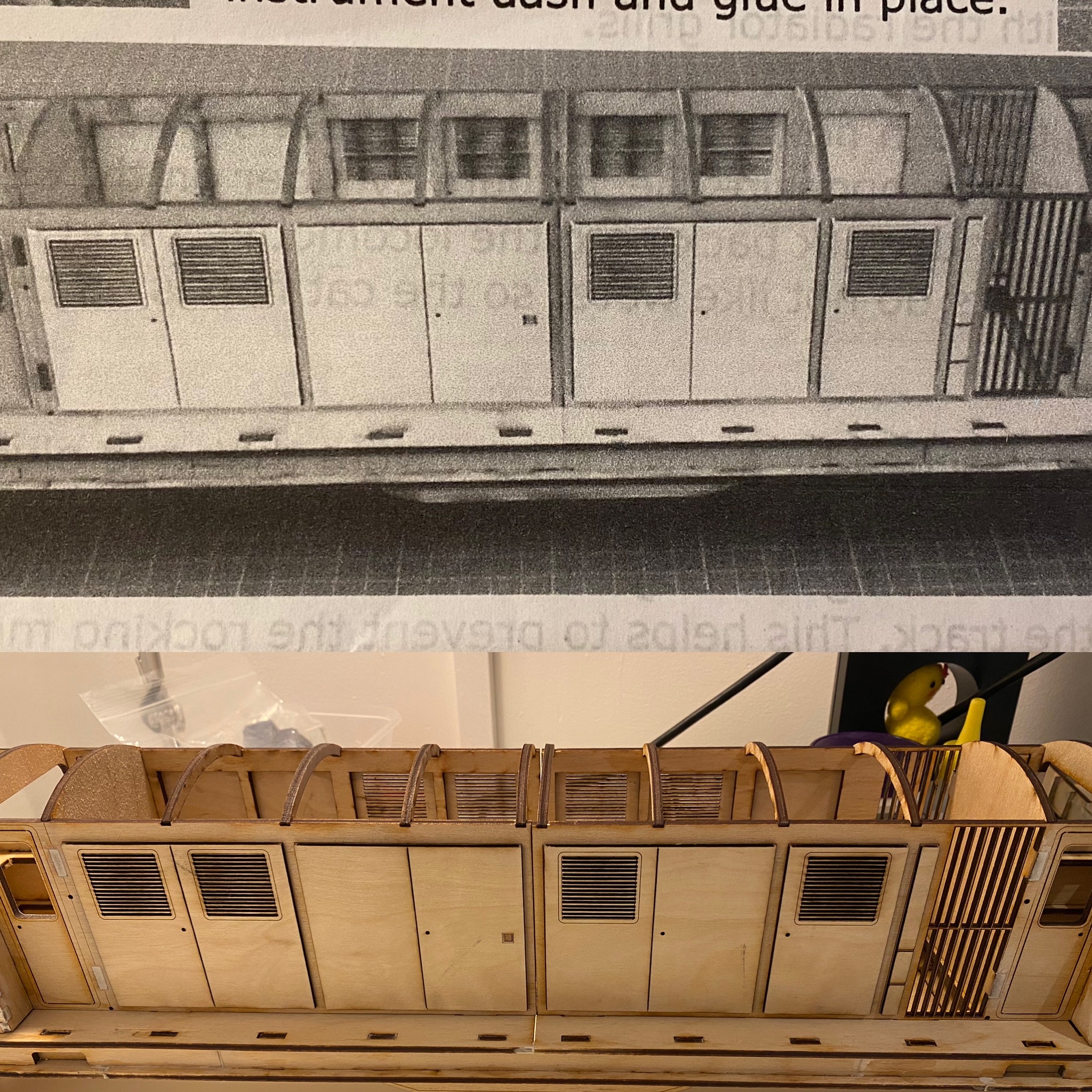

It seems this is incorrect in the kit unless I’m missing something.
Side by side from the instructions
Side by side on photos.
The incorrect panels are a double and a single, if they weren’t firmly affixed by super glue I could probably cut the double panel in half and use the blank door in place of the door with the grill. I’m more concerned about damaging the panels than it being totally correct, so my model will have to keep the incorrect panel arrangement.

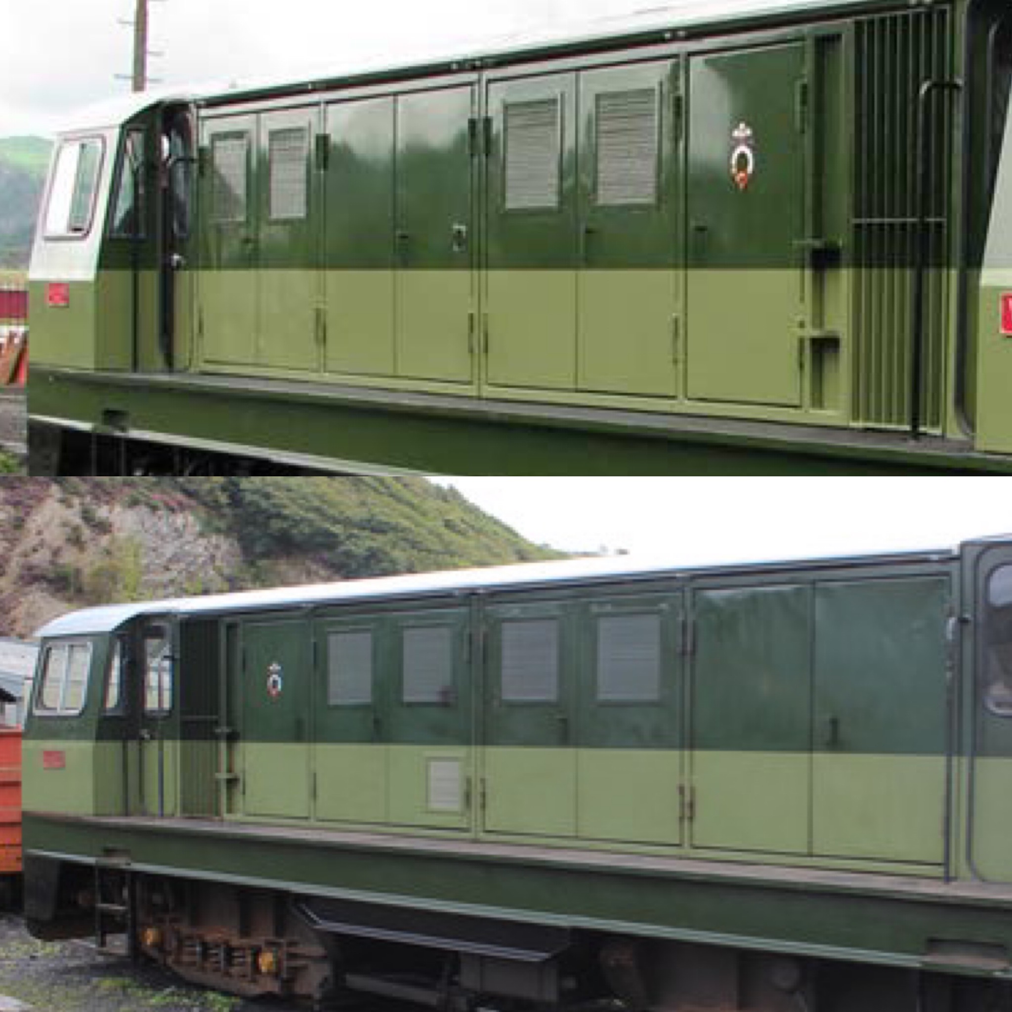

And then there was this: Image
The doors lift off their hinges and can easily be swapped around. Quite why somebody thought the fuel tank needed a vented door is a mystery to me.

TonyW wrote: Tue May 04, 2021 10:19 am And then there was this: Image
Precisely my point. And it seems as the doors are configured in the model it appears, at least on that side of the loco. The other we can glimpse in the instruction sheet but does it match the other side of the loco as pictured at that point ? It can be a problem when the widely accepted published detailing/configuration of a prototype does not match the way it is depicted in a scale representation. As they say the devil is in the detail.
